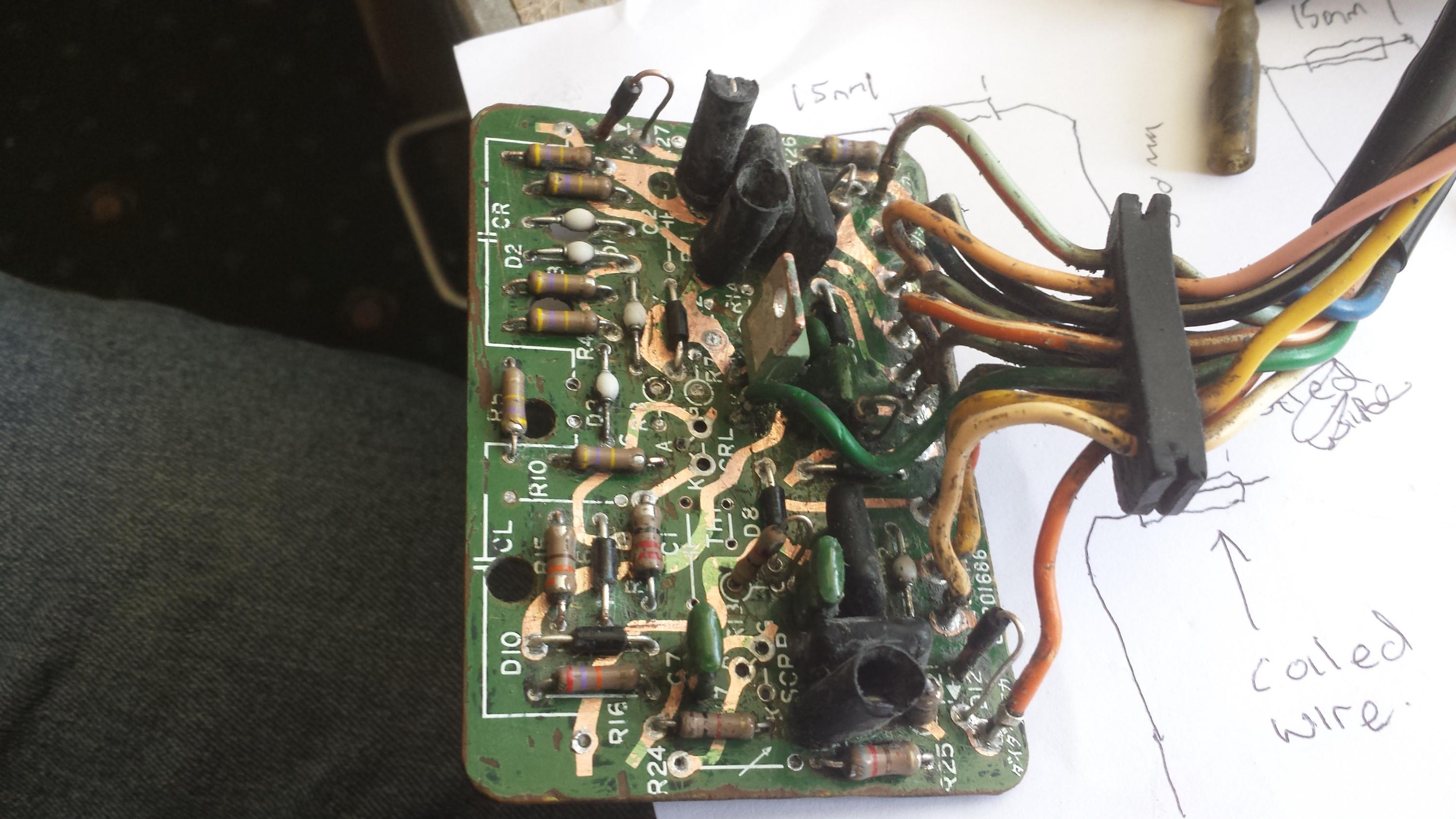

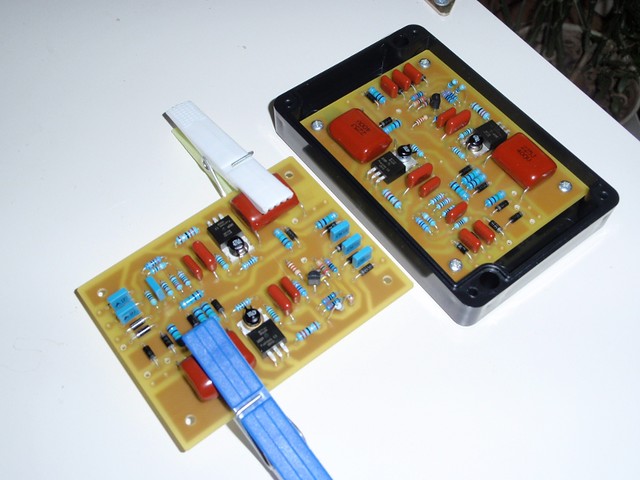

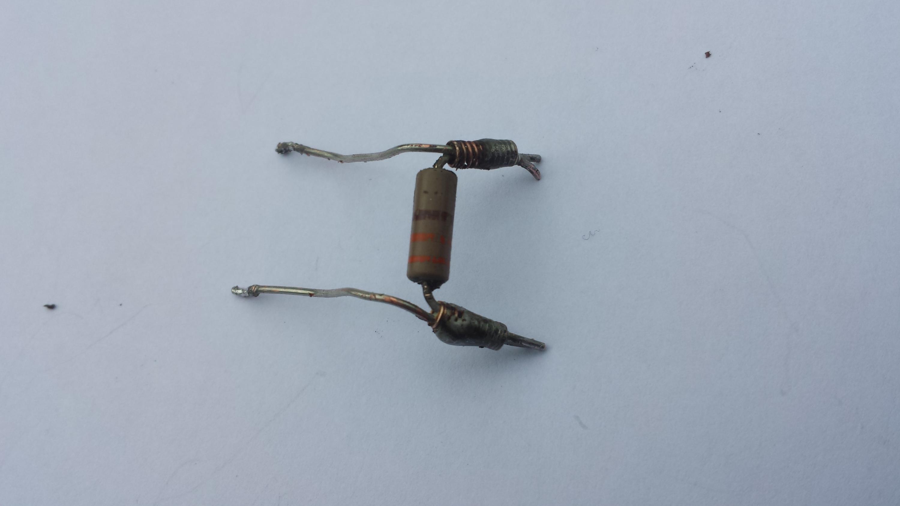

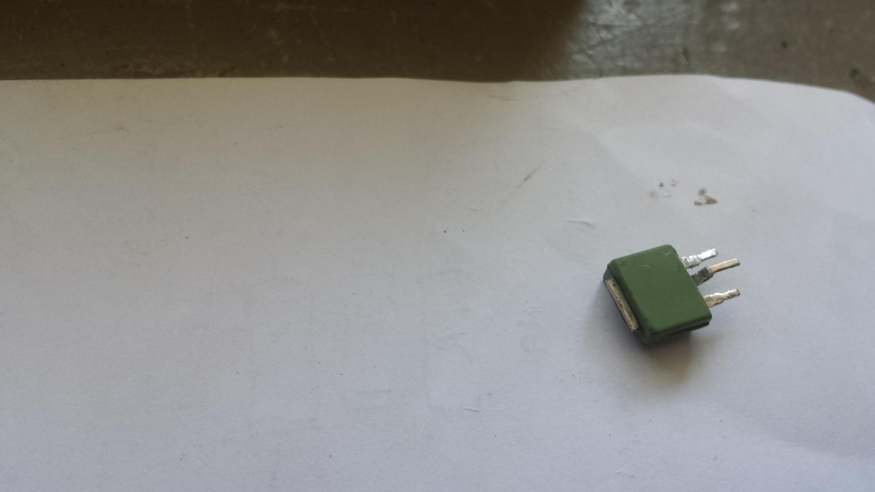

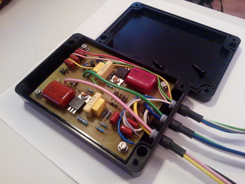

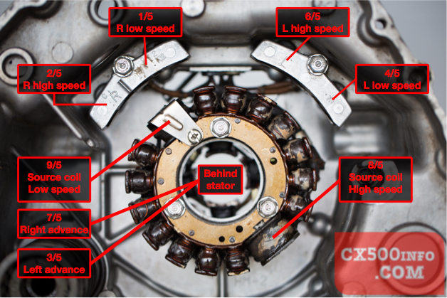

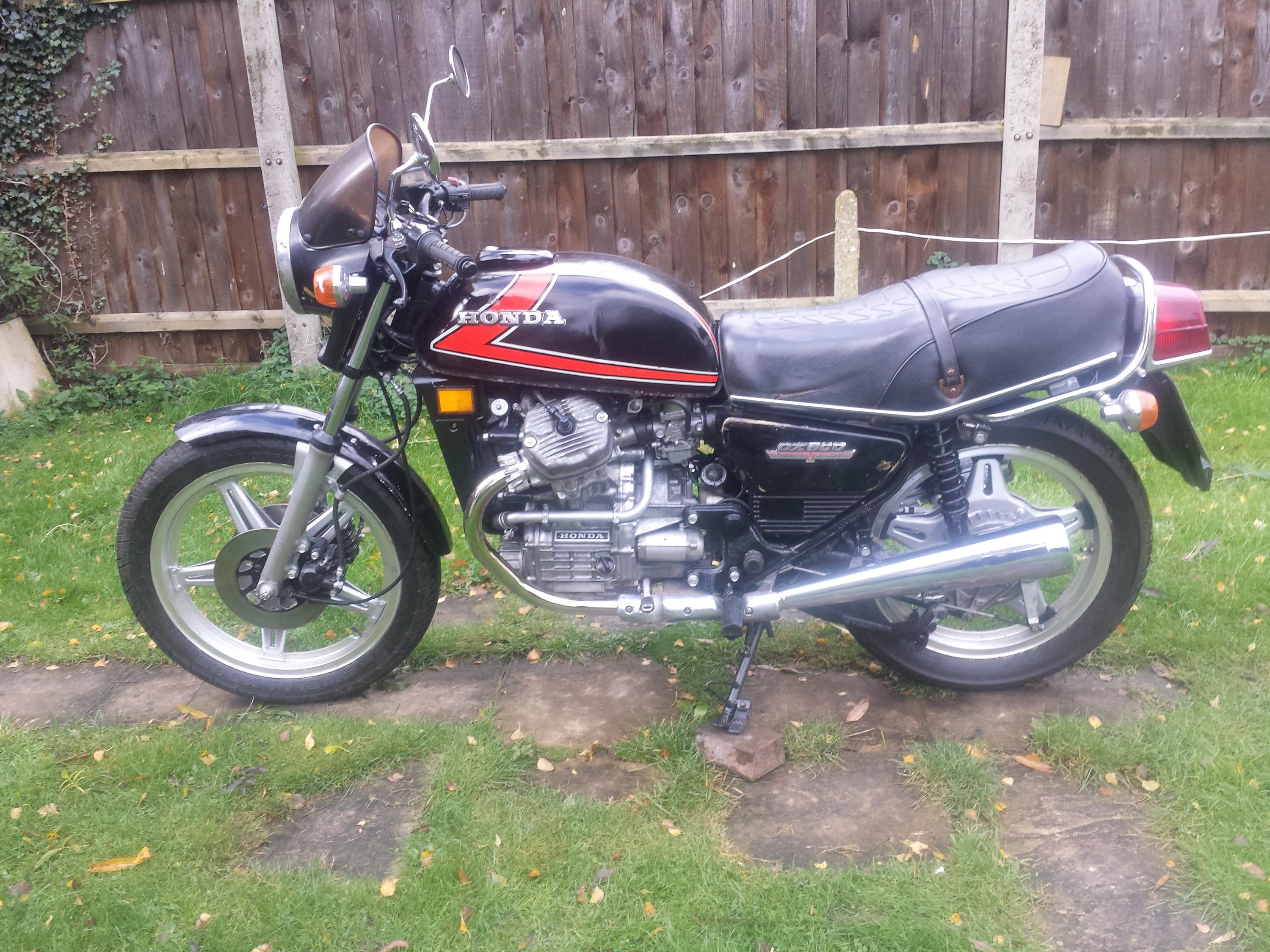

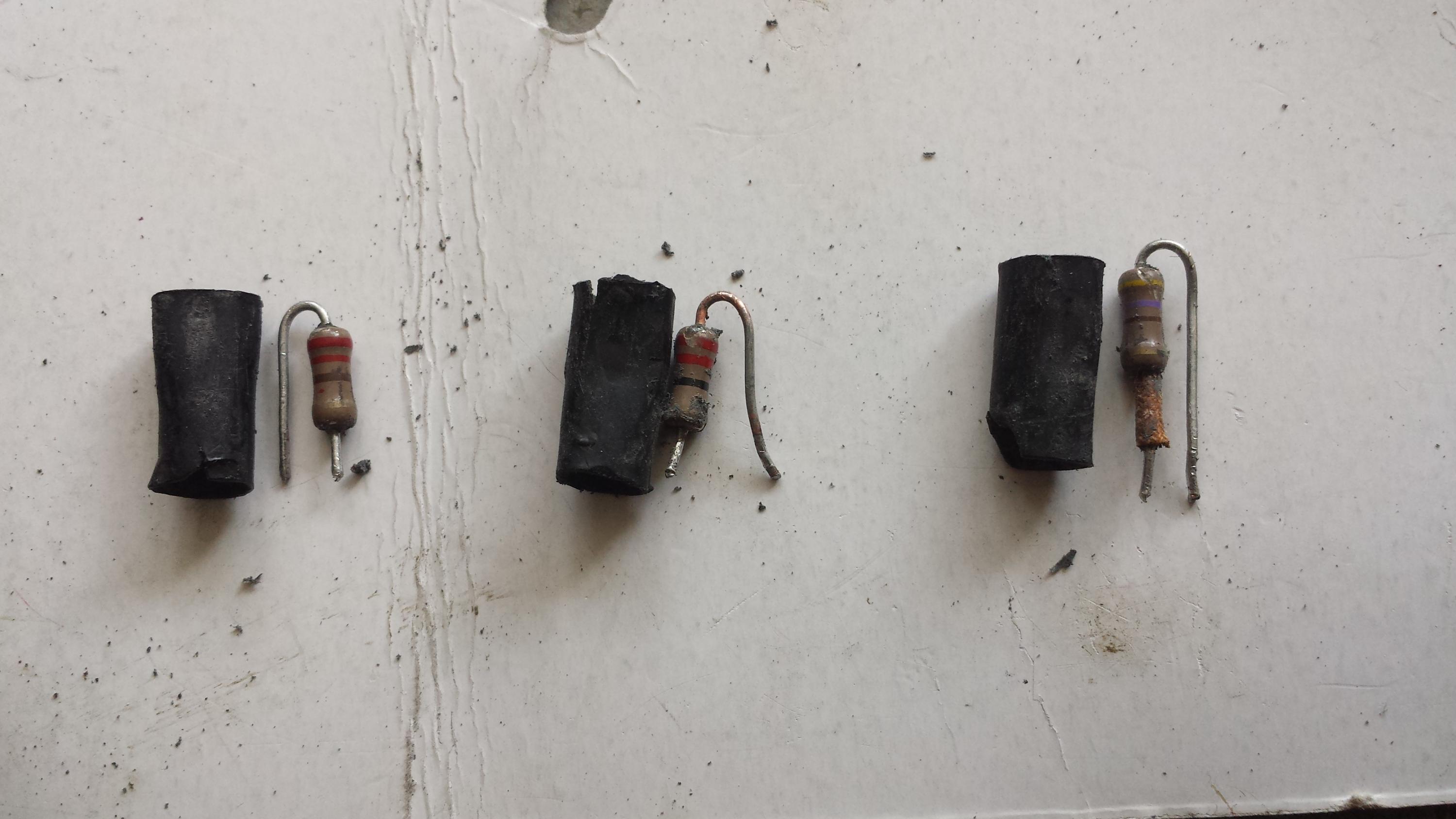

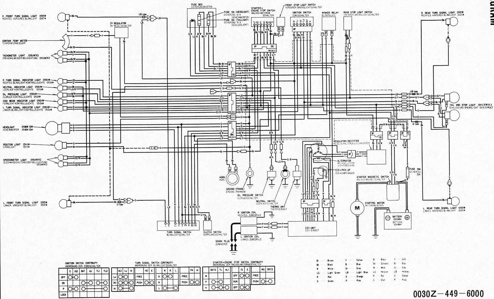

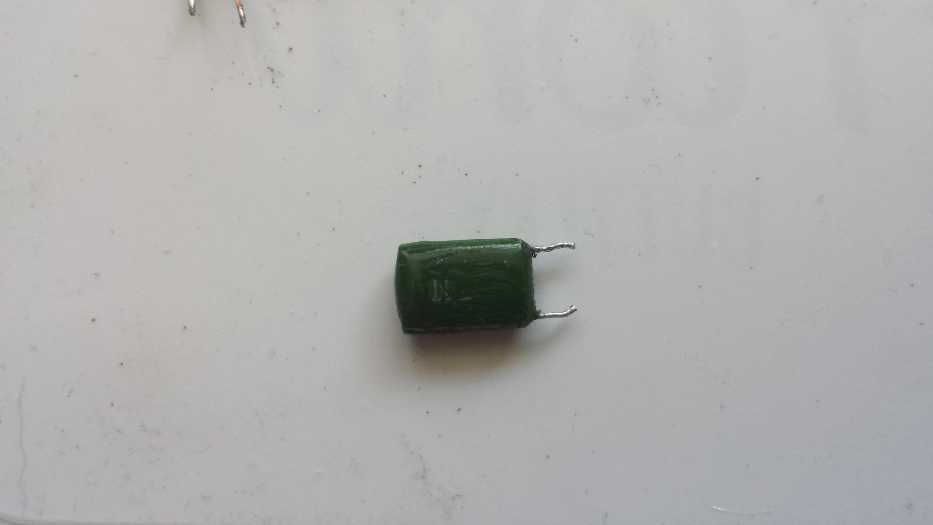

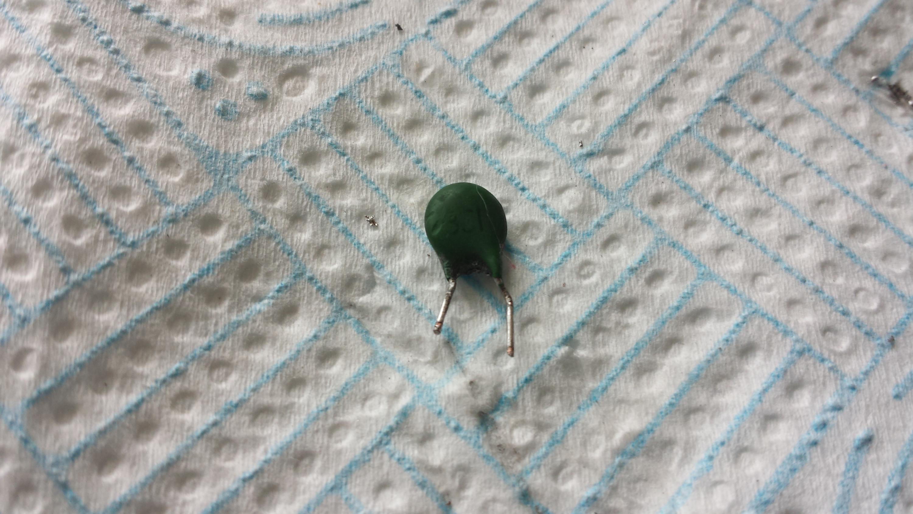

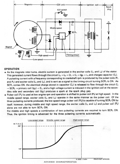

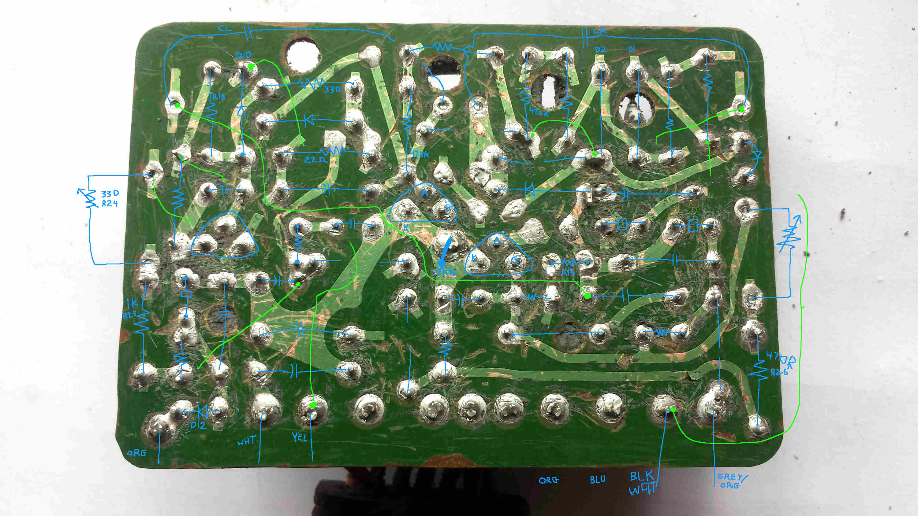

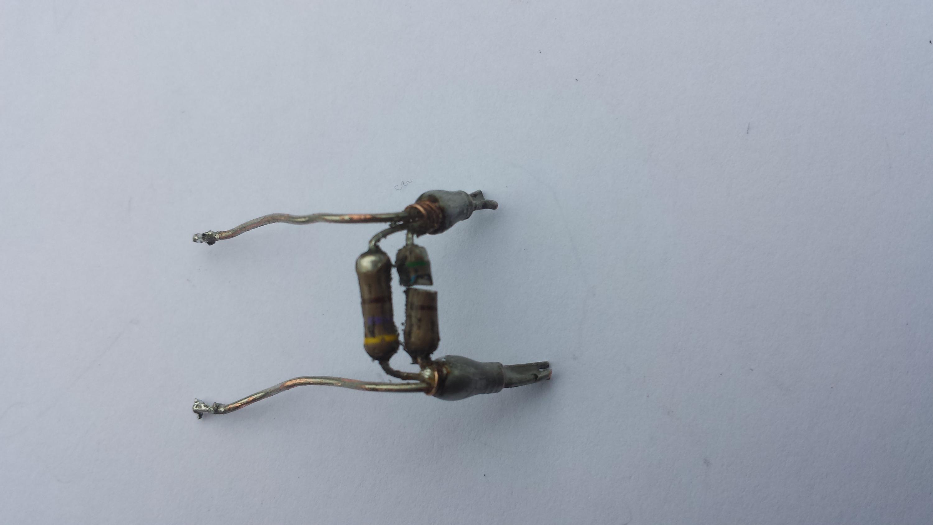

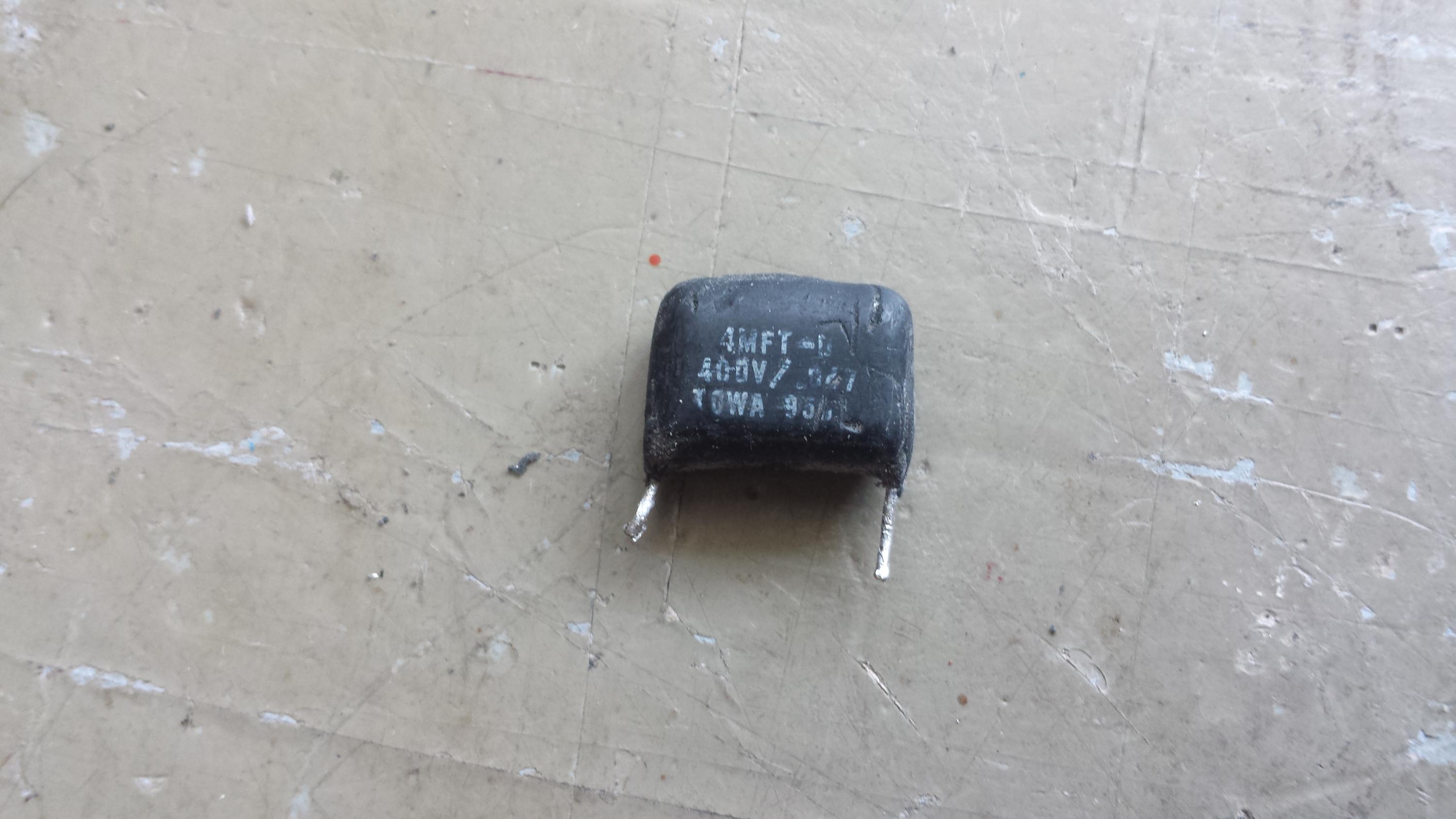

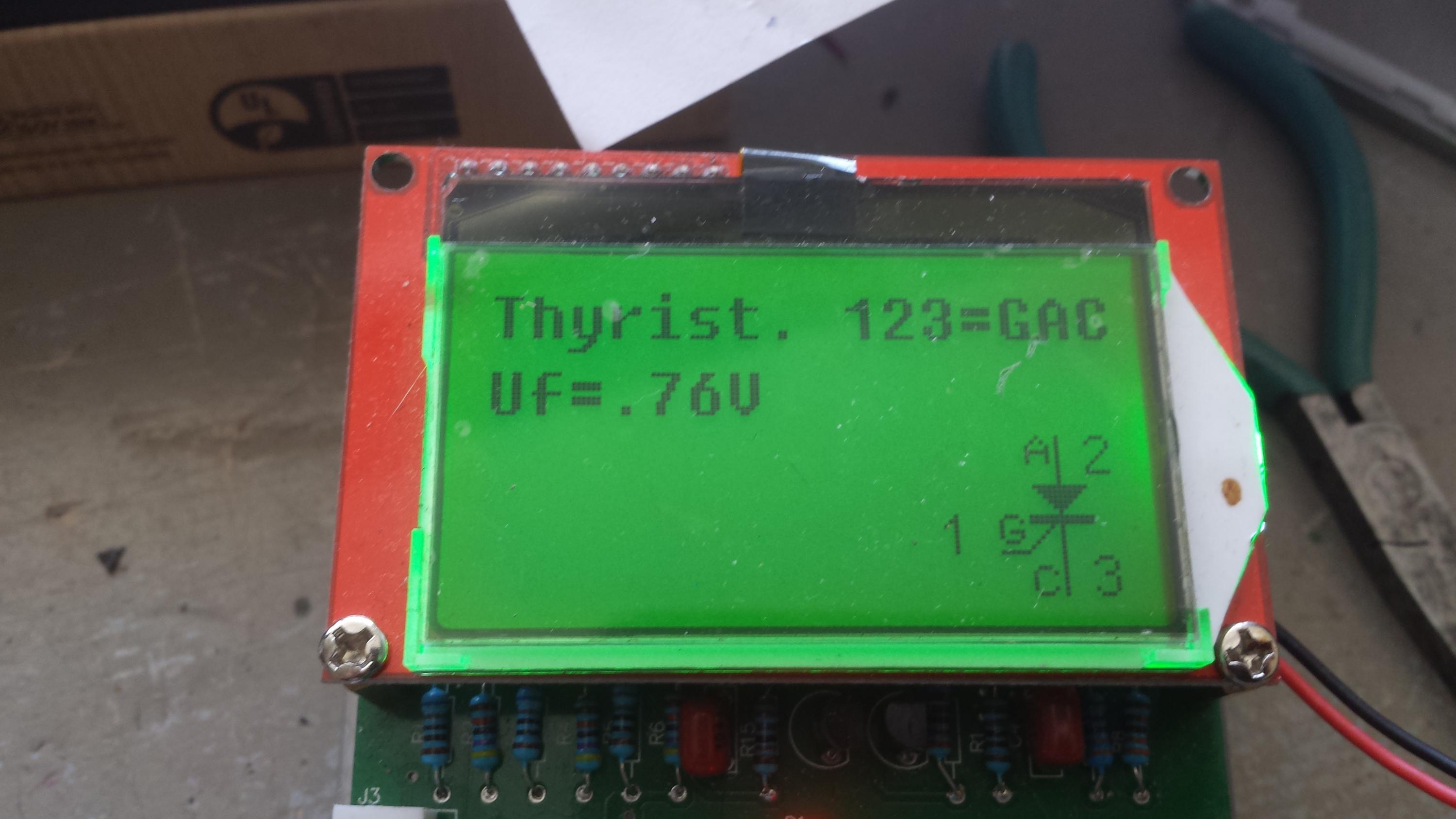

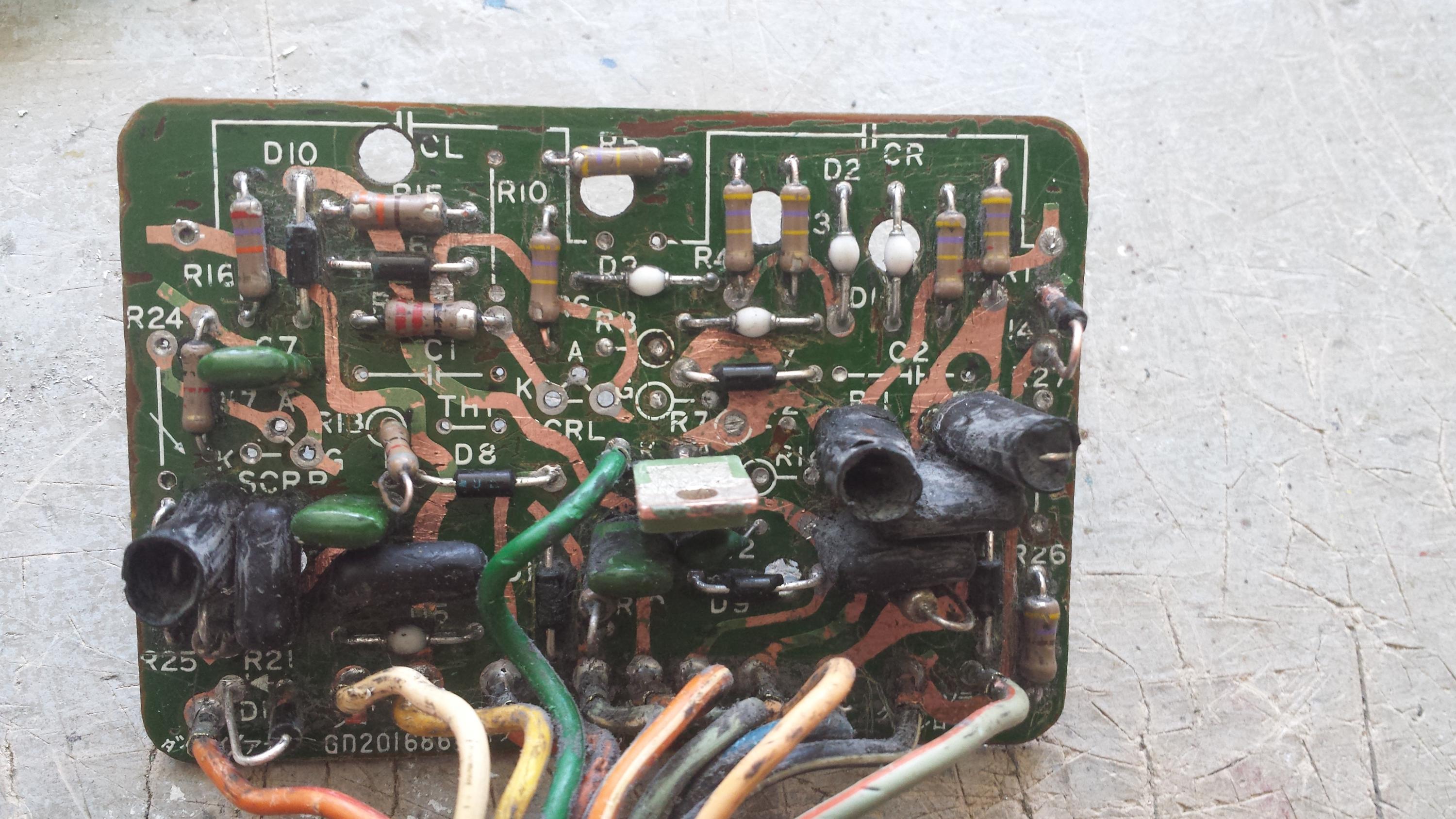

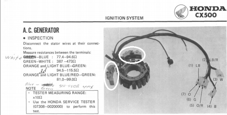

Honda CX500 Motorcycle CDI ignition unit
  • roadrash
    • Oct 2015
    • 493
    • U.K.
    Re: Motorcycle CDI ignition unit
    Originally posted by redwire
    The tricky part will be the thermistors. You would have measure their resistance at a few different temperatures to find something that matches. As the SCR's heat up, their sensitivity goes up and the thermistor lowers how much gate drive they get.
    I did see a remake of the box called Finnbox G47, the thermistors are on the SCR's tabs.
    I have seen the finnbox and others like the Ignitech one too. The finn box is no longer available as far as I can find out as their website is now dead. The Ignitech is very expensive in the hundreds of British pounds.
    The thermistors you mentioned, are they maybe what those resistors wired to each other are at each end of the original unit
    they just look like a standard pair of resistors wire wound together with copper wire are sit high up at each end of the PCB.
    • roadrash
      • Oct 2015
      • 493
      • U.K.
      Re: Motorcycle CDI ignition unit
      Originally posted by stj
      maybe re-designing it to use mosfets is the answer.
      or darlingtons
      Gone over my motor-mechanics head stj. Quite happy to experiment with this old unit now we have access to it as I still have my working unit still fitted to the bike.
      Apparently there are extra winding's in the stator of the bike that generate 12v to power the unit but in a aftermarket cdi unit called a "Ignitech" (click here for info) they dont use the 12v supply from the stator and instead just take the 12v supply from a switched 12v output from the battery. By doing this it means if those 12v winding's in the stator pack up it doesn't matter anymore. I don't see why this original unit cant be modified to take its 12v supply from the battery too as a sensible modification. We can try all these improvements once I get it working again.
      • roadrash
        • Oct 2015
        • 493
        • U.K.
        Re: Motorcycle CDI ignition unit
        Originally posted by SMDFlea
        (off-topic) The old CX500 flying maggot , a friend of mine had one of those
        yes thats it except we called it the plastic maggot after the little plastic cowl over the headlamp. Most bikes in that era were what we call naked and never had plastic cowls or fairings so hence "plastic"
        • redwire
          • Dec 2010
          • 3912
          Re: Motorcycle CDI ignition unit
          Originally posted by roadrash
          I have seen the finnbox and others like the Ignitech one too. The finn box is no longer available as far as I can find out as their website is now dead. The Ignitech is very expensive in the hundreds of British pounds.
          The thermistors you mentioned, are they maybe what those resistors wired to each other are at each end of the original unit
          they just look like a standard pair of resistors wire wound together with copper wire are sit high up at each end of the PCB.
          Those are just calibration resistors to precisely set the circuit for the two particular SCR's sensitivity. One is 330R, the other 470R+560R parallel = 255R (SCR gate-drive).
          The thermistors would be in the tall black towers, it looks like heatshrink tubing or something with parts inside. They are likely 470-500R at 25°C.
          I started drawing the schematic while a friend was boring me to death on the phone with their life's drama. It's a way to reverse engineer these modules, mirror the board and then doodle in the parts you know. I did not finish it because I don't know many of the parts, and well, people have already done it.
          The other pics are more of the Finnbox, should be able to clone it. Finnbox builder's pics: https://www.flickr.com/photos/lotjak...7632938667888/
          The TIA02-14 part number I'm not sure, usually the SCR's are special CDI parts which can take a massive current surge, like S6992 or S6A13.
          Some guy's CX500 repair photos https://www.flickr.com/photos/7849153@N05/
          P.S. your bike looks really nice
          Last edited by redwire; 06-12-2021, 01:51 PM.
          • roadrash
            • Oct 2015
            • 493
            • U.K.
            Re: Motorcycle CDI ignition unit
            Originally posted by redwire
            Those are just calibration resistors to precisely set the circuit for the two particular SCR's sensitivity. One is 330R, the other 470R+560R parallel = 255R (SCR gate-drive).
            The thermistors would be in the tall black towers, it looks like heatshrink tubing or something with parts inside. They are likely 470-500R at 25°C.
            I started drawing the schematic while a friend was boring me to death on the phone with their life's drama. It's a way to reverse engineer these modules, mirror the board and then doodle in the parts you know. I did not finish it because I don't know many of the parts, and well, people have already done it.
            The other pics are more of the Finnbox, should be able to clone it. Finnbox builder's pics: https://www.flickr.com/photos/lotjak...7632938667888/
            The TIA02-14 part number I'm not sure, usually the SCR's are special CDI parts which can take a massive current surge, like S6992 or S6A13.
            Some guy's CX500 repair photos https://www.flickr.com/photos/7849153@N05/
            P.S. your bike looks really nice
            That's some very interesting info redwire. I did see a supposed circuit diagram online but people who tried to make it say it doesn't work.
            I recently had to send a Kawasaki ER5 CDI box to a company in the Netherlands called Carno who did manage to repair it at a cost nearing 200 UK pounds.
            Do you want me to remove those thermistor stacks and unwrap them to see what's inside? I am removing some parts carefully and cleaning up the pcb of that resin as I go and resoldering all other parts. Hopefully when finished I should have a working CDI box and all the info that can be used to repair or recreate clones of the original. The pcb looks pretty straight forward and not overly complex. As long as there are not any custom components it should be possible.
            Thanks for the remarks about my bike. It's not as nice as it could be but if you saw the condition it was in when it was dragged out of a leaky old shed where it sat for over 30 years you would have thought it was scrap only and for that reason I never did a full restore as I was not sure it was possible to make it usable again with even the frame rotted out in some places. Now it's done it could be stripped again and a full as new restore done. But like it is now it's used a lot and not just for show.
            Last edited by roadrash; 06-13-2021, 07:28 AM.
            • roadrash
              • Oct 2015
              • 493
              • U.K.
              Re: Honda CX500 Motorcycle CDI ignition unit
              This capacitor C7 (see pic) is showing up as a resistor on my component tester with a value of .55 ohms. Is that normal? unfortunately it has no value marked on it, just what looked like a "N" symbol. Ive also just removed what my tester says is a thyristor.
              also another up tp date picture of pcb now cleaned up a lot better so that component markings can now be seen.
                • 31296
                Re: Honda CX500 Motorcycle CDI ignition unit
                first pic is a mylar film capacitor!!
                • redwire
                  • Dec 2010
                  • 3912
                  Re: Honda CX500 Motorcycle CDI ignition unit
                  That film cap C7 is shorted. It should be 0.047uF (473) 47nF low voltage 100V, it filters the Left TDC pulse with R15 330R. It doesn't see high stress so I'm not sure why it died edit: the module might have been wired up wrongly to the HV coil and that killed it. C7 is across SCR P anode-cathode. The larger black film caps are 47nF 400V.
                  There's only two real mysteries in the CX500 CDI module.
                  The thermistor's value and temperature curve. If you measure the ohms at room temp and maybe the fridge we can find the part. The black towers are weird, I'm not sure what's in them. One thermistor connects to R13, other to R14, if that is the bead in the black heatshrink. I don't think scraping them out will tell us anything. Maybe the Finnbox guy is willing to share what he used?
                  The other mystery is what the factor calibration resistors are about, Finnbox guy had a prototype with trimpots and then he got rid of them.
                  I understand the internals of the module so no prob to make one if they are not available at a fair price.
                  This bike seems very advanced for it's time - V-twin, water cooled and Honda does go crazy with complexity. I think there's six crank pickup coils lol.
                  Last edited by redwire; 06-13-2021, 03:14 PM.
                  • roadrash
                    • Oct 2015
                    • 493
                    • U.K.
                    #29
                    Re: Honda CX500 Motorcycle CDI ignition unit
                    Originally posted by redwire
                    That film cap C7 is shorted. It should be 0.047uF (473) 47nF low voltage 100V, it filters the Left TDC pulse with R15 330R. It doesn't see high stress so I'm not sure why it died edit: the module might have been wired up wrongly to the HV coil and that killed it. C7 is across SCR P anode-cathode. The larger black film caps are 47nF 400V.
                    There's only two real mysteries in the CX500 CDI module.
                    The thermistor's value and temperature curve. If you measure the ohms at room temp and maybe the fridge we can find the part. The black towers are weird, I'm not sure what's in them. One thermistor connects to R13, other to R14, if that is the bead in the black heatshrink. I don't think scraping them out will tell us anything. Maybe the Finnbox guy is willing to share what he used?
                    The other mystery is what the factor calibration resistors are about, Finnbox guy had a prototype with trimpots and then he got rid of them.
                    I understand the internals of the module so no prob to make one if they are not available at a fair price.
                    This bike seems very advanced for it's time - V-twin, water cooled and Honda does go crazy with complexity. I think there's six crank pickup coils lol.
                    Thats incredibly useful info Redwire. I will get those measurements done so we can identify what these unusual components are. Re the cap C7, I couldn't have wired anything wrong at any time as its all connected by the original connectors so it was probably another component failure that caused a over voltage. I did some more work yesterday and when testing one of the trannies my tester said it was not recognised or faulty. It looks the same as the other green TO220 one I removed earlier. Do you happen to know what type these are as this one is going to need replaced.
                    Just wondered if you had seen this article about the CX500 CDI as its has some useful info too Here and and here
                    • roadrash
                      • Oct 2015
                      • 493
                      • U.K.
                      #30
                      Re: Honda CX500 Motorcycle CDI ignition unit
                      Ive looked at the tower thingy's and they are not tunable pots of any kind, just resistors inside a plastic tube filled up with that same rubbery resin. Ive now finished checking everything on the PCB and most is ok with the exception of one transistor and the cap you mentioned Redwire. What kind of caps are these?
                      • redwire
                        • Dec 2010
                        • 3912
                        #31
                        Re: Honda CX500 Motorcycle CDI ignition unit
                        Oh, the heatshrink just has resistors inside. Now I see the nearby two green thermistors TH1, TH2 but I figured out their values, they should be 500 ohms at room temp. and around 1.2k in the fridge.
                        I have to look at the SCR's because they come in maybe 5 different sensitivities, i.e. IGT 6mA, 10mA, 15mA, 20mA, 30mA and the old green Toshibas I have to dig for. Later I can give a parts list, I have them all figured out.
                        I would check the 14 diodes (!) the board has too.
                        I can't see a way to zap the capacitor C7 so either it got stabbed scraping the potting compound off, but maybe it did fail short. The Left ign timing coil connects to it and is supposed to be low voltage.
                        The cap pictured is a 47nF 400V film cap, best is polypropylene like Epcos B32621A4473K000 or Panasonic ECW-F4473HL. I'm not sure who your parts disti's are in the UK.
                        Last edited by redwire; 06-15-2021, 03:57 PM.
                          • 31296
                          #32
                          Re: Honda CX500 Motorcycle CDI ignition unit
                          howdoes it work in general, i'm not a bike person.
                          is it fed a fixed dc voltage?
                          does it get a clean trigger pulse to trip the output??
                          i have a schematic for a german kit for CDI unit to add to a car - maybe it could be doubled and modded for higher rpm limit.
                          • roadrash
                            • Oct 2015
                            • 493
                            • U.K.
                            #33
                            Re: Honda CX500 Motorcycle CDI ignition unit
                            Originally posted by stj
                            howdoes it work in general, i'm not a bike person.
                            is it fed a fixed dc voltage?
                            does it get a clean trigger pulse to trip the output??
                            i have a schematic for a german kit for CDI unit to add to a car - maybe it could be doubled and modded for higher rpm limit.
                            Not a expert on this but I do know the stator supplies a isolated 12v just to power the CDI which is not powered from the ignition voltage as you would think so the bike can be started with a totally flat battery if you bump start it in gear.
                            I did read somewhere there are two outputs so the cdi, one does low speed and he other high speed.
                            You would need to Google the Honda CX500 ignition to get all the details. I am still using a 40+ year old unit now and I have a feeling it's on its way out to because there are occasional pops and bangs out of the exhausts that I cannot cure and it frightens old ladies and horses too.
                            • redwire
                              • Dec 2010
                              • 3912
                              #34
                              Re: Honda CX500 Motorcycle CDI ignition unit
                              This Honda CX500 CDI module gets high voltage from the (G47) stator winding "source coils", to charge the 2.2uF caps up to around 300VDC. Other CDI's use an inverter powered off the 12V to make the high voltage DC (i.e. IgniTech), but this factory ignition module is entirely powered off the stator coil pulses.
                              For each cylinder, that SCR is triggered ON by one of two pickup coils depending on engine speed. Either Idle-pulse (low-speed) or Advance Pulse (high-speed) coil, and there is a third coil Neg Pulse that seems to mute the SCR from firing. Suzuki uses a system where the trigger coil's signals are summed up to make the advance curve (pic related). I'm not 100% sure how advance is done in the CX500.
                              It's a complicated setup, and there seems to be no camshaft sensor so the engine has odd timing where one cylinder fires shortly after the other?
                              The small SCR seems to prevent cross firing, so when the Right is firing the Left ignition SCR is muted?
                              One guy thought this little SCR was instead making the timing advance, but it's (small SCR) only (muting) the Left cylinder's SCR from triggering and making a spark.
                              It's possible to clone the module, just have to lay out a PC board. New parts are stronger and more reliable. IgniTech seems way too expensive, and shipping from Czech on top of that. Ouch.
                              I don't own the bike or know it, I can just read the electronics from pictures.
                              TIA02-14, Honda part number: 30400-415-005, 30400-415-015.
                                • 31296
                                #35
                                Re: Honda CX500 Motorcycle CDI ignition unit
                                damn - typical japanese crap.
                                doing complex stuff the hard way.
                                if it was mine i'd run the primary supply through a schotky rectifier into a cap bank, then switch it with a pair of fets.
                                i would control it with a microcontroller that times the pulse-train and then divides it by 2 to get the split and then add advance-delay based on rpm.
                                it would of course be better if it had a vac sensor for that so you can create a timing table/curve.
                                i wonder if it would missfire if you went wasted-spark and just fired both cylinders together??
                                • roadrash
                                  • Oct 2015
                                  • 493
                                  • U.K.
                                  #36
                                  Re: Honda CX500 Motorcycle CDI ignition unit
                                  Originally posted by stj
                                  damn - typical japanese crap.
                                  doing complex stuff the hard way.
                                  if it was mine i'd run the primary supply through a schotky rectifier into a cap bank, then switch it with a pair of fets.
                                  i would control it with a microcontroller that times the pulse-train and then divides it by 2 to get the split and then add advance-delay based on rpm.
                                  it would of course be better if it had a vac sensor for that so you can create a timing table/curve.
                                  i wonder if it would missfire if you went wasted-spark and just fired both cylinders together??
                                  There is a repalcement CDI that uses thge ignition/battery voltage to power the CDI called a Igntec see here but its quite expensive.
                                  • roadrash
                                    • Oct 2015
                                    • 493
                                    • U.K.
                                    #37
                                    Re: Honda CX500 Motorcycle CDI ignition unit
                                    Originally posted by redwire
                                    Oh, the heatshrink just has resistors inside. Now I see the nearby two green thermistors TH1, TH2 but I figured out their values, they should be 500 ohms at room temp. and around 1.2k in the fridge.
                                    I have to look at the SCR's because they come in maybe 5 different sensitivities, i.e. IGT 6mA, 10mA, 15mA, 20mA, 30mA and the old green Toshibas I have to dig for. Later I can give a parts list, I have them all figured out.
                                    I would check the 14 diodes (!) the board has too.
                                    I can't see a way to zap the capacitor C7 so either it got stabbed scraping the potting compound off, but maybe it did fail short. The Left ign timing coil connects to it and is supposed to be low voltage.
                                    The cap pictured is a 47nF 400V film cap, best is polypropylene like Epcos B32621A4473K000 or Panasonic ECW-F4473HL. I'm not sure who your parts disti's are in the UK.
                                    I have now finished cleaning and checking all the components and all diodes test as ok.
                                    I think it may be a good idea too replace all the caps unless you think the tested ok film type caps are still good enough to use. A lot of the caps have no markings or they are faded. Are all the large film caps the same 47nf film type. Then its just the 2 other types used like the little rounds green ones marked with a value of 351 and the smaller oblong green caps that just have what seems to be a "N" symbol on them. Then just need to know what type these thermistors are? I can get components from all the usual sources here in the UK like RS, Mouser, Digkey, Farnells etc and of sometimes ebay.
                                    • redwire
                                      • Dec 2010
                                      • 3912
                                      #38
                                      Re: Honda CX500 Motorcycle CDI ignition unit
                                      These are the parts I would suggest as replacements:
                                      Capacitors
                                      2.2uF 400V PP Panasonic ECW-F4225 LS=25mm bend them+glue, all others almost 1" height w/short leads; RS has long lead Kemet R75MR42204040J. Or CBB22 225J400V.
                                      47nF 400V PP Panasonic ECW-F4473 LS=10mm
                                      47nF 250V mylar MKT Panasonic ECQ-E2473, Epcos B32529C3473, Kemet R82IC2470 LS=5mm
                                      Diodes
                                      Black - not sure what original part is.
                                      I would use 1A 1000V 1N4007, FR107
                                      White - original is either V08G 600V 1.1A controlled avalanche 1600V, V06E 400V 1.1A Hitachi 3usec
                                      I would use 2A 1000V fast-recovery: MUR2100, HER208G, BYV38 etc. (replaces white ones)
                                      SCR (two with tab)
                                      TYN608RG 8A 600V 15mA, TN5015H 50A 600V but cheap, BT151-500 12A 500V, 6015LTP
                                      SCR (one with no tab) - have to think about it.
                                      The black bead part "351" is a thermistor. Can you measure the resistance, I thought around 500R at room temp. Bead thermistors 470-500R@25C Beta ~3450, not critical. Like MF52-501, TDK Epcos B57164K0471J000 (3560K), Vishay NTCLE100E3471JB0 (3977K).
                                      If you want, it is possible to remake the PC board or maybe we should track down the Finnbox guy Andy in Finland? He has a few blogs and I just fired off an email to him.
                                        • 31296
                                        #39
                                        Re: Honda CX500 Motorcycle CDI ignition unit
                                        about the fast diodes - UF5408
                                        • roadrash
                                          • Oct 2015
                                          • 493
                                          • U.K.
                                          #40
                                          Re: Honda CX500 Motorcycle CDI ignition unit
                                          Originally posted by stj
                                          about the fast diodes - UF5408
                                          Thanks a lot thats great! I have now finished testing all components that were on the pcb.
                                          All Diodes test as OK including the white ones.
                                          All resistors are the correct value.
                                          All the original Caps except one were ok.
                                          one SCR faulty.
                                          is this really a thermistor?? It looks like a green cermic cap and it measures 347.4 ohms
                                          I was also wondering what is the purpose of this little coller that you see on some resistors and diodes like the one on the resistor on the right in the photo and is it important?
                                          Do you still want me to measure the one working SCR i have at room temp and in the fridge?
                                          • ngml
                                            Repair of an LG split AC system indoor unit PCB
                                            by ngml
                                            I am trying to repair an LG split AC indoor unit, which does not start and gives a CH05 error code.
                                            This indicates an error in the communication between the outdoor and the indoor unit.
                                            The outdoor unit is fine, so the problem is the indoor PCB.
                                            The indoor unit is an LG PC09SQ NSJ (3SNM09JA2FA), and the PCB has the following type number: EAX35907219-1.2 (see photo1)
                                            I changed optocouplers ICO1X & ICO2X and the NPN transistor S9013 which drives optocoupler ICO2X (see photo2), but this did not remedy the fault.
                                            Does anybody have the schematics of this board,...
                                            02-01-2025, 12:55 PM
                                          • CoinCoin88
                                            Garage door RX unit (Cardin S38C) does not short relay to send opening signal
                                            by CoinCoin88
                                            I'm turning to the Badcaps community to help me troubleshoot the radio Rx card from my (old) garage door opener. While I could just ditch that card and replace the whole system, I first would like to understand "why" it suddenly stopped working, because that's just how I am wired...!
                                            Some basics: the receiver works on a 30.875 Mhz frequency. Yes, I'm aware this is not in use anymore in a looot of places. It does not use any rolling code, it's just a regular dip-switch code that you have to set up on both the receiver and transmitter. The receiver...
                                            09-15-2025, 03:36 AM
                                          • DrDos
                                            Unit runs but no speaker output kenwood KR-6030
                                            by DrDos
                                            I have finished my work. The new lights come on except the one for stereo, I reversed the bulbs to no affect, anyway, the unit powers on, relay clicks. I have no DC voltage in speaker outputs, I also do not have any AC in the speaker outputs. There is some faint crackling in the speaker. This unit cranks up loud so I had the volume on very low. Everything seems to be fine but I can't really check the switch until I can get sound out of the outputs. I was going to do caps for the power supplys and the tone board but thought if it was cranking loud at one time maybe just leave it alone until it...
                                            09-14-2025, 09:57 PM
                                          • roadrash
                                            Motorcycle flasher mystery.
                                            by roadrash
                                            usually get help on here for computers and monitors etc but I thought you guys are the best I can think off to help me solve a real mystery.
                                            I have a Honda NT650V bike and recently fitted a towbar to tug a little trailer sometimes.
                                            Everything was good until I connected up the trailer socket.
                                            The problem is whenever I use the direction indicators/flashers it causes a misfire as soon as I cancel the flashers the misfire stops. The bike without the trailer lights attached is fine.
                                            .So far Ive tried the following:
                                            1) I replaced the battery for a higher A/h original...
                                            04-28-2022, 05:29 AM
                                          • nobbnobb1
                                            Bose Companion 5 - Unit Powers On then Cuts Off Shortly After
                                            by nobbnobb1
                                            Hi guys,
                                            Trying to salvage a Bose Companion 5 computer speaker system that powers off shortly after powering on. It's got a primary USB input (built in DAC) and an aux 3.5mm input. The USB appears to be the primarily source that tells the unit to power on (control pod LED goes green) as the unit has no power switch.
                                            When I first connect power to the unit, plug in the USB, it will play audio nicely for a minute before it drops out and the unit appears to go into standby (control pod LED goes red). It stays in standby and I cannot seem to power it back on without physically...
                                            02-03-2022, 11:14 AM
