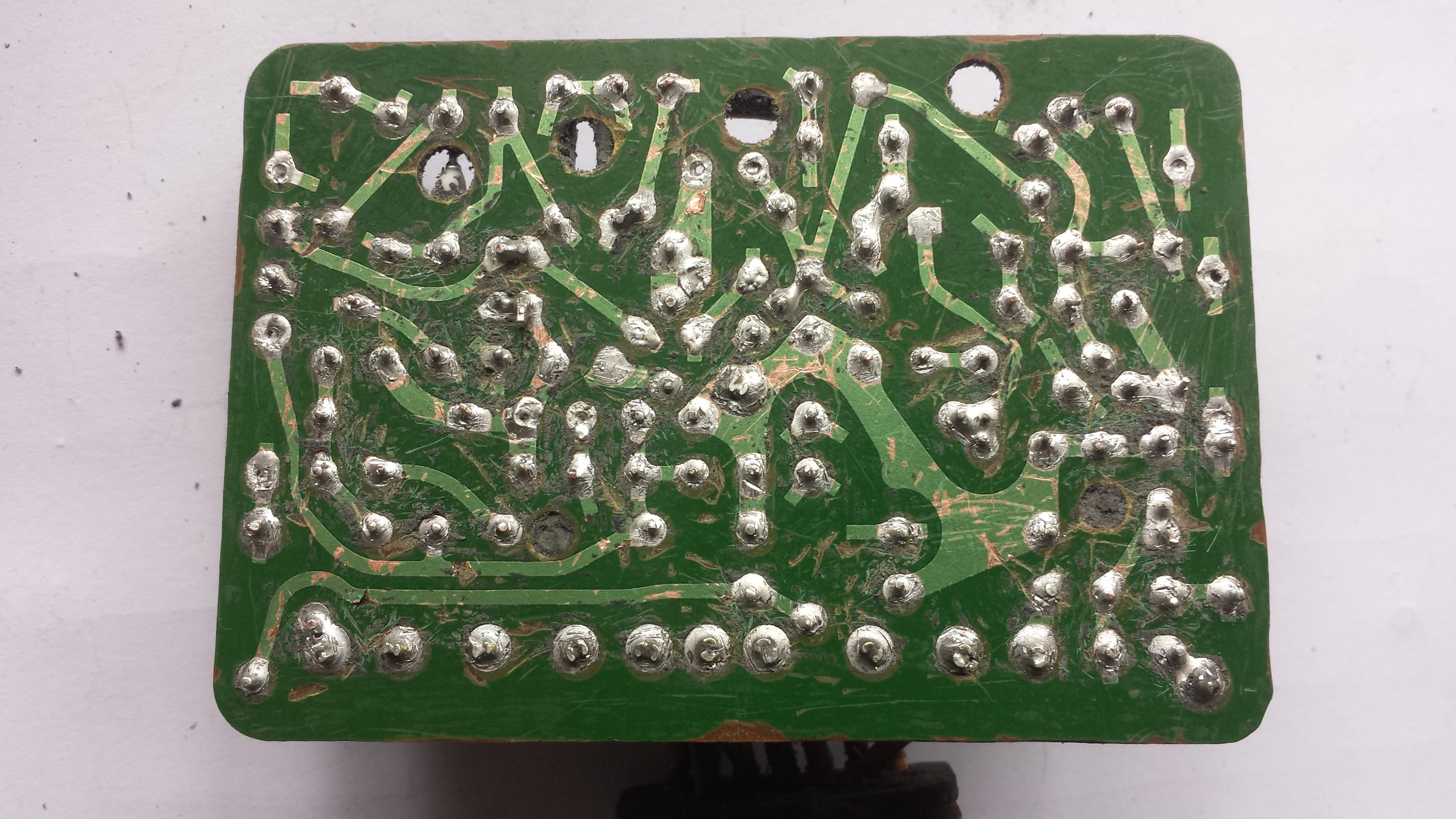

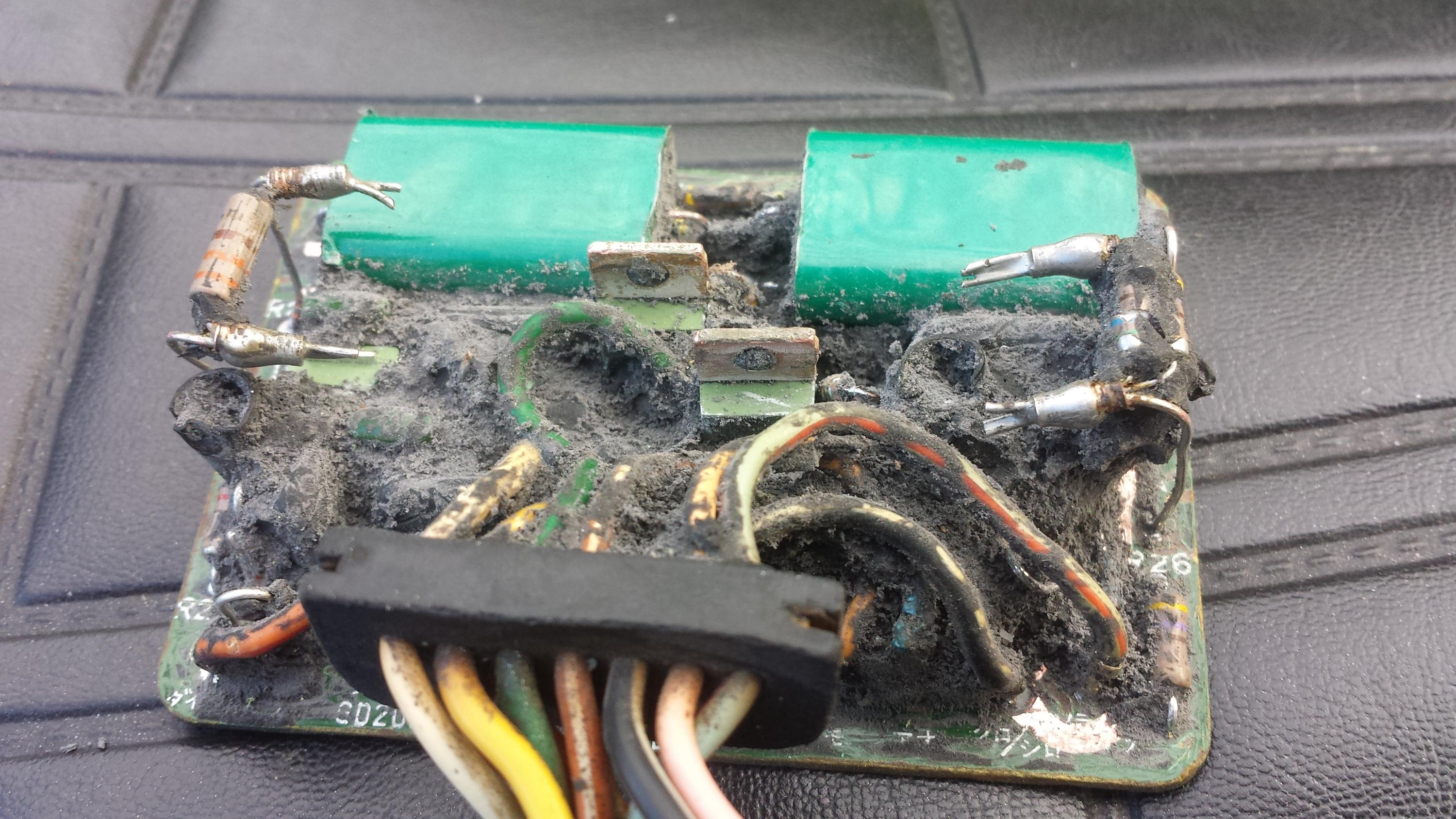

    Hi everyone. Not a old computer monitor this timer its something a bit different.
    This is a CDI ignition unit from a 1980 Honda CX500.
    In 1980 all Japanese bike starting replacing the mechanical contact breaker points ignition system with these fully electronic Capacitive discharge units. But trouble is like all electronic components they fail with age and these CDI units are are no longer available. That's progress they say ??? Luckily I found a second hand one thats still working miraculously so can use that to get readings from.
    Not just that but these CDI units are placed in a steel box and then filled with a resin sealing them tight inside and away from water ingress. I was lucky this one had a slightly softer resin that was almost rubbery and I found I could pick at it with model knives and tiny screwdrivers. It took me 2 days to get it out and then pick away at it to reveal all the components. Many say the main reason these things fail is poor solder joints and they do look a bit rough.
    Well It was inevitable that a few things might get damaged removing all that resin and I broke 4 resistors and slight damage to one diode and one capacitor,
    Here are some photos of the unit at different stages.

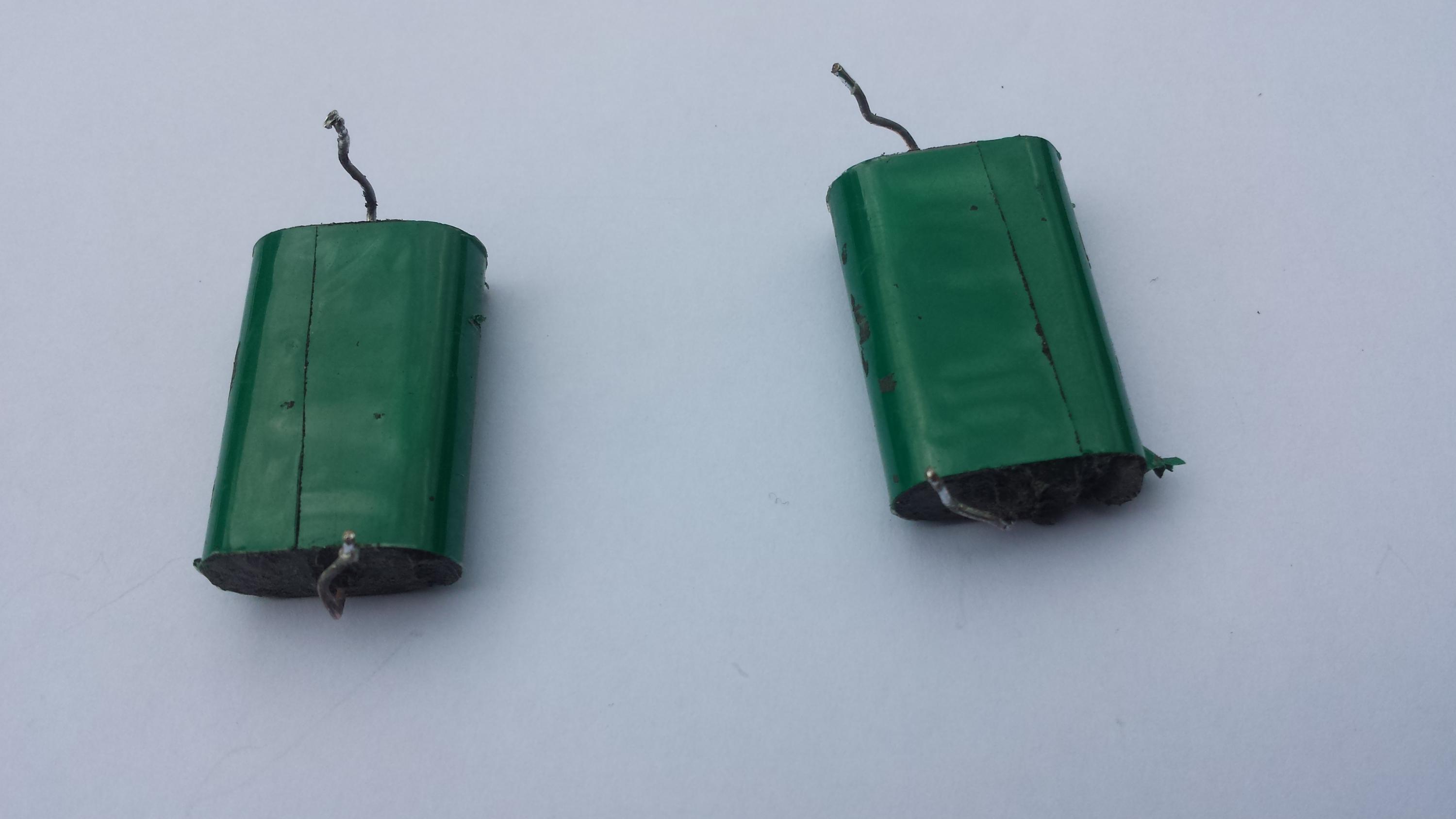

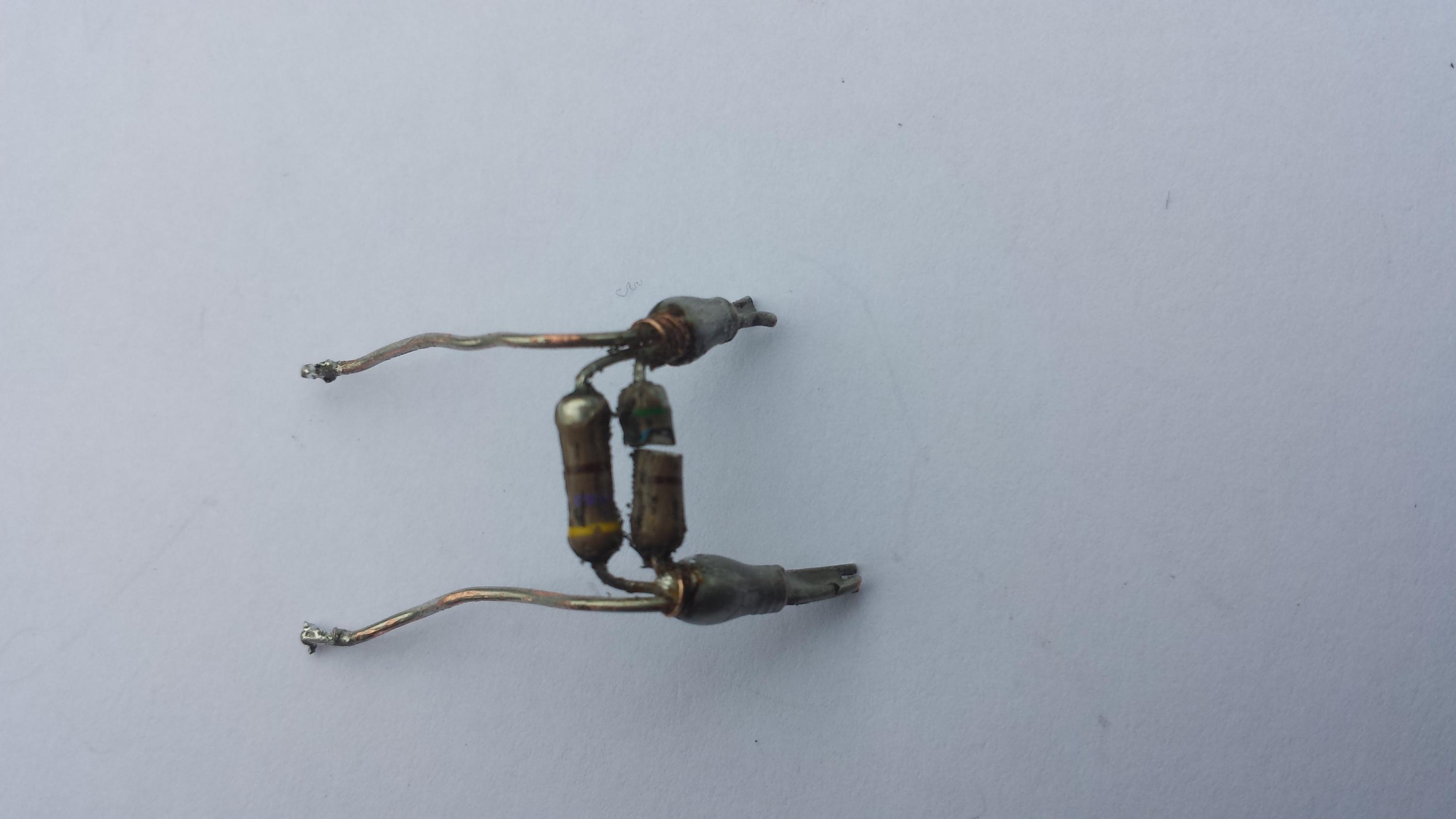

    At each end of the board there was a strange twisted wire resistor thingy I have no Ideal of its purpose. There are a few transistors also but they have no markings.
    I managed to remove the resin from the bottom of it revealing the printed circuit as well.
    Please can anyone help me identify any of these parts apart from the obvious resistors etc. None of the caps are marked either but there are no electrolytic ones.
    I removed the two main output Capacitors to get access to the components underneath.
    Please please help guide me to getting this rebuilt with the faulty parts replaced as its the only way this bike will run when this current still ancient unit I am using also fails.
    I have uploaded more pictures at https://drive.google.com/drive/folde...2s?usp=sharing

    some copper traces look damaged .
    did you try petrol to remove the gloop ?

        Yes I noticed there are a few myself. There are also a couple that look like broken tracks but they are not because if you zoom in you can see the green lacquer in the area that looks like a crack.
        I am still puzzled what those 2 strange resistor structures are at each end and what they do.

          Can you enlighten me stj as to the purpose of these 2 resistor structures and each end do.

            am guessing they run hot

              I have helped people reverse engineer these, they can get weird because of the Japanese design and the many patents that were out there back in the day.
              What part numbers do you have for it? Usually other engines got the same (family) of module. It's a lot of work to recreate one.
              The oddball resistors up in the air are likely for setting the ignition timing advance curve for the module, to match it to the engine and its crank pickup. The PCB shows one as R2 trimpot but the factory just soldered in those parts.
              The green TO-220 parts are likely Hitachi SCR's. The green HV caps around 1.5uF 400V.
              Drawing a schematic is the first step, it's mostly the same circuit 2X.
              I don't know the bike's wiring, if it's an exciter coil plus trigger coil or what.
                • 31305
                Re: Motorcycle CDI ignition unit
                the resistor stacks could be a heat thing, was this in an aluminium shell?

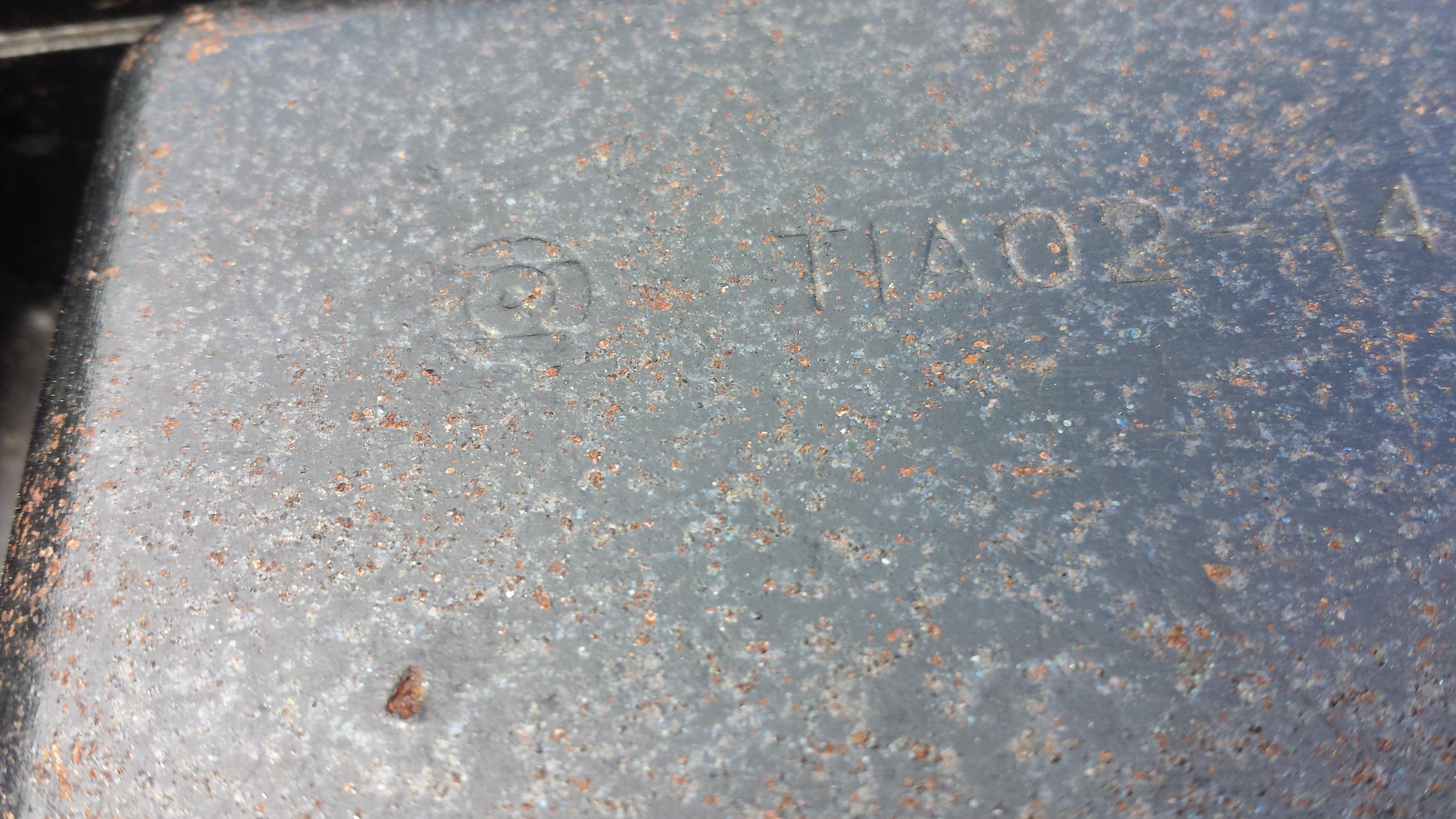

                  I believe that this is made by Hitachi and has a part number in its case TIA02-14.
                    No this was in a steel shell like this

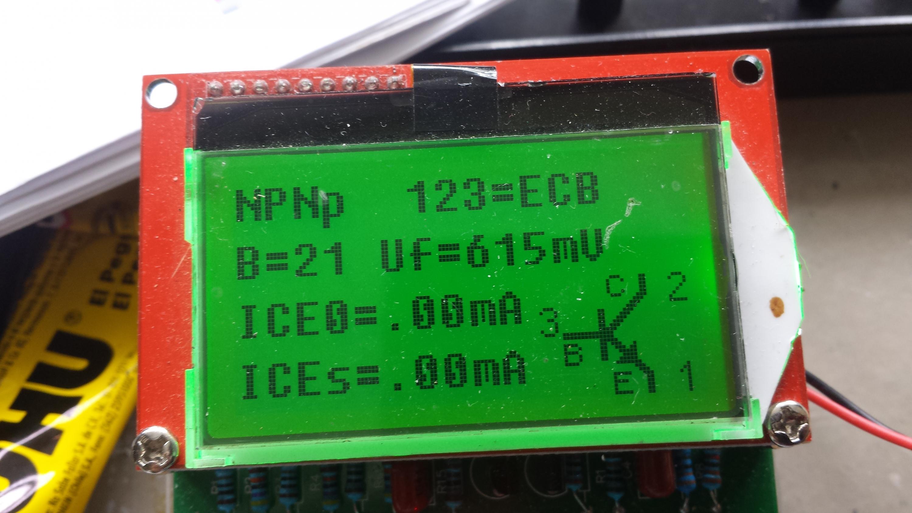

                        put the green to220 devices in a component tester

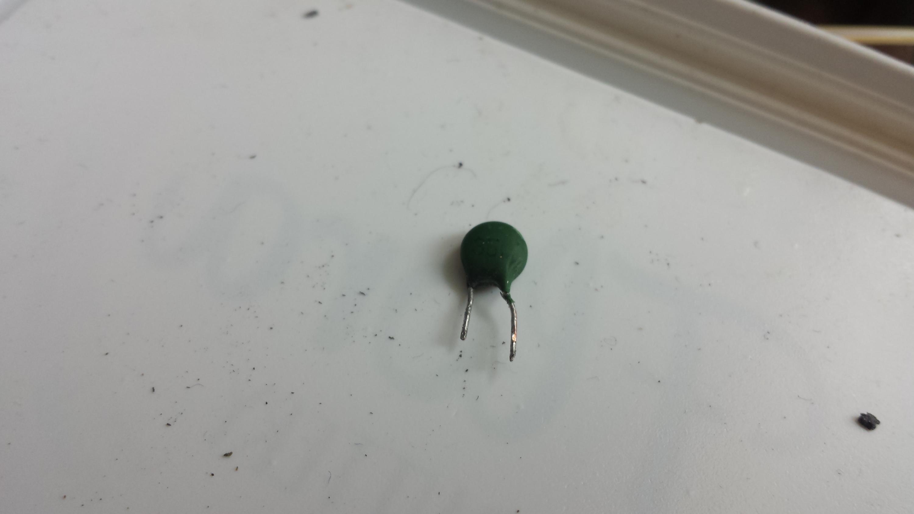

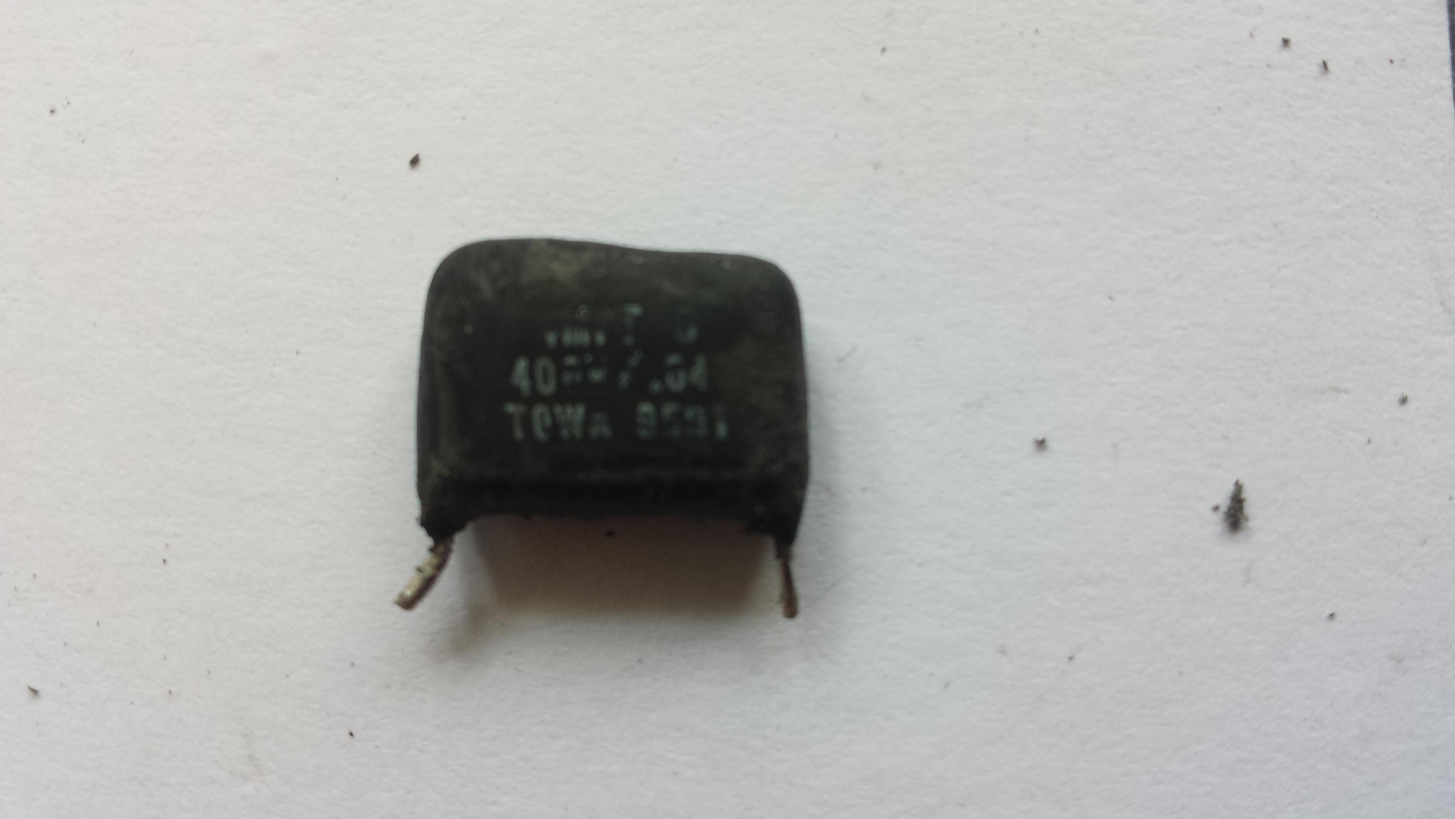

                          also have this little green thing that looks like a ceramic capacitor and has the number 351 on it. My component tester says it's resistor with value 331.4 ohms is this right?
                          There is a diode to that's tests ok but is this any special type? It has the markings 100 76 and 1R

                                351 could be a cap or a temperature sensitive resistor of some type to limit current.

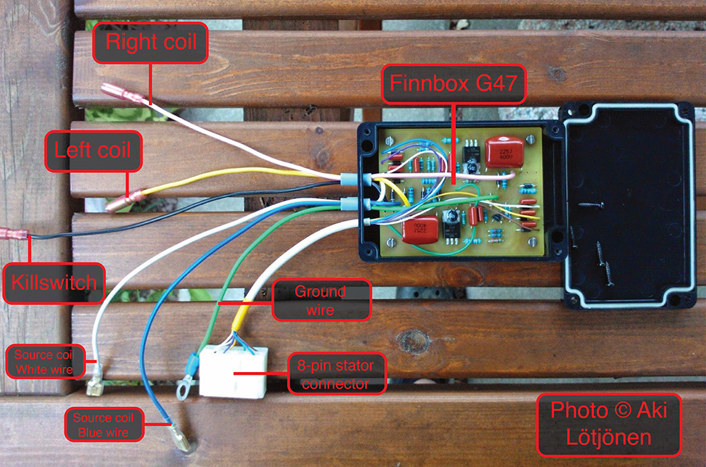

                                  • redwire
                                    • Dec 2010
                                    • 3912
                                    The tricky part will be the thermistors. You would have measure their resistance at a few different temperatures to find something that matches. As the SCR's heat up, their sensitivity goes up and the thermistor lowers how much gate drive they get.
                                    I did see a remake of the box called Finnbox G47, the thermistors are on the SCR's tabs.
                                      • 31305
                                      maybe re-designing it to use mosfets is the answer.
                                      or darlingtons
                                        do you have a wiring diagram for the bike btw?
                                        yes here is what the tester says.
