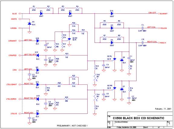

      I got an email response from the Finnbox G47 maker:
      "Sorry to tell but I haven't made any cdi units for a long time. The schematic is the thing which I keep with me. It's not very complicated but unfortunately it's the most important part of the process. I think I have told enough in my blog how to make one."
      So either we make a PC board or leave it.
      OP, take your original PCB and check behind a bright light for knife cuts to the traces, from cutting off the potting compound.
      The UF5408 is huge, it won't fit and slower 1N5408 was on the first prototype, then all changed to 1N4007. The HV coil is 430R nominal so it can't put out even 1A. The KILL switch just shorts out the coil.
      My change would be some to faster recovery diodes or a little more 2A for the high voltage section.
      Japan in the late 1970's did not have great HV semiconductors. Here there are three 600-800V diodes in series, giving 1,800-2,400 PIV which is quite high and slow at 3usec.
      The heatshrink just has some resistor in it, to prevent shorts to the resistor next to it. The green thermistor is nearby on the board.

          I did translate it and read it but it's some Rev. 1.2
          I can't make out some resistors values. Other schematics have errors. Sigh.
          R21 - goes to D12/C8 left TDC rtd, then to SCR-L gate, maybe 910R?
          R19 - goes to D11 right TDC, then to R26, maybe 180R?
          These are by where the wires come in and not in pics.
          TH1, TH2 - thermistor, maybe 500R?
          I don't see the point in reverse-engineering the box, posting pics on your blogs, youtube and then not giving out any schematic or parts list, if you're not going to make and sell the replacement modules? Am I wrong? Then you do improvements and post nothing specific.

                        For reliability, I would have a hard time using the original PCB.
                        I can lay out a new PCB, it's not that difficult for me. I've figured out all the parts. It doesn't all need to be potted. Like the Finnbox, a bare PCB and waterproof plastic box is good. Just the wires coming in and out need to be sealed up. Keeping it the same as the original design but better new parts. Let me know what you think.
                        About replacement parts:
                        The thermistors are the green disks marked "351" and not able to get. They are Hitachi 350 ohms at room temp. It is possible to substitute 470 ohm part such as Vishay NTCLE100E3471JB0, if the 82R is changed. Popular size MF52 or MF11 thermistors hard to find below 1k ohms.
                        The "351" should go from 350 ohms up to around 770 ohms when cold in a fridge, but touching it will warm it up fast. Freezer should be above 1,000 ohms. It's not important, I figured out the temperature compensation.
                        The SCR's: BT151-500R (NXP) 500V 12A which is popular for CDI but obsolete now, I would use ST TYN612RG 600V 12A.
                        The smaller TO-202 SCR is apparently the rev limiter. I think an ST X0402MF would work, 4A low voltage is fine. Finnbox went so small to a 1A TO-92 part I would not do it.

                            The weird part is the Left and Right cylinder have different SCR-firing circuits, as far as the gate drive (resistors). The pickup coils are supposedly the same between Right and Left, so this leaves me puzzled why no symmetry. I can't get values for R19 or R21 from anyone's pictures.
                            The semiconductor shortage is affecting some SCR's. I see some ST parts out of stock until October at Mouser and Digi-Key. On a new PC board I'd go with D2PAK parts because they can run cooler with a little copper pour. Anything that sticks up high on a PC board can't take vibration and eventually breaks off, so SMD is better I think than TO-220 up in the air.

                                  Original can is 92x65 by 45mm deep.
                                  I am having trouble locating R19 but if the one I think is it then its as follows.
                                  R19 =180 ohms???
                                  R20=610 ohms.
                                  R21=910 ohms.

                                      The heatshrink tubing is just insulation to prevent the part from shorting to parts next to it.
                                      The CAL resistors are the ones sticking way out on pins past the edges of the board.
                                      From your pics R20=220R (in the heatshrink) which matches other people's pics. Not 610R which does not exist as a EIA E-24 value. Where is that from? Who is 610.
                                      The rajamolor schematic is so hard to read, R21 is referenced twice (one by CAL R24 and then one by R20 as well) looks like it is 110R or 910R. Can you check if there are two resistors getting mixed up.

                                        OMG Sorry Redwire that must have been a typo as your right R20 is red, red, brown, gold=220R.
                                        Your right about the schematic being awkward to read. R21 is shown twice on PCB near R24 and its also next to C2. Oh and R19 is definitely 180R
