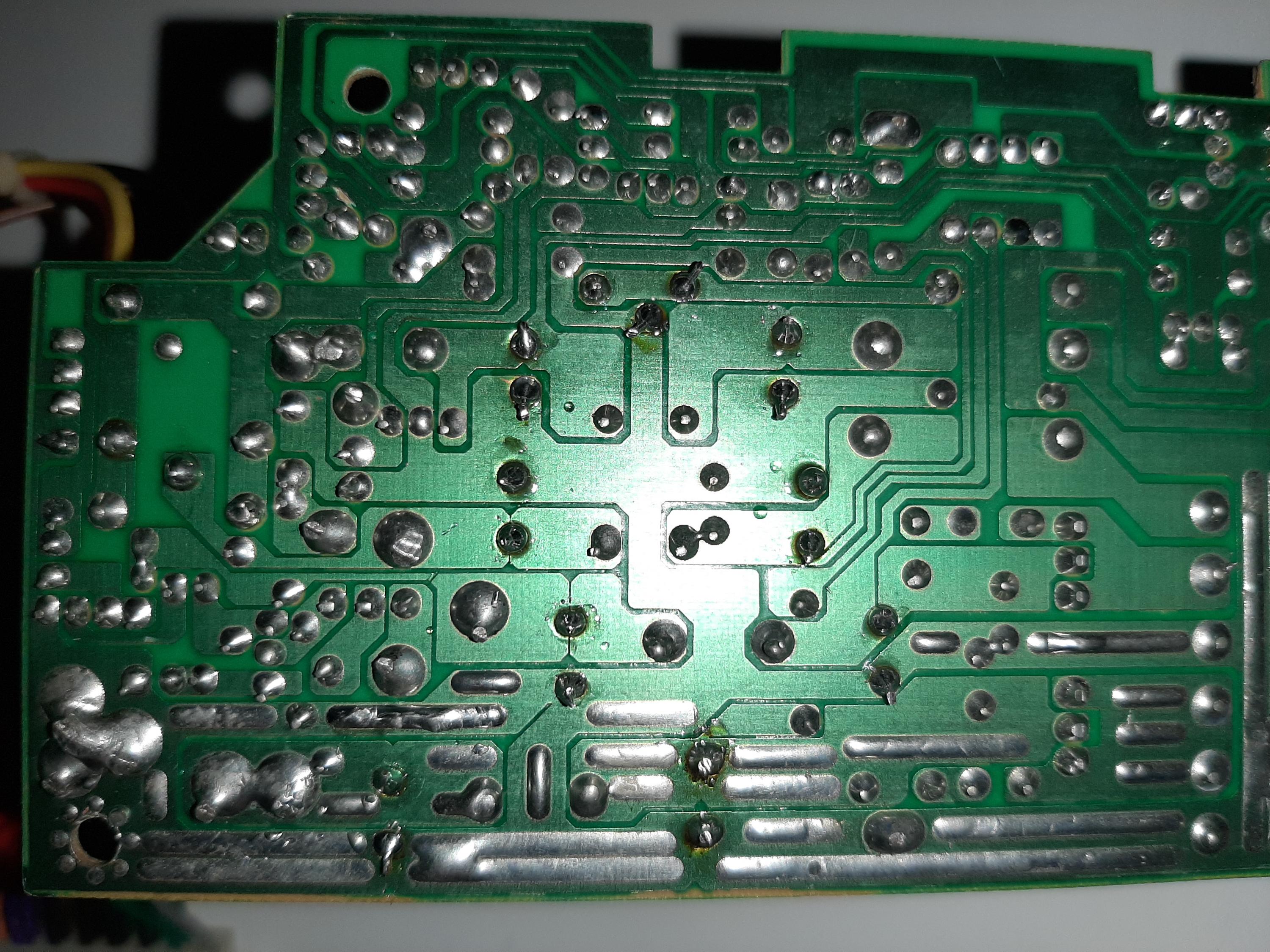

            Re: Xbox has low 12v, cause?
            Originally posted by momaka
            Yeah, to be 100% honest, the PSU does look like a crap design. But before we conclude that completely, could we also see some pictures of the under(solder)side so we could try tracing the PSU circuit?
            Hi, sure: pictures are attached.
            My only hope is that the TO-220 component by the orange wire is some kind of a regulator for the 3.3V rail. On that note, since I'm not 100% familiar with these old Xbox PSUs... are the wire colors indicating the voltage rail like on PC ATX PSUs? (i.e. yellow = 12V, red = 5V, orange = 3.3V, and purple = 5VSB??) If so, that could help me trace what's going on with this PSU (and with the solder-side pictures, of course.) But I suspect it may be a crap design to begin with. Let's see, though.
            Yes, same as with PC PSUs. I think you can even use a PC psu, but the pins need to be switched as a Xbox uses different pinout.
            I'm looking for a broken Xbox right now to swap out the psu, perhaps I can extract the new capacitors from this supposedly thrash psu and use them there. Still, I'm very interested in if this psu is in fact bad, the reason for it being bad and how to spot bad psu's like these! Heck, maybe it output the bad voltages all these years without me ever noticing?

              looking at the pics,
              resolder the transformers and check that the parts on the heatsink arent electrically connected to it - one of the thermal pads looks questionable

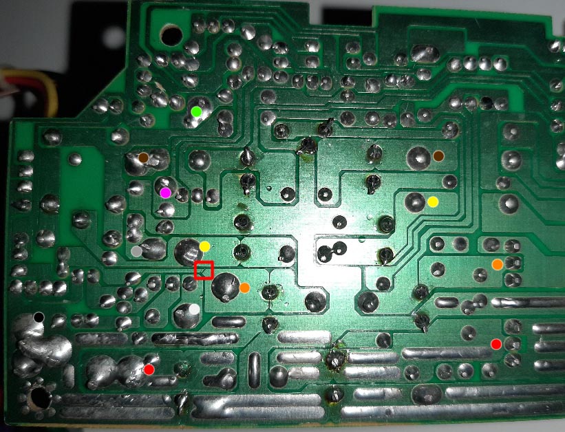

                OK, so looking at the pictures and analyzing the PSU, I noticed a few things.
                But before I mention anything else, first please look at the attached image in my post.
                I put a red square box around a trace that looks broken. Please check that and let me know what you find.
                As for the rest of the colored dots... these indicate to what rectifier the wires connect to. On that note, check the solder joints on the TO-220 rectifier (attached to the heatsink) for the 5V rail (i.e. the one close to the red dot in the lower right corner of the picture.) I think I see some crack rings... though that might be just the picture too, of course.
                  Good eye, but it was some flux from the solder wire.
                  True, was in the picture only. I don't see cracks.
