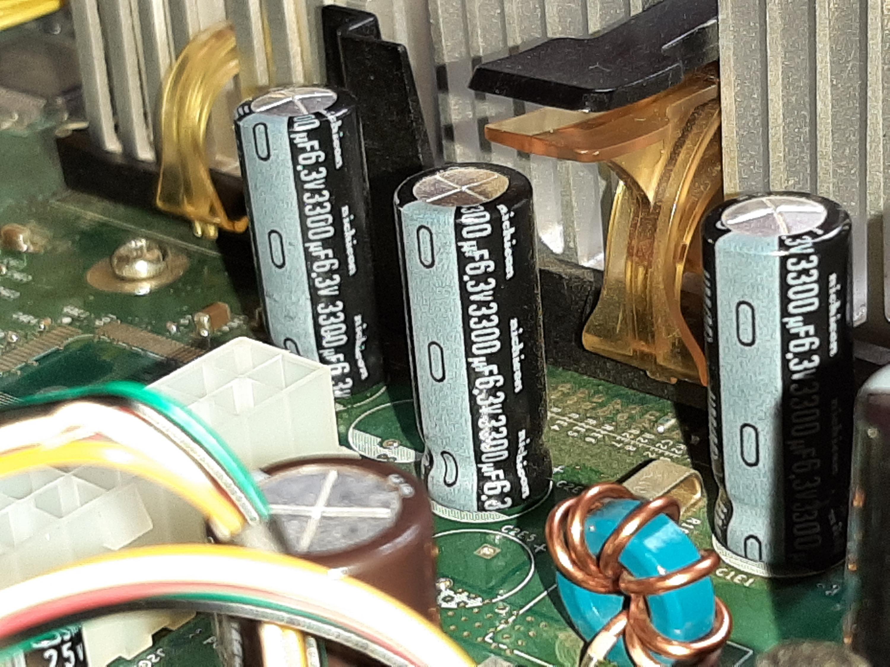

    I noticed two bulged capacitors near the CPU of the Xbox. See attached photograph.
    C3E2 3300uF 6.3v (bulge)
    C2E4 3300uF 6.3v (middle one, this one has flat surface)
    C1E1 3300uF 6.3v (bulge)
    Regarding the power supply: 15 years ago lighting struck the house and got into the Xbox and I replaced the power supply (which was blackened) with another one. I did some searching today and found out it: https://www.aliexpress.com/item/32298095875.html (Chinese).
    My question is this: could the two capacitors near the CPU cause the low 12v? Or, is it more likely caused by the PSU? I don't see any bulged/leaked capacitors on the PSU. But then again, I am a total newbie with this.

    you need a full recap, your 3.3v is high too.
    https://www.badcaps.net/forum/showthread.php?t=78134

        firstly, if you can get an xbox for €5, do it - and fix both!
        99% of xbox faults are capacitor related.
        as for your board.
        you have space for 5 caps at the cpu,
        so fit 1500uf polymers.
        https://www.aliexpress.com/item/32909529195.html
        for the psu, use panasonic FR series.

            the 5 spaces in front of the cpu are all connected in parallel.
            just do the psu and the ones in front of the cpu for now.
            then see if it runs.

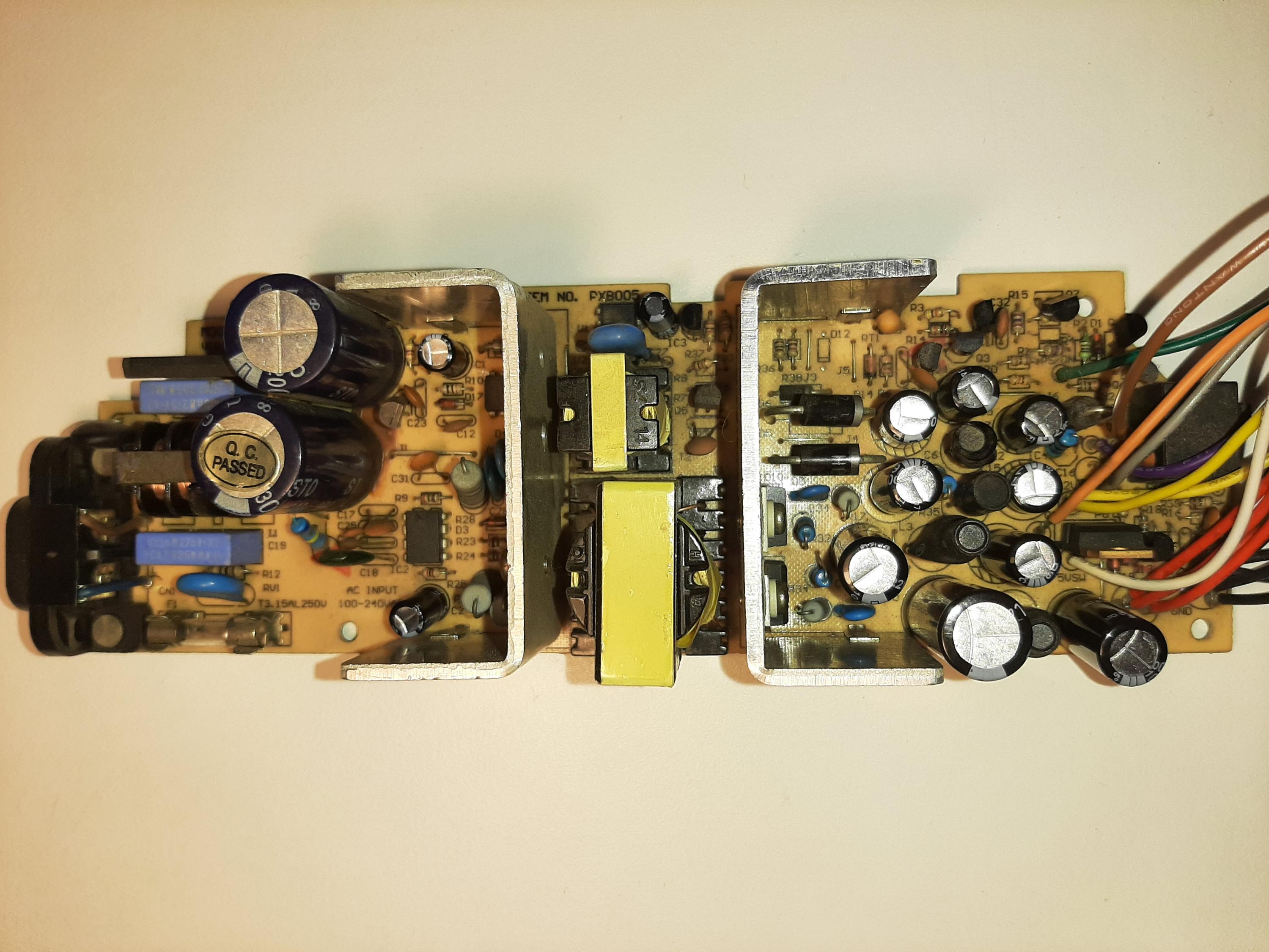

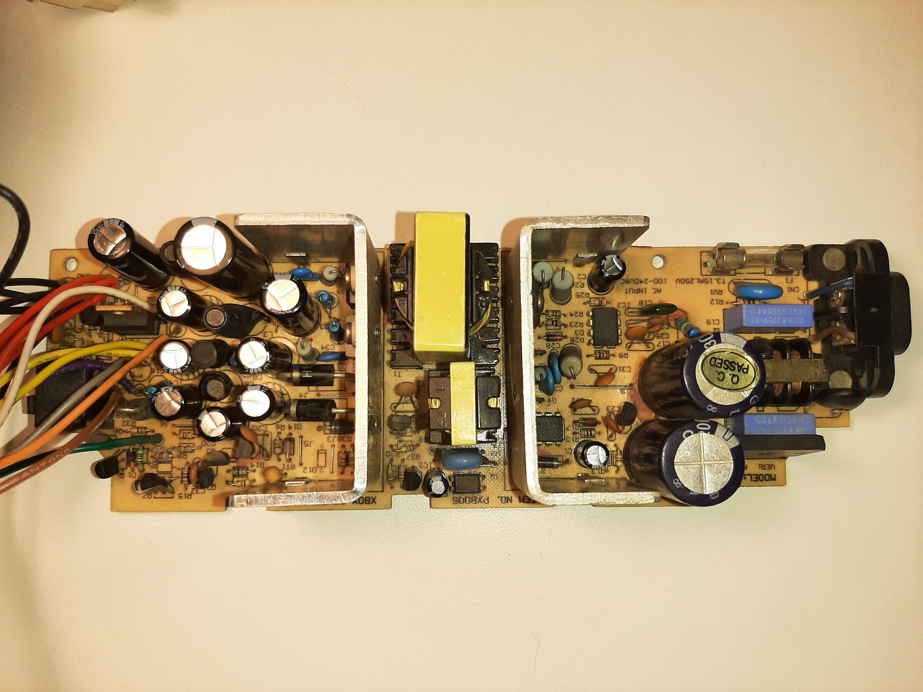

                                      • 31126
                                      Re: Xbox has low 12v, cause?
                                      good pics of the psu
                                      • Justin1091
                                        • May 2018
                                        • 50
                                        • The Netherlands
                                        Here are pictures of the psu.
