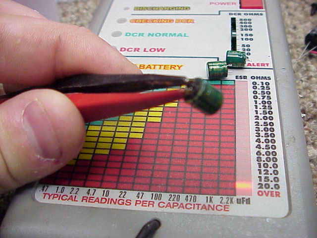

    been seeing a bunch of these bad in ccfl inverters.
    there are 4 paralell 100@25v
    they go high esr/open
    they are the common sanyo green/gold.

    shit what else is next.....rubycon?
    what you think....fake sanyo?

      To some who try fixing these inverters big and small, be aware of not only badcaps but also the very small fuse on the boards.
      Jim
