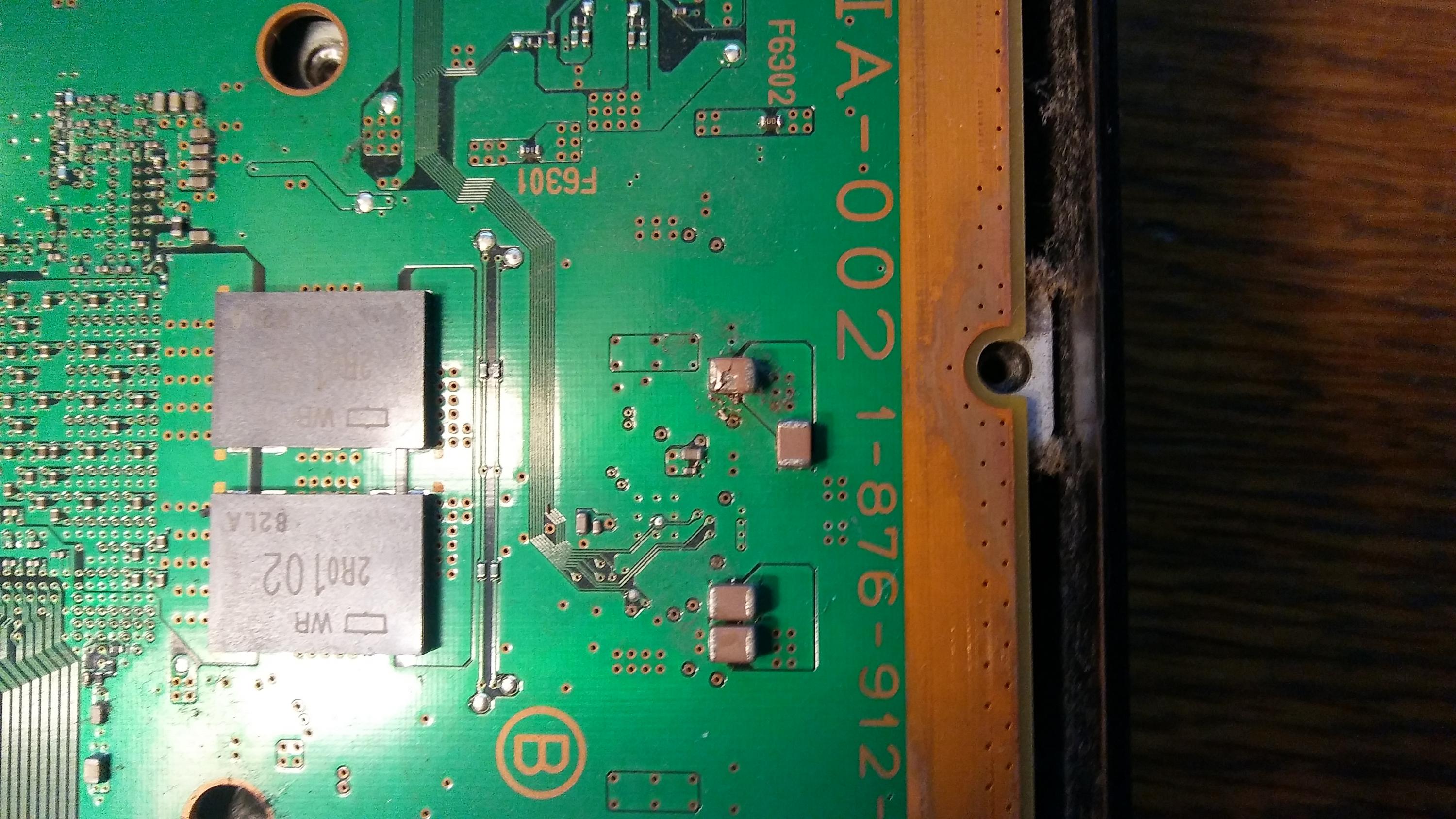

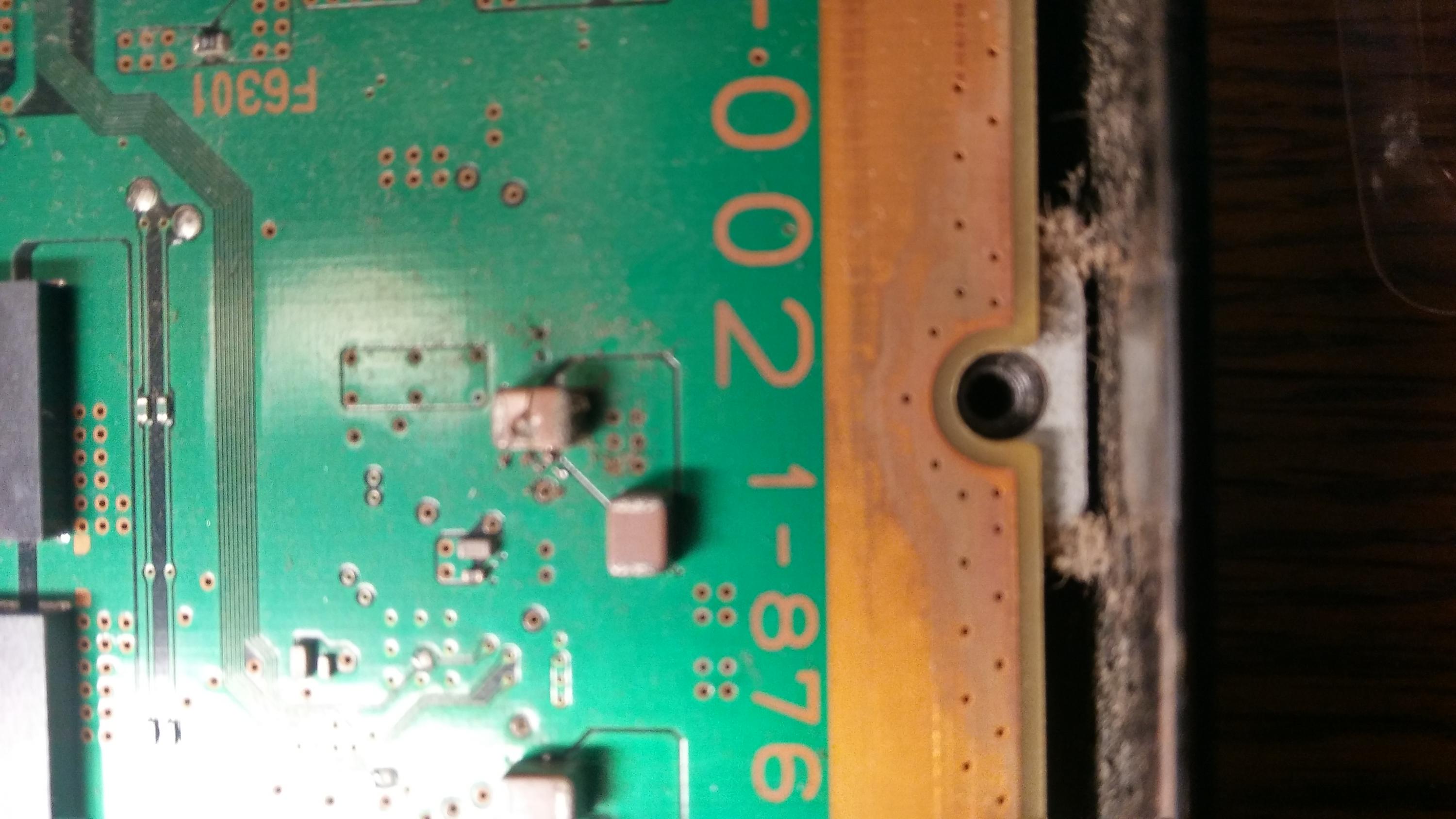

                Re: Ps3 fat Cechk04 no power
                [/ATTACH]I have tested the psu and 5vsb and 12v is there so the problem lies on the main board and found this,are they capacitors?
                  • 31200
                  yes, ceramic caps

                    #29
                    Thanks stj,but where do i find the value of the cap
                      • 31200
                      #30
                      meter a good one.
                      it will probably be o.k. with one missing anyway - so just removing it is o.k. for testing
                        • 31200
                        #31
                        it is:
                        22uf 16v X7R dielectric in a 3225 size

                            #33
                            i removed the cap now and tested it,it comes on and has the green led and blue led and gives 3 beeps,does that sound right stj
                              • 31200
                              #34
                              cant remember, it does different things if for example the settings are corrupt because you took the battery out for a while.
                              hook up a hdmi cable and check the screen - any usb joypad can be used
