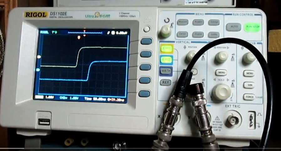

      Well by that I mean a knock off of a knock off, there are differing grades of knock off lol anyways these seem to work well enough for me. I recently purchased an unused Rigol digital storage scope on the cheap in the event this one was not repairable, it came with a two sealed sets of probes so I can always compare and contrast.

          Its a DS1102E 100 mhz digital scope so probably an older model, though I did not pay much for the unit, seems previous owner got it, looked at the manual and gave up. The probe kit supplied is indeed a PVP-2150 and feel rubber coated so maybe the unit is newer than I thought. Either way it will be cover most if not all I need it for and its size makes it all but ideal, if it had a battery pack it would be ideal in every way. Now there is a thought.

                MMmm given the low power requirement of the scope it might be easier to cramp a lipo pack in there along with a 240v inverter depending upon how much space there is in the back. From the review quite a lot it would seem. Anyways it is one of these and am kind of interested in what this will go upto so I may well hook it up to the sig gen and give it some exercise lol. Thanks for the links by the way.

                  Well I am sure you are all holding your breath for what its good for,
                  Well on a fluke 6060B, at maxed out at 1.9volt RF (which is about all this thing produces)
                  Very good upto 100mhz
                  Good upto 150mhz (you proabbly would not want to rely on calculating frequency)
                  More or less good upto 200MHZ some vertical drop off and a little more jitter
                  Usable at 250MHZ as long as you don't want to take any measurements from it, waveform looking a little weird in places
                  And the money shot, well it craps out at 300 MHZ waveform looking very ugly.
