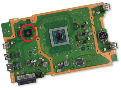

    Good day folks. Pretty difficult problem here and I was hoping those more knowledgeable with consoles can provide some input, since the internet was of no help and I couldn't find this issue anywhere else, plus I haven't exactly messed around with PSs before: I've got this PS4 (slim?) here which can't hold on to its date and time settings. It loses them as soon as you remove mains power, like a cheap digital clock when it's unplugged. If you leave it plugged in, everything's fine. Checked and replaced the CMOS battery inside - no luck. Measured the resistor+diode assembly that follows directly in series with the battery, but that was as far as my knowledge got me there. It all looks good - battery voltage makes it into the board. The board says SAE-004 on it.
    I took some pics as well, but haven't got a cable to upload them right now A colleague of mine also suggested the SPI chip might be bad. We managed to identify it, it's a 25Q256, but it's a flat SMD package and we don't quite have what it's needed to read/write it....plus I'm not sure we'd have something TO write to it in the first place, unless we could get away with copy/pasting the contents of the existing chip onto the new one in hopes the current one has got bad blocks. I think what's happening is the date/time is stored in some sort of flash memory when power is available and when mains power is removed, it's supposed to get stored somewhere, but this is not happening for some reason. Interestingly, the time ZONE settings remains intact to what you set it to - presumably it's stored in some other place and it's only the RTC part that's busted in some way. Any ideas ? Thank you.

    did you check that the power from the battery reached the chip?

      Re: PS4 loses date/time settings every time
      No, must admit I haven't done that. I didn't quite get to mess around with it at my own pace - my colleague did most of the work, but now that I think about it, what you suggested makes perfect sense. I'm guessing I should see battery voltage at the VCC pin of the Flash SPI.
        um, no.
        why would you have battery power at the flash?
        the clock is in the main chipset.
        it will go to a big bga chip - a givaway is it usually has a 32.768Khz crystal.
          My bad...
          This might mean the bug lies in a much "bigger" component after all...
            the timezone etc is stored in the o.s.
            the callender, clock and some extra cmos ram are integrated into the chipset itself.
            i'v seen this with a few industrial motherboards that are used in contaminated enviroments and it's always been a corroded track, via or small part like a resistor or capacitor.
            just follow the track from the battery till it reaches the chip with your meter set to ohms/buzzer
            btw, if you set the time, and when you power up again, it's not reset but shows the time you put in then suspect the crystal or it's capacitors.
              Yes, if I leave it plugged in and reboot, the time is still corect.
              There's also some other issues with this console: one of the USB ports is not working and it's also got some issues connecting to PSN - some error code shows up every time despite setting the correct date/time.
                then check the usb port tracks too - there maybe be damage in a common spot.
