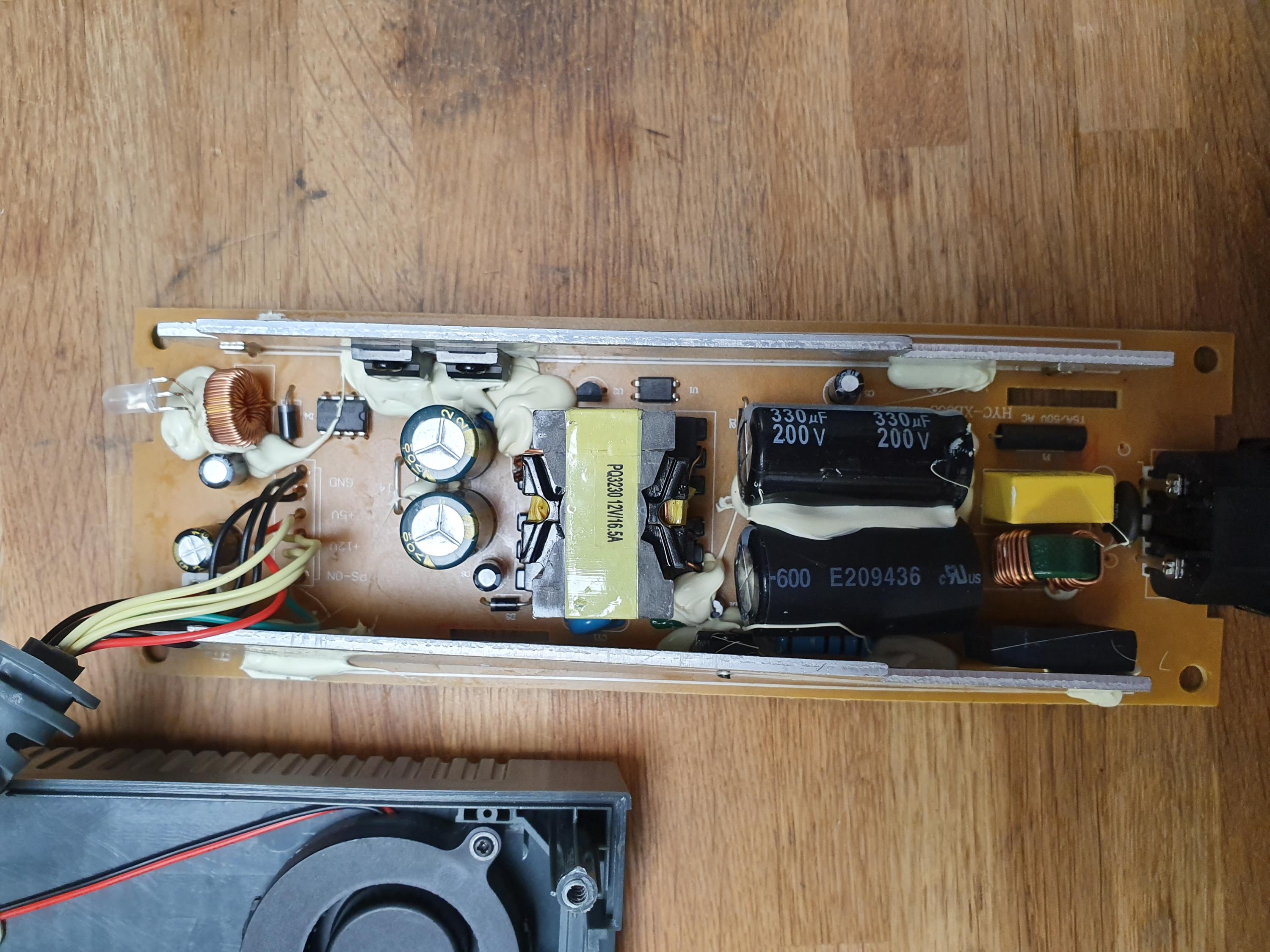

Turn 100v X-box 360 adapter into 250v
  • playman
    • Jan 2011
    • 252
    Somehow I managed to buy my self a US version of a X-box adapter when
    I wanted a EU version.
    Is there any chance for me to "upgrade" it from 100-127v to a 220-250v?
    What would I need for that?

    Re: Turn 100v X-box 360 adapter into 250v
    there might a possibility to change the big caps to 400v ... but wait until someone else chimes in .

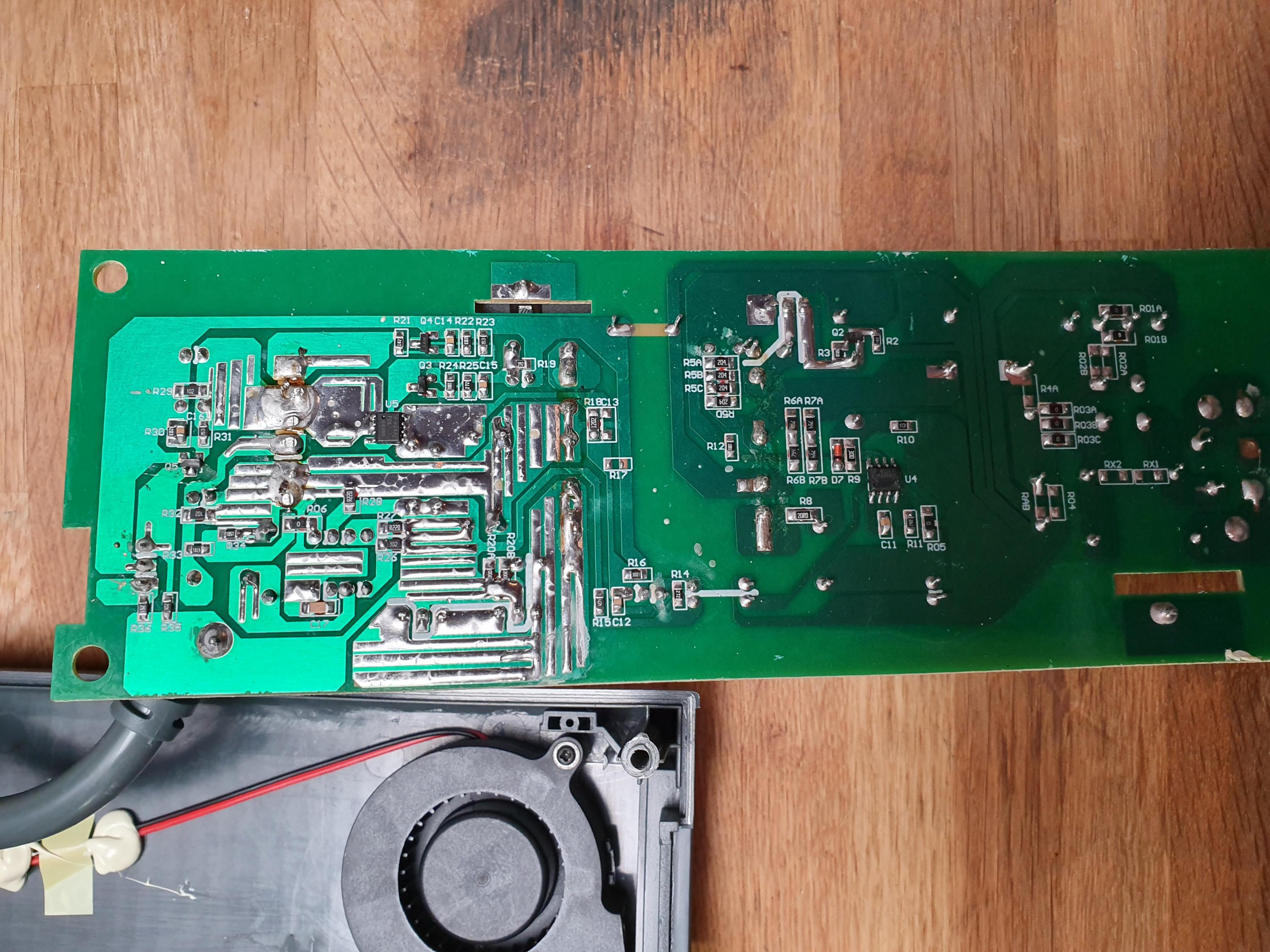

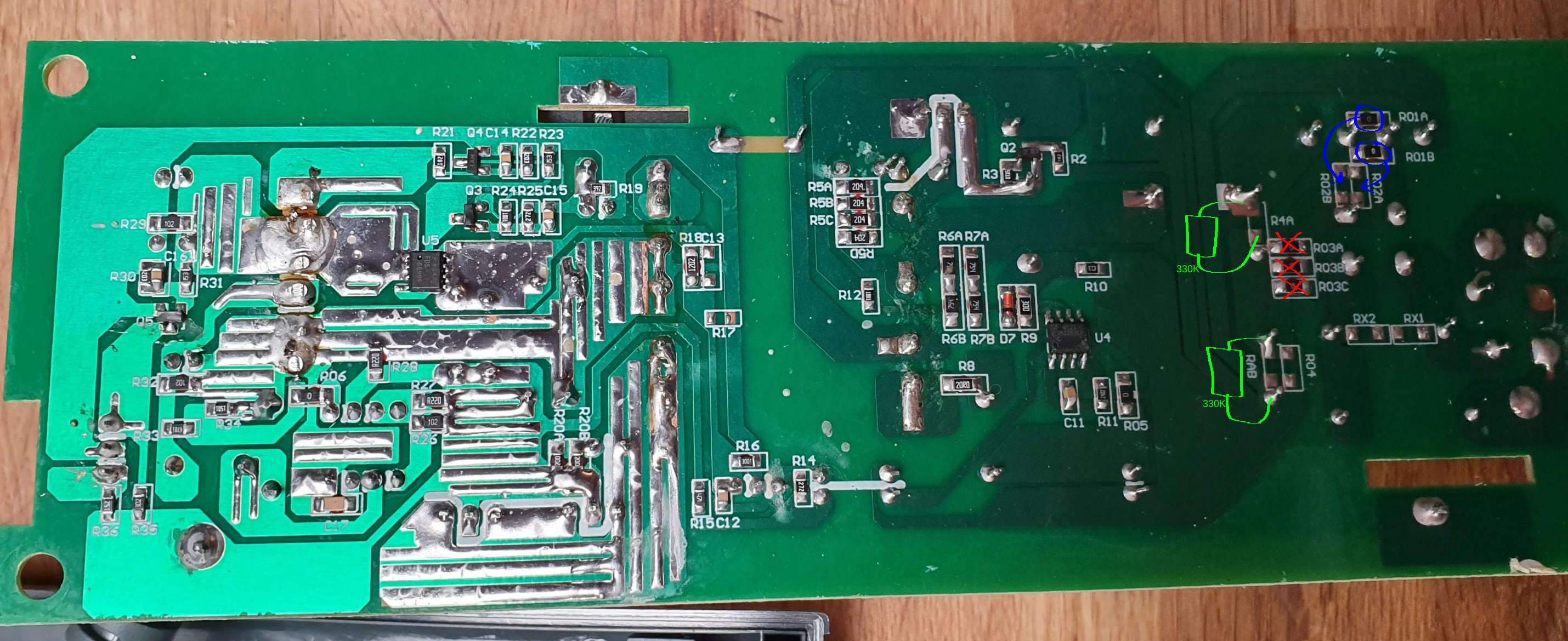

      100% your responsibility if it explodes as I am not the designer of this, I just hack things to work.
      1. Move R01A and R01B to R02A and R02B, respectively.
      2. Remove R03A, R03B, R03C and bin them.
      3. Install two 330K resistors in positions R4A and RAB
      I think that's it. The picture is really hard to see, wish it was a little better quality.
      And the disclaimer: if it explodes, you keep the pieces of capacitors, NTC, fuses, wires, circuit traces, and burned down house. Not my fault. I hereby warned you about this and it's the standard disclaimer you see on all websites.
        not exactly what I wrote but functionally equivalent
        red=remove
        green=add
        blue=change

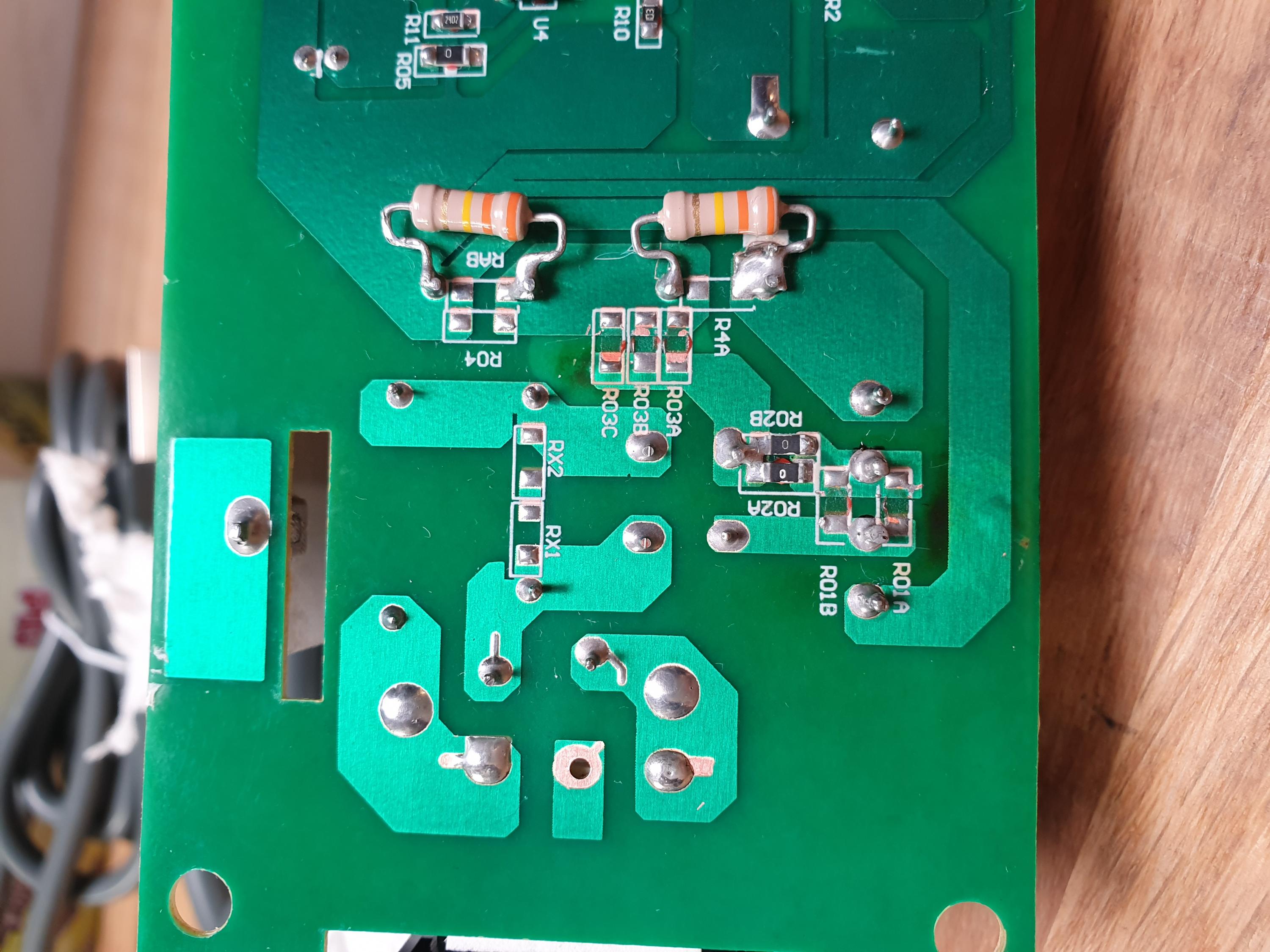

          Is that all? just those few items? No need to replace the 200v caps or the transformer. Did not expect changing from 120v to 230v would be that easy.
          I did do as you said, included the picture of the work.
          Also here's a link to high QL pictures of both sides, hope they are good enough, if not let me know what you need. These pictures were taken after the change.
          https://drive.google.com/drive/folde...Ax?usp=sharing
          If that's all then it's just to plug it right into the wall and hope the best?
          Did not expect any one else then me to take responsibility for those changes

            use a series old fashioned light bulb first on mains supply ..100w should let it start up .
              Yeah DBT would be good.
              Well, assuming the device was working, yeah it looks okay. Just make sure that yellow capacitor is rated for at least 275V, if it's only rated for at least 250V it may be fine. If it's less than 275V you may want to just remove it, definitely remove if less than 240V.
              Good luck!
                BTW you may want to insulate the resistors some more if you want to be really safe. I suspect the pads were for surface mount and not have wires jut out close to the other rail. Air resistance gap should be sufficient but can't hurt to have added safety.
