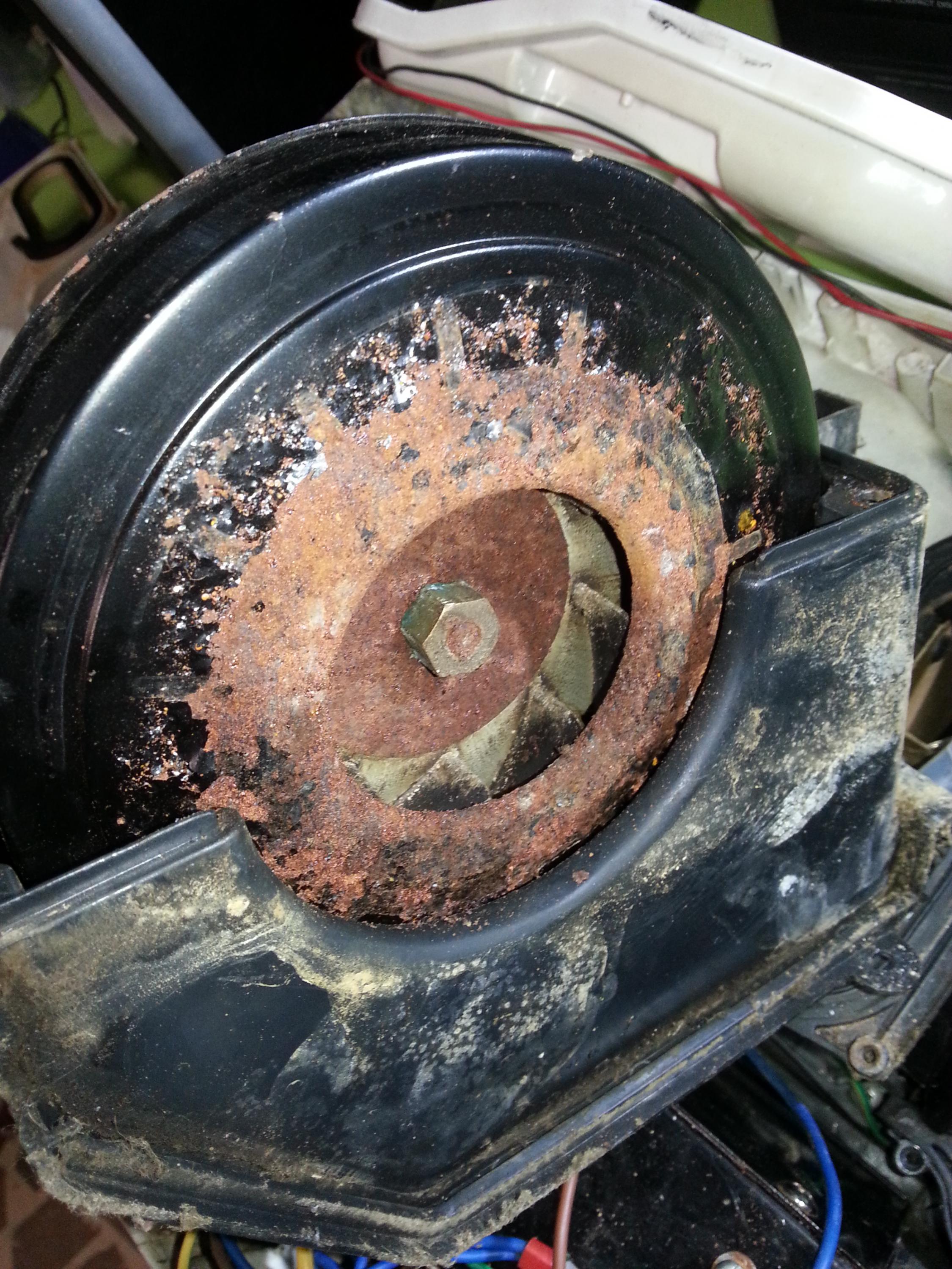

    Good day folks. A few days ago I had the misfortune to be assigned a hand drier, the vertical type with a slot at the top where you insert your hands and a jet of air on either side blasts away the water. This thing was a nightmare to work on and it's stuff like this that makes me hate my job: very dirty, disgusting ! They didn't even have the courtesy to let it dry before plopping it on my desk....dirty water dripping out of it, mixed with bits of dust, hairs and dirt, limescale everywhere, a pungent moisture smell....horrible experience ! The type of thing you would only give to a greenhorn to work on when you don't feel like doing dirty work...most annoying ! Adding to the frustration was that many of the screws were rusty and stuck in place, so just opening up the thing was not enjoyable in the slightest...
    Getting past the ugly nature of the job, the actual problem came down to the motor itself which is far past f***ed (see the picture): moisture got sucked up through the bottom, into the whole machine, causing many of the metal parts to rust, including the impeller blades and part of the motor housing as you can see. The expansion of the rust actually caused the impeller to weld itself to the inside lip of the cover there ! I have no idea how it could've possibly ended up SO bad inside - you wouldn't think leftover water on hands can do this sort of damage, especially since it's (SHOULD BE !) designed to be immune to moisture...it's like they left it out in the rain on purpose just to screw with me...
    It's also one of the most overkill and over engineered things I've ever seen...just look at that control board ! Was this really necessary ? It's a hand drier - you just run a motor ! Why do you need a computer in there ?! Amazingly, the board works and was perplexingly the driest part in the whole machine, despite that box just having a POS metal lid with no gasket and no screws whatsoever that was all bent and not fitting properly, because the thing was kicked or knocked somewhere in a bottom corner and a lot of things no longer fit or close properly...*ARRRGHH !! * Stuff like this just made it more and more annoying the more I dug into it and I would love to beat the crap out of that thing with a sledgehammer just because it's such a humongous piece of garbage stinking up my shop and soiling my hands and desk and wasting my time ! !

    When I turned it on, I could hear the rising frequency sweep vibrating the motor windings in the audible range, but it quickly shut back down and returned an error code (yeah, it's got a display at the top - did I mention "overkill" ?). I got the motor out and found THAT....game over, since there's no way you're restoring that, not with the rock bottom equipment we have here. Still, the motor's pretty interesting: it's got 8 wires going into it ! 3 fat ones and 5 thinner ones. In the picture of the control box, the first three are the black, white and red in the bottom-left corner and just above that terminal block there's the other 5...what is this motor ? Is it a three phase VFD-driven motor ? Why all the wires then ? There's a bridge rectifier, two large caps, 6 IRFP460 FETs and a handful of other small components, so it must be a VFD....STILL overkill IMO. Would it be possible to find a replacement for such a seemingly dedicated motor ? Swapping it would be a nightmare, since those wires pass through a moulded plug in the housing so I'd have to cut each one then individually solder them back onto the new motor, plus just the idea of working any further on this thing makes me sick...cheers guys

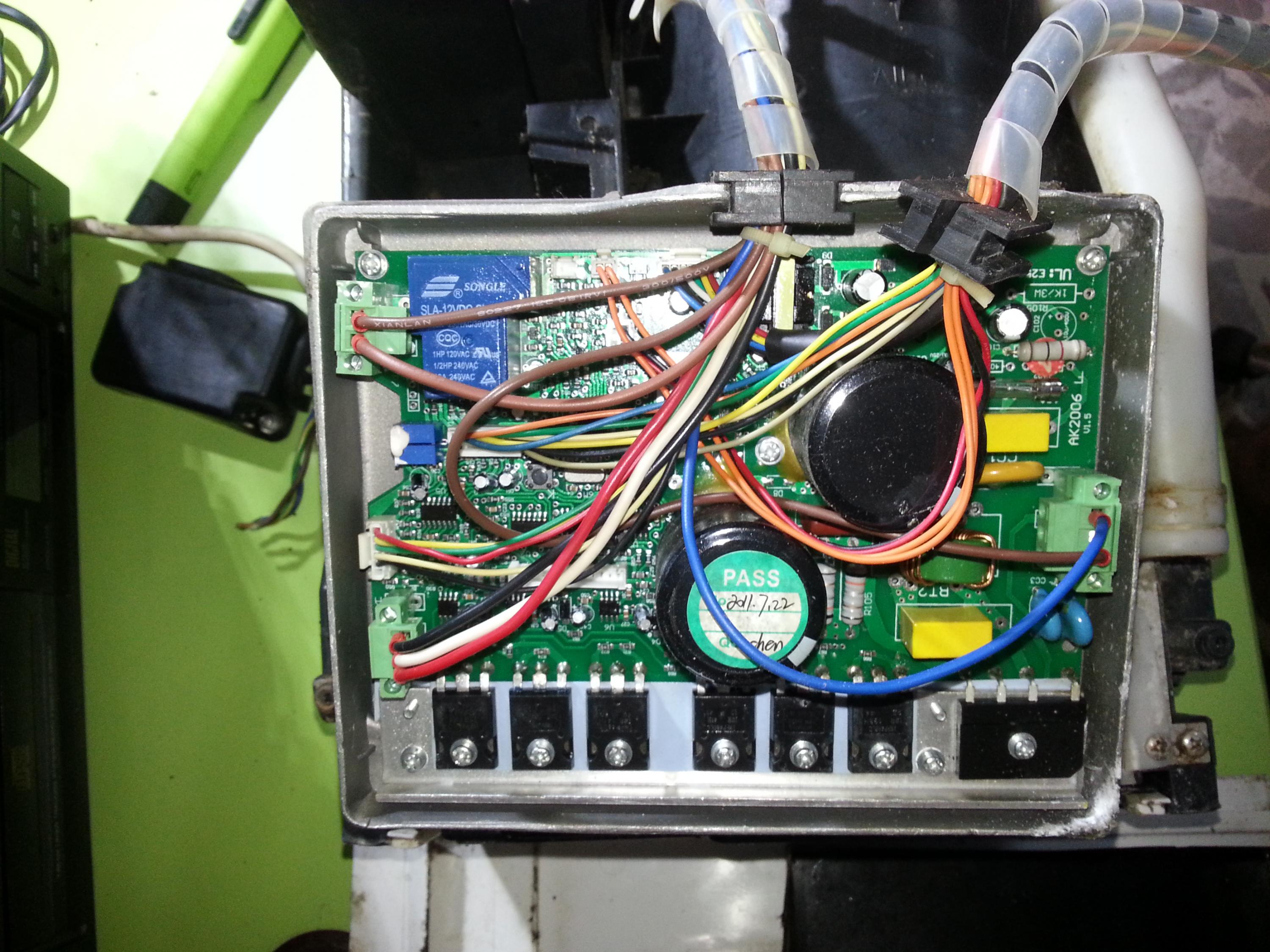

    Does the motor have any identifying marks or labels? Also, I might suspect that it is a standard AC motor, but with something like a rotory encoder/an array of hall effect sensors inside. If my guess is correct, you should most likely find all three of the large ones can be ohmed out and have some continuity to each other, but that the other smaller wires would have no connectivity to the big three.. Well, that is my guess anyways.
    Could be some sort of starter windings I suppose, but yes. Are those 6 fets on the board in two parallel sets? If so, are two of the 3 wires on that motor connected to the source or drain on the fets? Right now I'm kind of suspecting that the motor is a two pole ac motor. You would have one winding connected to one of the legs of the mains (probably through that relay) and then the other two would be connected to the 2 sets of mosfets. This would create the two phases for the ac motor. Then the 5 other windings would be something like a rotary encoder to give the mcu information on where the motor is so it can sync the phases. An advantage to this would be that you can control the speed/make the device work the same in both 240v 50hz and 120 60hz AC countries I suppose..
    And I suppose the last thing I could say is that you may be able to save the blower assembly/motor. You might try grabbing something like a thing of Tupperware and then just submerge the rusted to shit part with some vinegar. (You could also use hydrochloric acid or something commercial like Evaporust. ) You'd be amazed what about 24 hours of white vinegar will do to the rust. haha

      WHY would it have encoders and the likes ? I too thought of that, but it wouldn't quite make sense...
      Originally posted by Retro-Hipster
      Are those 6 fets on the board in two parrelel sets?
      Don't know - haven't measured them TBH.

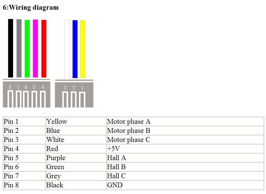

        This might be the motor? http://www.czowo.com/sale-10257912-d...and-dryer.html
        It might not be the exact motor but the wiring might be the same

          Every time you post R_J, I am impressed. lol That sure looks like the motor to me. hahaha

            Oh, I noticed that the opening on the blower cage seems a bit different/more narrow on the opening.. Also, I feel silly not thinking it was a brushless dc motor.. ^^;; That just makes more sense. That definitely looks practically identical to me though.

              AK2006H AIKE hand dryer, from the PCB number.
              I don't see an SMPS transformer, so the H-bridge must be using rectified mains voltage.
              I wouldn't warranty the repair because of the water and corrosion. It's supposed to have a intake air filter, lol.

                It's actually a "Jofel" but no doubt could be rebranded under many other names whilst still using the same chassis and parts.
                Correct. There IS a small SMPS there for various signals and stuff, but it's driven from a separate small transformer, tucked under that bundle of wires coming into the control box. You can just about see the yellow top there.
                It does - all clogged and dirty and sopping wet
                The motor, although similar in concept, is unlikely to be an exact match.

                        Rusty brushless motors, I find the magnets and hall sensors can get covered in iron dust and not work. The hall sensor does not get good flux signal.
                        Use sticky masking tape to clean that up.

                              White vinegar, heated near boiling, does a great job on limescale and is not like handling hydrochloric acid.
                              Dannyx, put some in a glass container (pickle jar?) & heat in a microwave oven. Try to soak/pour it over the nut holding the impeller.
                              If there's enough slack in the wires, immerse the entire volute/impeller assembly in hot vinegar.
                              The round volute/cone thing enclosing the impeller should eventually pry off the baseplate/static vanes, if it's anything like a vacuum motor.
