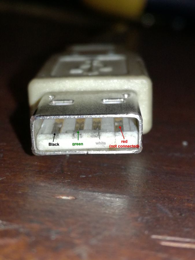

                    Could the usb cable be the reason behind it ? it's 4 wires black (ground) - Green (Data +) - White (Data -) - Red (5V).
                    My idea is to replace it with a Printer cable and have the red wire disconnected as this dude did before as mentioned in this link: https://cartechnology.co.uk/showthre...light=fantomel (Post #34).

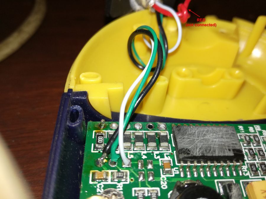

                          Here is my China unit, I chopped the original cable off and used an old printer cable, its been working OK, sometimes very slow connecting.
                          I will change the small parts on the PCB to see if it helps, will the CTX50-1P be OK or is it best I change it ?
                          Said that guy I told about.

                                  #36
                                  Re: A problem with an automotive trouble codes diagnosis device
                                  o.k. so you have to have a bad cable or a bad USB port on the OBDII device then.
                                    • 31199
                                    #37
                                    no, he cut the red so the computer does not power the device.
                                    it's possible that it overloads some laptops - a desktop would have unlimited current.

                                      #38
                                      then that would be good anyway no matter I kept the red wire or cut it ?
                                      • CapLeaker
                                        Leaking Member
                                        • Dec 2014
                                        • 8327
                                        #39
                                        and how does this programmer power up without 5V and only have the GND, Data - and Data + connected? I don't understand that.
                                        Interesting to see if there is a short between 5V and GND on that circuit board?
                                        • petehall347
                                          • Jan 2015
                                          • 4439
                                          • United Kingdom
                                          #40
                                          will power up from the cars obd port
