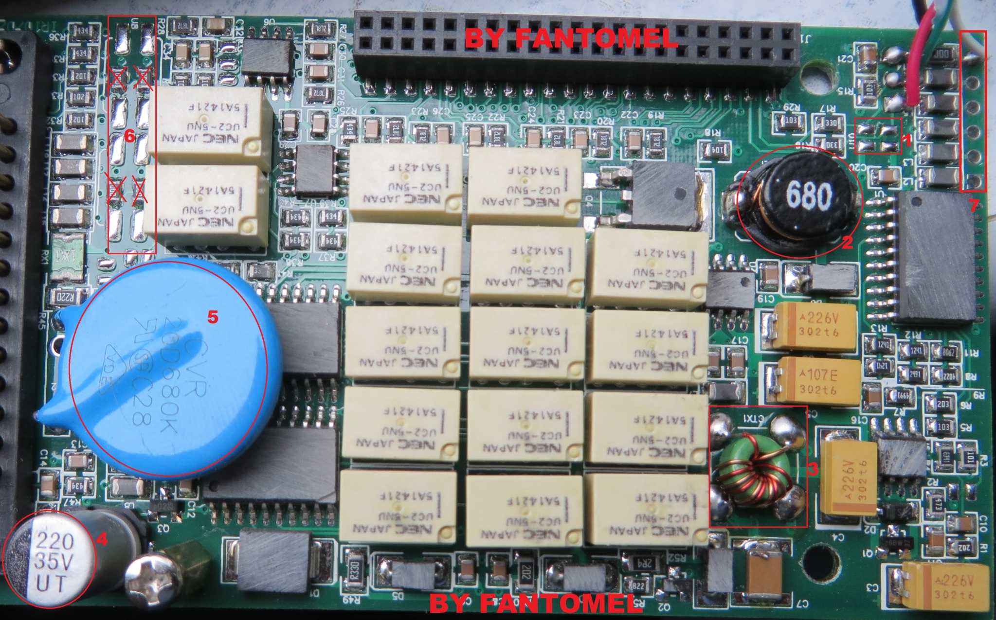

    Hello Everyone !
    glad to be right here posting my ever first thread in this forum and I hope You all to be in a good wellness

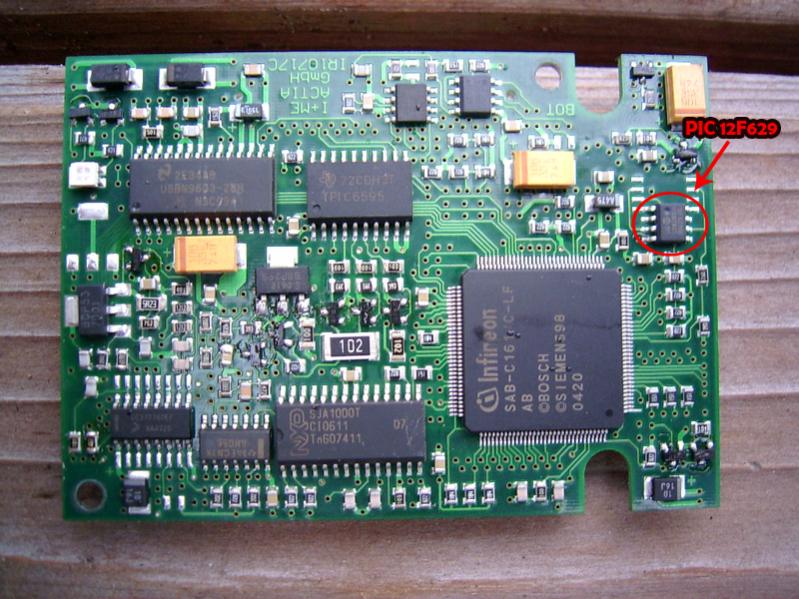

    So first of all, a couple of months ago I've purchased my father a DTC (diagnosis of trouble codes) device for Automotive that's known to be really handy despite being a chinese clone of a genuine unit known as Actia basic Passthru XS and I wanna say that I had it flawed since then and the following video shows my suffering with it : https://www.youtube.com/watch?v=JYkhgXAk_v4
    It worths metioning that I've done a dump for a hex file for a pic12f629 chip on the upper board thinking that it didn't have anything written on it but it was fine and undamaged unlike a thought.
    https://www.photobox.co.uk/my/photo?..._id=5535115176
    If You have any idea of the reason behind such an issue then please illuminate my sight !

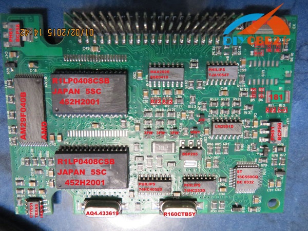

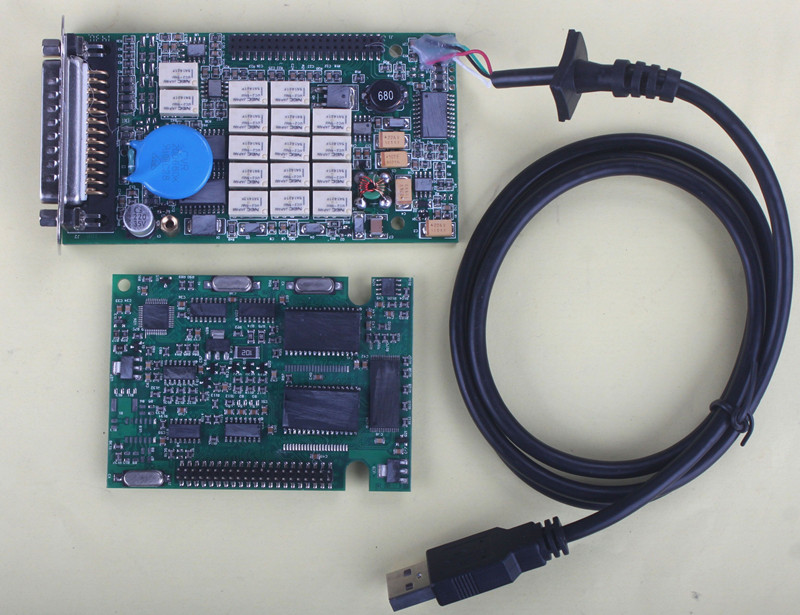

                                    Well, the fact it's a clone of the Acita Passthru basic XS which has a din 8 cable for a choice of either a RS232 or USB cables, whereas the clone one has only a usb inlet.
                                    as shown in the pics below we have the genuine VCI on the right and on the left side the clone.

                                      Re: A problem with an automotive trouble codes diagnosis device
                                      have 2 similar ones . one is cheapo elm chip one , the other a clone ross tech one . ross tech connected first time . elm one was a bit finicky to start with with it being usb com port connection .
                                      neither are like yours inside will all those relays . i wonder why it has them all ?
                                      Regarding mine it's a J2534 Passthru based device that allows You to perform some other special functions unlike the ELM such as flashing the ecu, throttle matching and a heft of other stuff making this thing really handy.
