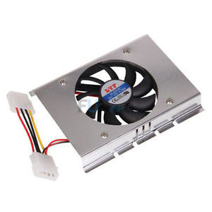

    Zalman Fanmate-2 speed controller crashed my PC
    Sometimes I'd hear a coil whine which kept getting lower in pitch until poof blue screen on a PC.
    Tried everything, thought it was VRM instability and basically lived with it for 2 years.
    Other day I hear the whine again and rip the PC apart and find a cooling fan stalled and whistling. Nudge the fan it works, no whistle.
    Investigated and Zalman Fanmate-2 speed controller is a piece of garbage.
    Uses a linear 7805 regulator, no capacitors anywhere.
    So what happened is the 7805 would oscillate and the fan would whistle, I think sending bogus high freq. tach signal to motherboard and then it blue screens.
    Turfed the Zalman and the PC is stable like a rock.
    Unbelievable, after 2 years of this.
    Who'd thing a fan tach can crash a PC?
    Link to a guy's teardown of the Zalman Fanmate-2. Yes it's a garbage design.

      This was driving a HDD cooler fan, pointing right at the controller pcb.
      It's slim- the sheet-metal is pretty restrictive and high/full speeds just made too much noise, all turbulence and no better airflow.
        Ah, I see Molex connectors.
        Just mod the connector so the fan is running either at 5V or 7V, whichever works better with you. Then you won't even need a fan controller.
