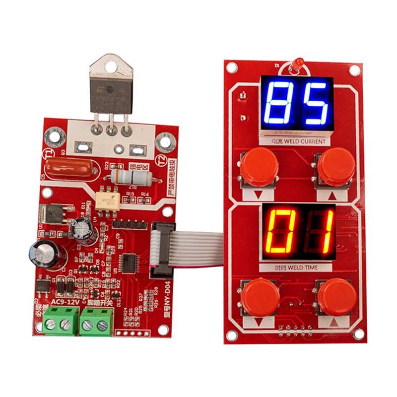

    I think that particular spot welder board model is NY-D04, with dual LED displays.
    Likely the MCU side is not earth-grounded and the EMI from a spot weld causes it to crash. I would add a 0.02uF cap parallel with 1MEG, from DC(-) (at the filter cap or 5V reg) to the enclosure chassis/earth ground so the MCU does not experience high level EMI. The display/keypad board may also pick that up. The ribbon cable is also vulnerable. Mains wiring needs to be away from the MCU and keypad and ribbon.
    One guy got his board to work better by beefing up the snubber and adding a cap for noise filtering. Have to see the board's values for those parts. Is your 9-12VAC power transformer decent, not sagging.
    The big 100A triac BTA100-800B I think has a live tab so you need an insulated heatsink or insulated mounting kit. But it apparently doesn't heat up much, as it is only on for a few 100 msec and many seconds rest.

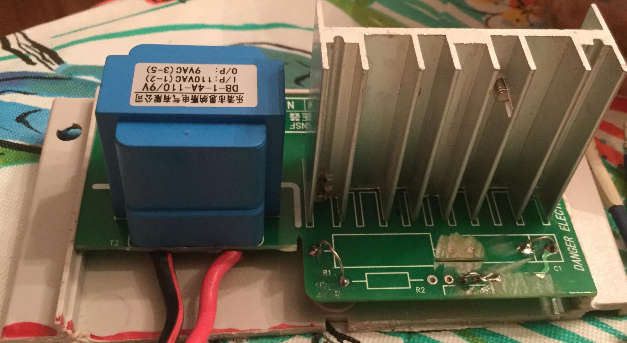

        I was able to cut circuit board where the optic sensor is and separate them it will be easier to mount the tirac to a heat sink that I have
        on the outside of the enclosure the enclosure has a cover that covers the tirac from another setup that used the same tirac
        Yeah I know stealing parts from one setup and use on another setup really but other setup would have had me use a separate timer which I did not want to do
        The optic sensor is now mount on a small double sided circuit board that I have to make small circuits for testing
        I just have to use some hook up wire to make all the circuits come together and test it out and see how well it will work
          Why the resistor at 1meg what will that do your only using a 0.02uf capacitor what voltage spikes is going to hold down with that high of resistance / capacitor smooth the spikes I understand this and I understand that if you have the right resistance it will discharge the capacitor over time
          This can be done up to a point what can I really do for this not be a problem
          Please explain further what parts would I use and how would I hook it up I understand what it suppose do but I have never had to add one
          What part of the circuit do you need to see I can do a very close close up I just need to what part
          The pins are not tied to the metal part of tirac
          It does not if you hit it once in a while but if you do a big battery pack it will get quite warm
          if you are pulsing the tirac many times in a short period of time to get a better weld
          The normally setting might be 15 pulses at 300 to 500 milliseconds this normally gives you the best results depending on how good the metal that is used on the cell and the tabbing metal is

                Re: Modifing a Battery Spot Welder because of Controller Issues
                I believe there is an initial double pulse as a pre-heat, followed by the main weld long pulse. Somewhere they found it does better with batteries, fewer outright punch through holes.
                My guess is the controller crashes whenever a burst of EMI from an arc happens, either during pre-heat or the main pulse. It might be from the transformer too. EMI would explain it acting unpredictably.
                First thing to try would be to ground the controller MCU/DC side to earth-ground. This can be a short piece of wire, or a cap+resistor if there is a chance the MCU-side has some oddball grounding. The 1MEG resistor bleeds off leakage currents from the power transformer so no charge build up and the 0.02uF cap is a short at RF frequencies.
                Using RC grounding lets it float so at DC or 50/60Hz AC frequencies there is no ground loop possible, but at RF frequencies it is grounded. Note one display board trace is very close to shorting to the mounting spacer.
                Attach the ground (wire or RC) to the main board's filter cap C1 (-) or Vreg U1 (tab?). The footswitch common might be OK if one end goes to MCU ground. I would ohm it out.
                The MCU connects directly to the ribbon cable going to LED display/keypad, and the ribbon cable makes a great antenna.
                Just pay attention to lead dress, loose mains wires that go close or touch the ribbon cable, or PC boards- will radiate EMI which gets into the MCU.
                I don't know the values of the triac's snubber, C5+R17. R17 should be 10-39 ohms 3W and the cap at least 0.1uF or 0.22uF I think they might have cheaped out on C5. 0.01uF is useless and the triac might even get damaged.
                I think a diode fell off the board for this guy: Aliexpress poor quality chinese NY-D04 spot welder. Very sad.

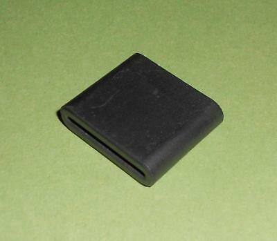

                    • 31144
                    Originally posted by sam_sam_sam
                    This might be possible but what about the ribbon cable this is a problem by it self
                    ferrite ring?

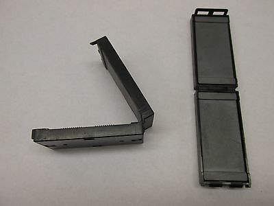

                      • Jul 2011
                      • 6057
                      Originally posted by stj
                      ferrite ring?
                      Are taking about this type
                      Should I have one on each end of ribbon cable and hot glue them in place

                        Those flat ferrite ring or clamps, you can use one with a loop (if two ribbon cable thicknesses fit). A round donut works if you can fit the ribbon connector through.
                          • 31144
                          those are good, but any type will do.
                          i think you only need one at the end with the microcontroller - as close to the board as possible.
                          another option woiuld be to screen the cable with something.
                          maybe aluminium or copper tape - and earth it.

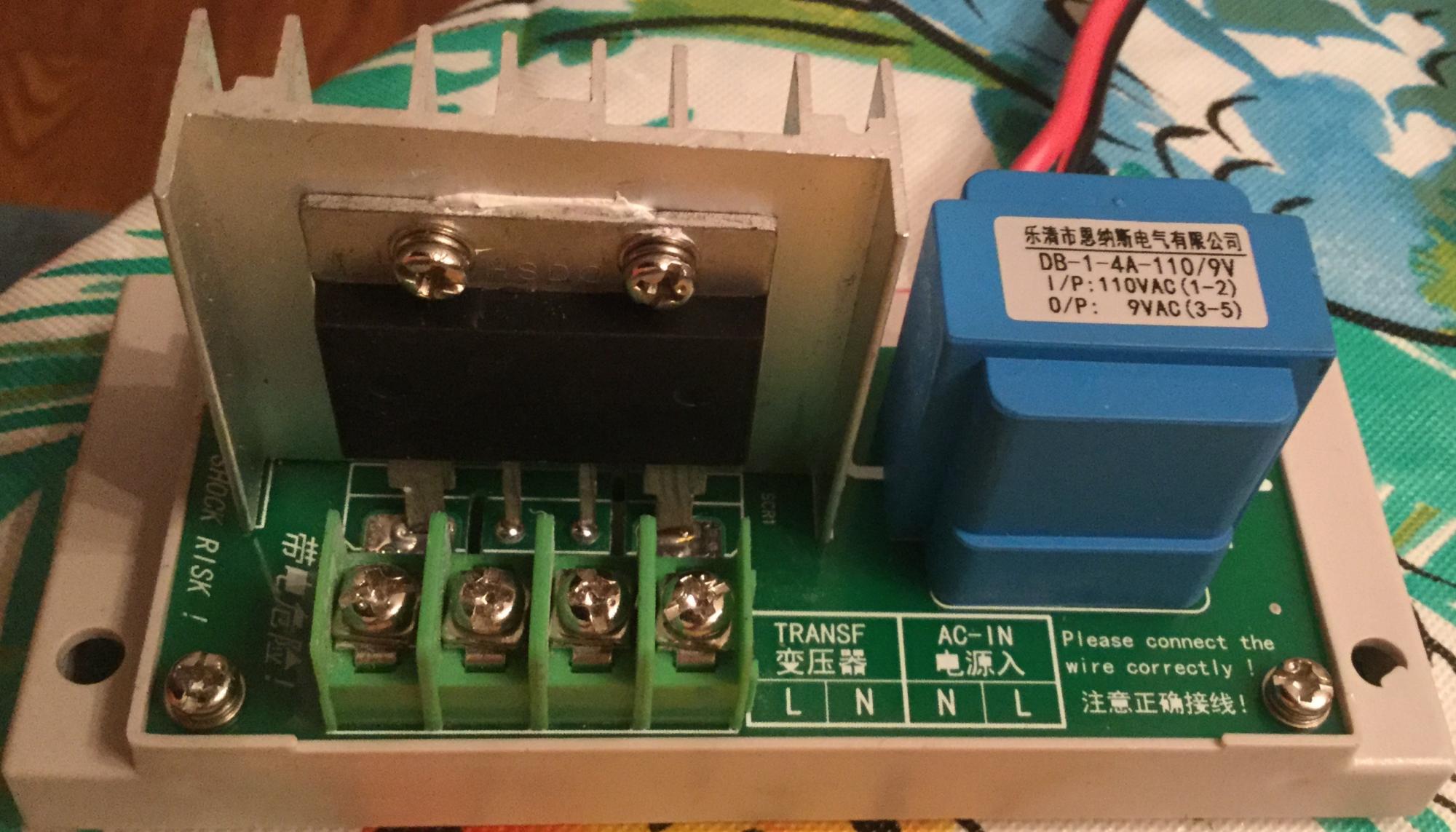

                              I have a plan
                              I modified this controller to be able to have the heat sink and the transformer all on one board
                              https://www.ebay.com/itm/Spot-welder...53.m2749.l2649
                              One note about this controller it nice device but it has to many steps to program it
                              The other controller is easier to step up and use so we will see how well this controller works
                              And waiting for this to come in
                              https://www.ebay.com/itm/NY-D04-40A-...53.m2749.l2649
                              I have this part already
                              https://www.ebay.com/itm/NY-D04-NY-D...53.m2749.l2649
                              I was just going to take the heat sink off the other controller that in the photo but it would interfere with the power in and power out pins
                              I can not have this way so I started with another plan
                              I will be able to fit all the parts in it I will also cut a hole for a fan to keep the heat sink cool if I have room in the case to do this
                              Yeah I know that a 100 amp unit is over kill but the 30 amp ones do not last
                              I thought about using the optic sensor parts of this board but it setup is different so I could not do it that way so I remove the optic sensor circuits and use the other optic sensor circuit
                              I just have three wires to hook for this part and the power supply for the controller board and hook up the foot switch pedal I should be rocking and rolling soon I hope
