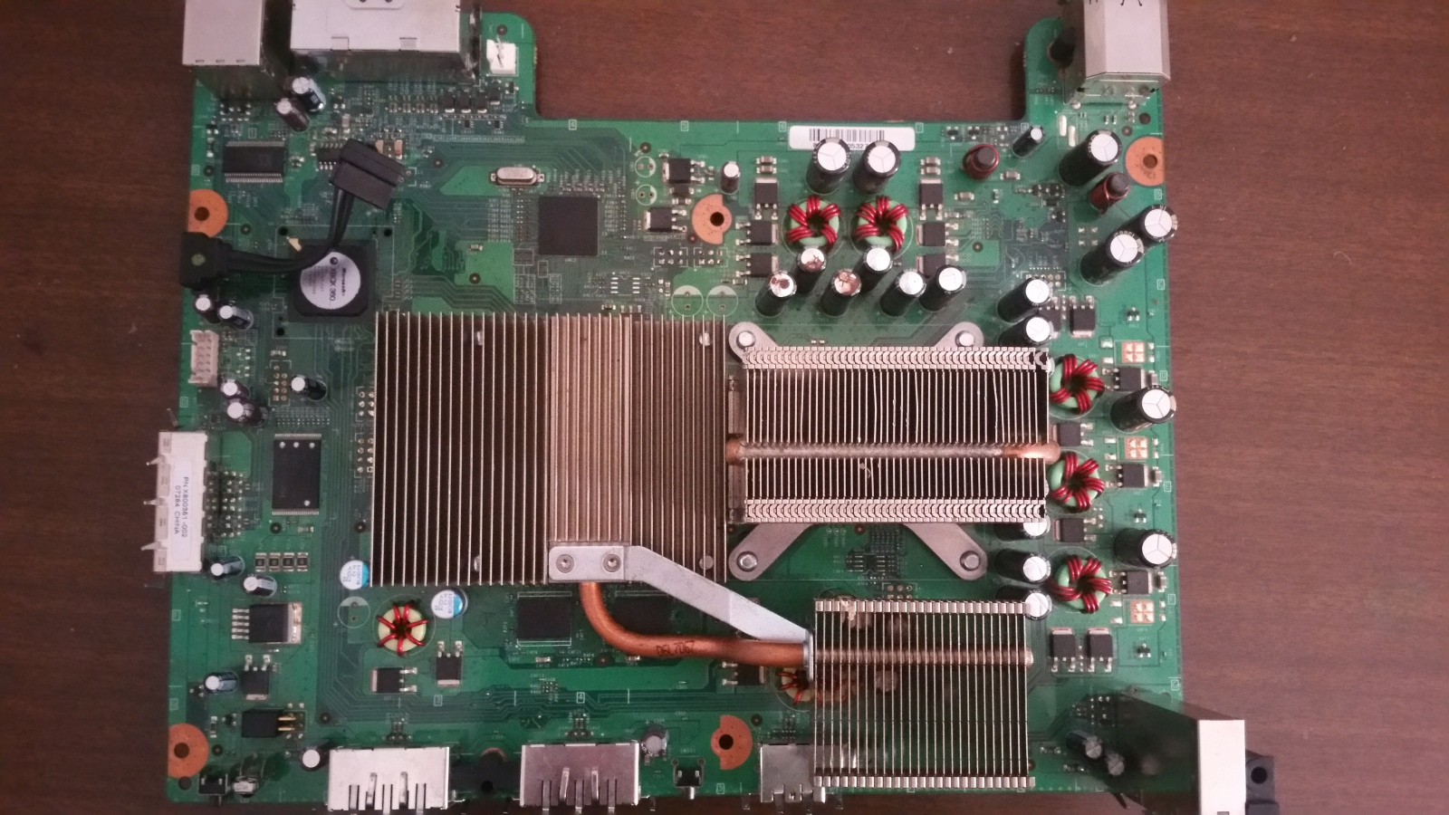

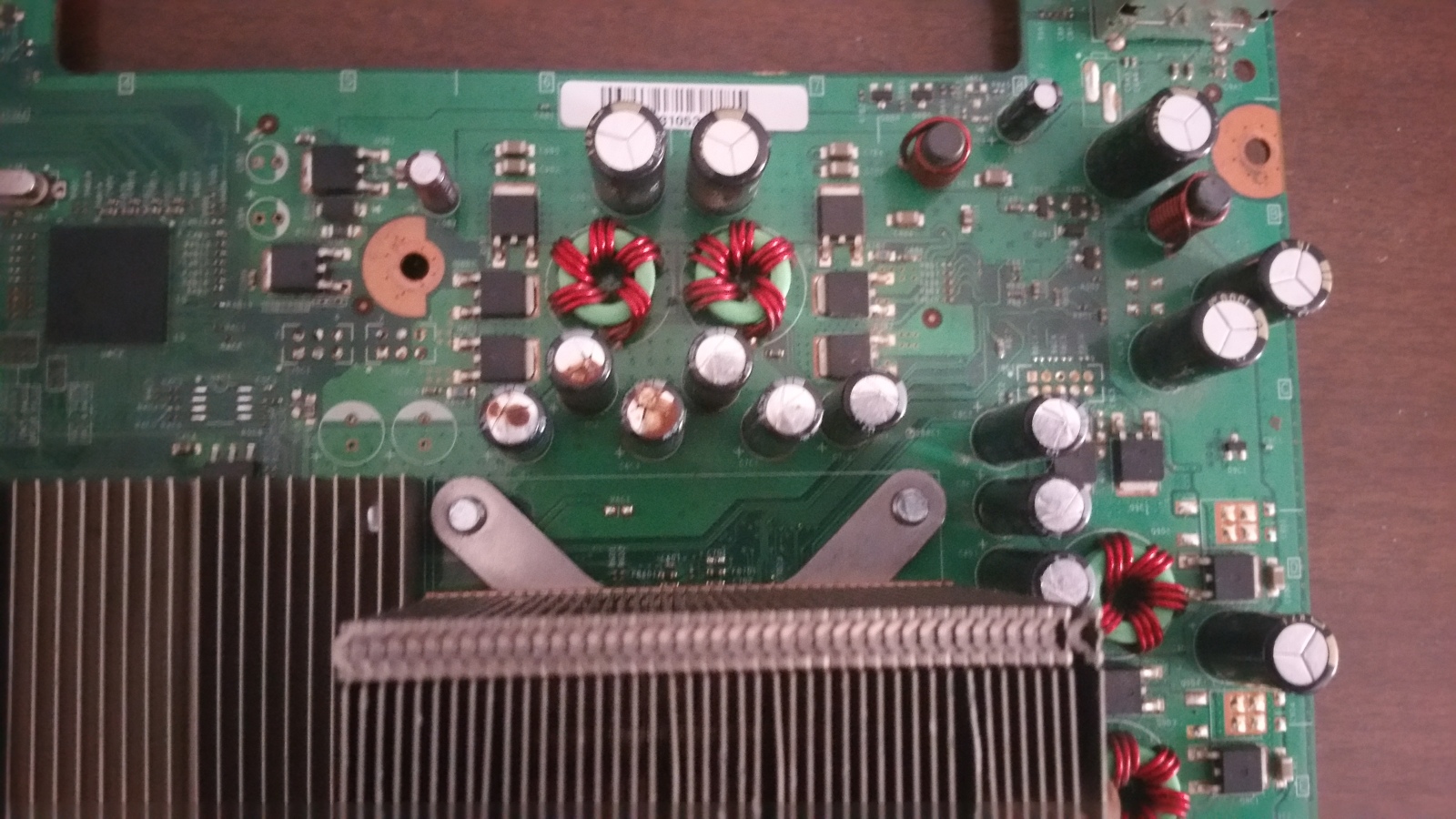

    So I decided to fix the E74 error on my xbox 360 with a heat gun and blew some capacitors in the process. When I went to test it out it doesn't come on at all. I know the exact capacitors that I need to buy,but is it worth fixing the xbox?

        What series are the caps ?

          100uf 16v niche con
          6.3v 820uf MFZ

              Is the Nichicon blown out ? Also cant spec sheet for MFZ but their esr is about 0.07 ohms for that value so find a cap with similar spec. Will have a search.

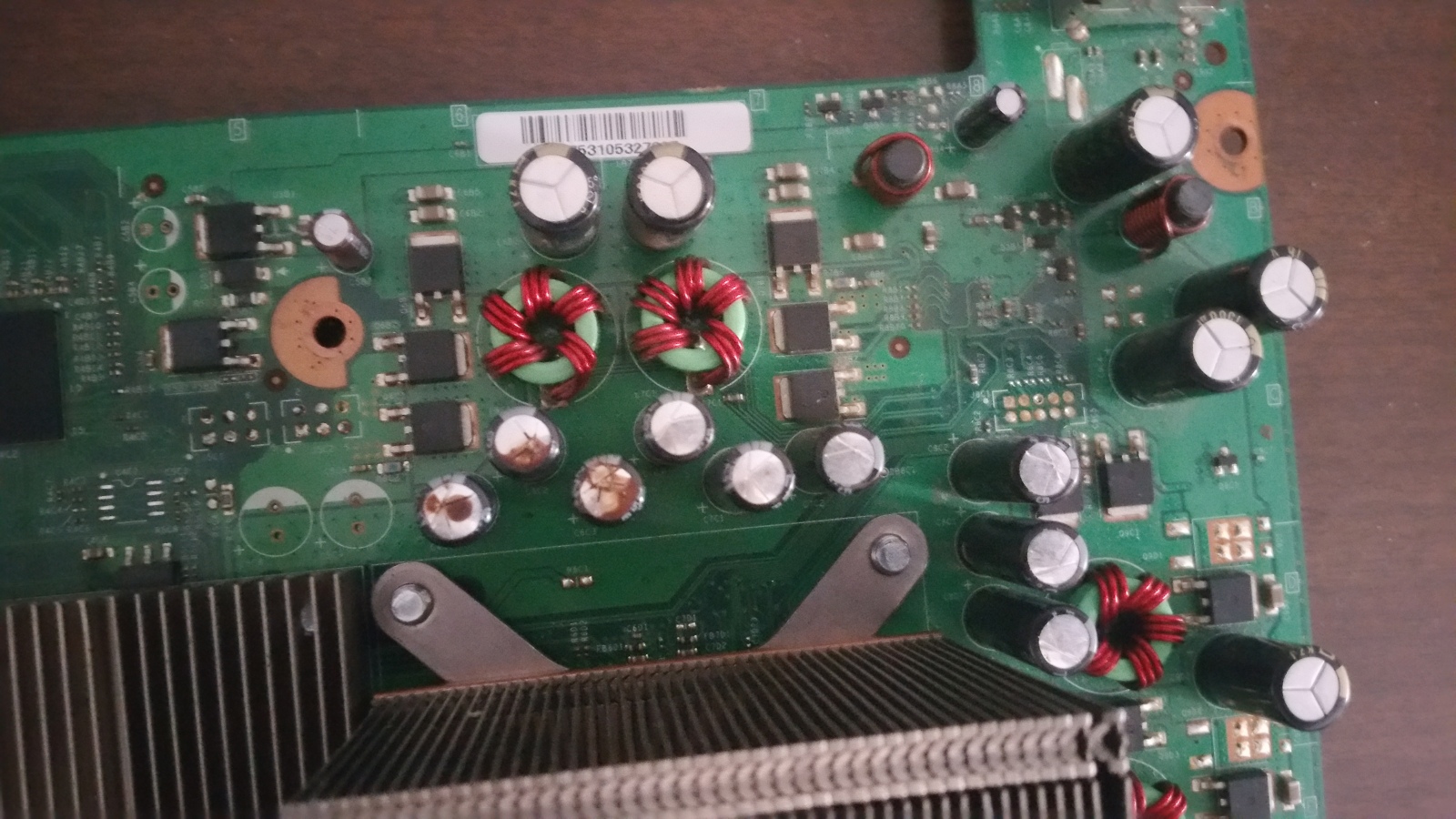

                  MFZ is a Rubycon series(OE-only and discontinued a quick web search didn't turn up a data sheet), and the bulged caps have the signature Rubycon K-vent, so I suspect boyam99 misspoke that they were Nichicons.
                  I replied to his other thread about possible substitutes, the only place I've ever seen MFZs is Ebay (likely counterfeits):
                  https://www.badcaps.net/forum/showthread.php?t=55556

                    Yeah you can try to replace them with same the same rubycon caps, i think nichicon low esr also work, idk what series (i will look). Get some rubycon 820uf 6.3v caps online and replace them.

                                Heat gun?!
                                If you "assaulted" it with a paint stripper gun scrap it as you probably killed it anyway.
                                If you are using a Hot Air Rework Station don't bother as the chances of fixing it using a air wand are slim - You need a BGA rework station to sort that properly.
