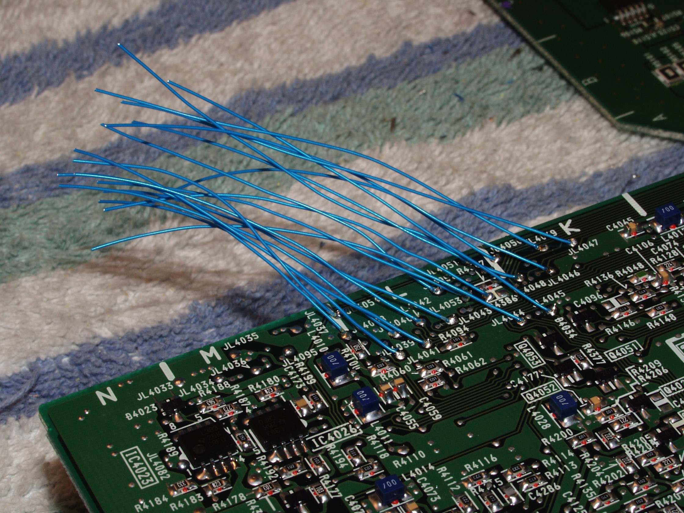

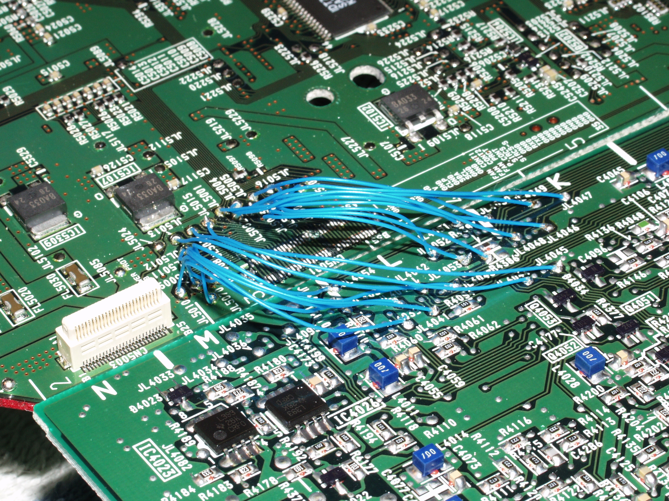

    First you get a some nice mod chip, I got a Modbo 760 one. Then you take your poor PS2 and disassembly it. If you did not want to write it off right away, then you take a look into this guide - in fact it was very simple, however from the second time on - http://www.rpghry.cz/dds/nastenka.htm#ps2
    Now using the included both sided sticker attach the Modbo chip on the bottom side of PS2 PCB that way, so it's little contact match perfectly against where they connect the pins GND, M, N, O, P, R, V, U, T, Q - simply this way:
    And now use your soldering iron to make a connection there, as shown. I used my trusty old transformer soldering iron, as I need to heat-up the PCB a lot to make these contacts possible:
    It is not easy, but if you have a small slim soldering point, lot's of resin and just the good amount of tin on your soldering iron tip - it will work. Then check the connections with DMM, if they did not just look as conductive, but if they really are. Pin W you have to connect by wire and differently a bit. In the guide for Modbo 760 chip there: http://www.picsystems.net/diagrams_p...760_v12_13.jpg (backup link here: http://img118.*************/my.php?i...60v1213of0.jpg ) is mitake. You cannot get the pin W connected bellow the small white Modbo PCB board, so you have to use different connection that suggested. (in theory you can, but then the height of the soldering and wire will prevent connecting of the other pins) This way:
    Then only a "fun moments" awaits you with soldering connections like the B, G H and I connections:
    To show how small they are, I add a ruler there. In Centimeters, the small ares are millimeters...
    Good luck!
    Another mistake in the guide is, that instead of pin S it shown pin SX (!) - so just connect the pin S on Modbo 760 (new revision?) to the SX connection in the picture shown. Things work that way. Another problem is, that where to connect the pin Z is completely unknown to me ATM. Luckily this one is optional, so, it is not need to be connected at all. You just missing the features called "AR Max" and "Gameshark"... I have no idea what they even mean, so...
    So then, if everything works as it should, you get only more fun now
    Details, as the PS2 sold for Region 2 (Europe) can now play Region 1 DVD's such as only in USA sold Redux edition of Apocalypse Now:
    ...is perhaps not even worth mentioning. I tested the classis R2 (Europe), R1 (USA) and R4 (Australia) DVD's and everything worked w/o a problem.

      i use wirewrap wire to hook up mod chips/boards.
      much easier to work with.an isotip iron with a 1/64 tip helps too.

                  Nicely done installation.
                  I use enameled transformer wire also for nested hookups like that.

                    I used wire that was as thin as tranformer wire but it had insulation on it.
                    I know that the transformer wire doesn't conduct but I just wouldn't feel safe with laquer instead of traditional insulation.

                      Krankshaft - it is a mod chip. The PS2 work perfectly w/o it, so, not need for life And looks like you got experience with the moding, so, share with us some
                      kc8adu - wirewrap wire, hmmm, you mean like this, for example?
                      http://www.matronics.com/SonyVPL-VW1...d-C-Boards.JPG
                      http://www.matronics.com/SonyVPL-VW1...est-Points.JPG
                      Looks small and good. I did not get so nice small wires... where to get them? Just in case I will do job like that again

                      killjoy - but hey, you actually did a good job. Nice wires, man. And you got it harder that me - the older Modbo revision require you to solder way more wires, so... congratulations on job well done!

                      arneson - thanks. Well, I was considering just a wire from transformer, but then I was not sure about the just painted isulation of the wire, so I decided to use these smallest ones I got in my box of wires...
                      I probably need smaller ones. Now, where to get 'em?
