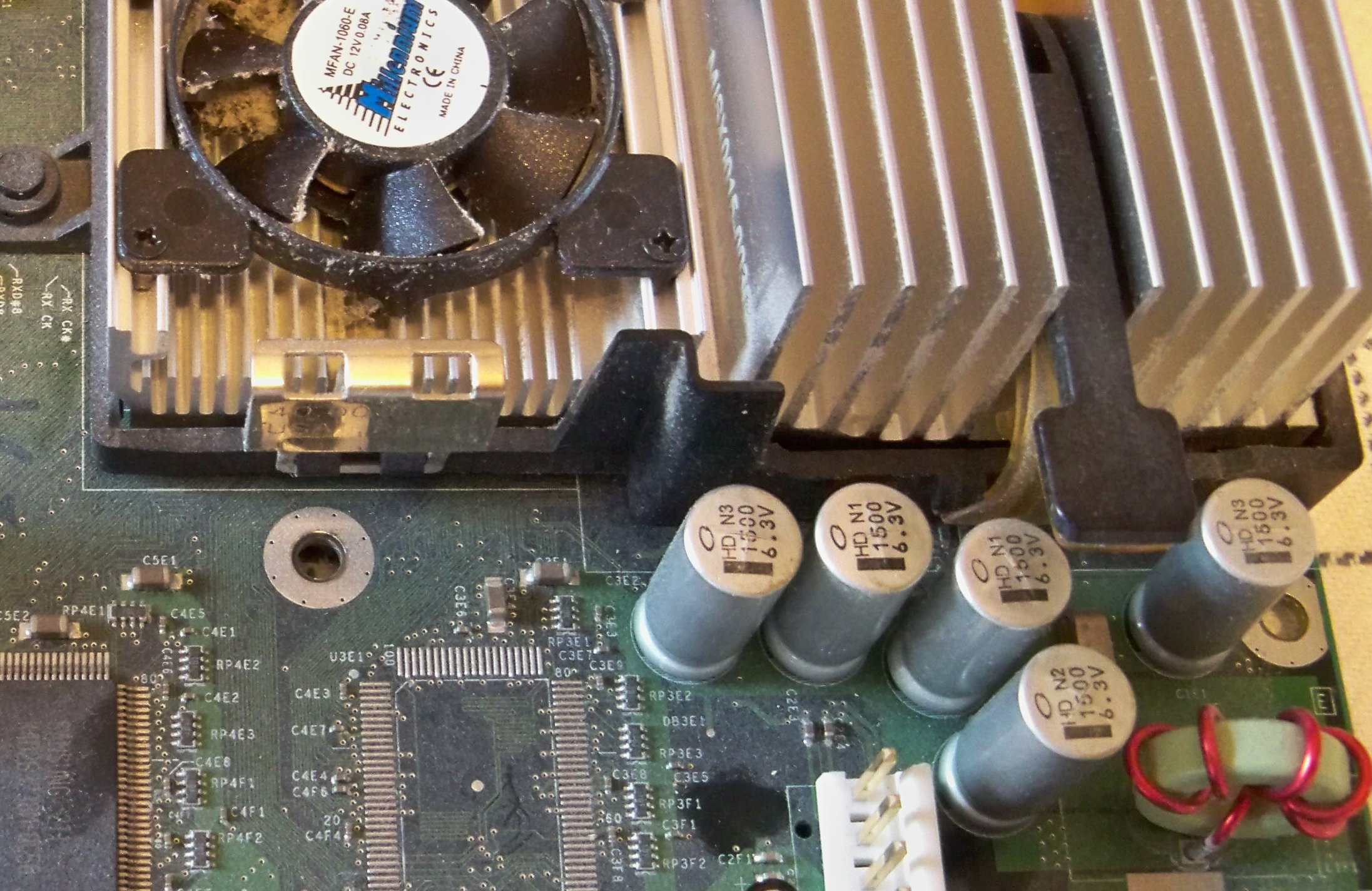

    Well after 20+ years my orig Xbox 1.0 finally started to Frag a couple of days ago.
    The 4 Caps near the Cpu are leaking from the top. (the right most cap isn't)
    The clock cap leaked all over the board too.
    I removed the clock one and cleaned up the MB using 91% rubbing alcohol with Q-tips.
    I couple of questions:
    Where do I buy the Cpu replacement caps? Links please. (I'm in NH, USA)
    Is a 15watt iron ok? That's what I used to remove the clock cap.
    I also have a 45watt de-soldering red bulb (radio shack) iron too, is that ok to clean the holes of solder? (I didn't use it yet)
    The pic shows the cpu caps, I removed the orange stuff leaking from the top to see the writing on them.
    Thank-you, Michael

      https://www.digikey.com/en/products/...AAE014/6196333
      You may struggle with a 15w iron, especially when trying to clear the holes. You may have to use the wiggle in and out method heating the two holes off and on.

        you have no chance with 15w
        a 40w iron is still difficult.
        you may be able to do it with a 25w iron by clearing the holes with a stainless-steel needle

          So the 45watt de-soldering red bulb iron is safe; as in not too hot??
          Also thanks for the link at digikey.
          Michael F.
            • 31296
            #205
            Re: Original Xbox Replacement Caps
            well, it's not temperature controlled so it's a bit risky.
            use it fast - dont use the bulb, it wont work anyway.
            just melt the solder and rock the cap out - clean the hole(s) out later

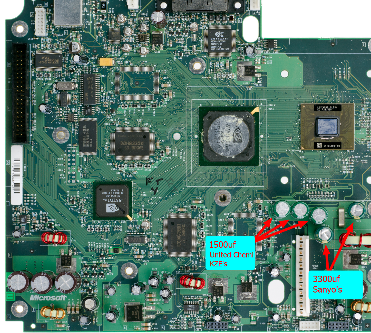

                              I found this interesting, an Xbox with two 3300uf Sanyo's and three 1500uf UCC KZE's. I've never seen them mixed like that before. Always five 1500uf's or three 3300uf's.
                                Are you sure they haven't just been replaced?
