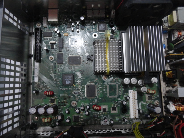

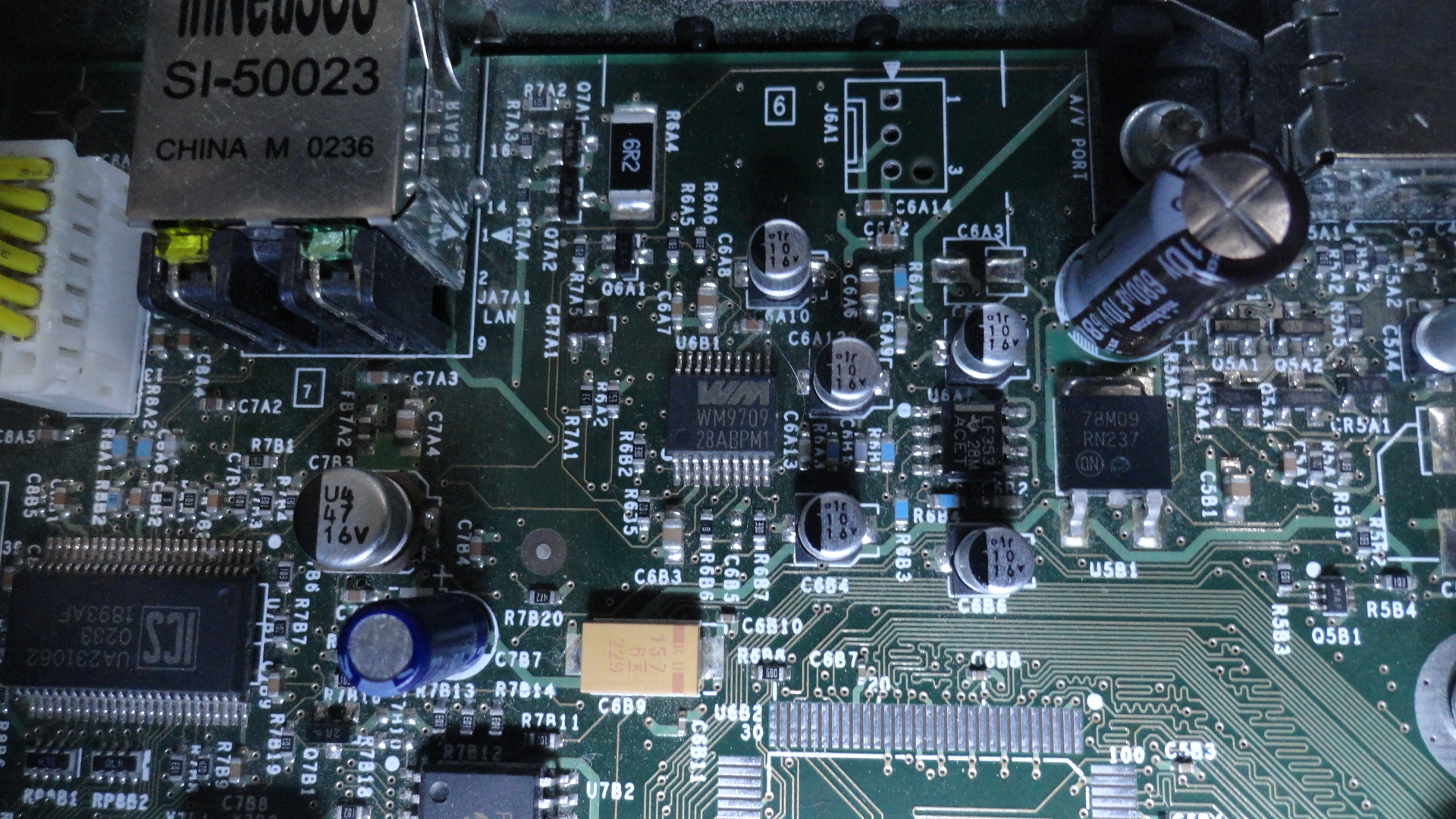

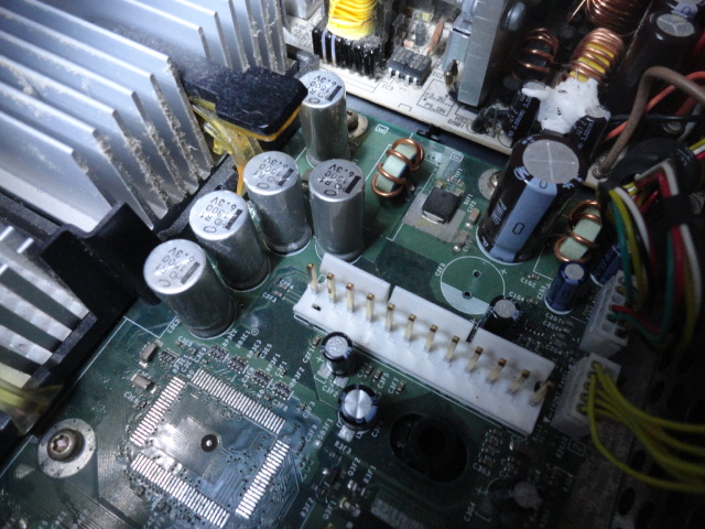

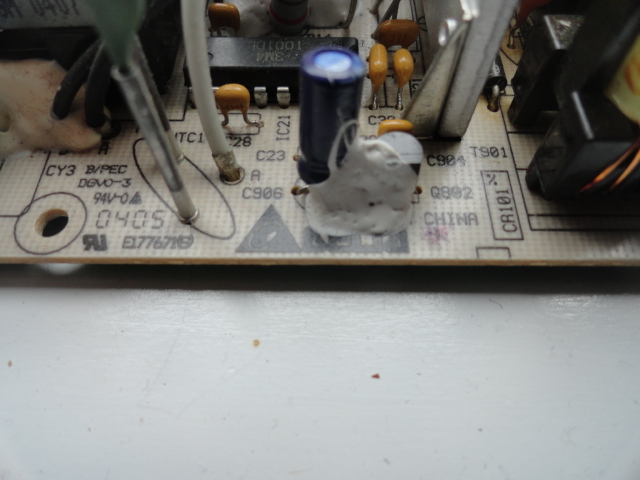

    I've been modding Original Xbox consoles for over ten years.
    As these things age I find myself becoming more of a refurbisher.
    The most common problem is the clock capacitor which tends to leak.
    This is illustrated in the first 2 attached pictures below.

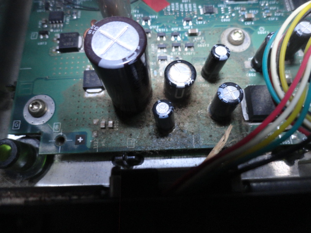

    The faulty capacitor is a SuperStor 1F 2.5v SuperCap (console v1.0 to 1.5)

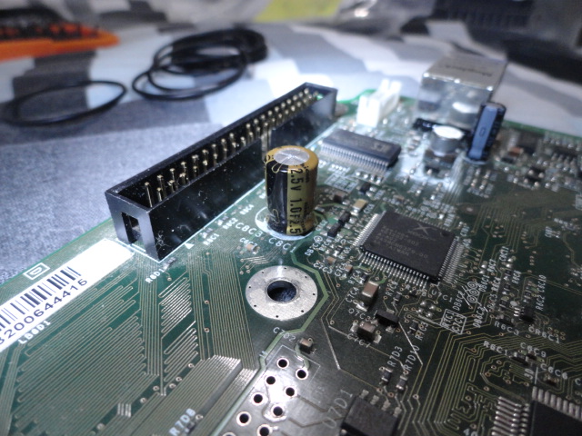

    It wasnt until the final Original Xbox version 1.6 that the cap was replaced,
    with a Nichicon 1F 2.5v Gold SuperCap, as seen in the 3rd picture.
    I came across and have been looking for replacement caps at "mouser.com"
    I've noticed that smaller caps like 22uf 25v have a life span of around 2000hrs
    Medium sized have life span of around 5 to 7k hrs and 10k for the largest (psu) caps.
    I'd like these console to last another decade, I'm considering replacing most,
    if not all caps on the motherboards and power supply units.

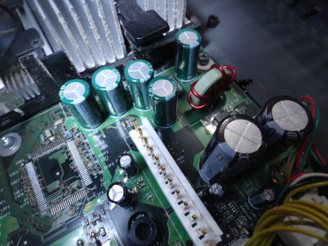

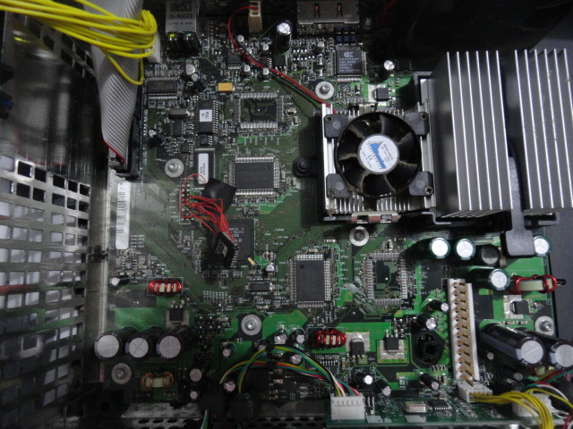

    The 4th picture is a Xbox version 1.0 motherboard (with cpu fan)
    13x 25v 22uf Nippon SMG
    6x 25v 100uf Nichicon VR
    3x 16v 1500uf Nichicon PW
    2*x 10v 3300uf Nichicon PW
    1x 10v 680uf Nichicon PW

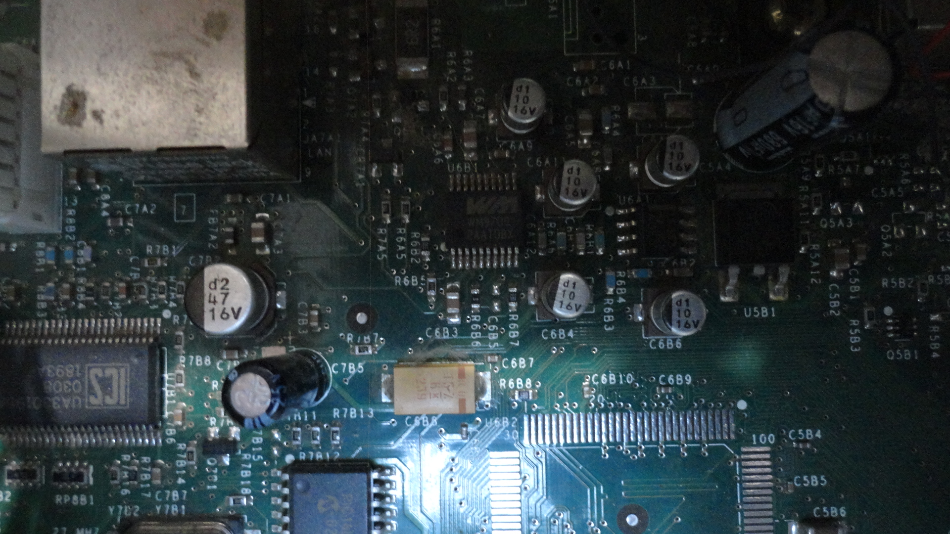

    5x 6.3v 1500uf Nippon KZE (6th picture)
    1x 1F 2.5v SuperStor

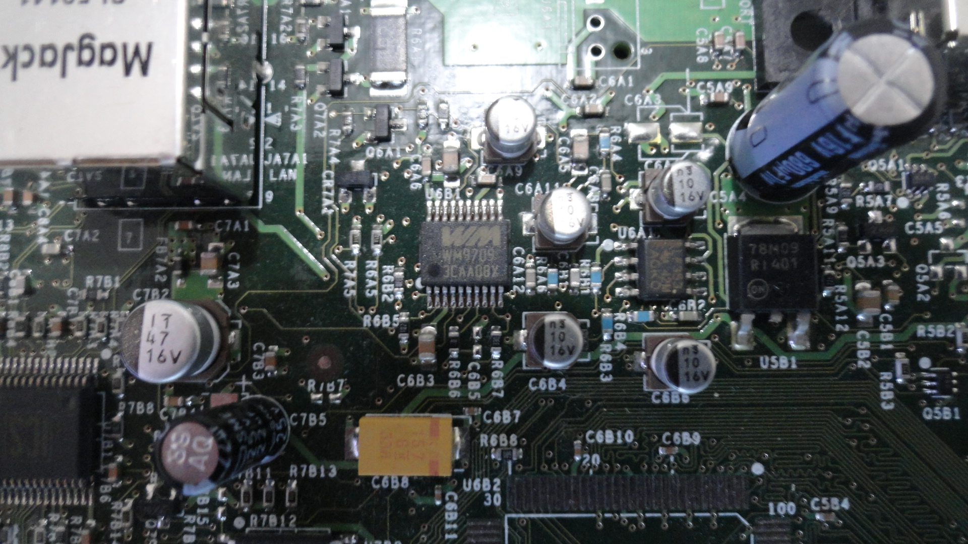

    The 5th picture is a Xbox version 1.1 motherboard (without cpu fan)
    1*x 10v 3300uf Nichicon PW
    5x 6.3v 1500uf Unidentified Solid Cap (7th picture)

    Re: Original Xbox Replacement Caps
    you dont need the supercap, under 1.6 just leave it out.
    on a 1.6 you need something so stuff a 100uf electrolytic there or the console wont start.
    there is no cpu fan btw, that's the g-force3 gpu your refering to.
    the cpu vrm caps - the 1500uf 6.3v must be *very* low esr or use poly's
    for the rest, just use panasonic FR
    finally, your unidentified caps are not solid, they are just electrolytics.
    the symbol on them is Nichicon - they are HD series.

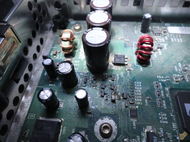

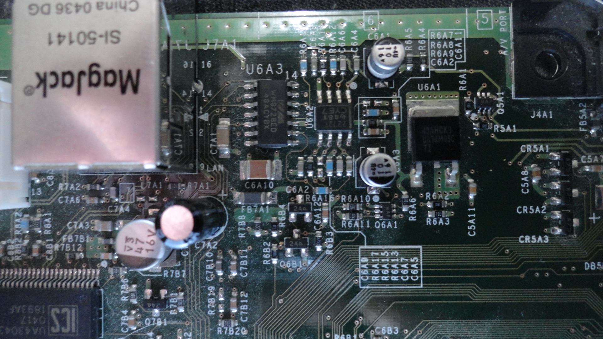

      I'm not sure if the Aerogel clock capacitor is actually defective. These capacitors are 1F, 2.5V, and IIRC, the clock capacitor is ran right at its maximum voltage (2.5V is the voltage the clock circuit runs at, if memory serves), which is why both the Aerogel capacitor and even sometimes the Nichicon UC capacitor (which bulges now and then because of that) has a limited life. Though, since the Aerogel capacitor almost always leaks from the bottom, it may be sealed very poorly. For what it's worth, I would just desolder the clock capacitor (from versions 1.0-1.5) and forget about it. It isn't very useful anyway - if you remove AC power, it only keeps the time for what, a few hours? Those ADDA hyprobearing fans that come with version 1.0 of the console tend to seize prematurely as well.
      There are also a bunch of small SMD electrolytics as you can see - one is 47uF 16V, six are 10uF 16V. Nichicon 85C (WX series very likely), Chemi-con 85C (MV series - can be identified by the shield), and Suncon (Sanyo) 85C (CBS series, from what I can tell) SMD electrolytics are all used interchangeably there. The 3300uF 6.3V Nichicon HMs were also known to go bad in versions 1.2-1.6 (2002-2005 datecodes) of the console, in the VRM input and output. I believe there is also one more 680uF 16V HM (again 2002-2004 datecodes) used in version 1.2-1.5 (it's used interchangeably with a Panasonic FJ of the same value). Never seen it actually go bad, but it wouldn't hurt to replace all the electrolytics, as you said.

        these "supercaps" are a joke, i had the datasheet for them.
        they are rated for something like 500 charge/discharge cycles.
        after that - it's anybody's guess what they do - other than piss themselves on the board above some fets.

          I attached the datasheet for both Nichicon UC and Aerogel Powerstor B series.
          Worst of all, both capacitors are only rated for 1,000 hours @ 70*C, both load life and shelf life.
            Thanks for all the replies,
            100uf 25v cap?
            Noted...
            Cheers, I forgot to mention them...

            Picture 6 (1.0mobo) you can see the two black caps to the right (3300uf 10v),
            Picture 7 (1.1mobo) there is only one but the cap is still allocated on the board,
            Could this be filled in? Would there be any benefit?

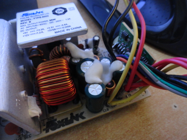

                      Also come across a couple "FoxLink" PSU's in some v1.0's
                      I will also make a listing for it when I get a chance.

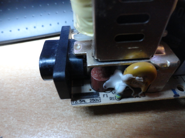

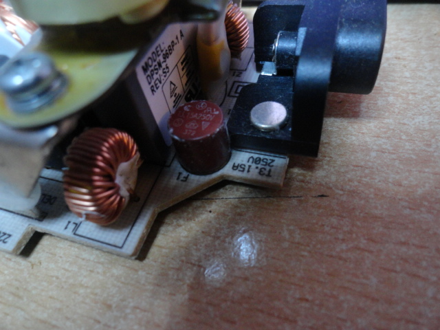

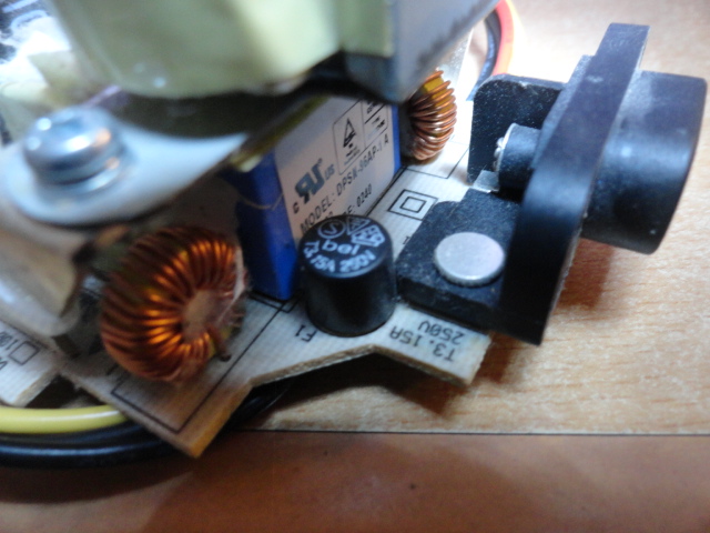

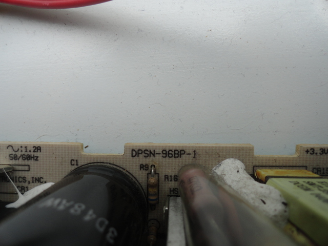

                      Attached are 2 pictures of a Delta PSU from a v1.4-1.5
                      Picture 2 shows "DPSN-96BP-1" is this the part number?

                        CapXon GS and GL. And that's actually a Samsung power supply made in Tuscany as evidenced by the transformer part number. And yes, DPSN-96BP-1 is the part number. Also, those early Foxlink units were the worst when it came to cracked solder joints in the AC inlet (FTPS-0001, except revision D, and FTPS-0002 were the affected models - the socket and inlet were only held in place by two measly plastic clips so eventually the solder would break with repeated insertions and disconnections of the power cord).
                              I had troubles trying to identify the caps on the FoxLink PSU
                              As you could see in the picture the caps are covered in glue.
                              I also Included values and measurements for the PSU fuses.
                              • mariushm
                                • May 2011
                                • 3799
                                The last three pictures show fuses, T means they're "time delay" fuses, then you have the current and voltage.
                                The first picture shows some capacitors, most likely made by Teapo if I'm going by the color and the shape of the vent. If you want to be more accurate, you'll just have to use a sharp blade to cut the glue and desolder the capacitors to read the capacitance and voltage rating.
                                The glue is there just to prevent components from vibrating and/or popping out of the pcb holes when these pcbs go through wave soldering. You can cut it out without damaging the power supply.
                                ps. pay attention to those gray and green wires, the insulation is almost cut. may want to put some tape around the cables for safety.
                                • Wester547
                                  • Nov 2011
                                  • 1268
                                  • USA.
                                  Originally posted by NeMesiS34
                                  SMD Caps:
                                  1x 16v 47uf Nichicon WX (6.3x5.4mm)
                                  6x 16v 10uf Nichicon WX (3x5.4mm)
                                  Just to be clear on this, though I may not be 100% correct on this, the "WX" capacitors can be identified by these markings:
                                  [Letter][Number]
                                  [Capacitance]
                                  [Voltage]
                                  "WT" (105*C SMD electrolytics by Nichicon) have a "P" after the number (the datecode).
                                  Chemi-con MV SMD capacitors can be identified by a shield on the markings. And I think the Suncon (Sanyo) ones reverse the letter and numbers on the datecode and have a slightly different font.
                                  240v PSU Caps: (FoxLink FTPS-0002 Rev. B)
                                  1x 400v 180uf TEAPO? (25x30mm)
                                  That would be Teapo LXK or LH. Sometimes they used Chemi-con SMH in this position.
                                  2x 25v 100uf TEAPO? (6x11mm)
                                  There is a 100uF 25V Teapo SEK (brown sleeve) on the primary side which acts a a startup capacitor. The green and gold sleeved Teapo SC (100uF 25V) on the secondary is before the standby regulator. There appears to be a ventless, brown Teapo SEK after it - not sure what the value is either since it's drenched in glue and removing the glue could compromise the sleeve (if you're not careful whilst removing the glue with a blade, as mariushm said), but I'd guess smaller than 100uF 25V. Perhaps 47uF 25V.
                                  1x 1000uf 16v TEAPO? (10x20mm)
                                  Teapo SC, +12V filtering. From what I can see, there is a 13x20 2200uF 10V Teapo SC before the ferrite coil on the +5V rail and possibly an 8x20 1000uF 10V Teapo SC after the ferrite coil (forming a PI filter). The +3.3V rail appears to have one 1000uF 10V 8x15 Teapo SC before and after the ferrite coil in the PI filter. Their sleeves do appear to be partially covered in glue, so this is my best guess. The later Foxlinks (FTPS-0007) used two 2200uF 10V 10x25 Teapo SCs in parallel for +5V filtering and one for +3.3V. These are the stock capacitors, and obviously there were better choices when it came to brand.
                                  Could not identify the following caps:
                                  C23, C19, C17, C21, C15, & unknown C??
                                  Those are all Teapo SEK, probably on the decoupling side of the secondary logic. You may need to desolder them to identify them at all if they aren't draped and awash in glue (which you'd have to remove, again).
                                  3x 6.3v 3300uf Nichicon HM (10x25mm)
                                  Watch out - these are known to go bad even if they don't show it. They are notorious for going leaky (partially shorted) during this time period.

                                    Took a few pictures of the SMDs
                                    Maybe you could help Identify, please...
                                    Pictures, from left to right:
                                    1) Version 1.0-1.1
                                    2) Version 1.4-1.5
                                    3) Version 1.6
                                    4) Version 1.2-1.3
                                    Found this fuse on Mouser.com
                                    Would this be a suitable replacement?
                                    "Bel Fuse MRT 3.15"
                                    (For all PSU's excluding FoxLink)
                                      Awesome, thanks.
                                      Yea, just noticed that thanks again
                                        1) Version 1.0-1.1
                                        2) Version 1.4-1.5
                                        3) Version 1.6
                                        4) Version 1.2-1.3
                                        1) 47uF 16V - Nichicon WX, 10uF 16V - Chemi-con MV
                                        2) 47uF 16V - Nichicon WX, 10uF 16V - Nichicon WX
                                        3) 47uF 16V - Nichicon WX, 10uF 16V - Chemi-con MV
                                        4) 47uF 16V - Nichicon WX, 10uF 16V - Chemi-con MV
                                        I noticed a blue, ventless capacitor in the 1.0 - 1.1 image. That's either Panasonic M or Nichicon VX series, depending on whether there's a boxed M logo on the sleeve or if it says Nichicon.
