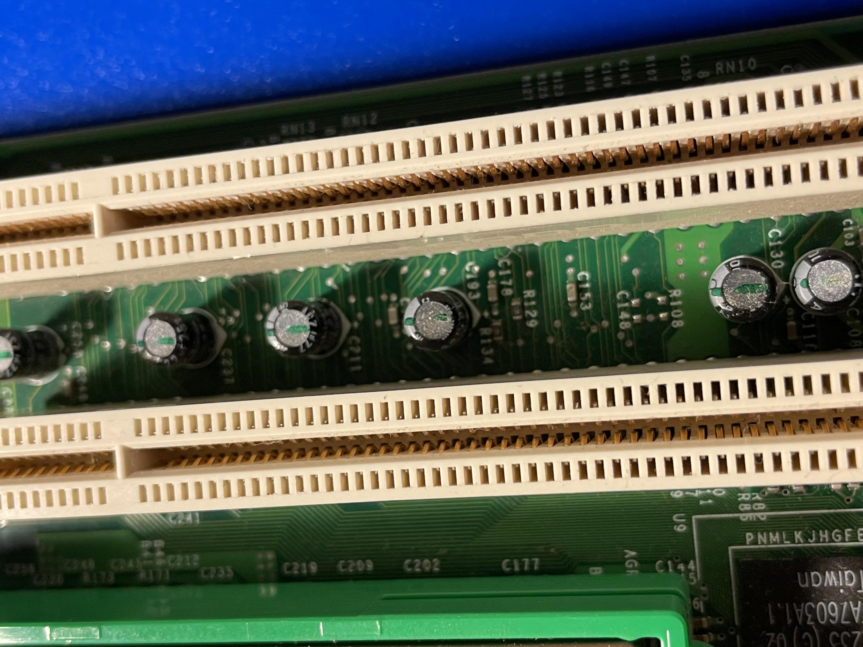

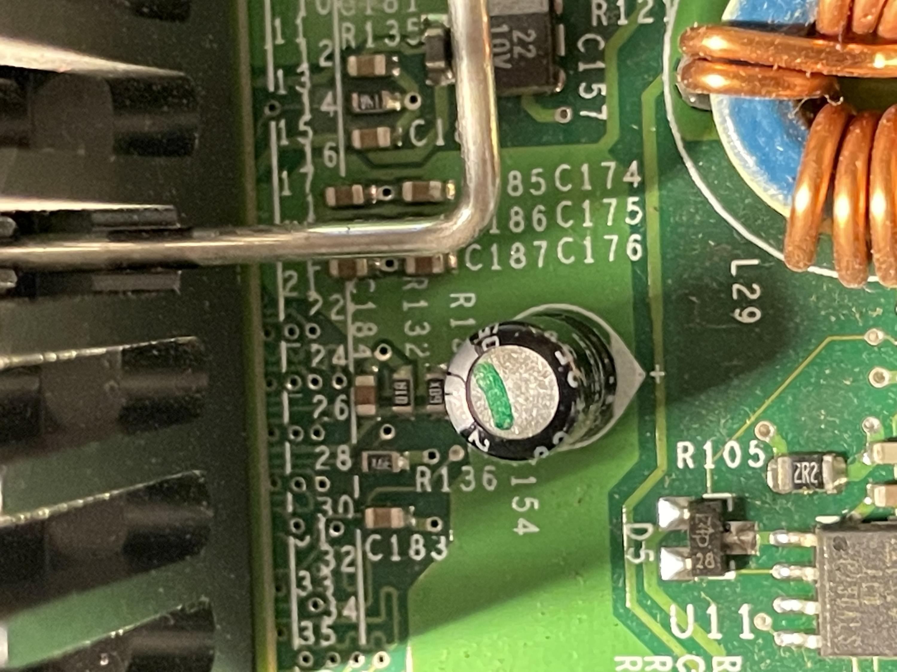

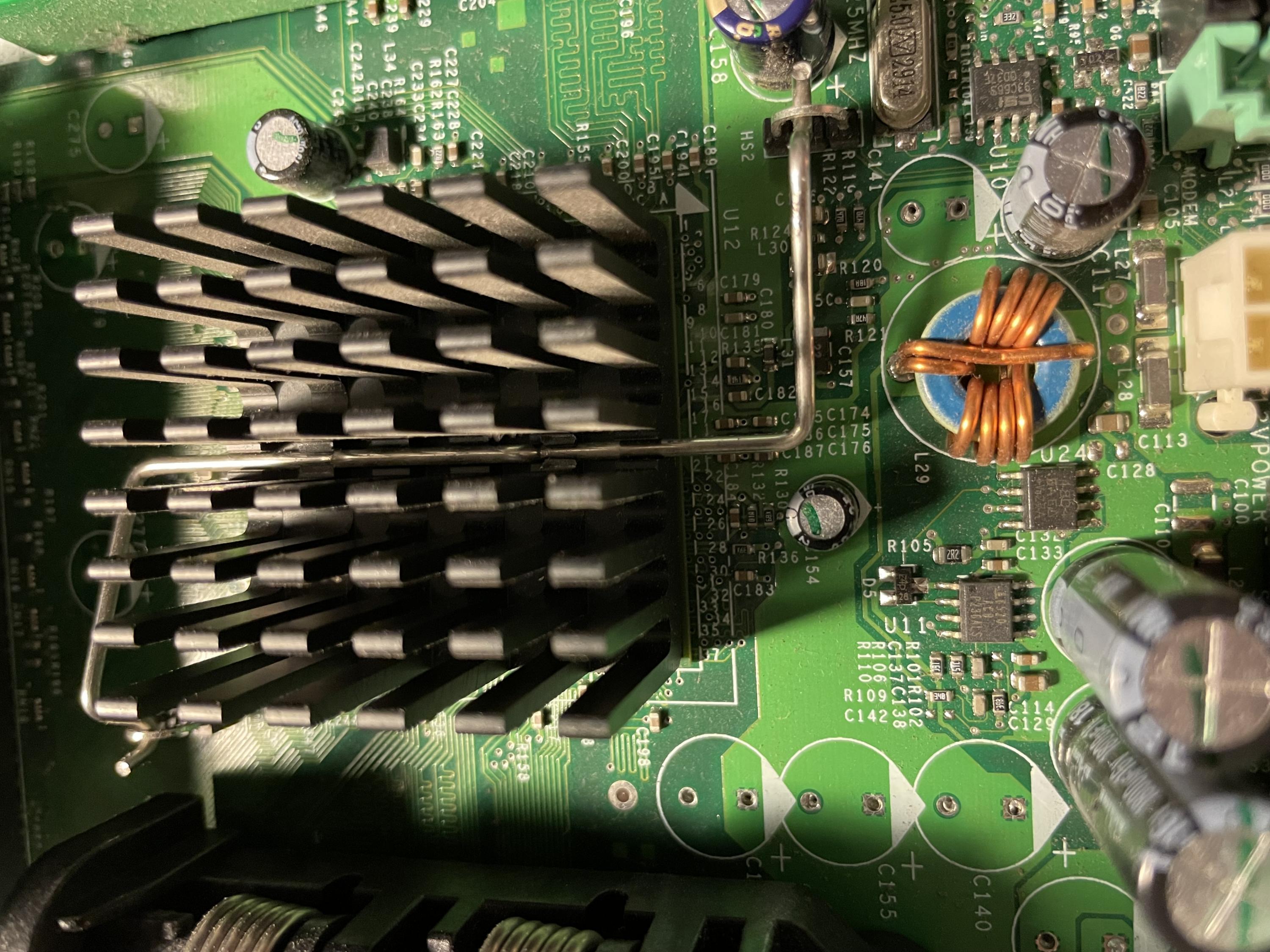

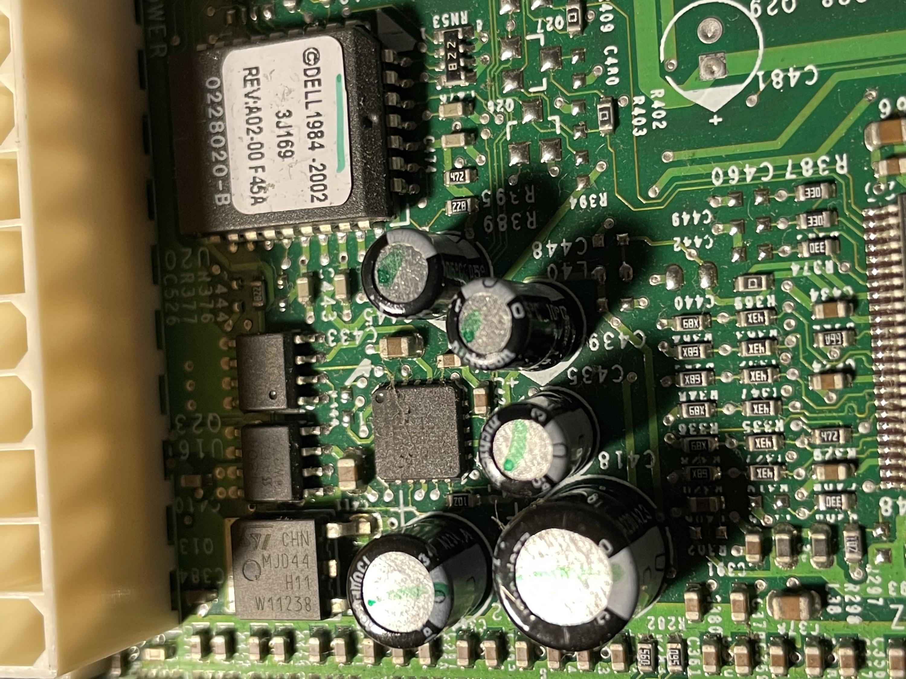

    Howdy folks,

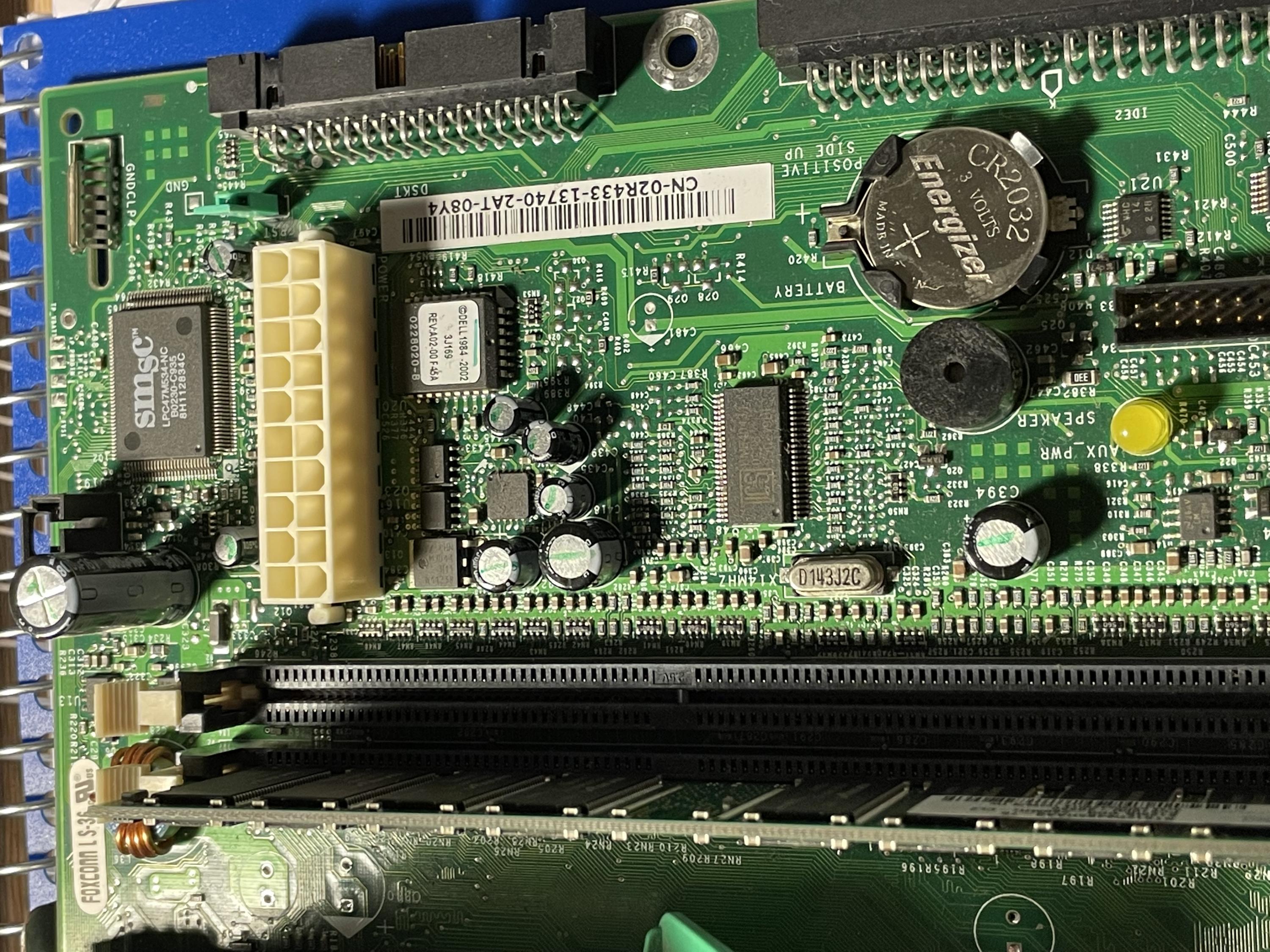

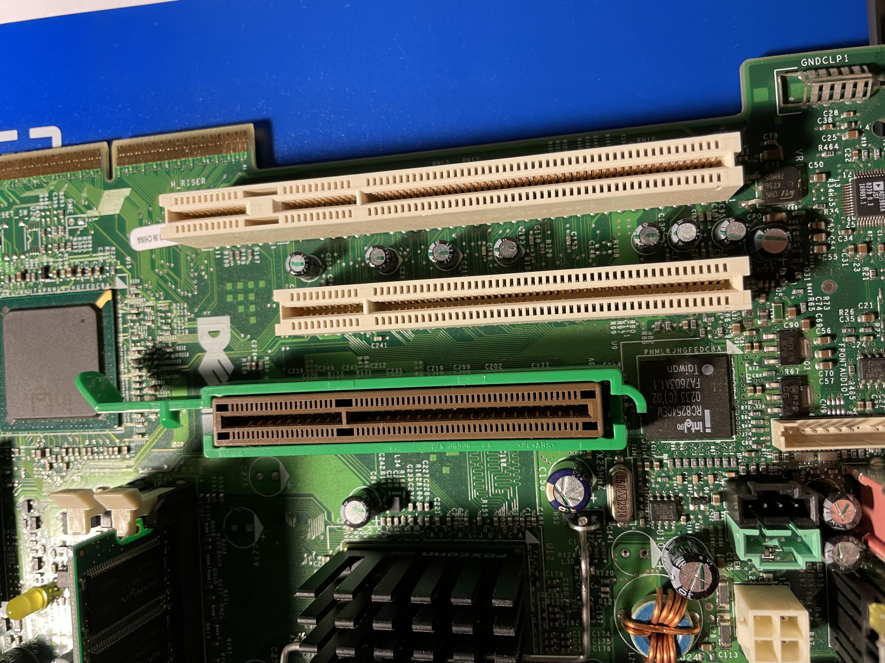

    The GX260 strikes again, I just now noticed that a bunch of smaller caps on the motherboard are bad.

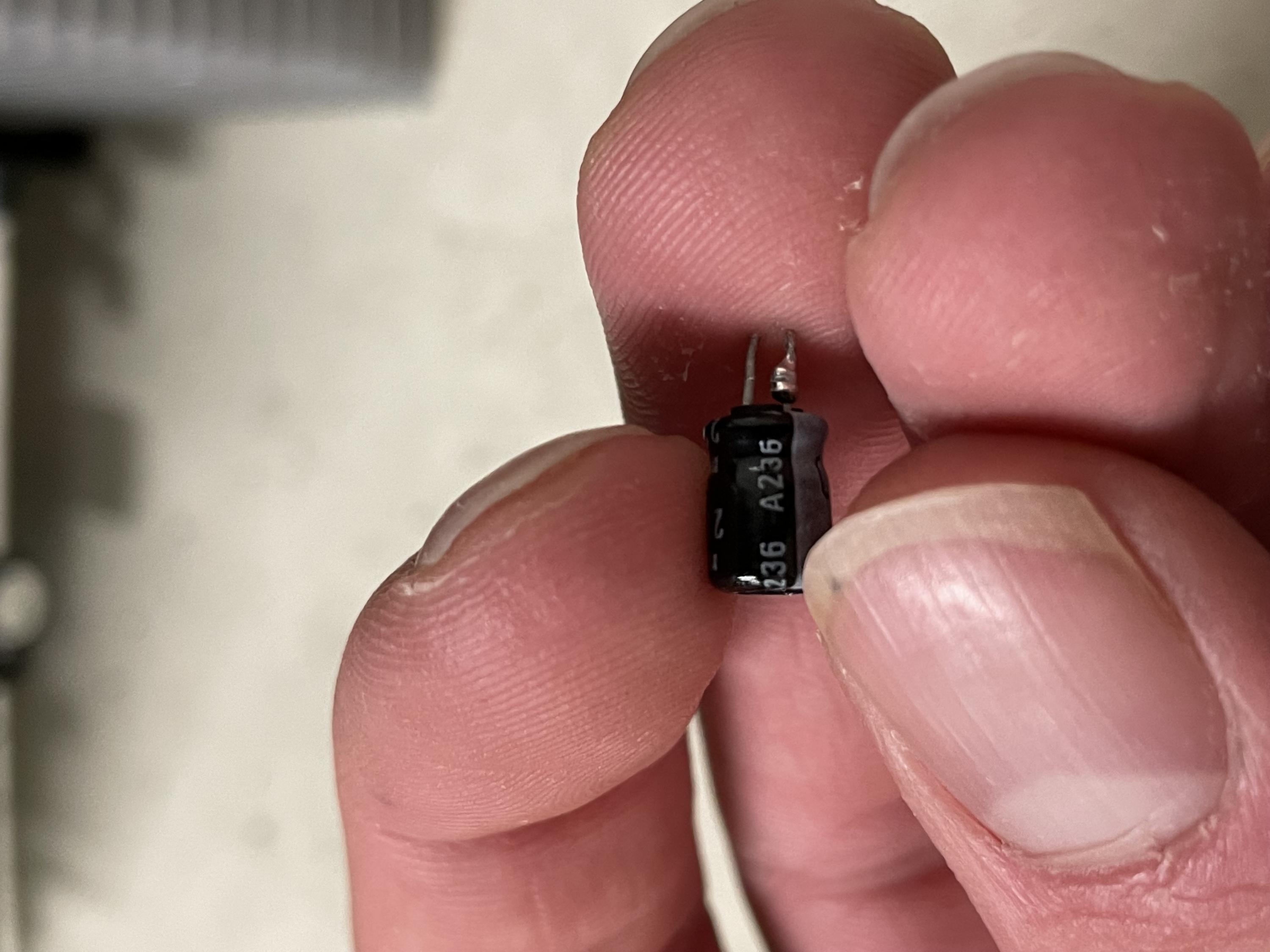

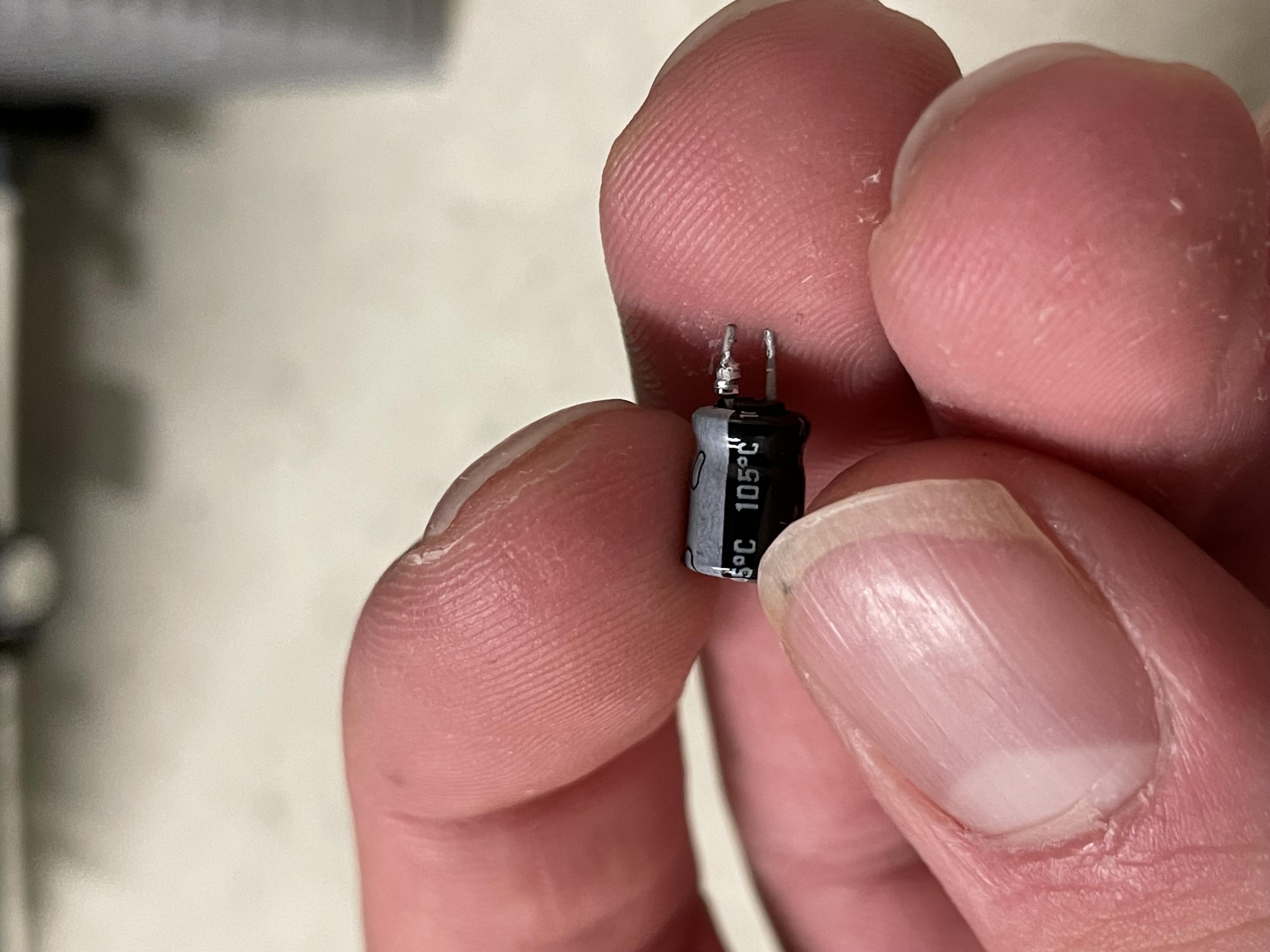

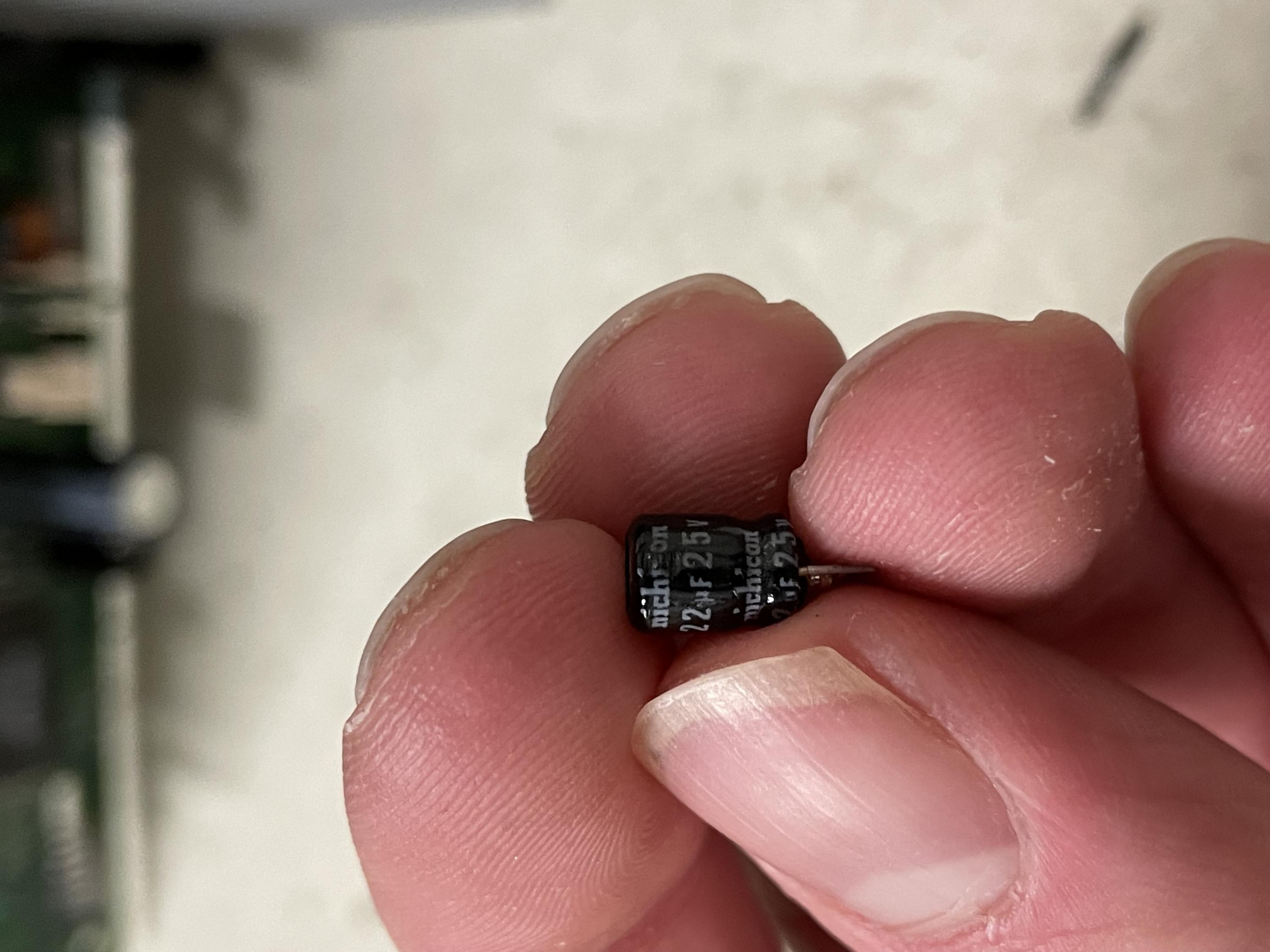

    There's no indication of what series these are, but they have the same color wrap as the HM series. They're rated at 22uf and 25v and about 5mm x 6.5mm. The only other markings are the temperature rating (105 degrees Celsius) and what I assume is a date code - A236. The data sheet for the HM series doesn't include caps with these ratings. I've attached some images of the caps themselves and where they are/were on the motherboard.
    Does anyone know what exact series these are? Also, what would be a suitable replacement?
    Cheers,
    -SwedishDiesel
    • 31267
    Re: Mystery Nichicon 22uf 25v Caps
    panasonic FR or tantalum.
