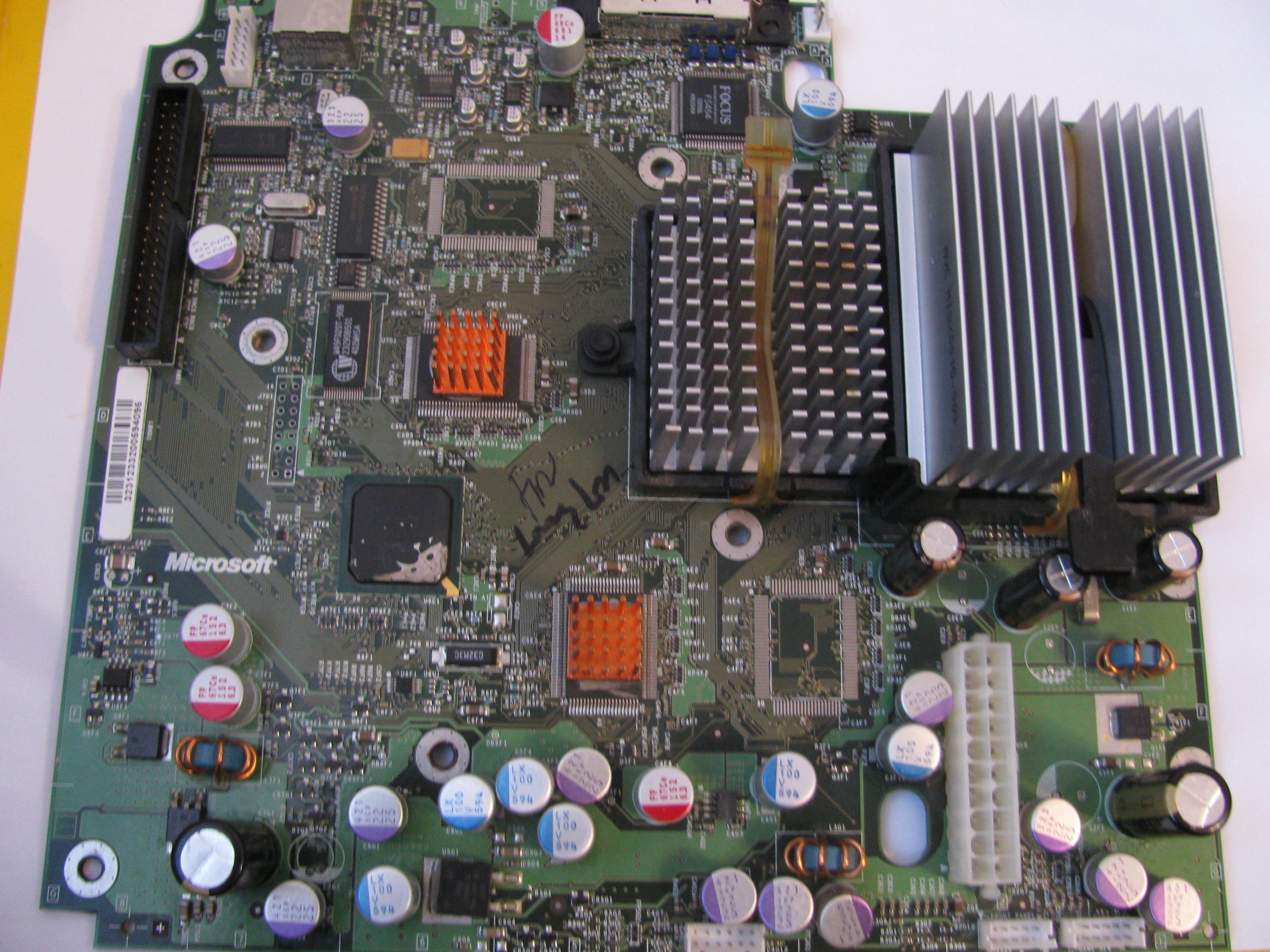

        So i'm making a return to this project. I replaced the xbox PSU with a PC one and now i'm looking to replace the caps on my 1.4 board.
        Looking for the caps of the board on websites i found myself with some questions.
        Can i use low esr caps instead of general purpose(some are low esr) for this project?
        An example : On the board we have : 1x 16v 680uf Nichicon HM (8x15mm)
        Can i use this cap : http://ro.farnell.com/nichicon/rnu1c...0#techDocsHook
        (you can change the language in the top right area, flag icon)
        Another example:
        3x 6.3v 1500uf Nichicon HD (10x20mm)
        Replacement:
        http://ro.farnell.com/nichicon/plg0j...rfnonsku=false
        How low can i go with the esr?
        Also can i use caps that do not fit properly, like size, diameter, lead spacing? Are there any issues with this.? I really dont mind if the board will look funny.
        Notes:
        Cost is not an issue for this project.
        Quality of the caps is.
        I want to keep the base values as they were, like voltage and capacitance.
        I'm not an electrical engineer
        Many thanks.

          • Nov 2016
          • 297
          • Venezuela
          #44
          Re: Original Xbox Replacement Caps
          Something is wrong with farnell because nichicon lg does not have a 1500 uf cap on the datasheet, but they do have a 1200uf which should be ok to replace those hd, because of the lower esr and higher ripple spec.
          Use low esr to replace low esr caps, And for the general purposse caps you dont need low esr just look for something with similar specs and from a good brand ( nichicon, chemi con, rubycon, matsushita...)

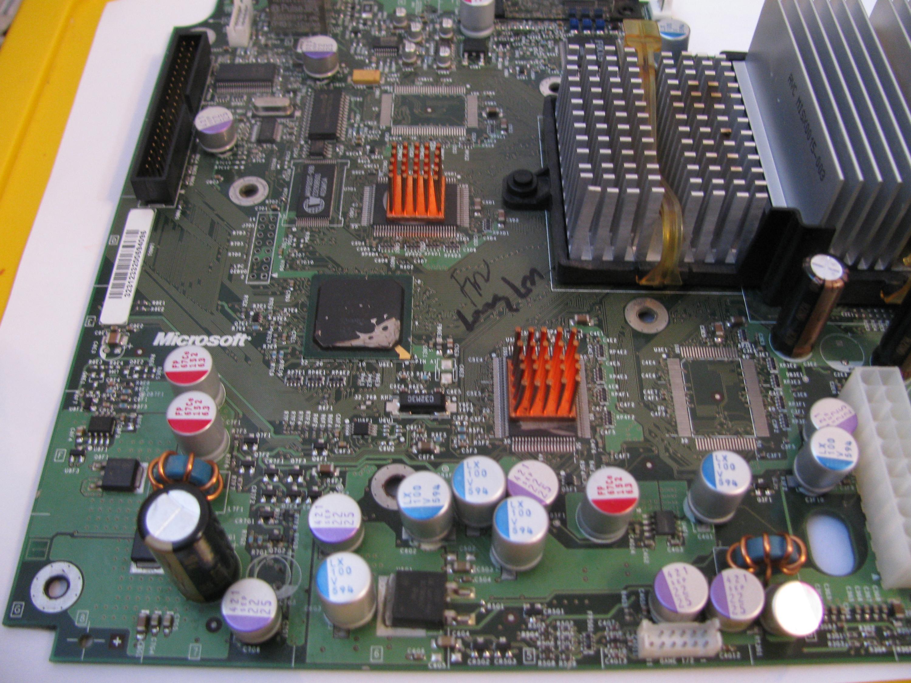

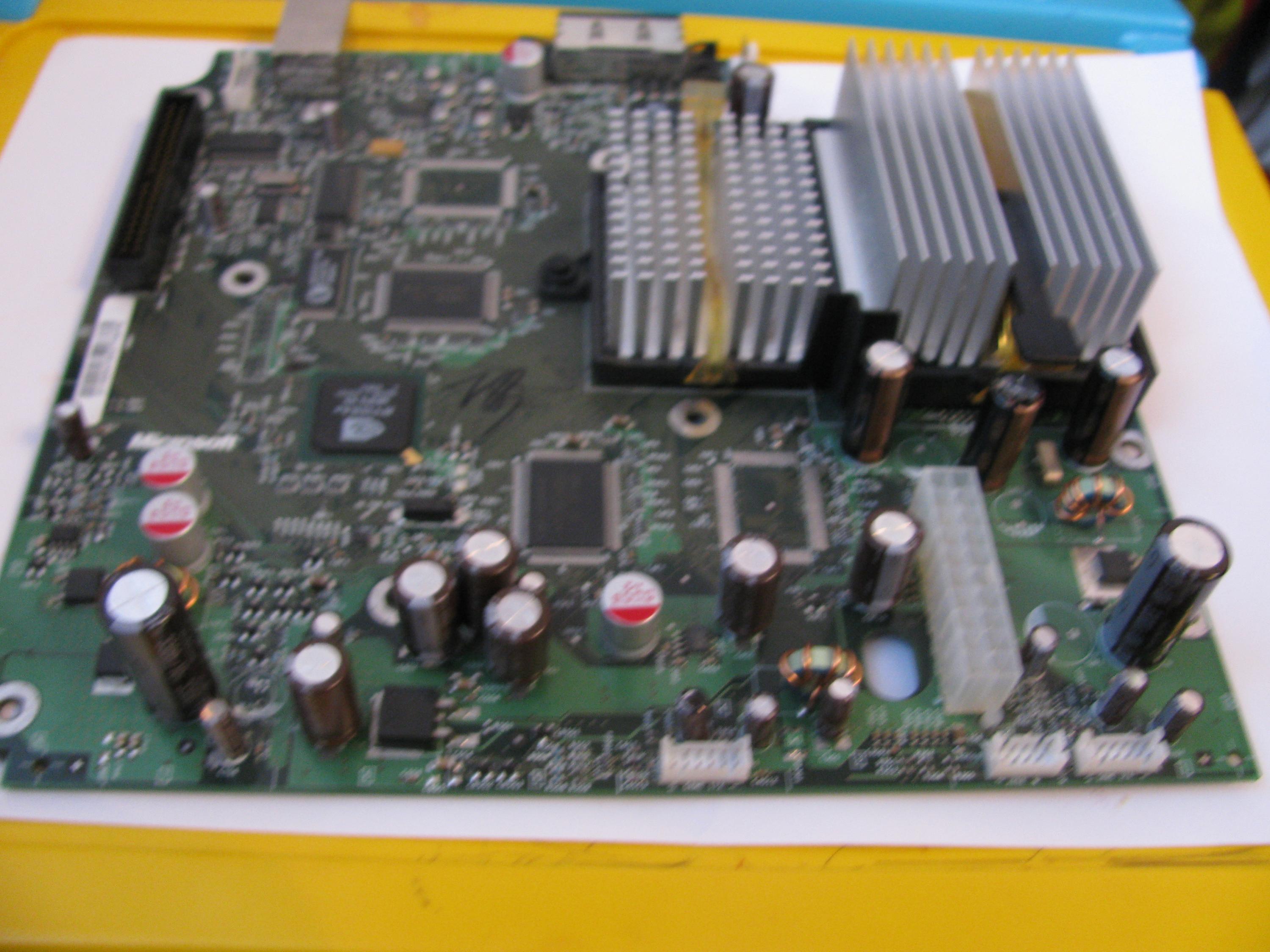

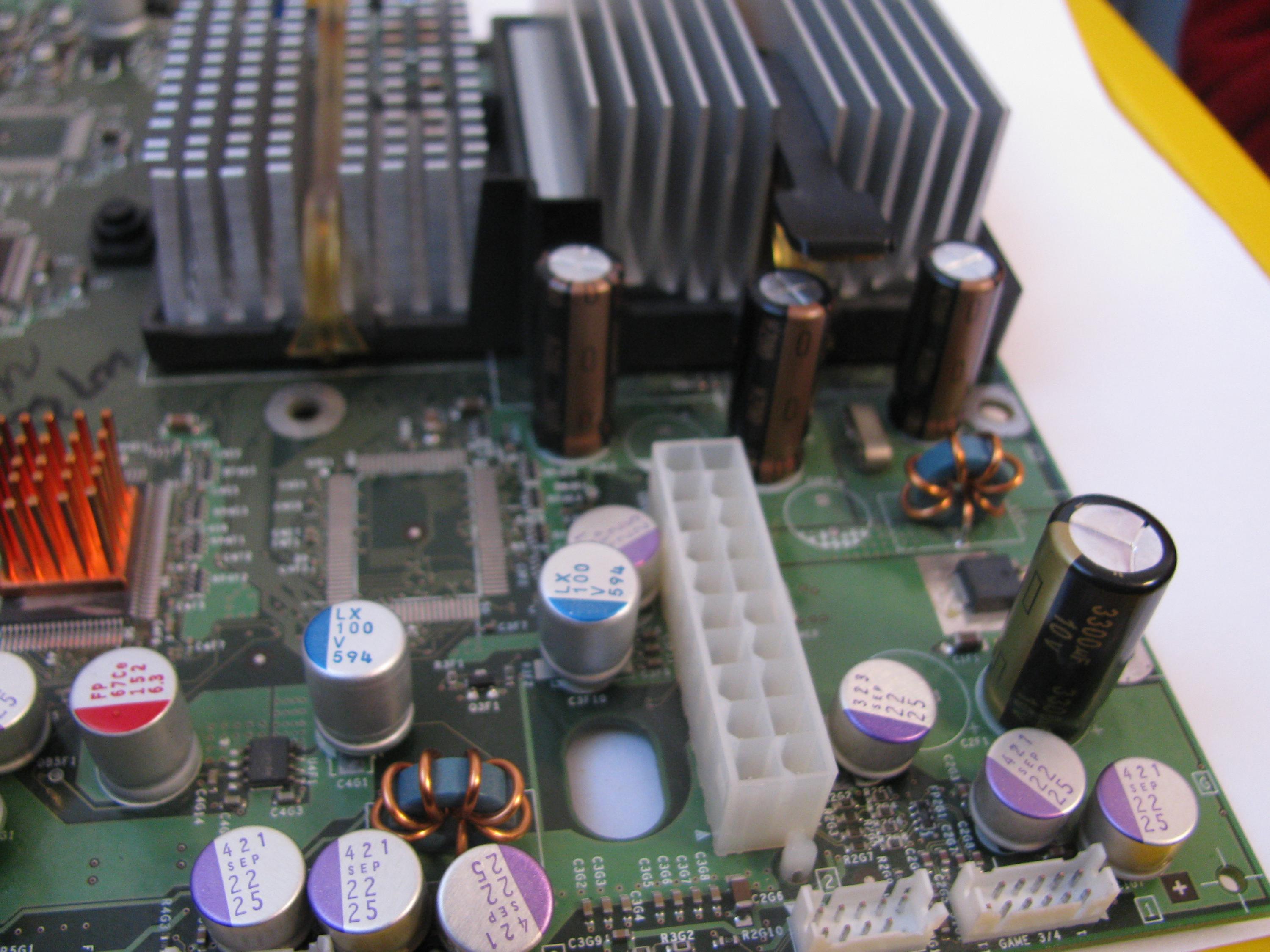

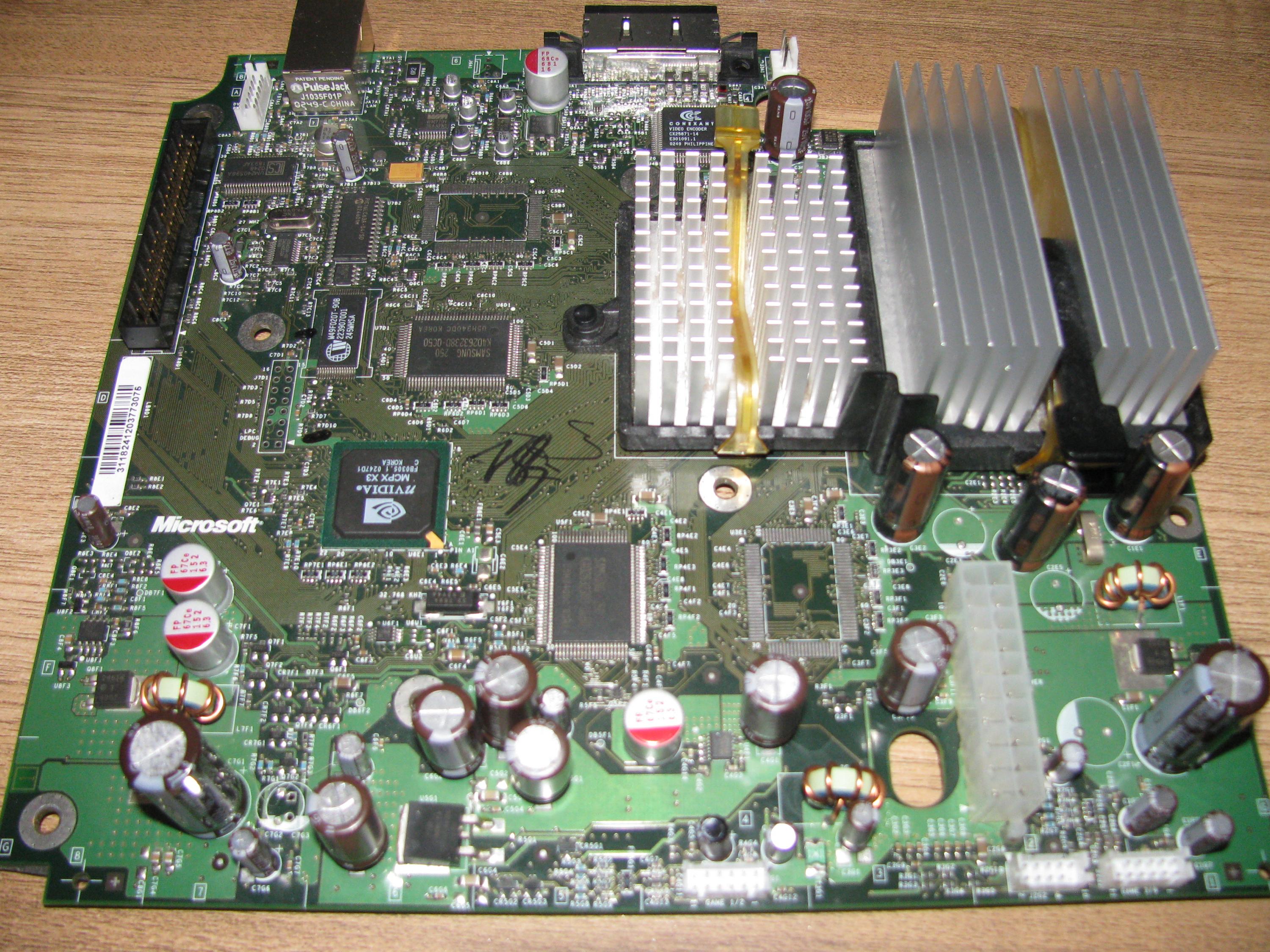

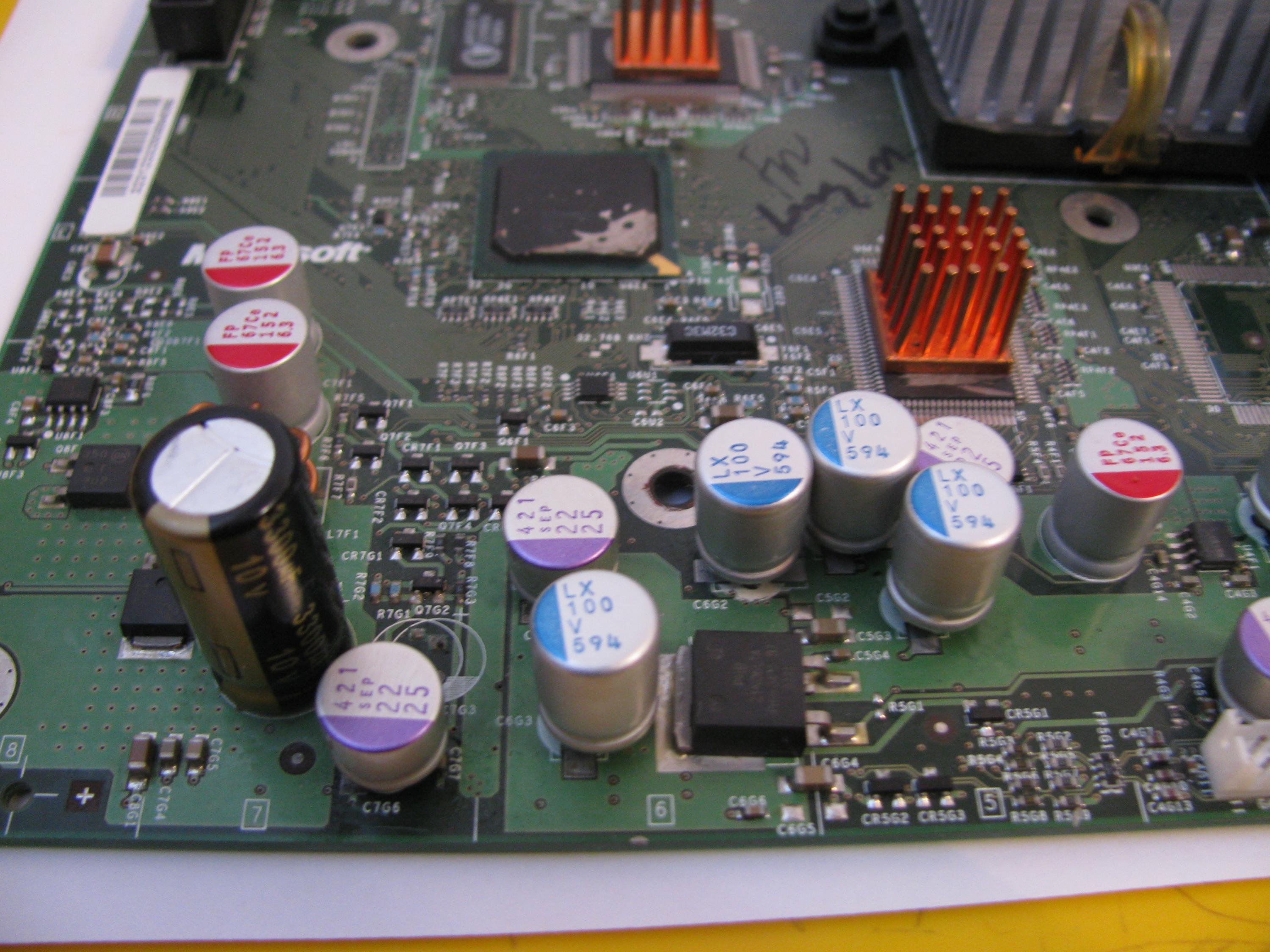

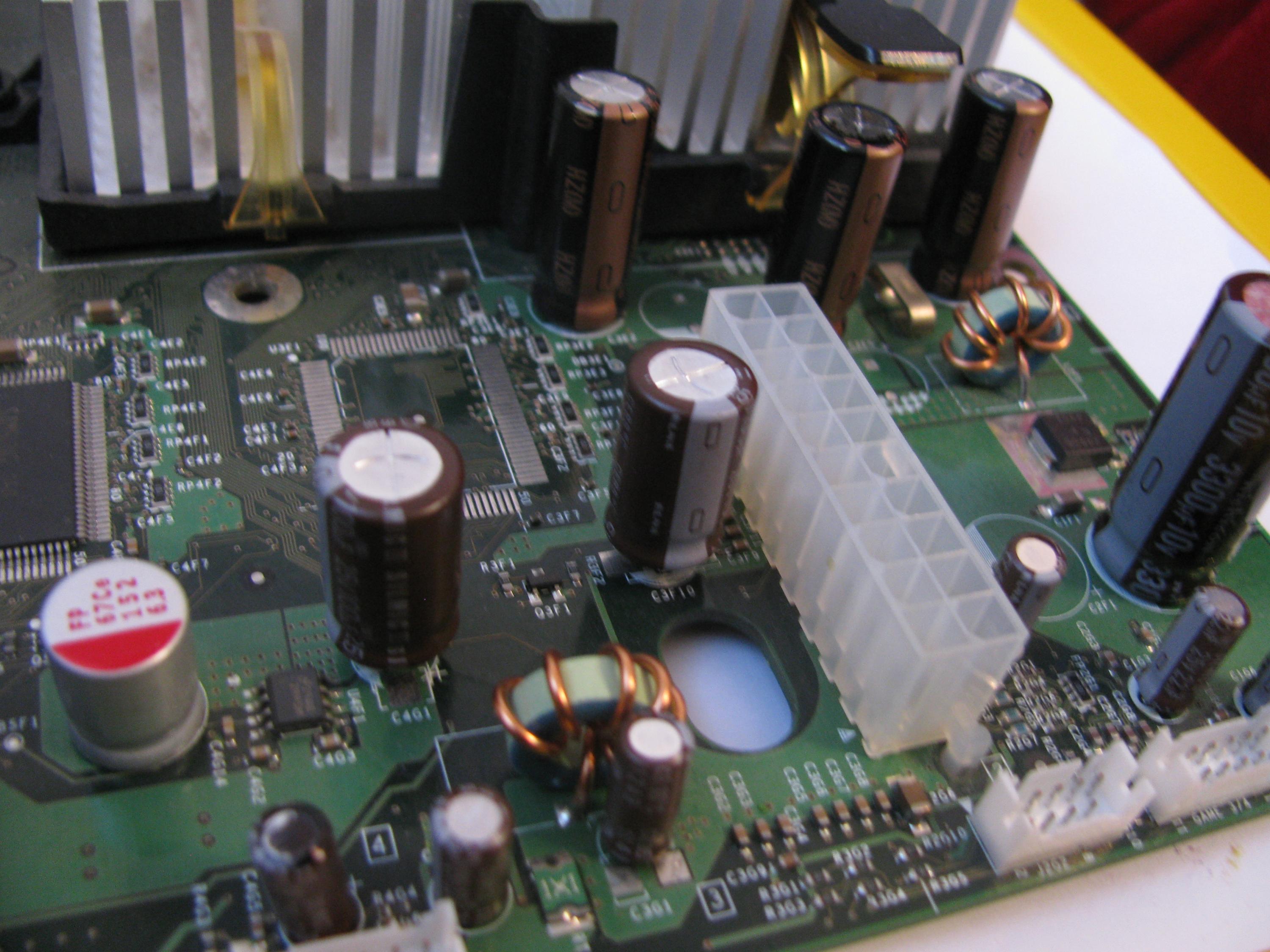

                  #48
                  Thanks.
                  I found out that the xbox has digital only output.

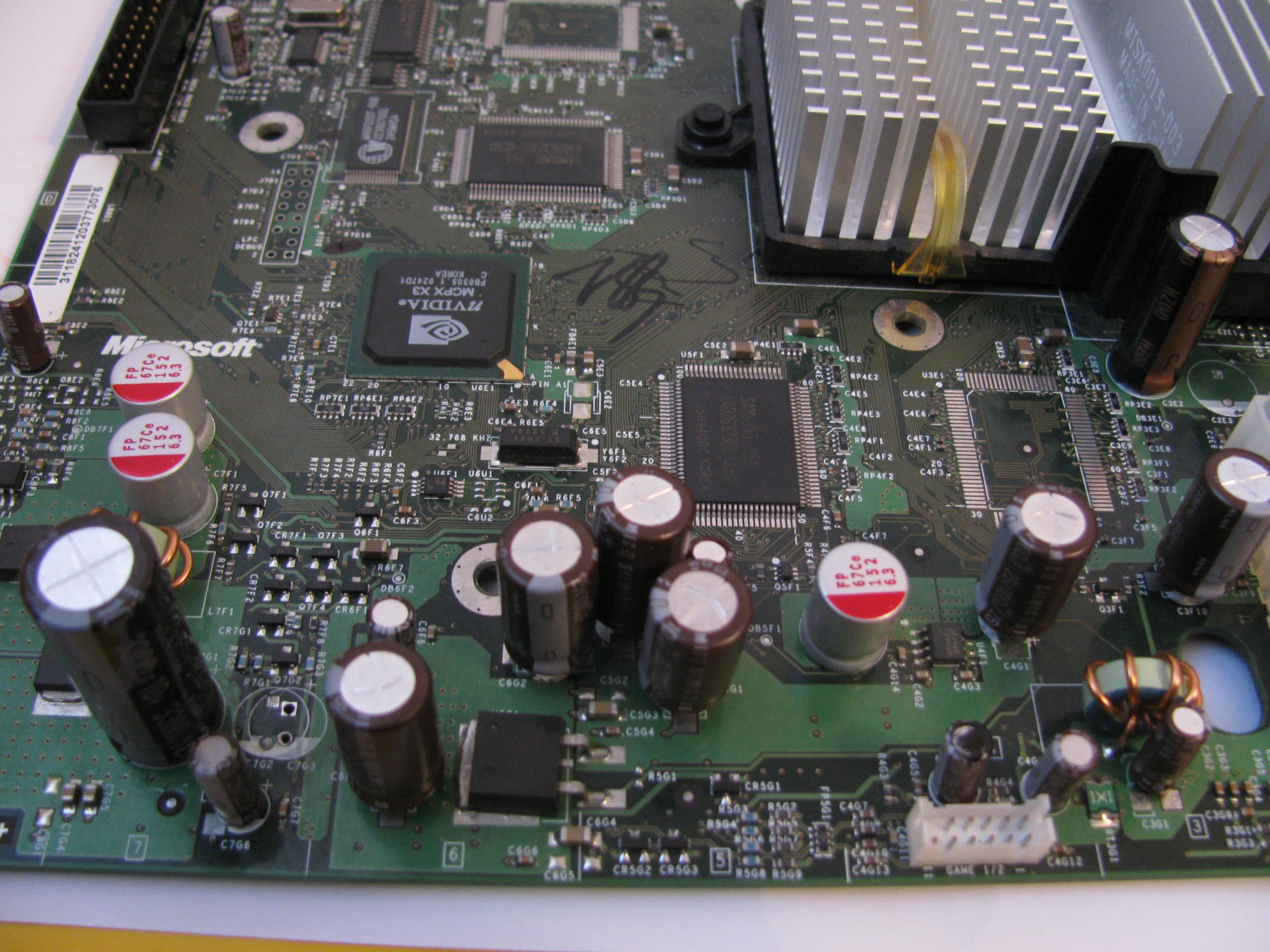

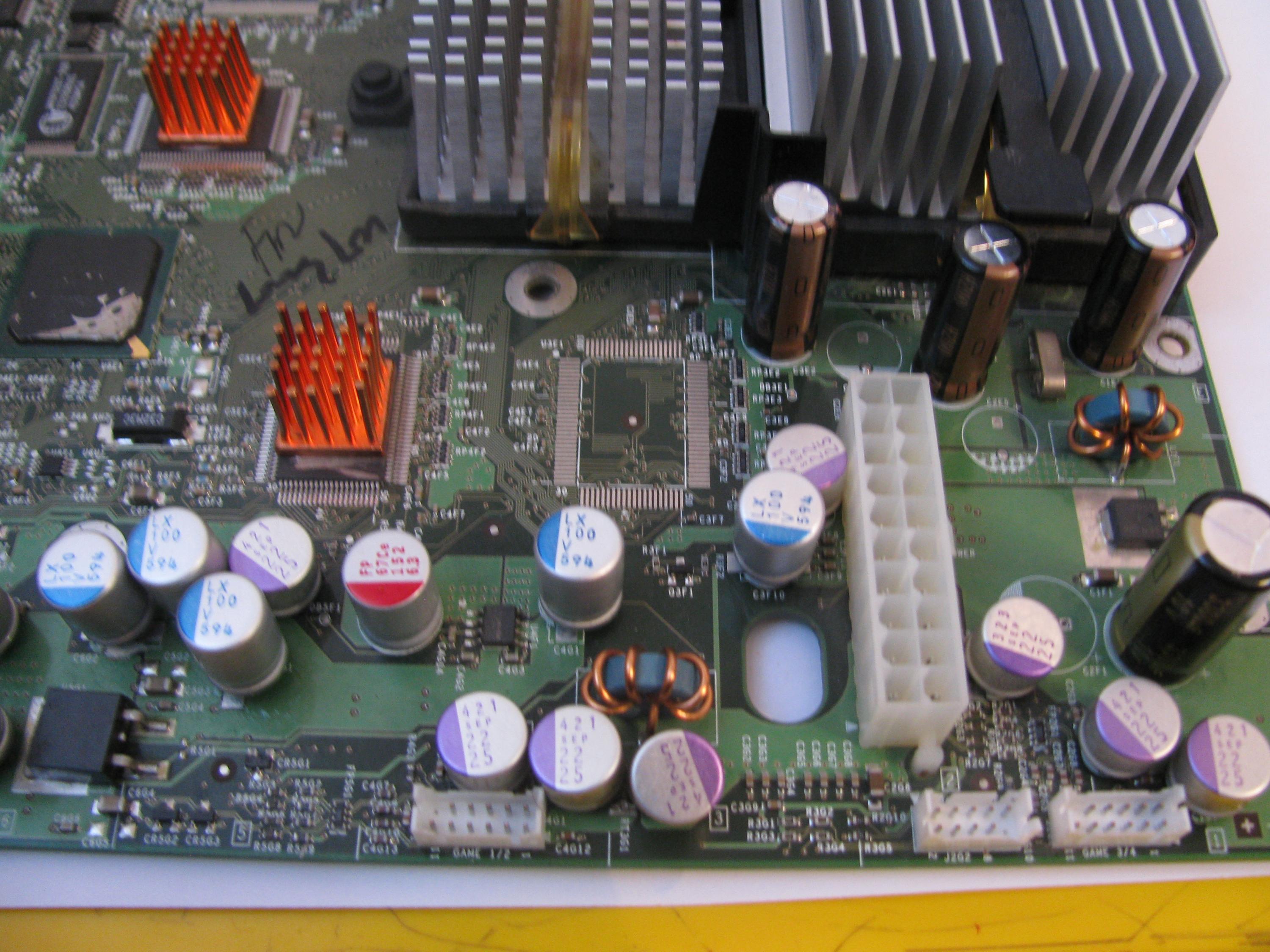

                  So i managed to finish my project here. I started with a trash xbox mobo. The capacitors were in a bad condition. Have leaked and bulging.
                  Trash board(now is a good one) uses:
                  -Nichon Hz near the cpu
                  -Nichicon HM
                  -Elna capacitors
                  -some Nichicon polymers
                  Values for capacitors used are the same as original.
                  Then i moved to the real deal. This board is polymer only. Almost same values used.
                  Exception is that i used 35v 100uf instead of 25v 100uf.
                  Capacitors used:
                  Nichicon HZ, Panasonic FM and polymers from Nichicon.
                  All in all i attached some pics for everybody to see.
                  I want to thank OP and people who replyed in this thread.
                  PS: My skill with the iron is mediocre at best but considering i didnt not solder since i used to be student i think it turned well. Learned a lot doing this small project.

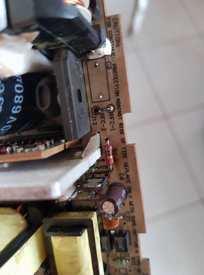

                      I need help, does anyone know which capacitor is missing?
                      Foxlink ftps 0007 rev b
