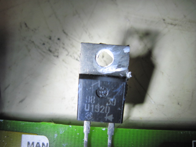

                        Can you take good pictures of the MOSFET?

                            #233
                            Re: Help with Motor Control Board
                            This is the 2 prong one next to it.
                              #234
                              This one is a Diode.
                                #235
                                Well, I am glad I asked for picture because in post 230 you have the numbers as 'W33B20' that is why I could not find any info on it.
                                The actual numbers as printed on the body is W33N20, so it is 'STW33N20'
                                http://www.mouser.com/ProductDetail/...pYC6krShfGCA==
