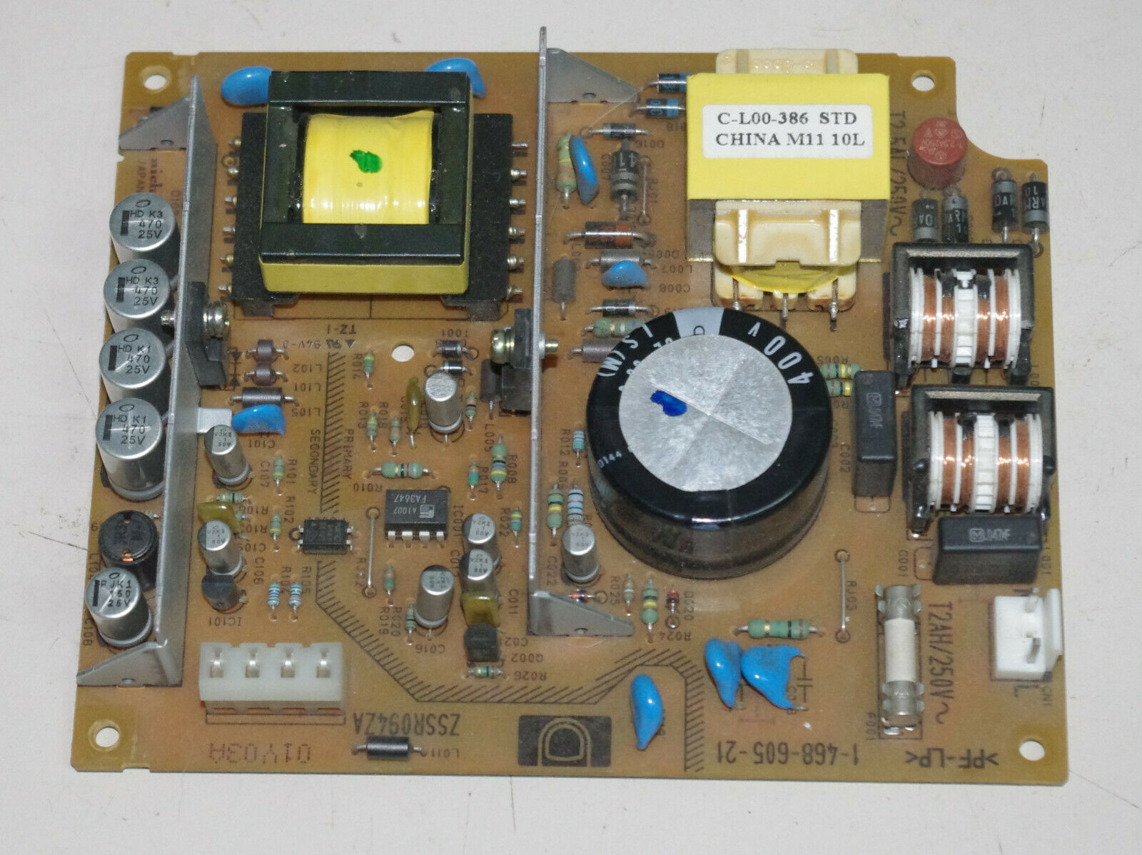

    Just had a Sony PlayStation PS2 in with a symptom of not powering up. The problem was not the ribbon cable this time, it was the internal power supply.
    Delta ADP-75EP. Plugged it in, no 12V coming out. Nothing physically wrong, fuse, bridge rectifier, transistors and diodes checked all OK. Capacitor C3 (35V 33uF) checked good with the DMM, but not with the ESR meter. Replaced C3 with a 50V 100uf Nichicon PW series. Since IC2 (the white optocoupler P421f) was on the same line than the C3 I just replaced, I took it out, measured it and she was open all around. So I replaced IC2 with an NEC 2561 optocoupler that I stole out of a junked ATX power supply. Verdict: I've got a working PS2!
    That is another example of not trusting the CAP setting on the DMM even if you paid 500$ for it. Always check caps with a good ESR meter.

    Thank you sir for posting this info, you have taught me a valuable lesson regarding esr meters and my lack of one.
    I had found the bad opto and replaced it with the same part infact but no joy until I found this post, swapped in a 47uf 50v cap and the psu works perfectly again.

      glad this worked for you too! BTW, this PlayStation is still going strong to date. I guess it has been a few years since I fixed this thing, but I remember that the cap and the opto where bad...

        Thank you for the info. I replaced C3 with a 33uF 65V electrolytic from my junk bin. The PS2 is alive again. This cap is quite a bit larger in size than the original. I didn't test the isolator, but it appears to be working OK.

            I don't currently have any fat PS2 models myself, but I've recently read about few cap failures on these Ltec-equipped Delta power boards, and as in OPs case, it seems to be C3 that usually fails. To add a bit more detail about specific models, the ADP-75EP seems to have been used in 120V SCPH-3900x consoles, and there was also an ADP-75JP that was at least used in 230V SCPH-5000x machines - same story with that. I'm currently unsure if 230V 3900x and 120V 5000x units are affected too.
            The primary cap on said Delta power boards is Japanese, the rest consists of 7 Ltec caps that don't look glued to the board, so I'd say just replacing them all before they take any other components with them would be a good idea. Perhaps quite a few consoles were already junked due to Delta skimping a few cents on caps back in the day - shame that Sony too used that supplier...

              pretty irelevent - even the best caps dont last forever.
              whenever i get a switching psu that wont run and is not visibly blown, i change all the small caps FIRST.
              and re-test.
              often it works - comparing the cost of a few small caps to the time it would take to pull and test them, it is better to just replace them first.

                    nichicon HD's - that's the most common caps in ps2's

                      I just found this and wanted to say thank you. I spent an hour checking voltages and trying to find anything that had failed and never would have thought to check the C3 cap. It looked fine, but when I pulled it out of the board it had clearly started to spill its guts. I did the same thing as FatBuck and had a 33uf 65V cap kicking around in a parts bin that I pulled from lord knows what and threw it in. Now I've just got to sort out the busted av output on the mainboard and I'll have another working Phat PS2.
