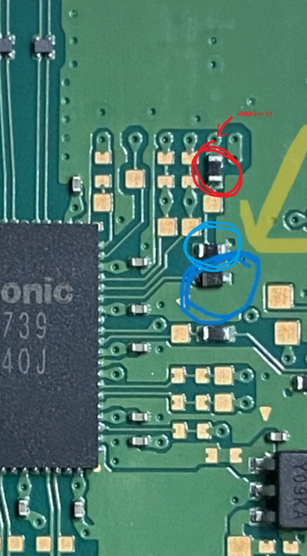

    PS5 EDM-020 HDMI short on pin 19.
    Any body knows where the pin 19 from HDMI trace goes to? it is shorted to ground.
    Update; short disappeared and was able to traced it to pin 46 of the Panasonic chip but first goes through 22-ohm resistor and another resistor and diode is attached to line and ground, my measurement of second resistor was 6.7k red probe on the line.

    Added picture

      Short's gone, and? What the symptoms are?
