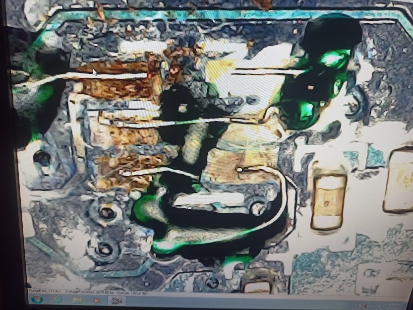

    Re: HP Omen 17-an108nc - 3long and 2 short/memory error/ after capacitor short on 5V
    looks like i fck up real good this time. i found ripped component on other side of board with ripped all traces. i can repair traces but i need to identify this component.
    anybody know what is this?
      I've come across that one before on another HP, it was a 2N7002KDW FET.

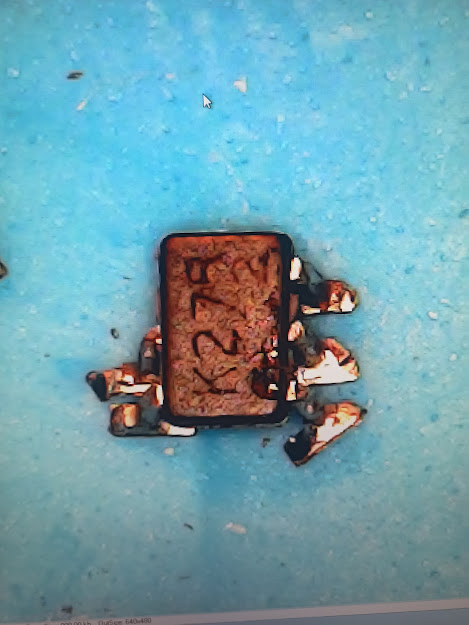

        i fond ic marking K27K on HP 840 G1. by schematic it is L2N7002
        Marking is K2 so looks like it is it
        https://pdf1.alldatasheet.com/datash...002DW1T1G.html

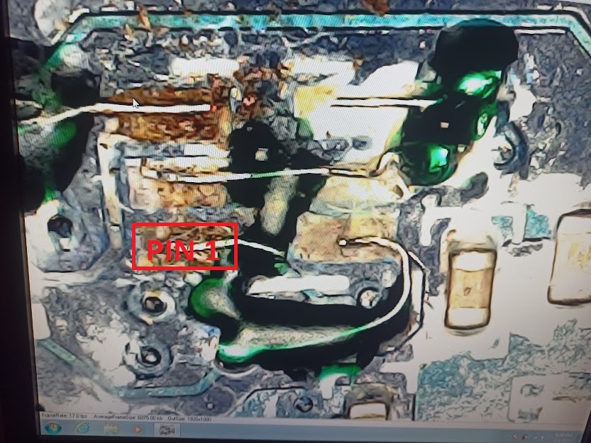

          After ic installation laptop works but no video after restart. only work when shutdown and fresh start. maybe i put ic backwards. can somebody confirm that i put ic like i should? u update bios by windows actualization, but still the same. start till show video took about 10 seconds
            i have been dumbaas to not look on other component. offcourse i put this ic backwards. but after rotate it, the restart problem still persist even with new bios. so i look for another ripped component

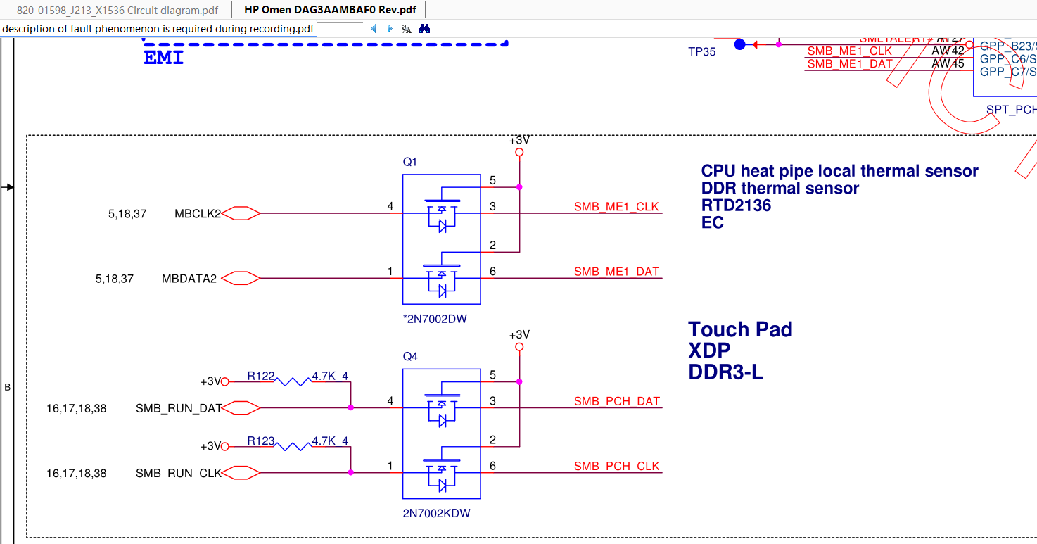

              • mon2
                • Dec 2019
                • 14685
                In the only OMEN schematic, do see that HP has dual mosfets onboard.
                What is the voltage to ground of pin # 2 & #5 of this SOT23-6 package?
                That may give us the confirmation / hint.
