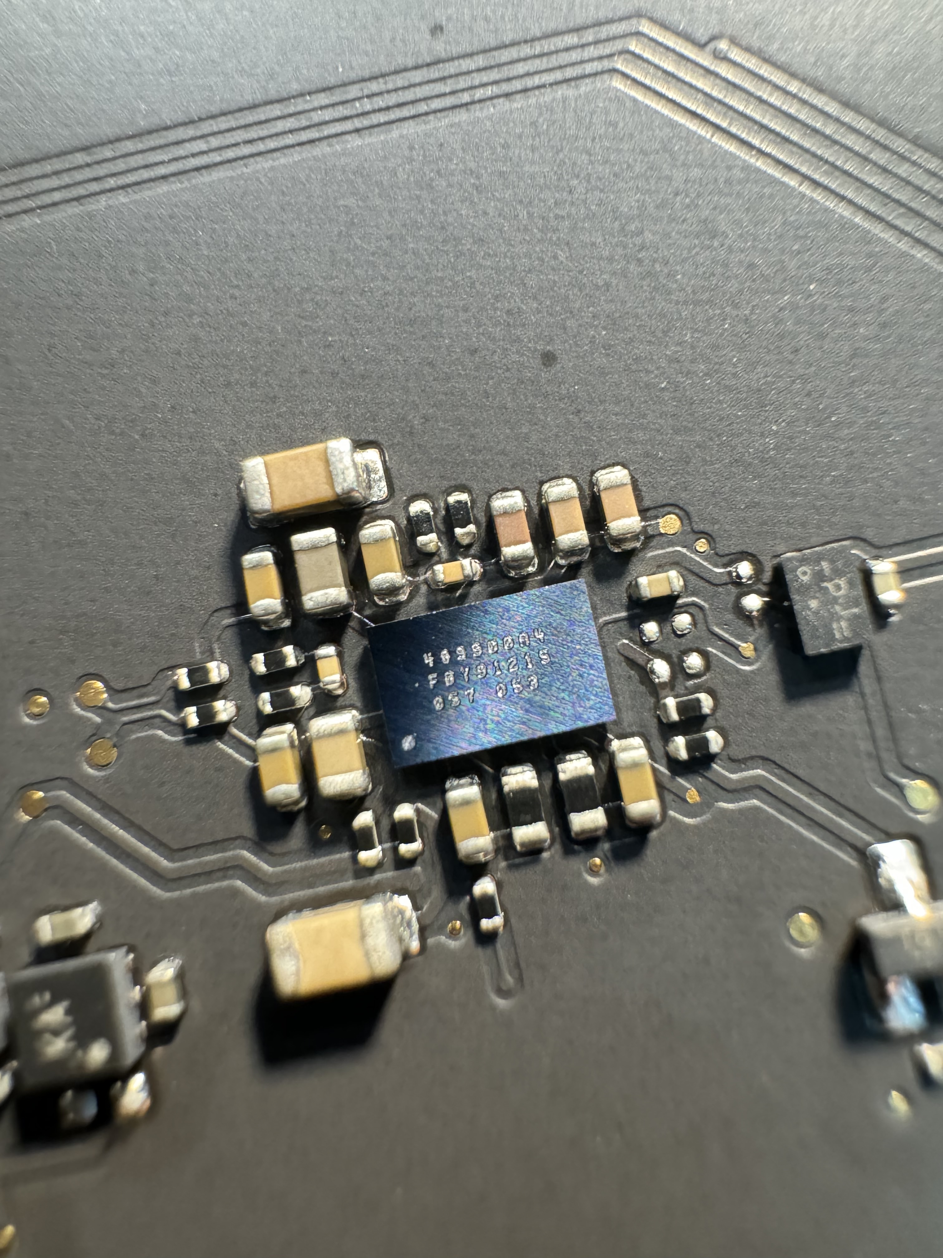

                    Flux and carefully remove F5200 and F5201. This is to remove the downstream / consumer side of this power rail. There does not appear to be a short on the consumer side of the fuses but this step will isolate this regulator. Then power up again and measure the voltage to ground of PPBUS_AON_REG​.
                    Do review U5200 for any possible damage or on surrounding parts. You can also post close up pics of this part.
                    • fricosu007
                      • Feb 2016
                      • 38
                      • romania
                      0.02v and the u5200 is mint allaround it .. Click image for larger version

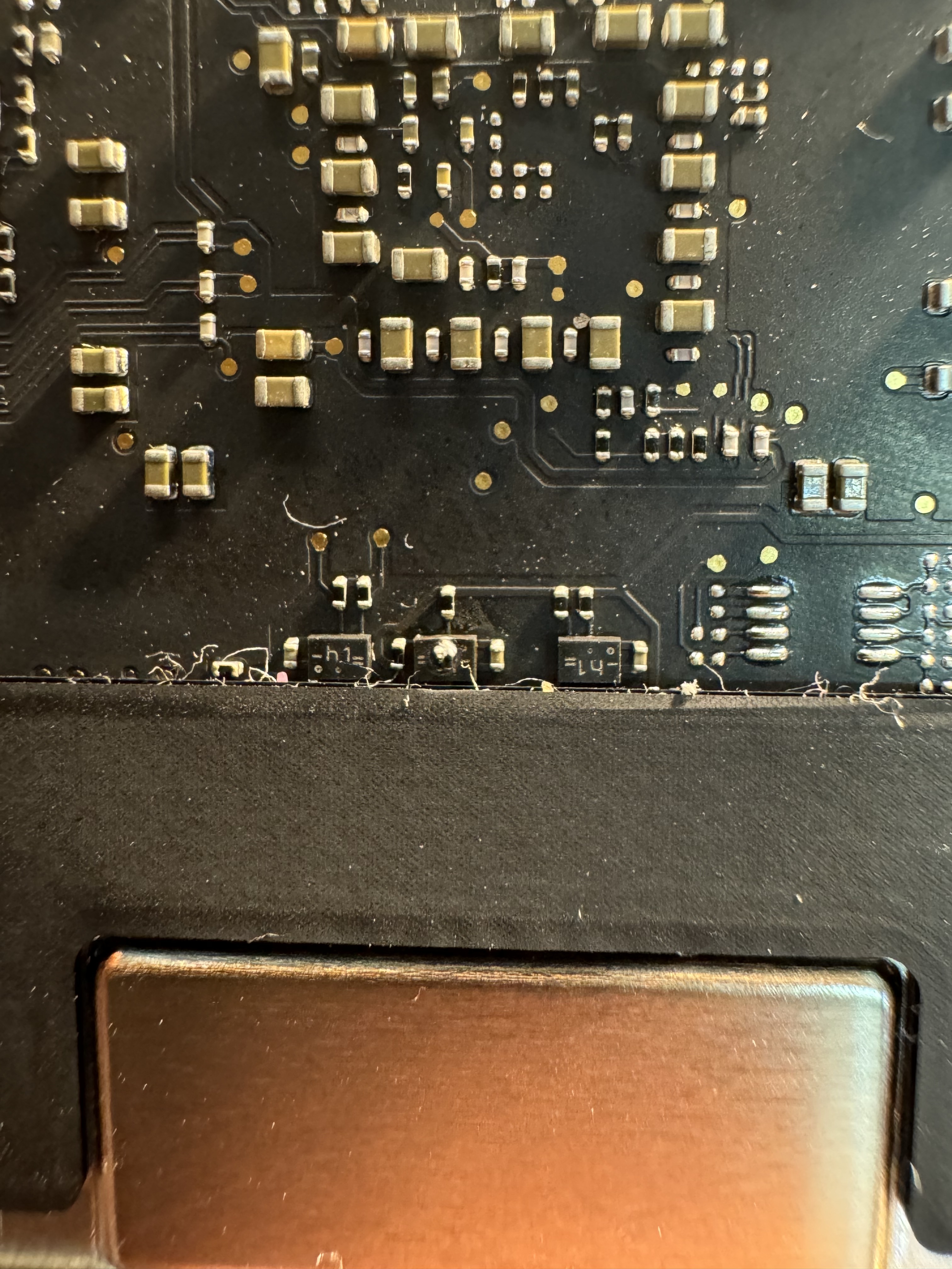

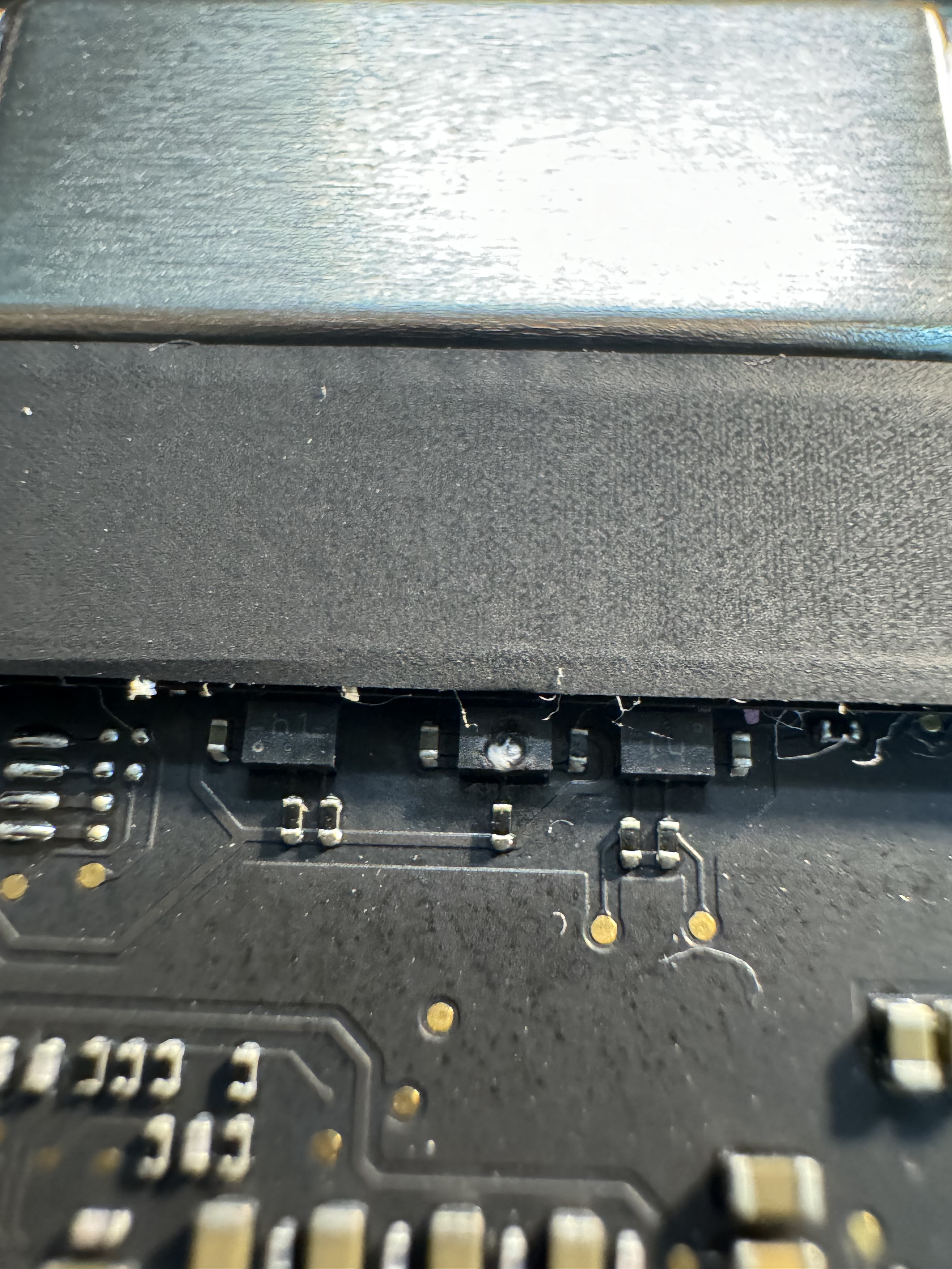

                      • fricosu007
                        • Feb 2016
                        • 38
                        • romania
                        Found something new just now, UD102 BLOWN
                        • mon2
                          • Dec 2019
                          • 14762
                          This is the AHA moment
                          Not sure why it is damaged but will need to be fluxed and carefully removed. Be sure to allow ample time for the solder to be in liquid state.
                          This part is a level / voltage shifter for the SMBUS interface.
