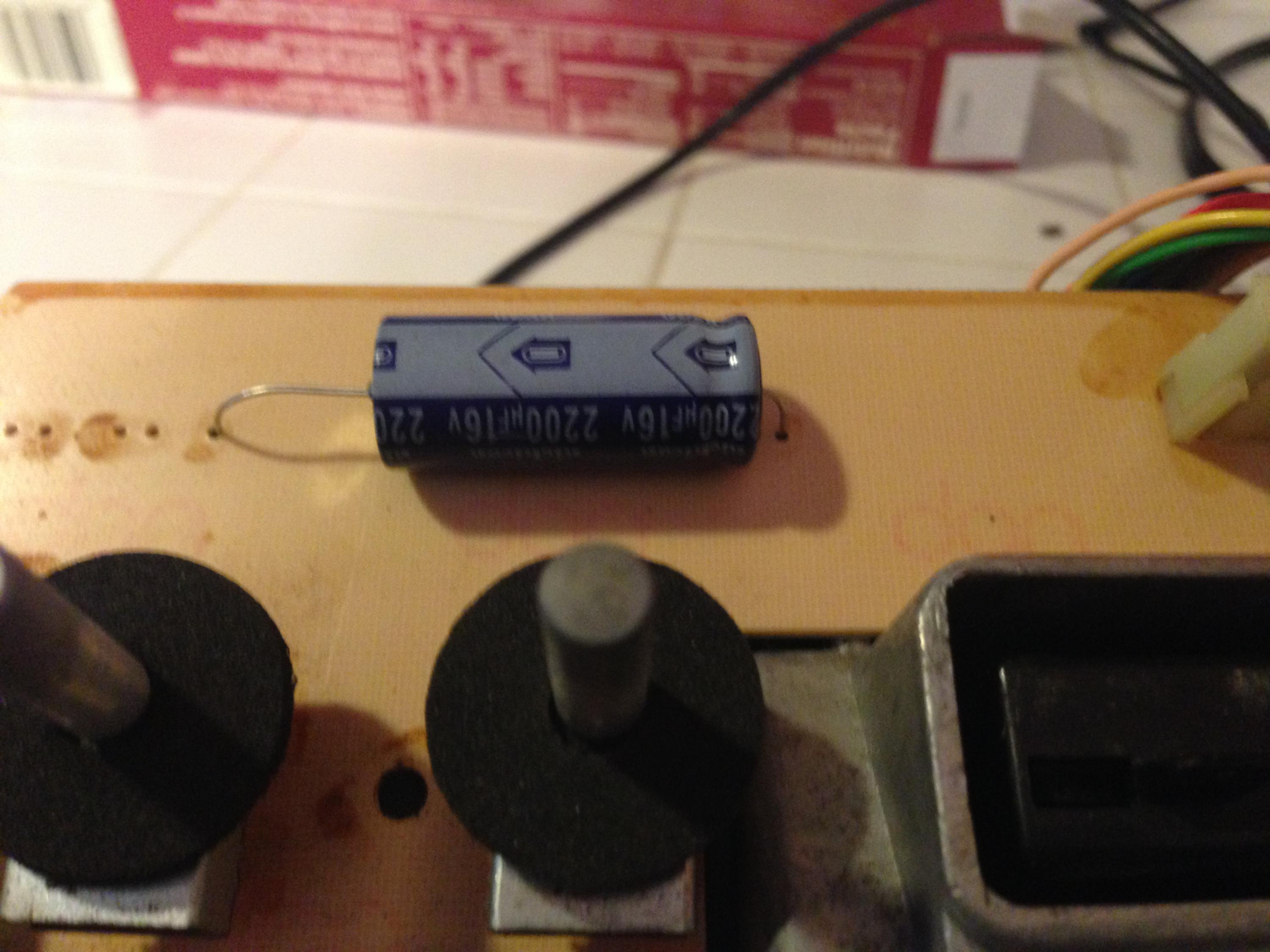

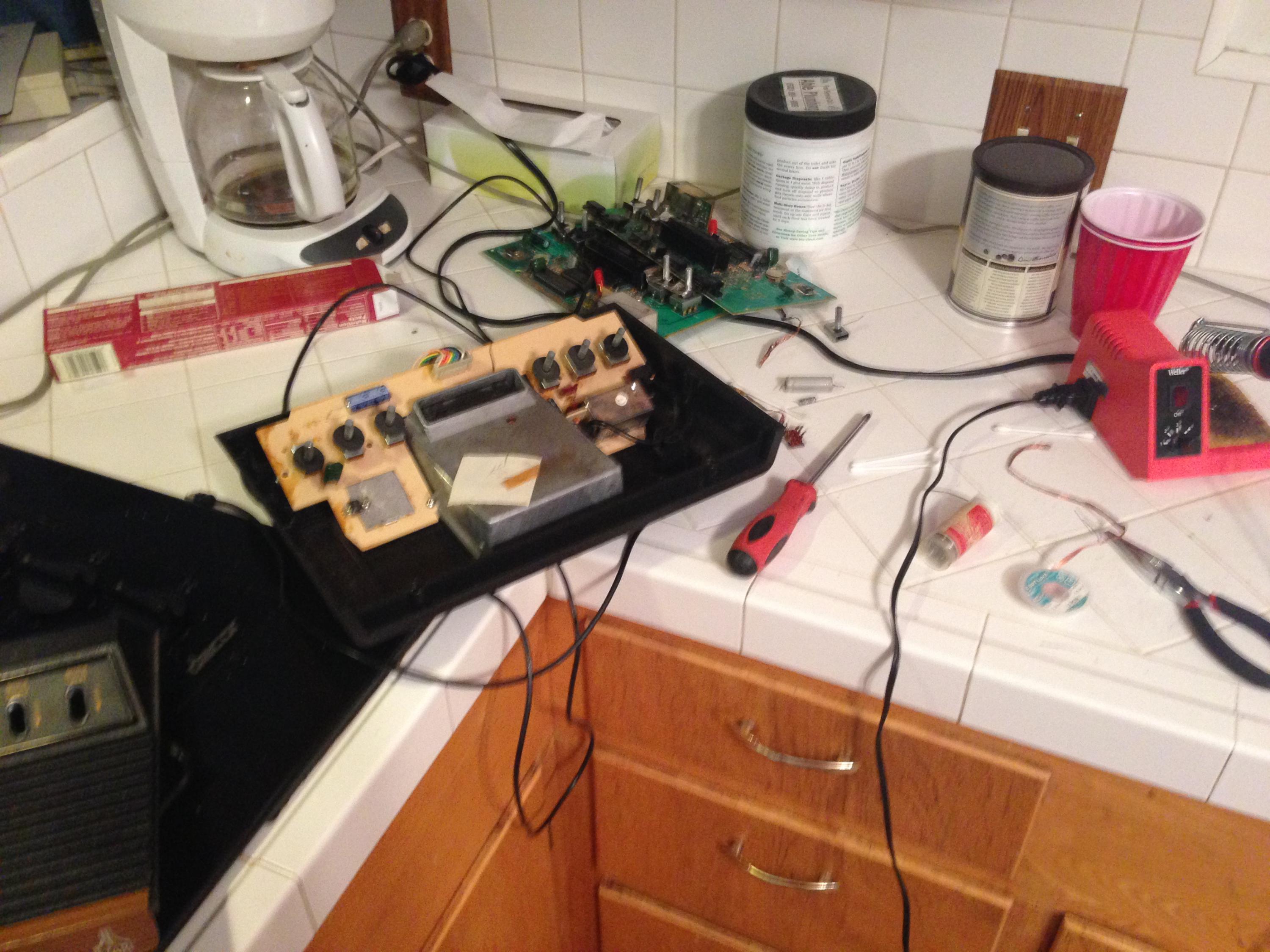

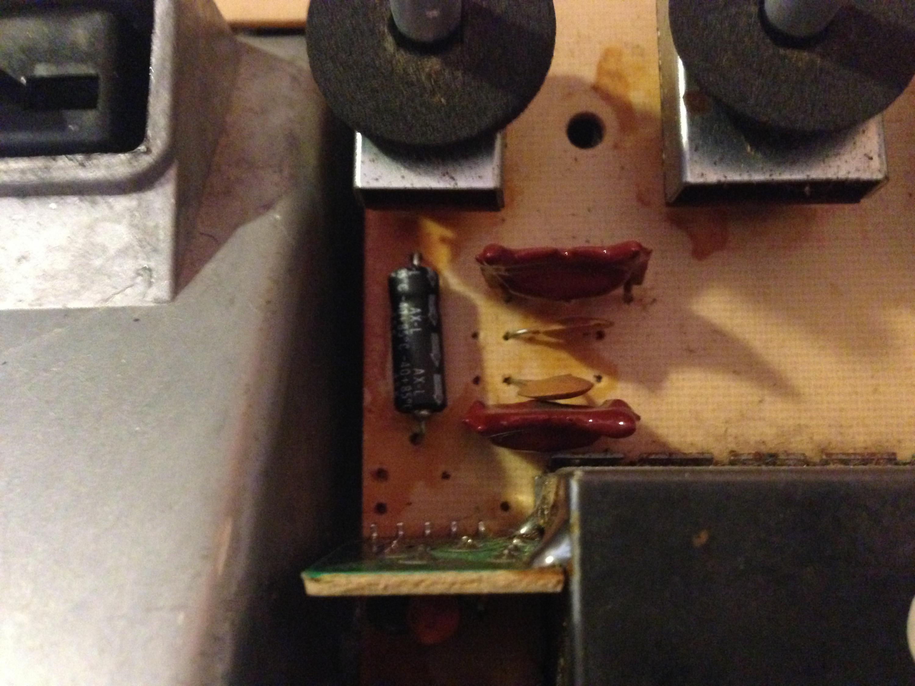

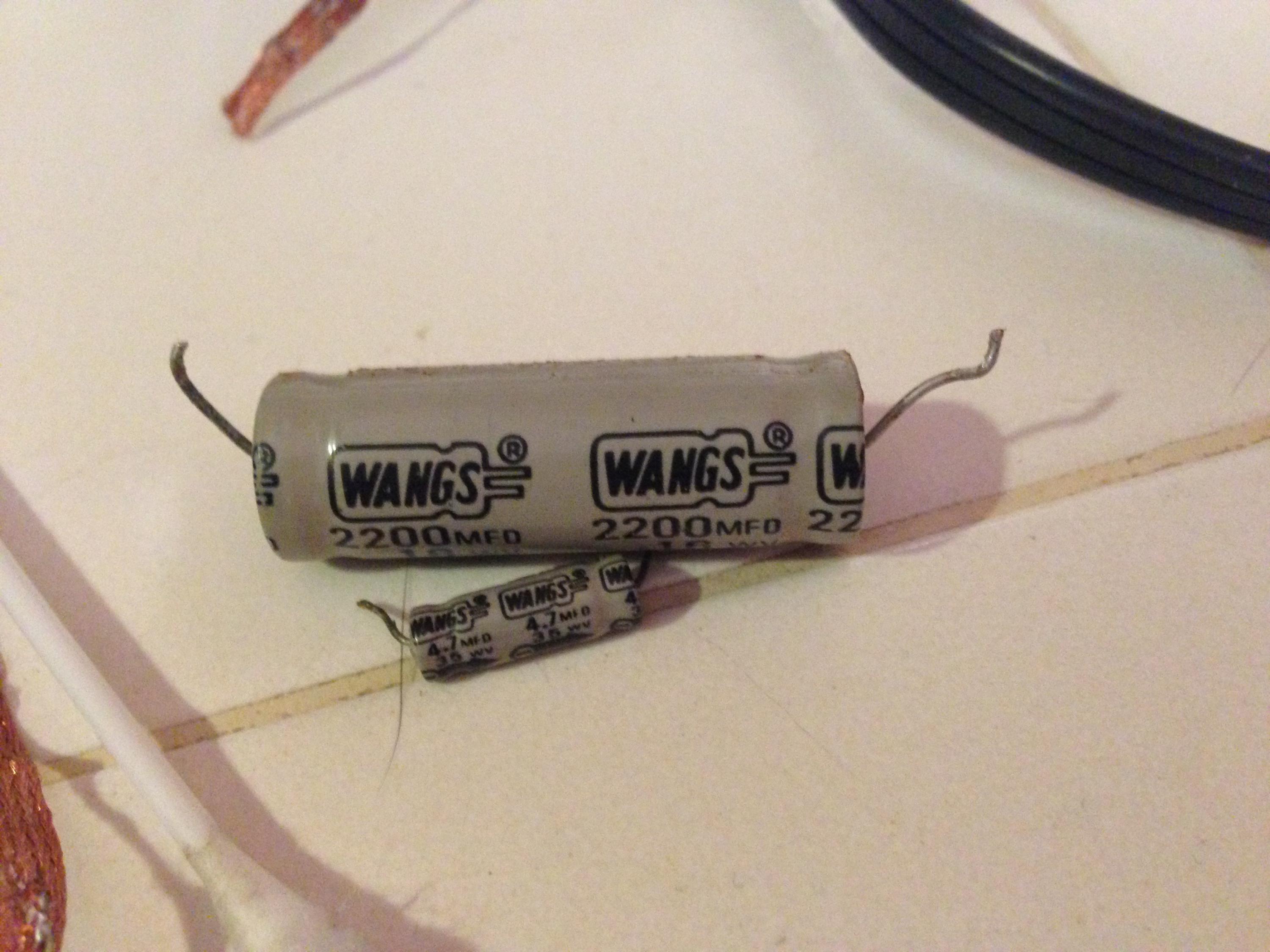

    my 4 switch atari had kinda died so i found a used 6 switch and brought it back to life, when i got it, it had no power or video. so far recapped the main 2200uf cap and two small 4.7uf caps, the main was a WANG brand and was replaced with Nichicon and the smallers were also WANG (=====> replaced with ITT which is a brand i have not heard of. Also replaced the power switch with one from my doner 4 switch board and resolded some joints, the ribbon cable between the mainboard and the switch board was problem matic so sand papered the metal prongs and she seems good to go now, working great.

    I think I might have an "ITT" capacitor or two in my cap box. Not sure of the reliability of them, never used them on anything yet. They are just general purpose if I recall correctly.

      Nice fix. It's interesting to see that crappy caps were used even in very old electronics.
      My guess is they have nothing to do with ITT Tech University

        The best cap brand I've found was FU-YU.
        The leads on that Nichicon cap look unusually thin.
        I have seen ITT caps in really old stuff.

          Yikes i hope they are real, I haven't seen to many nichicon axials so its hard to say, either way the WANGs were leaking so I wanted to be proactive, also I plan on replacing the teapos in my other 4 switch, the primary isn't leaking but the tiny 4.7uf 35v caps are showing signs of leakage and the video quality is not nearly as good as my 6 switch.

                Could these Taiwanese electrolytics be first or second generation units?
