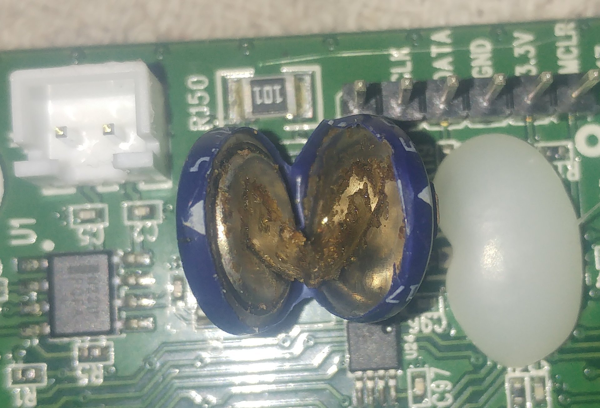

    With ref to "STJ":
    Originally posted by stj
    super capacitors - also known by other names are a failed design.
    they only survive a limited number of cycles and the cheaper ones in aluminium cans like to leak and wreck pcb traces.
    the better ones from ELNA and NEC are steel-cased but still have a limited lifespan
    if it's been replaced then check near it for damage from the old one - specially throughhole traces.
    it's gets into the holes and eats the sleeve away
    Take this seriously and inspect thoroughly.
    The new photos of the underside with super cap removed, inspect it carefully the pcb has top and bottom layer so there are traces connecting to the top and bottom thru the holes via the sleeves and so all soldering has to be clean and neat both sides to prevent short circuits to surrounding area there can be no excess solder and i think you might have overdone it slightly. With supercap removed clean the solder up, get some solder braid to remove all excess solder around where you have been working it acts like wick to draw excess solder away when heated by the iron. Then use a magnifier to look closely and you can even shine a torch on the other side of the board to see all the traces that run around just to be sure there is no splash of solder shorted out anything and that the sleeves in the holes are ok and to test resistance of the sleeves should be near 0 Ohm do it by putting probes ether side of the holes that the supercap legs go into. All this said it is odd symptom to have so once cleaned up might be idea to leave the supercap out for now.

                                    Just replaced another failed super cap on a Max M7i console and it looked ok on the outside but when cut to make removal simpler the evidence showed itself, see photo below.
                                    The console was starting up ok but on power up had garbled screen breifly which corrected itself in a second or less then goes straight into the setup routine every time, upon testing the supercap it was found to hold 100mv only with power removed and would come up to 4.3v instantly so knew it was dead before snipping. All sorted after replacing the super cap.

                                      Typical small supercap behaviour.
                                      • CuriousJohn
                                        Ordained
                                        • Dec 2018
                                        • 134
                                        • Great Britain
                                        #79
                                        Hey CapLeaker.
                                        Have done a handful of these now but this is by far the worst condition one I found yet, reckon its about 6 year old no more. What a scandal
