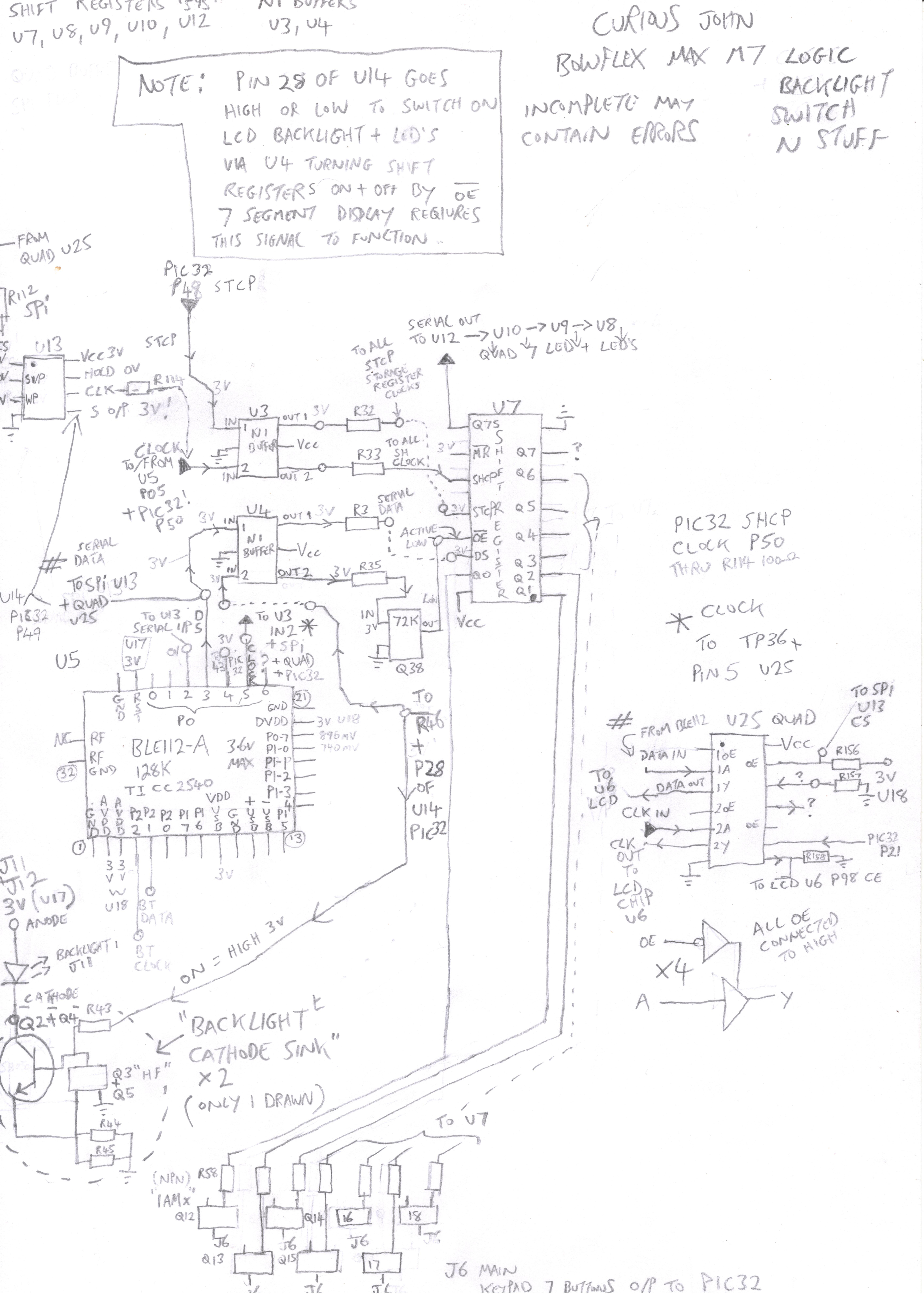

            Originally posted by CuriousJohn
            Bowflex Max M7 console logic stuff diagram and backlight/led stuff.
            LCD backlight is turned on by switching its cathode sink switches Q2+Q3 ip high for on and low for off but this comes from the ip side of a buffer chip U4 and i am yet to find where this actually feeds from I suspect its the PIC32 or something here is not understood. Can a none inverting buffer chip also behave as a sink so its reversed and its o/p state informs its ip state by holding it high? Meh
            Please disregard the post above it is incorrect and rambling it was late and i was tired. 😑
            I have just spend a whole 5 minutes this afternoon figuring out that pin 28 of U14 the PIC32 MCU, switches the LCD backlight on and off by driving its cathode sink transistors and there are two sets as two strings in the led backlight by looks of it and that signal high or low from P28 also goes into input 2 of U4, a none inverting buffer thus turning the tacho leds on and off and the 7 segment display as that is a common cathode part so all 4 cathodes are controlled by shift register as well as are the cathodes of the tacho leds in a similar way. All 5 shift registers are daisy chained together and the OE enable signal from p28 via the NI buffer U4 is common to all of them. Sorted. :-)
            Updated logic diagram below its a bit busy sorry its more my notes than owt else.

                #47
                Logic diagram update with corrected info.

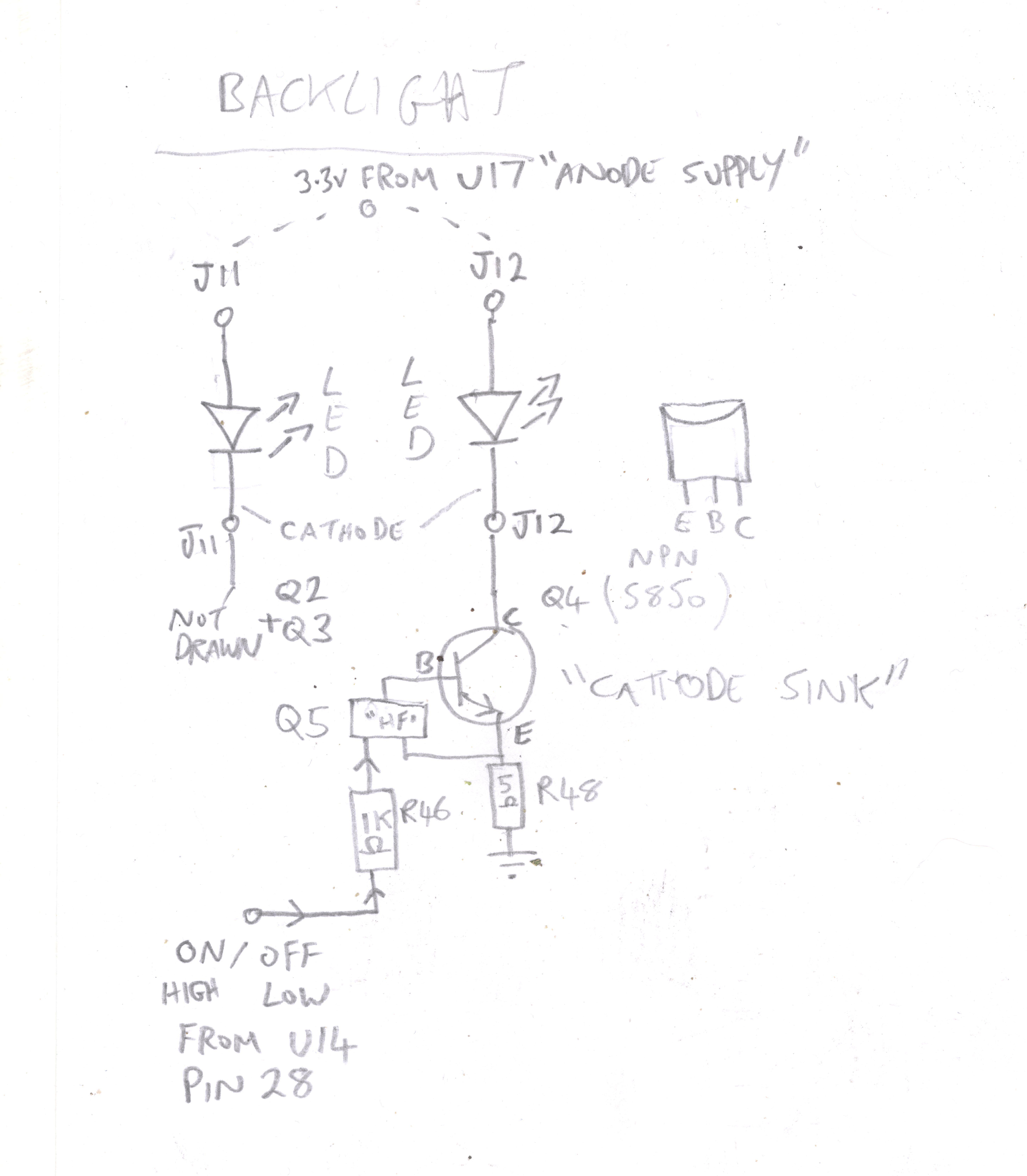

                    It can be daunting looking at a complex diagram so its best to take it in small bites so i offer this for understanding of the backlight.
                    The backlight has two "strings of leds" so at least two different leds are in it, focusing on one side only but both sides work identical;
                    The anode supply at J12 is always on 3v supplied from U17 BUK, U18 powers U14 (2.85v) and U14 pin 28 turns transistors Q5+Q4 on and this allows the backlight leds to illuminate as current can flow through the leds to ground via Q4 + R48.
                    Click image for larger version  Name:	M7 backlight simplified.jpg Views:	0 Size:	755.9 KB ID:	3527606

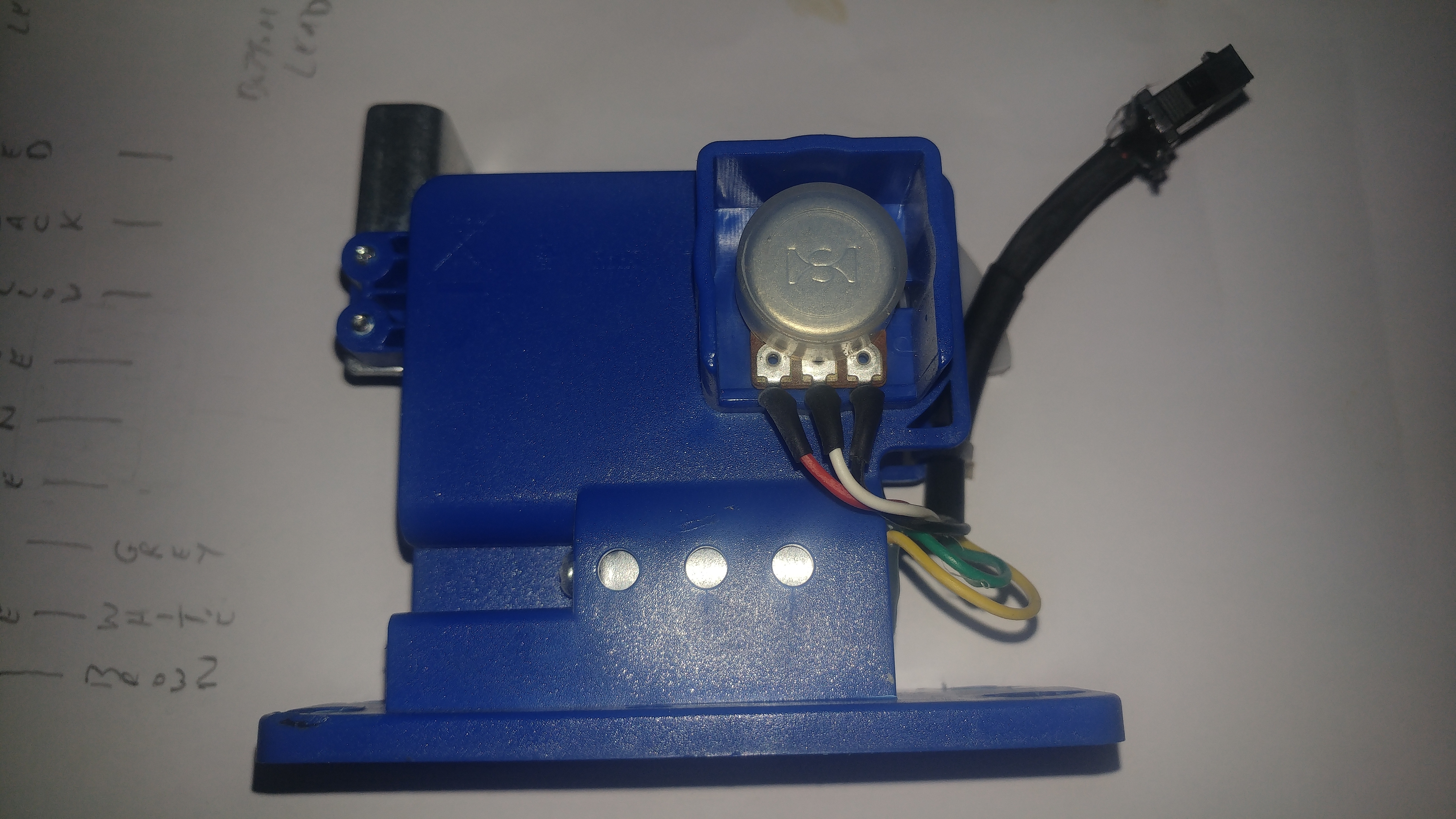

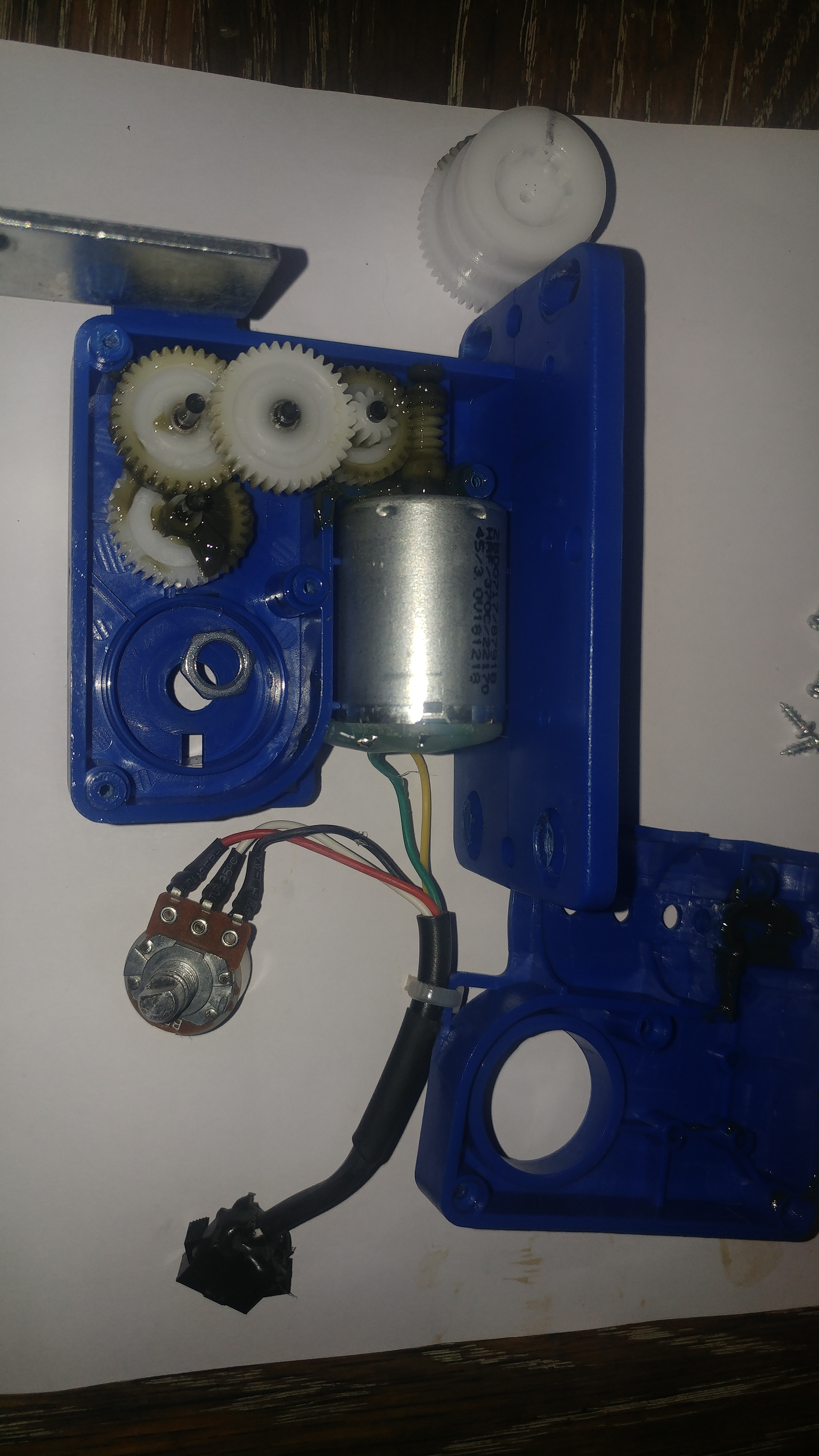

                        Another cause then and more likely for you given the scenerio described is the potentionmeter or "pot" in the servo motor, it is the posh name for a variable resistor, they are known to drift out of tolerance causing issues.
                        The symptom is erratic variation in resistance brake position with relation to the resistance setting on the console. The problem is caused as the "pot" which is a 5K ohm (5000 ohms) variable resistor, due to wear or failure it drops in value to below 4K ohm even lower, the last one i repaired the resistance measured 3K ohm with the ohm meter on my multimeter which is way out and caused the console to drive the servo motor hard as it couldnt find the voltage level it wanted to find for its position. These pots are supposed to remain within 10% of there stated value "tolerance" but are falling way out of that causing issues. Would it cause your fault? Maybe if the servo motor was being driven hard causing lots of current to flow which might explain your hot voltage regulator U18? This can also wreck the gears inside so defo worthwhile to measure the resistance of the pot, it should be 5K ohm or 10% either side so 4.5K ohm to 5.5K ohm, anything outside this range means its fallen out of tolerance and will likely get worse.
                        Photo of Servo internals for info, you shouldnt need to open it up to measure the resistance but will need to open it if new pot is needed. The pot is down the bottom with 3 wires going into it. The resistance between the two outer wires should be 5K Ohm, measure the resistance of the pot with the resistance setting of a multimeter or ohm meter if you have that.
                        Click image for larger version  Name:	20240602_175716.jpg Views:	0 Size:	4.57 MB ID:	3574813
                        The pot on this one is not covered in hot glue its easy to see the terminals on its back. The resistance between the red wire and black wire should be 5K Ohm or within 10%.
                        Click image for larger version  Name:	20240602_174026.jpg Views:	0 Size:	5.19 MB ID:	3574814
                        Dont rule out having both these faults or even none of them lol but a multimeter is needed for quick simple measurment of both DC voltage and resistance in order to determine the status of both the supercap and servo pot.

                          I measured the servo without power, so all cables are disconnected. If I measure both outer pins, I get 5.18 kOhm

                              The Servo seems ok then, thats good news you didnt mention it going out of resistance setting when set so assumes it doesnt. It would be an idea to check the resistance from the middle pin to each outer pin they should both be different readings unless you managed to put the pot dead centre lol but both readings will add up to the total you measured of 5.18K or thereabouts, just to confirm the pot is fully working as it should for completeness if you care to lol.

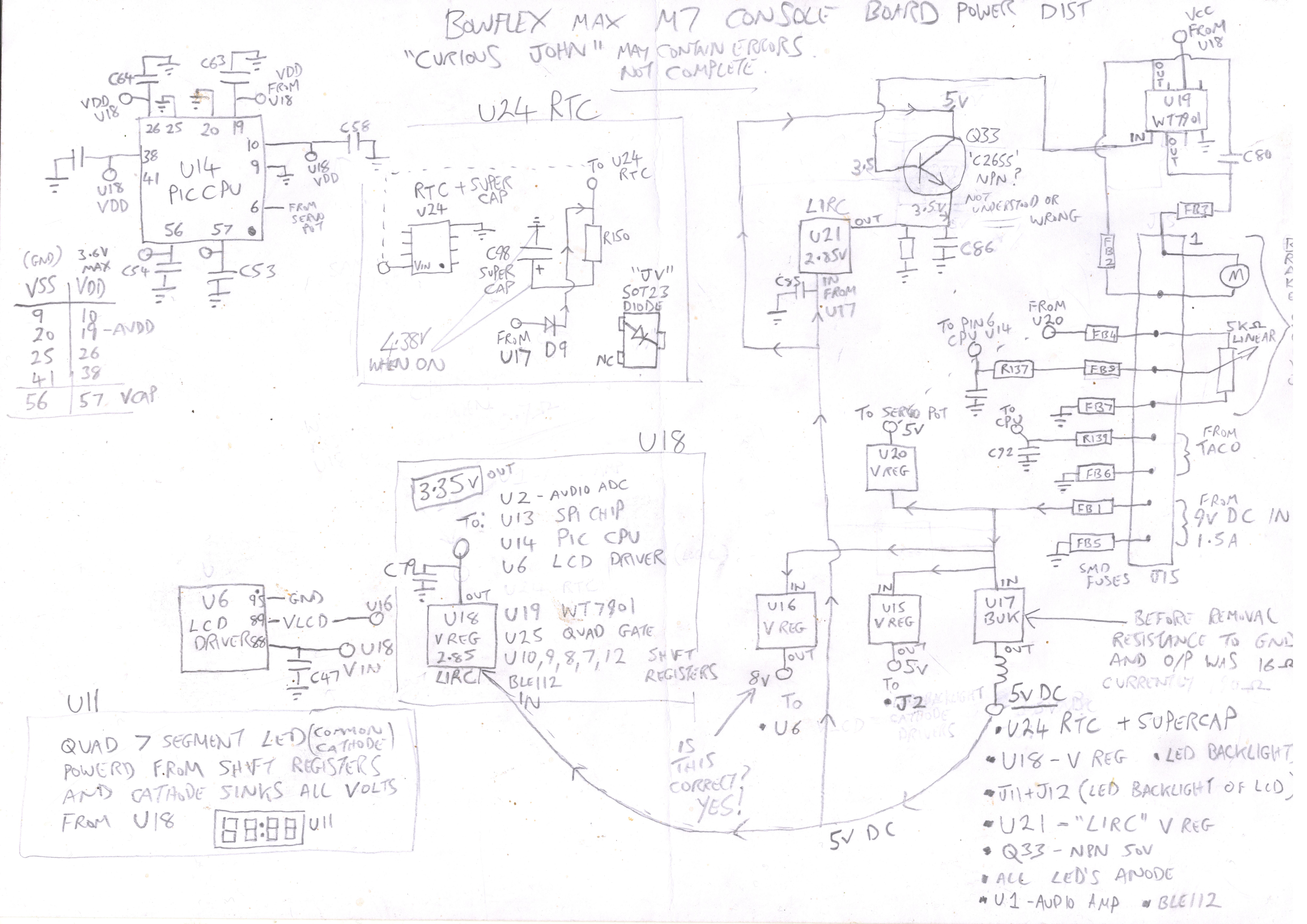

                              I have updated the M7 console diagram as needed a few errors correcting see below. It has RTC + Supercap circuit in centre its same as on M8 just in different location thanks for posting photo. I would check D9 resistance to make sure its not gone short (diode testing) and R170 (R150 on M7) although be mindful doing this with supercap installed and charged might produce strange resistance readings as mayeb confuse meter best to check when removed supercap or could snip it out.
                              So on M8 U17 looks like the MCU main regulator, its in the same location as U18 on M7 console board doing same job i think. I thought this regulator fed the RTC and supercap but that was wrong the RTC and supercap is charged from U17 on the M7, lookslike U16 on M8, easy to check continuity between output of U16 to D9 it should be near 0 ohm as just a copper trace connecting them. Or with 9v being fed onto the board at J17 pin 8 (9v) and pin 9 (gnd) the output of U16 should be 5v and that goes into the anode of D9 among other places lol.
                              Any chance you could do a better photo of the U12 & U10 area as keen to know what those chips are, not sure if U10 is a realtec or raspberry pi something but i doubt lol. that board defo has a different Blutooth module which might explain the JRNY compatability thing as M7 is not JRNY compatible.
                              Updated power Distribution of M7 console.
                              Click image for larger version  Name:	Bowflex_Max_M7_console _power_dist.jpg Views:	0 Size:	1.99 MB ID:	3575785

                                  So the resistors show different values and added together they again give the total number of about 5.2 kOhm.

                                    The servo measures ok then, good to confirm.
