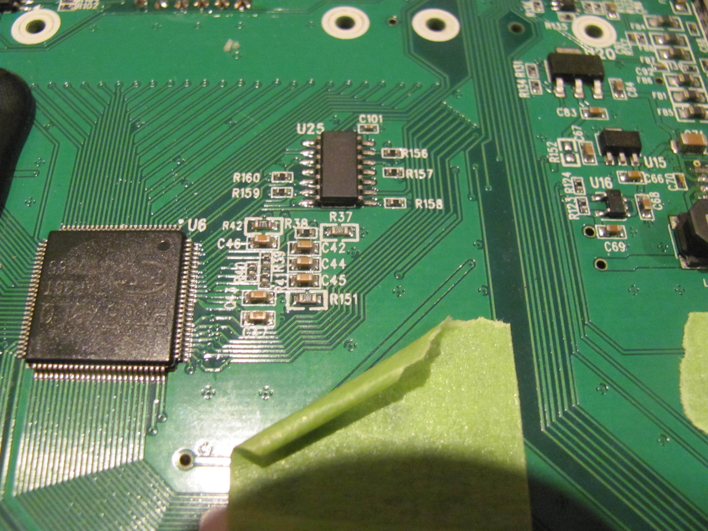

      There is still a short somewhere after the voltage regulator (removed) that is fed by the BUK measured as 0.7 ohm to ground the smd cap smoothing the output to GND was open i was hoping short but hey ho and this line supplies cpu among others i think its supposed to be 2.85v with something like 3.3v coming into it from the BUK. Ive probed about and figured out the power distribution on this board and removed the odd cap for testing my guess is the short is in the CPU as it has the most connections to the regulator and ground and it has the lowest tolerance max voltage of all the components fed by the regulator many of those can stand 19v ok it seems but there may be some texas instrument chips to look at.
      The only thing i know to do now is remove the cpu and see if that cures the short to ground from the primary regulator, i could faf and lift up the 4 ground pads it has but the chip has a bit of a shine to it on one edge i suspect it got very hot and smoked out then the BUK current limit kicked in and saved the day but it got hot and hurt to as did the regulator. I intend to replace just the BUK first and see how that looks as it supplies other regulators including the lcd chip, cant do main cpu regulator till the short is located/solved
      Here is the cpu it doesnt look great do you think?
      Click image for larger version  Name:	S20240611_0001.jpg Views:	0 Size:	1.82 MB ID:	3288517
        • 31204
        nothing obvious there
        usually with flat packs like that they blow a hole in the top or round a pin.
        it looks rubbed or maybe it has a coating on it of some sort.
        post a picture of the rest of the board

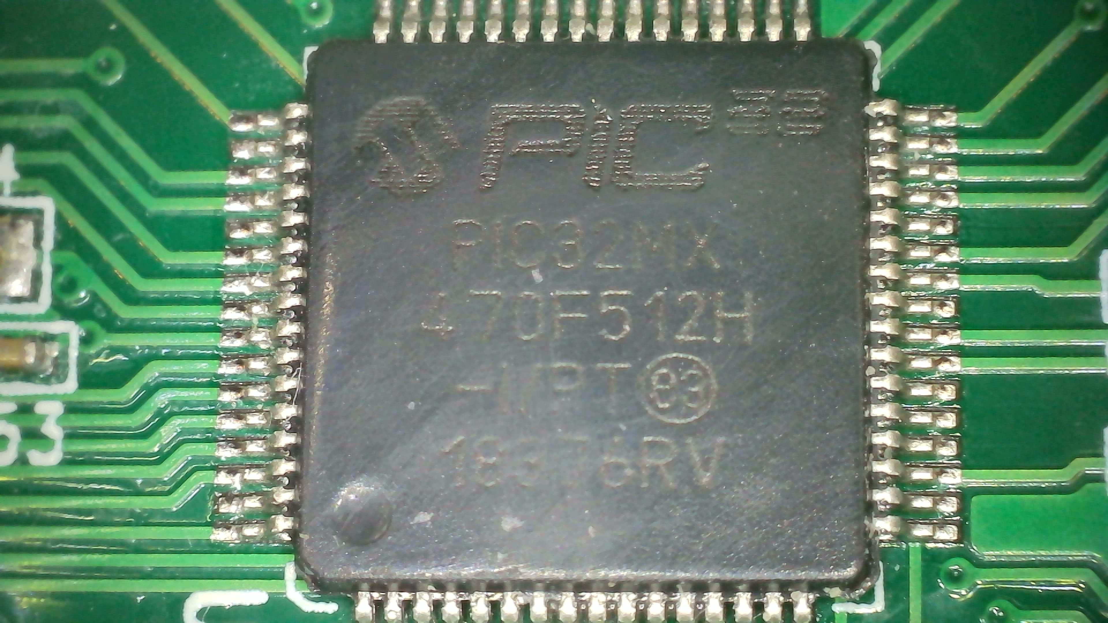

                          Below is another photo of the PIC32 chip and it shows the shiny side i mentioned which i believe is heat caused, the chip has not been polished or rubbed to summon some gene lol i just cleaned it with IPA a couple of times with a Q tip. Maybe its ok yet to be determined....

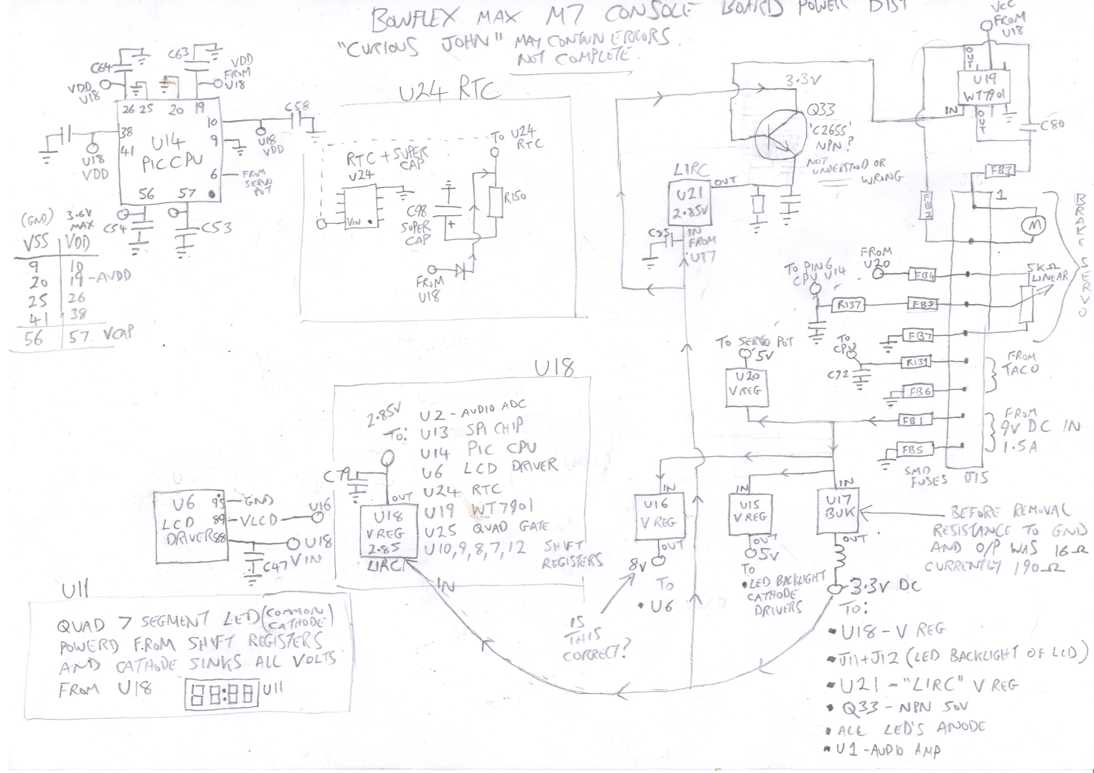

                              Bowflex Max M7 console board power distribution and stuff
                              Click image for larger version  Name:	Bowflex_Max_M7_console _power_diagram.png Views:	4 Size:	3.28 MB ID:	3291001

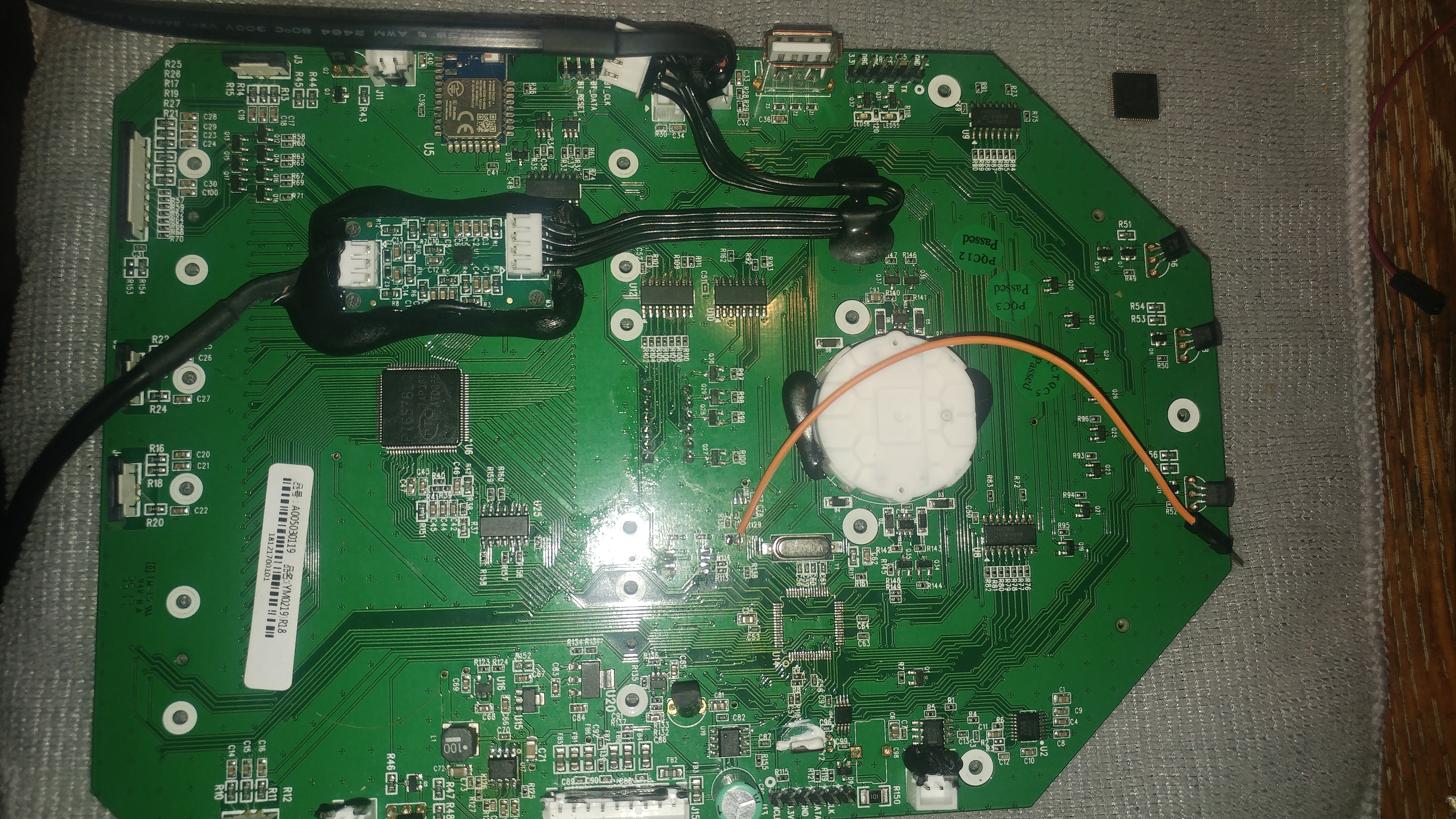

                                MCU removed and S/C resolved.
                                Next problem after installing new PIC32 is tp flash it with already achieved extracted HEX dump of working board. Believe it is possible to upload the HEX dump back to the MCU in MPLAB X IDE.......? Currently struggling to convert it to a Bin anyway so more learning next week when MCU delivery arrives glad to report its not protected or encrypted according to configuration bits menu from MPLAB

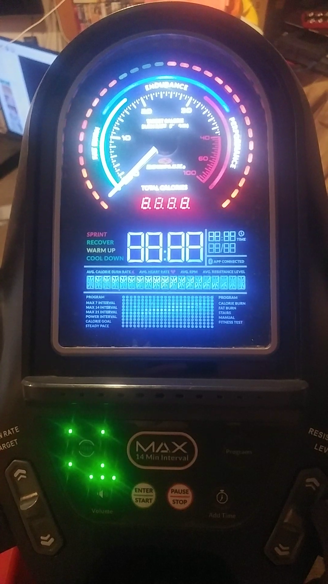

                                      Photo 1. Image of a good console screen at power on startup test, this last about 2 seconds then it goes blank and the thing loads its program proper.
                                      Click image for larger version  Name:	vlcsnap-2024-06-26-23h10m47s974.png Views:	8 Size:	1.60 MB ID:	3297930

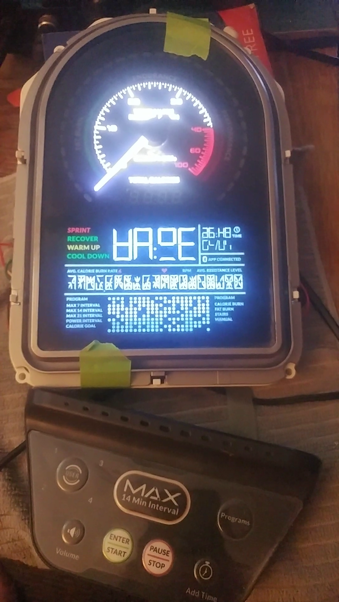

                                      Photo 2, Image of this console screen after PIC32MX replace and reprogram suspect shift registers & LCD chip poorly as all power supplies good. The ring of RED led's never shows or the words within and the LED 7 segment never shows any sign of life all these driven by PIC32 into shift registers and also shift register controls the cathodes in the usual way but all shift registers have good VCC supplied from the Main regulator U18 3.2v that needed replacement.
                                      Eagle eyes will note the absence of the green leds in the control panel, they do flash on briefly so there is life but dont stay on anywhere near as long as the good console example. I have ensured the leads of the PIC32 are all connected well with no shorts but i may revisit that as have spares on hand but will get the 5 shift registers replaced next and see how it likes that.
                                      Click image for larger version  Name:	vlcsnap-2024-06-26-23h13m09s064.png Views:	0 Size:	1.65 MB ID:	3297934
