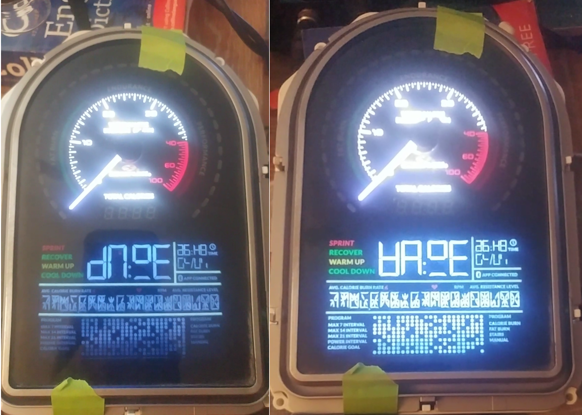

      Exciting times today lol, have now observed slight changes on the LCD screen at power up self test but only slight in the top large 7 segment display portion, i like that it encourages the idea the LCD chip driver is naff, or maybe it is zebra woes lol
Name:	bowflex Max M7 bad2.png

        Ok folks i know your over there in the corner with your popcorn trying not to snigger openly lol but you know when you start something like this and reasonably think; i'll just ignore that BLE112-A module because if its broken (~it probably is having been on the same supply bus as the PIC32MX) i dont need blue tooth anyway and can just remove it...
        Then you start looking at shift registers and there buffers to see why they are not driving the quad 7 segment led and all the other tri state leds on the board and you trace the data bus that goes smack bang into the BLE112-A and never having encountered this before you pull that data sheet and it dawns on you that your dealing with yet another system on a chip with its 8051 processor, 128Kb flash and all the rest of it and then understand the PIC32MX is but one of 3 MC on this infernal max trainer console board and will likely require not only replacement but flashing haha with an expensive CC debugger you dont currently own? The only good news being you do have access to a working console unit to extract a binary or hex from....
        Meh, and oh joy.. 🍿
        And all of that after sourcing and ordering some rare ish LCD driver chips. Cost of new BLE112A + CC debugger = ⚠
        EDIT
        Cheap CC debuggers on fleebay, phew.... think ill start that after i finish this box. 🍿

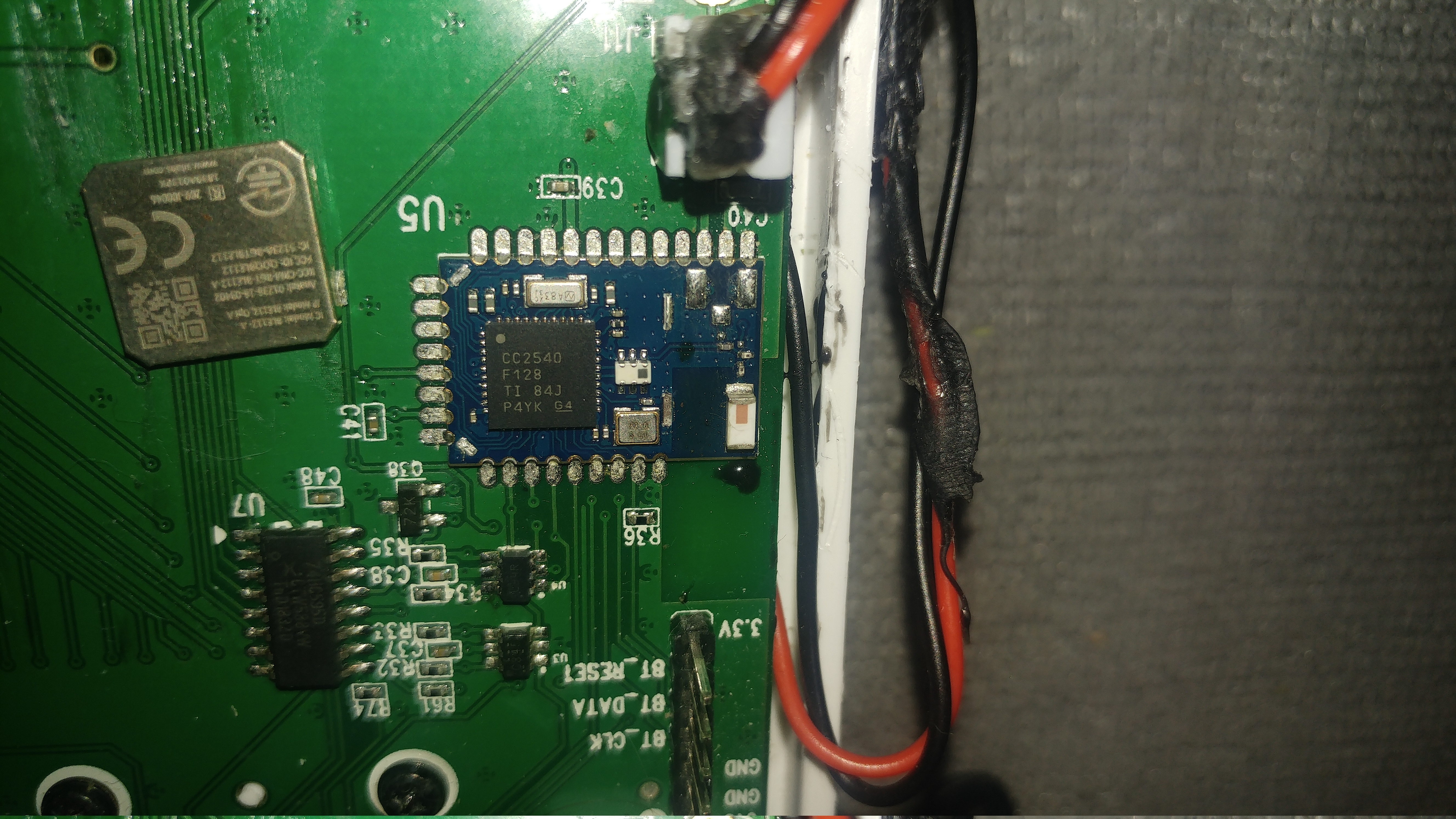

              Excitement of delivery of CC debugger turned to despair in quick measure today as it would not "go green" with this BLE112 which confirms its U/S after receiving 19v lol. The despair came on when i connected the cc debugger onto the header port of a working unit and got the green light instantly and was then thrown to into the dirt by Bowflex locking the debug interface, no info no hex dump GAME OVER
              Any magicians out there know how to proceed? Bowflex dont supply Firmware anymore, i'm not even sure the company exists last i heard they sold up to Johnson health tec who make gym grade kit under Horizon brand apparently. Anyway its all obsolete isnt it, maybe a nice email to.... naaa defeat
              debug interface locked

                Here's a photo of the broken BLE112 i need firmware for, i took its cover of just now to scream at it and see if there really was anything that could be done but nope it has its own voltage regulator inside the chip.
                Click image for larger version  Name:	20240709_174505.jpg Views:	0 Size:	5.73 MB ID:	3305883

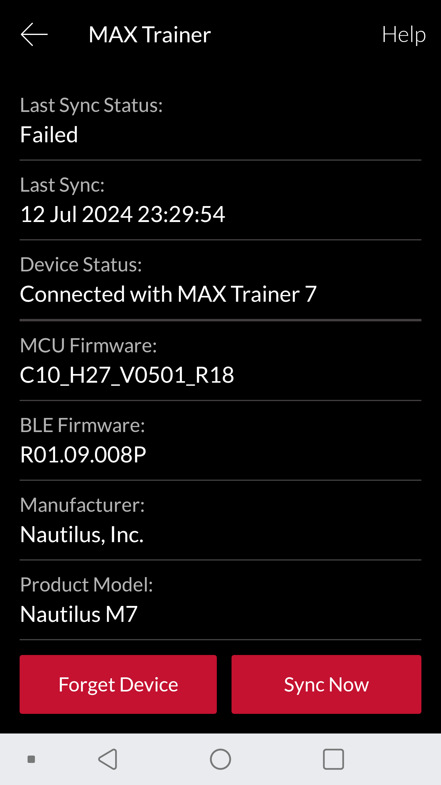

                  I was looking through an android app that connects to Bowflex Max M7 via bluetooth with it connected to a working machine and some useful info presented itself confirming there are two firmware's on this machine and have successfully extracted the Hex dump of the MCU PIC32MX however the firmware of the BLE112-A module remains elusive.
                  Here is the dump of the MCU firmware:
                  https://archive.org/details/bowflex-max-m-7-firmware
                  The BLE112-A module contains a TI CC2540 chip with 128Kb of flash memory but its debug interface was locked when it was written so i dont at present have any way to extract it and Nautilus/Bowflex/Johnson health tec dont seem to be able to help so it really is GAME OVER unless anybody here knows of a way to dump the flash memory out of this thing i am going to investigate over the air ways via blueooth but its more learning and probably futile but as ever i live to find out.
                  Click image for larger version  Name:	Screenshot_2024-07-12-23-33-47.png Views:	0 Size:	147.6 KB ID:	3308356

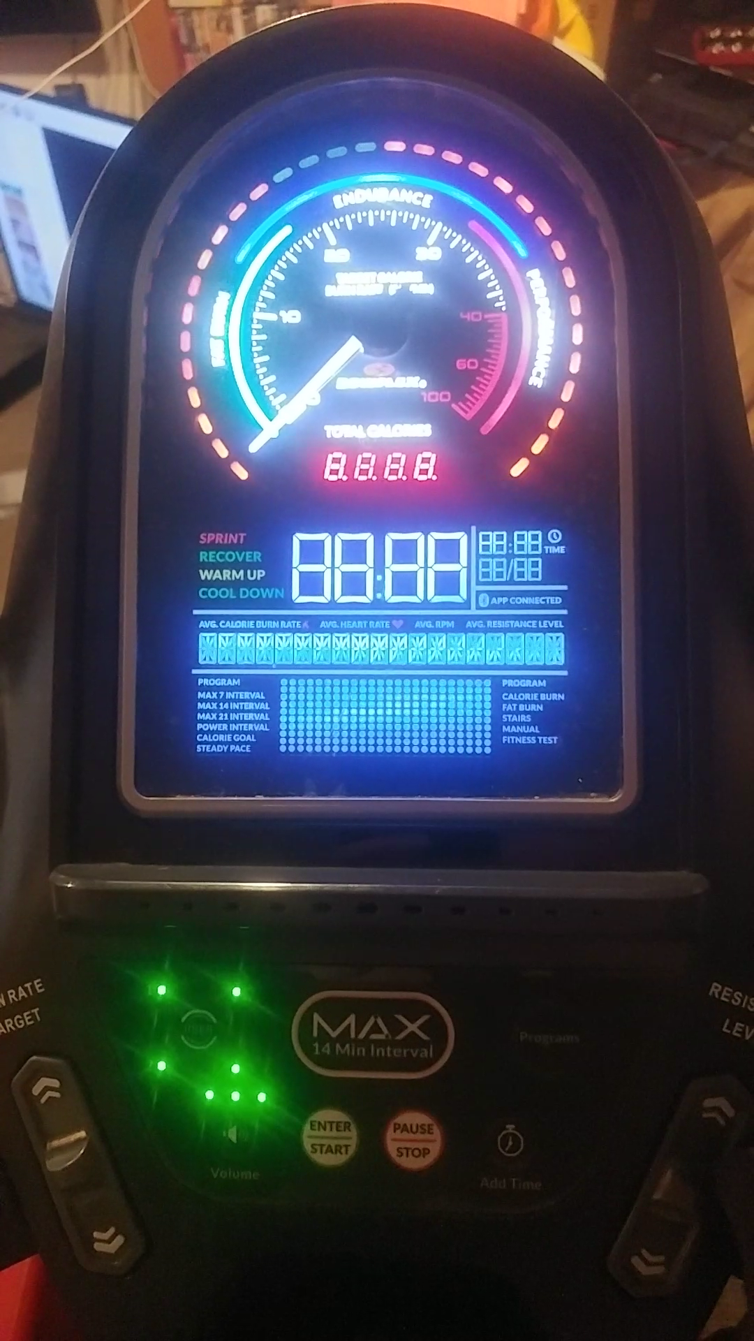

                                  0 life out of the machine(Beyond somewhat dimly glowing tach LEDs attached pic I think). Buttons dont light up or function nor it shows up on BT scans and Max Trainer app(Found a copy APK). Just what you see on video. LCD does not react whatsoever to button pushes nor any attempts to put console into service mode.
                                  Kind of raked PIC32 chip pins and most read less than a 1V around .01 to .5V.
                                  I can spray some IPA but on touch(cold in the shop) PIC32 and BT modules seem to get somewhat warmer first few minutes plugged in.

                                          Nothing to be sorry about I am not really educated in board repair beyond watching Lois Rossman! Im just a curious idiot with a volt meter. I do appreciate you humoring my efforts.
                                          The photo I attached was merely to show that some tachometer LEDs do work albeit are very dim - the panel stays that way with no changes - had it on for 30+min to see maybe it will do something. When shop lights are on, you cant tell there is any power - it certainly does not light up like in your photo... maybe 1/16th of that. No life from green LEDs at all - I did have all ribbon cables hooked up tight.
                                          I have tested backlight with 3V coin battery and both sides light up fine - tested one at a time. One would think having some voltage to there(2.4 currently) would at least allow the backlight to glow... which it isnt without using the 3V battery.
                                          Measured resistance between ground and the cap indicated and get 1ohm. Top side gets 4ohms.
                                          Heres video of it booting takes a second to see anything... Its certainly not as bright regardless of lighting. Looking at the boot requence mine is stuck where inner tachometer LEDs are faintly on. Left it up and running and screen reads same garble. Nothing on 7 segment LED either.
                                          https://youtube.com/shorts/NAdPOw99I...nhZHkRh9sC72K7
                                          Left it on for about 10 min and screen had not changed nor I get any button response. Nothing legible there. It almost as if its not getting the power it needs to boot fully...
