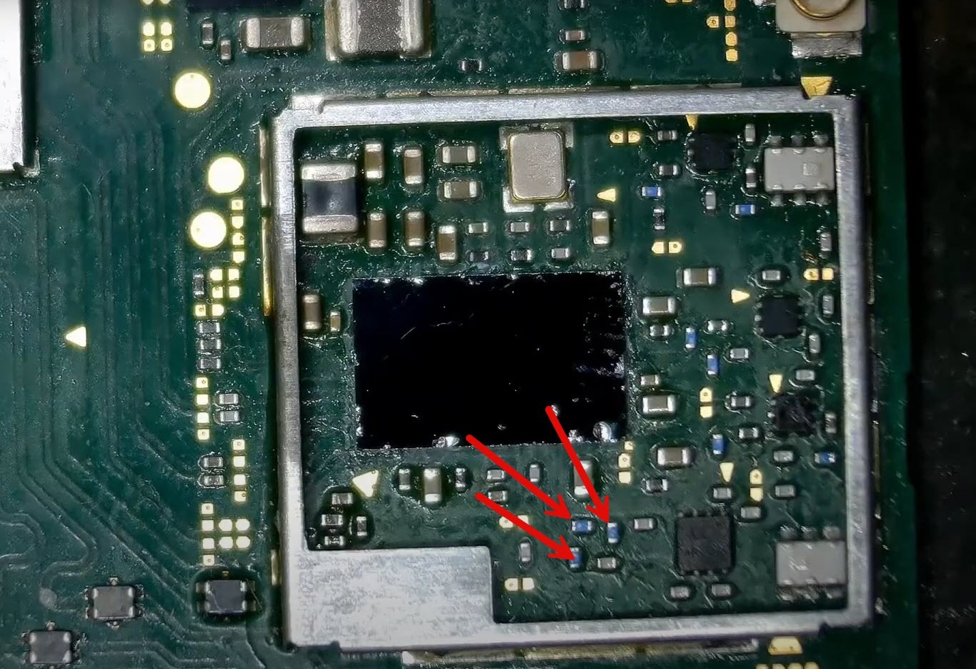

    While replacing the wi-fi chip I had a couple small components get away on me so I need some help to iD them and where I can get them. They are blue with a dot at one end. Any help would be great!

    have you tried taking off the same component nearby and testing in component tester ? which switch model is this ? did check at the shield corners/under ?
    I haven't messed with wifi chip and don't know the part number.
    Perhaps see if they have it here: https://usoldering.com/switch-lite/
