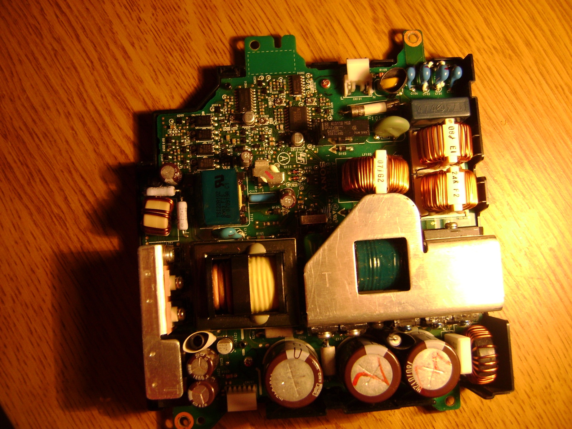

    I have this PSU from old broken PS3, it's 23.5A +12V PSU, using it 3 months from now to run a car amp and it works perfectly, but it needs little more boost.
    I need help about mod, don't know where to start, which chip..which resistor??
    Any help will be appreciated

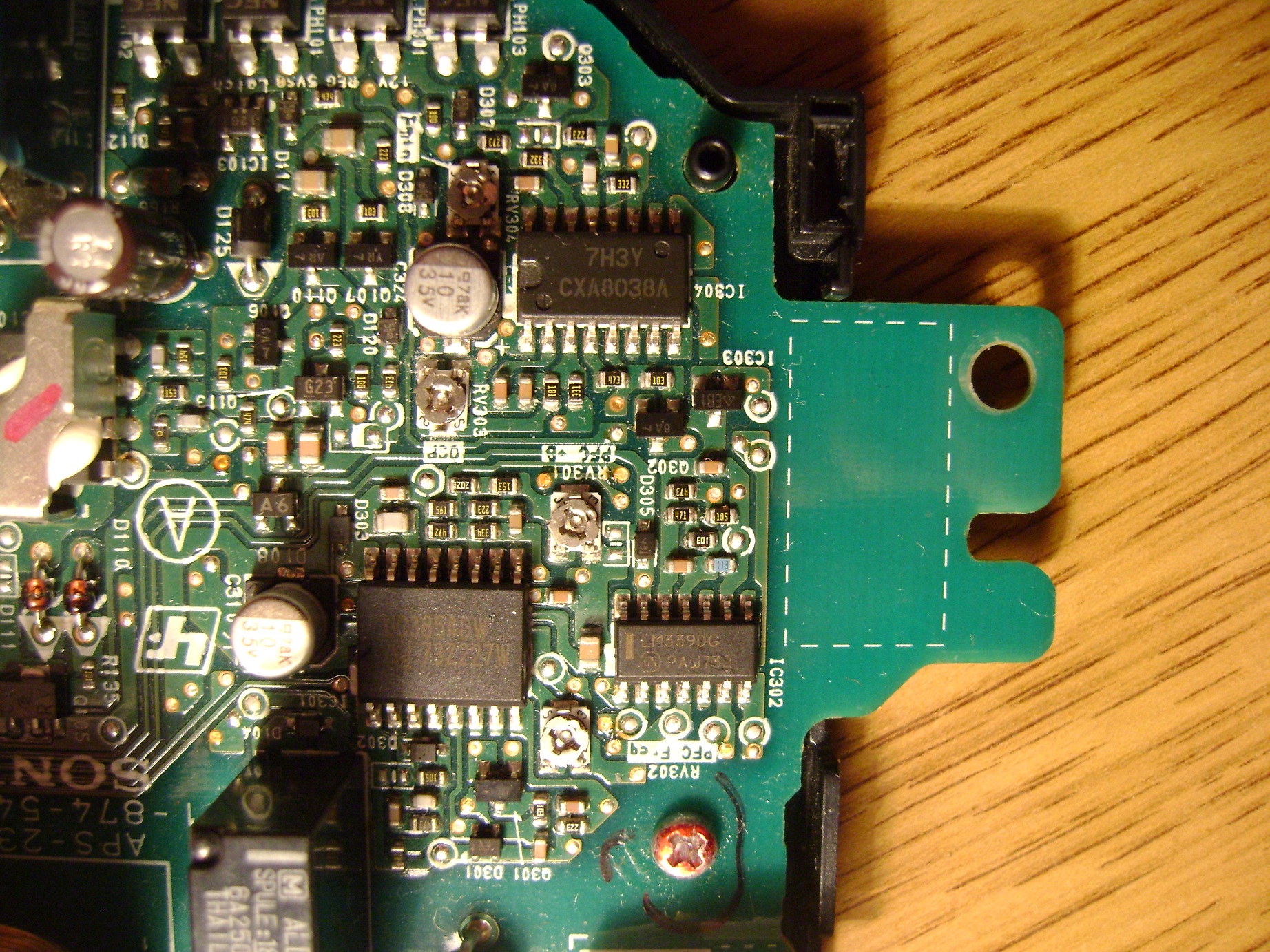

    there are 3 chips as i can see
    uc3854, LM339, cxa8038a
    not sure about last one but the controlling chip is uc3854. check it's datasheet. It is different from tl434, so you have to work on in yourself.

      https://cdn.badcaps-static.com/pdfs/...f943b9589e.pdf
      maybe pin 11(Vsense) but check what voltage do you have there when p/s is operating normally.

          from datasheet: "VSENSE (Pin 11) (voltage amplifier inverting input): This is
          normally connected to a feedback network and to the
          boost converter output through a divider network"
          Cloud be it?

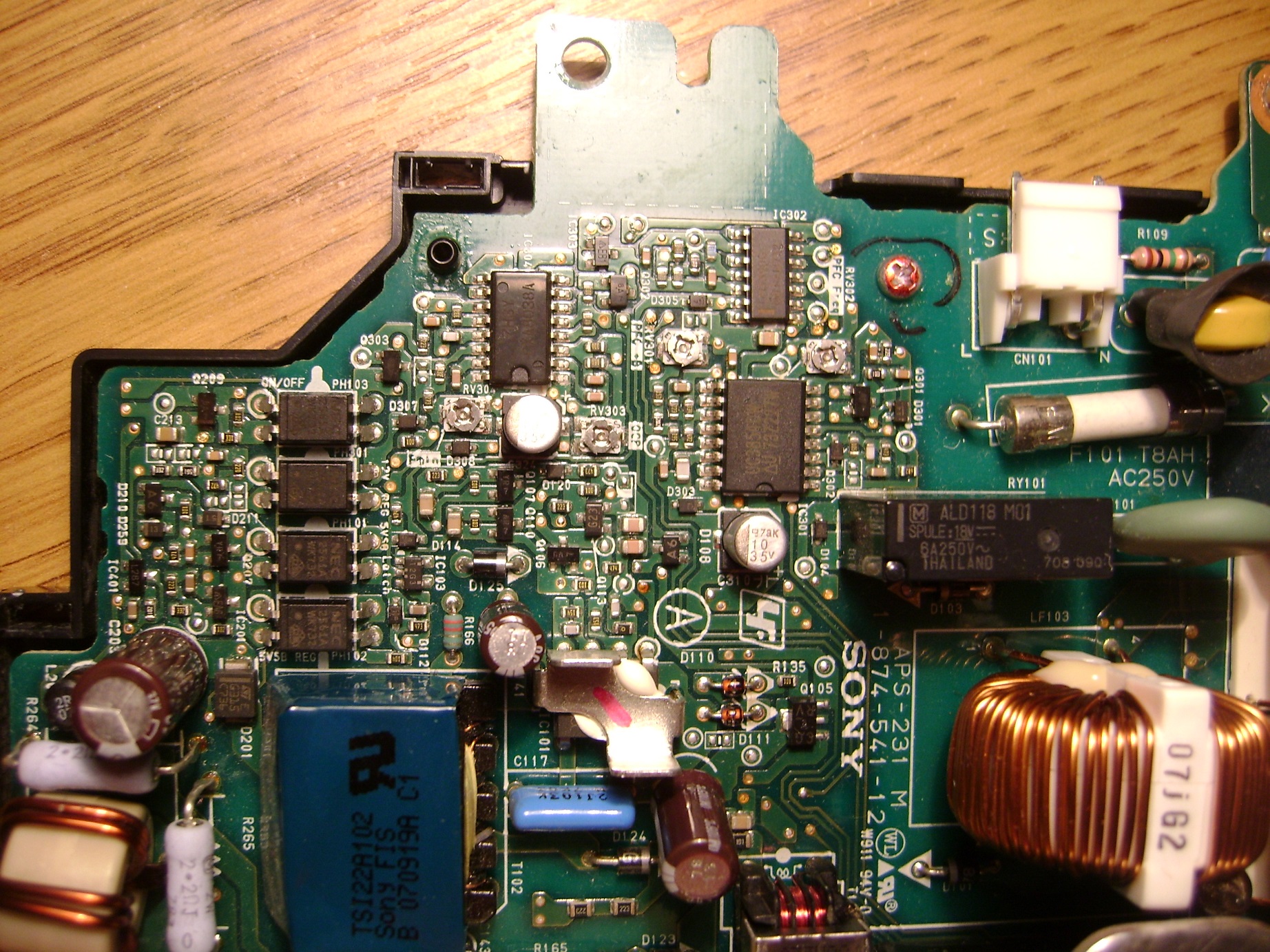

              I would seriously recommend AGAINST messing around on the primary side of the circuit...
              A far better choice would be finding the TL431 that's hooked up to one of the optocouplers (which is responsible for the voltage regulation feedback) - i think i might've found it, but you'll have to confirm the markings. It might be one of the two small SOT23 3-pin IC401(?) or IC201, near the top left corner of the board, right on the left edge, "above" that 6.3mm or 8mm ChemiCon cap, and "facing" the bottom-most two of those four optocouplers.
              Just keep in mind, one of them may well be for the 5Vsb, and the other one for the 12v rail. If you can read the values of the 2-3 resistors connected to each of those 3-pin chips, that can easily be determined

                        Then again, i've found 2 pages (with not much on them) for a CXA8038P:
                        And yes, it seems that UC3854 is "just" the APFC controller (not "just" in ATX terms ).
                        In the first picture from the first post, i can read "12V REG" right next to optocoupler PH301 - see if any of its two leads from the secondary side go to IC401(?) or IC201, then see what resistors are connected to that one - one will have one end going to the +12v rail, and the other one will have one end going to ground; the two remaining resistor ends should be joined together, and going to one of the pins on IC401 or IC201, whichever's responsible for regulating the 12v rail.

                          nice job with finding the datasheet, it seems that pinout is what we need.
                          according to datasheet it looks like it should be pin 4, but i am not too sure about it.
                          m111 please check how much voltage in relation to GND and pin 16 do you have on that pin 4 when p/s is operating normally.

                                    there is 0 ohm resistance between optocoupler's second pin and ic401 first pin
                                    • Khron
                                      • Sep 2006
                                      • 1350
                                      • Finland
                                      Re: PS3 PSU (APS-231) Voltage mod
                                      IC401 - marking L287 = TS2431
                                      https://cdn.badcaps-static.com/pdfs/...72f58e3dcc.pdf
                                      See what resistance value you can measure between pins 1 and 2, and then 3 and 2 (see datasheet in the link for pin numbering).
                                      To increase the output voltage, you'll need to decrease the resistance between pins 2 and 3 (formula in Figure 11 in datasheet).

                                        there is 6.20K ohm between 1 and 2 and 800ohm between pins 2 and 3
