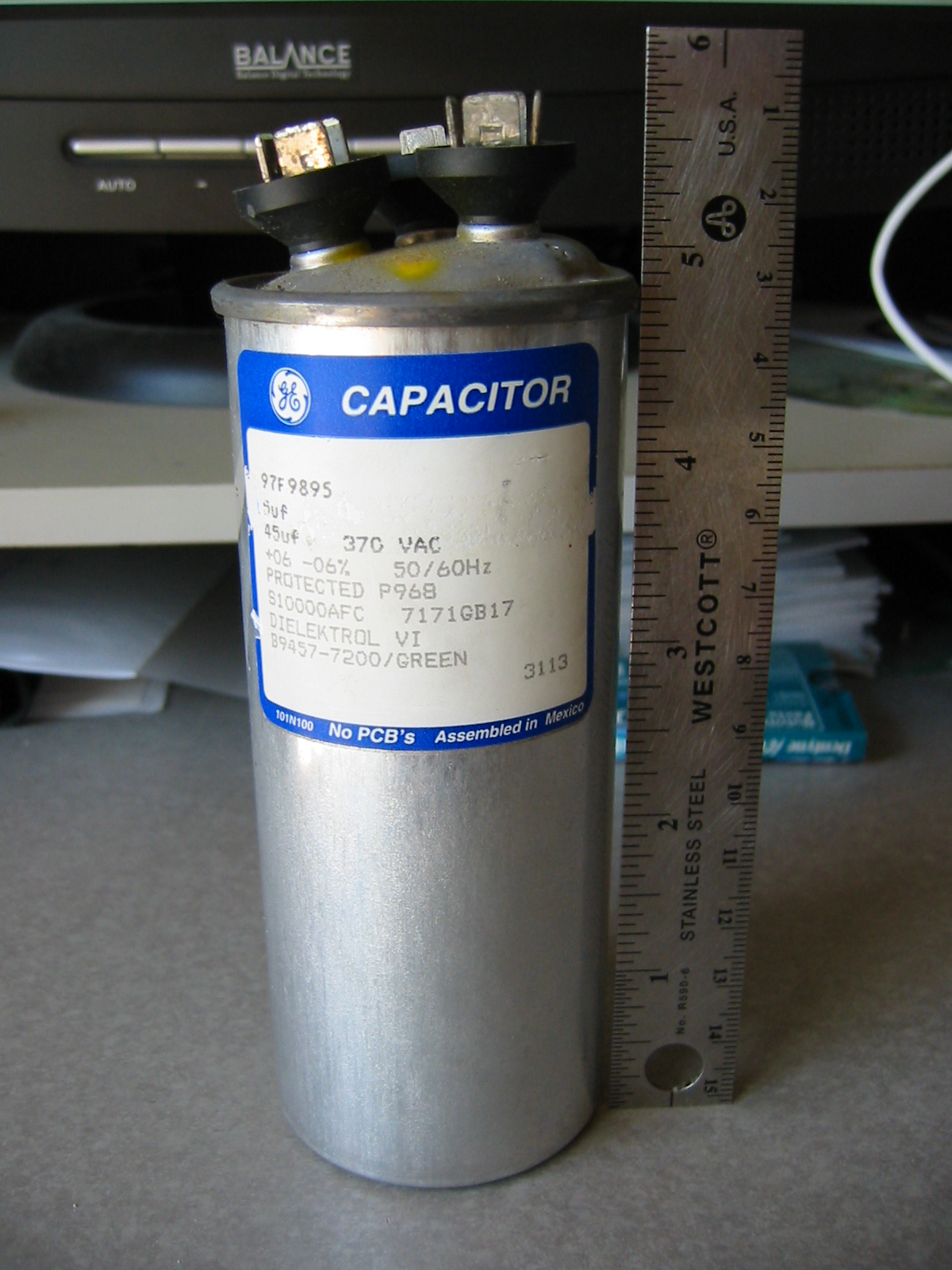

    The hot summer days from the heat wave around a month ago here in southern california took its toll on my Air Conditioning unit. I tried to turn it on a few days ago as usual..., but the unit would not start up. A quick call to a friend who services AC units got me back up and running again. There was a bad motor run cap that was obviously bulging
    Replacement cap was bought locally for around $15, MUCH cheaper than calling some random AC repairman from the yellow pages. Just though I would share this experience with you guys.

    My brother had the same problem with a large window unit he uses to cool his ranch house.

      in a good season i can fill a 5 gallon pickle bucket with motor caps failed like that just from window units i rebuild to sell.sometimes they blow up or spit out the terminals.

        OMG Moby Cap, Thar she blows.

          Are that AL elektrolytic caps? metall paer should not bulge that way, but may be a litle expensive at that capacity.

            iirc they are paper/oil dielectric.
