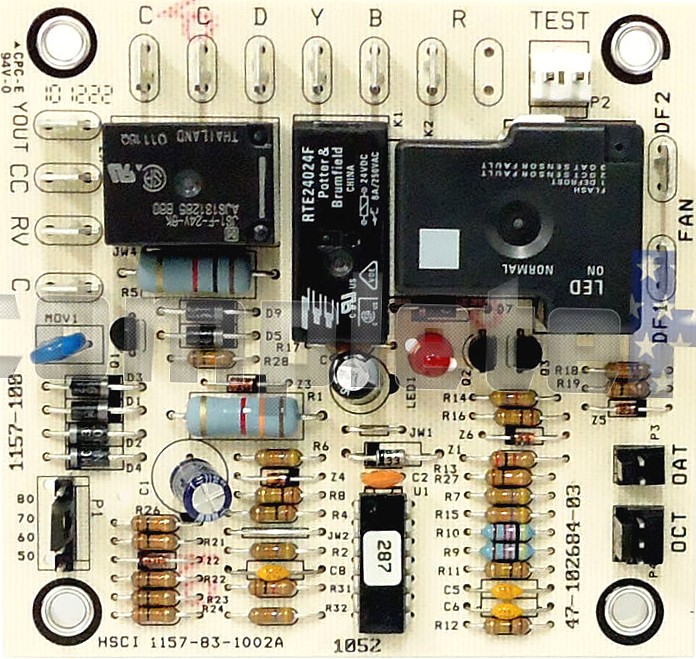

                            I looked at the White-Rodgers defrost board/ fan controller for my Rheem packaged heatpump and noticed no L-C line filter, despite the board having a microprocessor. How do they get away with digital in such an electrically noisy environment? I couldn't find an L-C filter elsewhere, and the wiring diagram didn't show any. BTW a couple of copper traces were lifted, and I don't think it was from vibration.
                            Most of the problems I've had with central A/C have been with the electronic boards. The defrost board of the old Rheem developed a bad relay and was replaced with a homemade board that was a copy, only I used Radio Shack relays. The fan controller of the ICP Heil heatpump that replaced it was changed 4 times under warranty and finally by a homemade board that ran fine for 3 years until I put back the original board to hide the evidence of tampering so I could get the failed reversing valve replaced under warranty.
