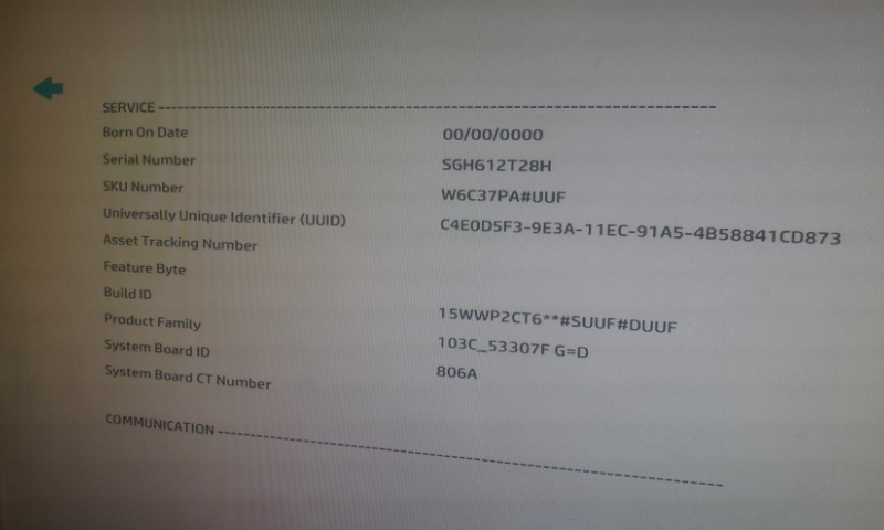

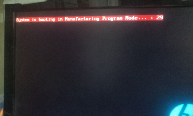

    After bios repair of 6th gen Hp desktop and all in one pc, "SYSTEM IS BOOTING IN MANUFACTURING PROGRAM MODE" message appears on screen in startup. I tried adding build id, serial number, product number, product name and feature byte in bios setup but it didn't work. Is there an easy way to solve this problem because I am not so good at using special software for bios editing. Any kind of help would be greatly appreciated. Thanks.

        you need to use (BCU) biosconfigutilty tool to set the system info.
        its widely available to download here. once you applied the MDM popup will go away.

          Thanks for your help. Is it easy to use because I am not good at using special tools for bios.

                If you repair bios via dump you need upload original bad file i will extract your all data and replace new file.

                  Here is the original bad file of Hp 400 G2 all in one pc.

                    Send me file you repaired.

                        Repaired file.

                          Try this.

                              Problem solved. Thank you so much.
