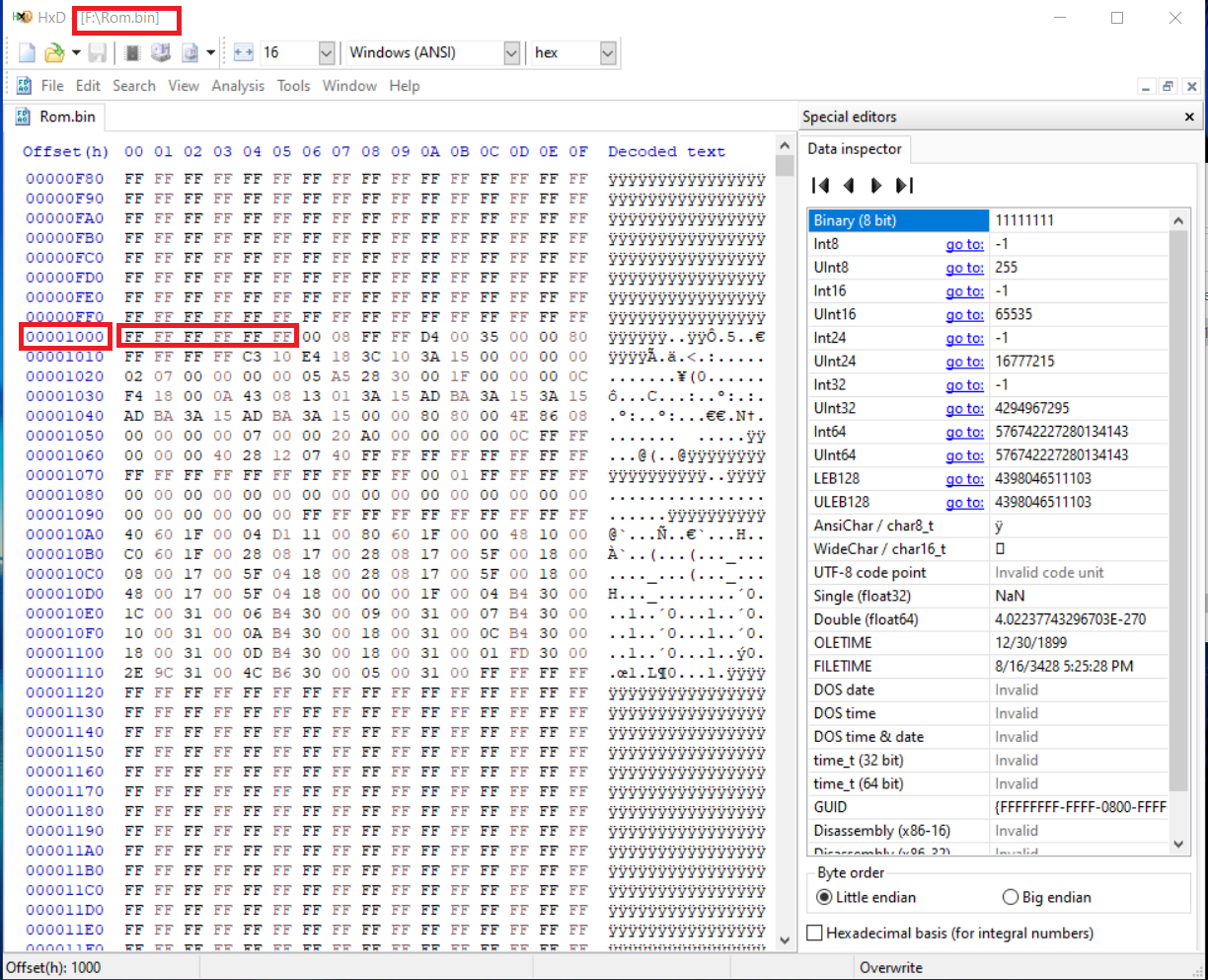

            I don't have a backup of the original bin. I wrote one of the files given here. System boots but MAC is FF:FF......
            What are my options?
            Thanks.

              Can you find your device's MAC address? And which bios file did you use?

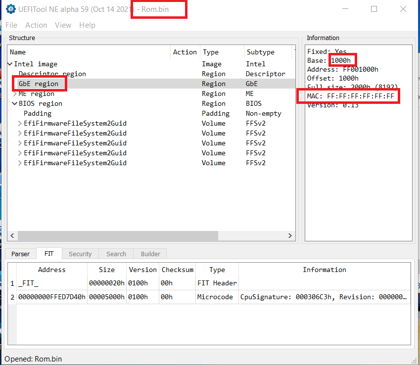

                  I want to believe any MAC address should work unless it's FF:FF:.... Does MOBO check the validity of MAC and disable the NIC?

                  NIC on the board is Intel I217-LM. I couldn't find the appropriate EeUpdate.exe file for this one.

                        Q _ Do I really need the original MAC to get ethernet card to work ?
                        A _ That is obvious.
                        Q _ Even if I do, is there a way to embed MAC address to bin file and flash the BIOS ?
                        A _ Yes , you can. See the images under.

                          I used another dump from an identical model and it works. Now I will change it to a random MAC address to eliminate duplicates on the same network. It seems there is no control mechanism to authenticate the original MAC address of NIC, as long as it has an acceptable one.
                          Thanks a lot!

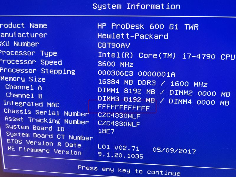

                                    Thank you so much for everything,
                                    I just tried it and it works. The only problem I have now is that I don't have a MAC in the BIOS. Everything comes out f
                                    Does anyone know how to edit the MAC on the Prodesk 600 G1?

                                        Sorry for not responding earlier, I have to say that with this new version I already have a MAC. Thank you very much for your work. Now my daughter already has the equipment working.
                                        Thanks again.
