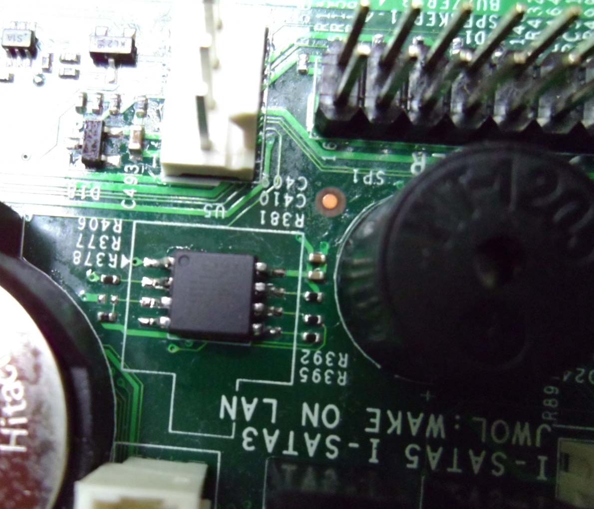

              Now that it's getting warm in the Southern Hemisphere, I can play in the workshop without freezing
              Inspired by
              http://mondotech.blogspot.com.au/200...spi-flash.html
              and
              http://www.mylesgray.com/hardware/fi...n-motherboard/

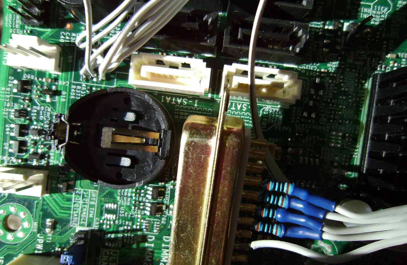

              I tried a reflash in situ
              Without success - maybe would have worked had I known at first, what I subsequently learned

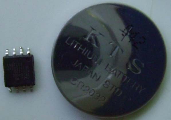

                So I desoldered the BIOS chip - what a tiny little thing, beside a CR2032 battery for comparison

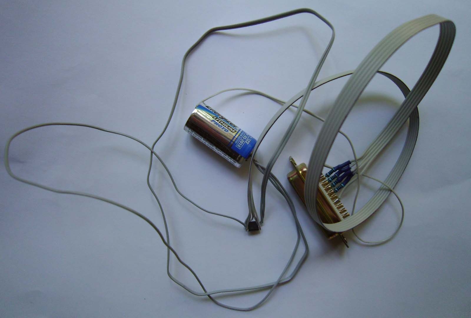

                  Then learnt the hard way how to reflash it with the latest Supermicro C7Q67 firmware image - which has changed, together with their reflash script, from the version I originally used
                  The Rube Goldberg setup used for reflashing, via the LPT port on another motherboard

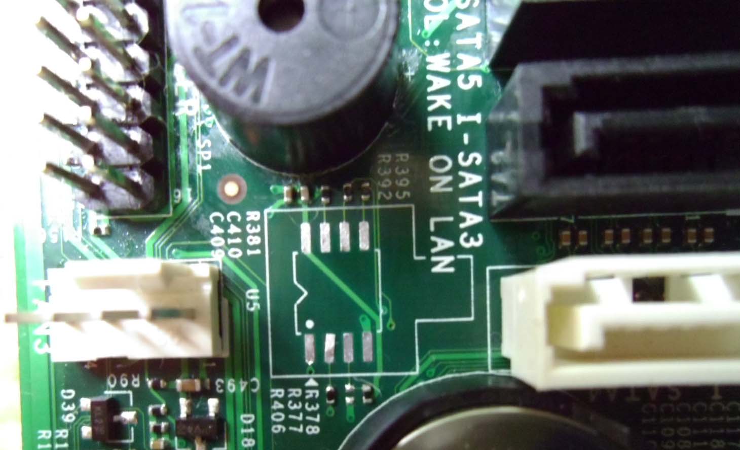

                    The C7Q67 ready for replacement of its BIOS chip
                    better to keep quiet and be thought a fool, than to open your mouth and remove all doubt
                    • pfrcom
                      Oldbie
                      • Jun 2006
                      • 1230
                      Re: No love for SuperMicro C7Q67
                      Replaced

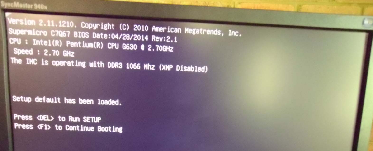

                        And all this effort rewarded
                        • pfrcom
                          Oldbie
                          • Jun 2006
                          • 1230
                          A pox on Supermicro and all their houses

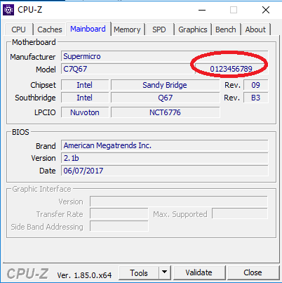

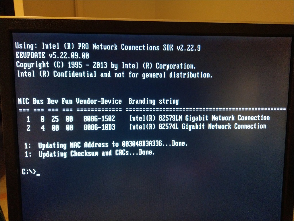

                                  I fixed an identical board here but afterwards noticed the MAC address for NIC1 was wrong.
                                  Instead of something sensible it was 88:88:88:88:87:88
                                  I found the following thread that described the use of Eeupdate which I've also attached to this post.
                                  The MAC address was printed on a sticker on the board and it was no problem to update it.
                                  There might be some more SMBIOS & DMI data etc still being wrong but at least the board seems to work fine like this with Server 2016

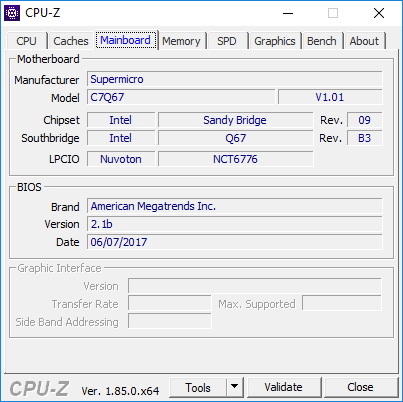

                                    The attached tool can fix the DMI data on the AMI BIOS for the Supermicro C7Q67
                                    Usage in MS-DOS as with the tool in my previous post.
                                    It has a built in help so it's easy to understand.
                                    Code:
                                    amidedos /SS 0123456789
                                    amidedos /SV V1.01
                                    amidedos /BS 0123456789
                                    amidedos /BV V1.01
                                    In the post I linked before I did dump my corrupted BIOS.
                                    The data is stored in the BIOS under GUID: FD44820B-F1AB-41C0-AE4E-0C55556EB9BD
                                    I could use AMI Aptio UEFI MMTool v5.0.0.7 to extract that module and confirm my serial number and board revision.
                                    (Which is also printed on a sticker & the PCB respectively).
                                    Of course I could also have replaced the module from my backup and flashed the BIOS.
                                    But as recovery of soldered BIOS chips is not my favorite past-time I prefer a nice MS-DOS utility
