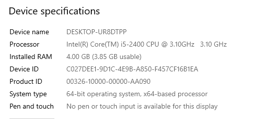

    Hi my PC win 10 random freezes, already did sff /scannow tested HDD, memory and did Fresh start any help would be appreciated ,have a Merry Christmas

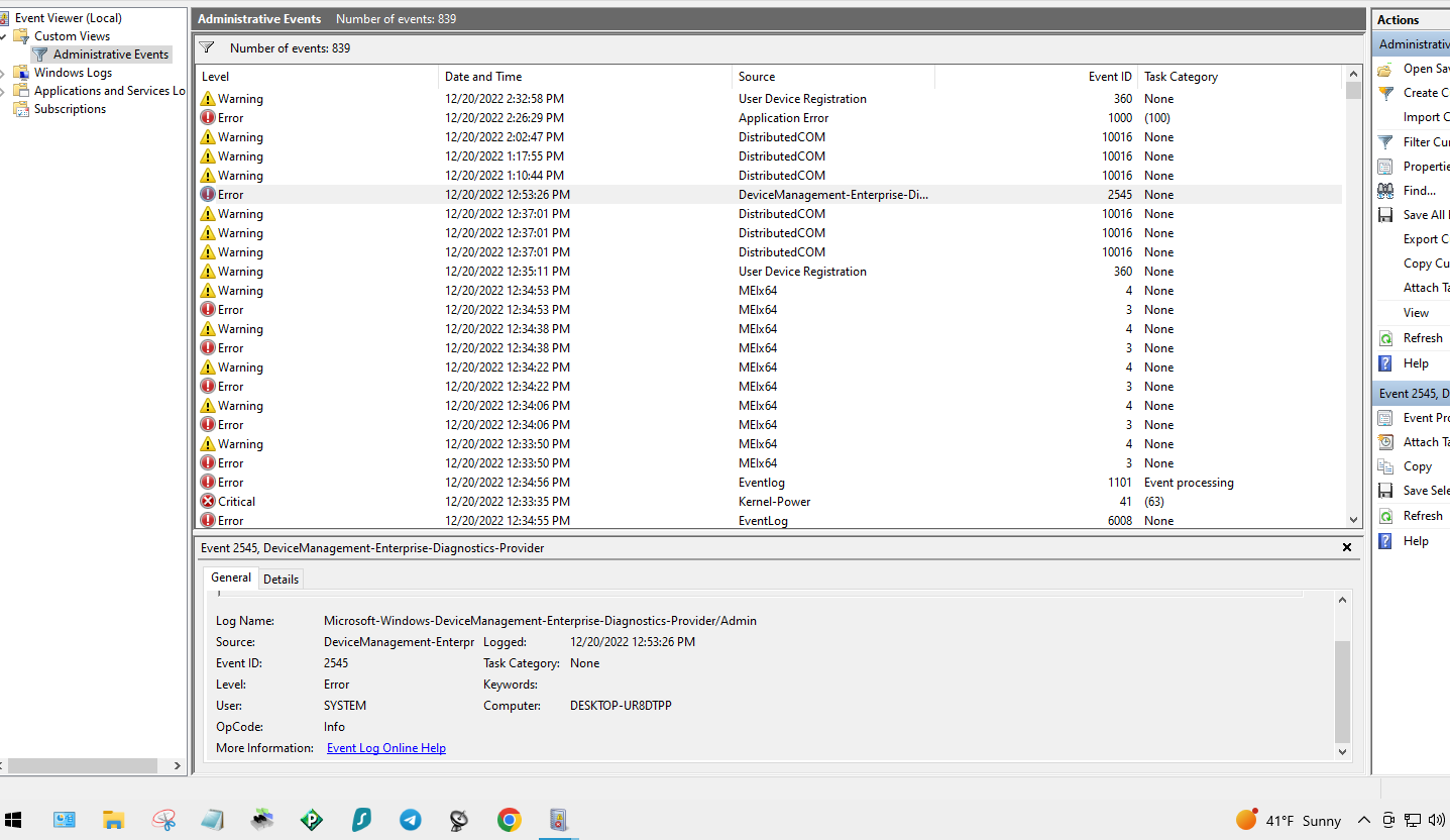

      Did you check the Event Viewer in Windows? Sometimes this provides clues what has failed and caused the freezes.
      Thanks mate i have lot of errors, but i don't know what is what? see pic attach.

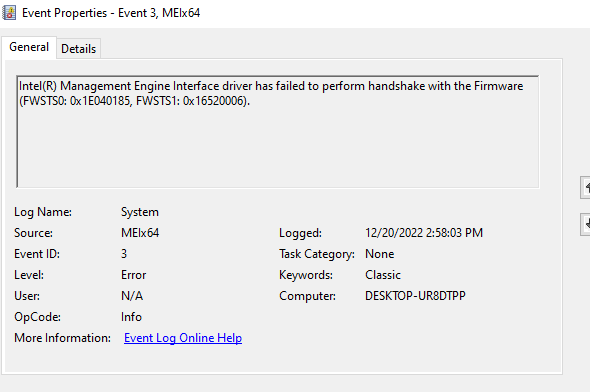

        Re: PC Win 10 random freezes help
        Last freeze i think this is the error log?
          Yes, problems with the Intel Management Engine Interface driver can cause the system to freeze. You could try the following things:
          - Check Windows Update, maybe there is an (optional) update available for this specific driver
          - Check for a BIOS update for your motherboard
          - If there are no updates available at all, you could try to remove and reinstall the driver or even disable it and see if this solves the problem (Device Manager->System Devices->Intel Management Engine Interface).

                  Thanks mate; i've disabled the *Management Engine in device manager*.
                  Now i'll wait till it freezes again.

                          Hi guys ,FZG and Diif ; good news 1 week or so after i used the advice uninstall
                          Intel Management Engine Interface, did not freeze no more, and it saved from grief and probably reinstall system for nothing .So thanks and have an happy new year.

                                  And for the win Event expert, what mean Critical (kernel power) in picture of post #3, is that connection for hardware issue?
                                      Usually that error is something along the lines of "the system has been shut down unexpectedly". For example force-shutting down the PC by holding the power button for a few seconds might trigger this error. So this is not restricted to actual hardware faults.
                                      @ ivtec: Glad to hear that disabling the MEI sorted out your troubles. Hope you´ll be free from computer errors, at least for the rest of this year
