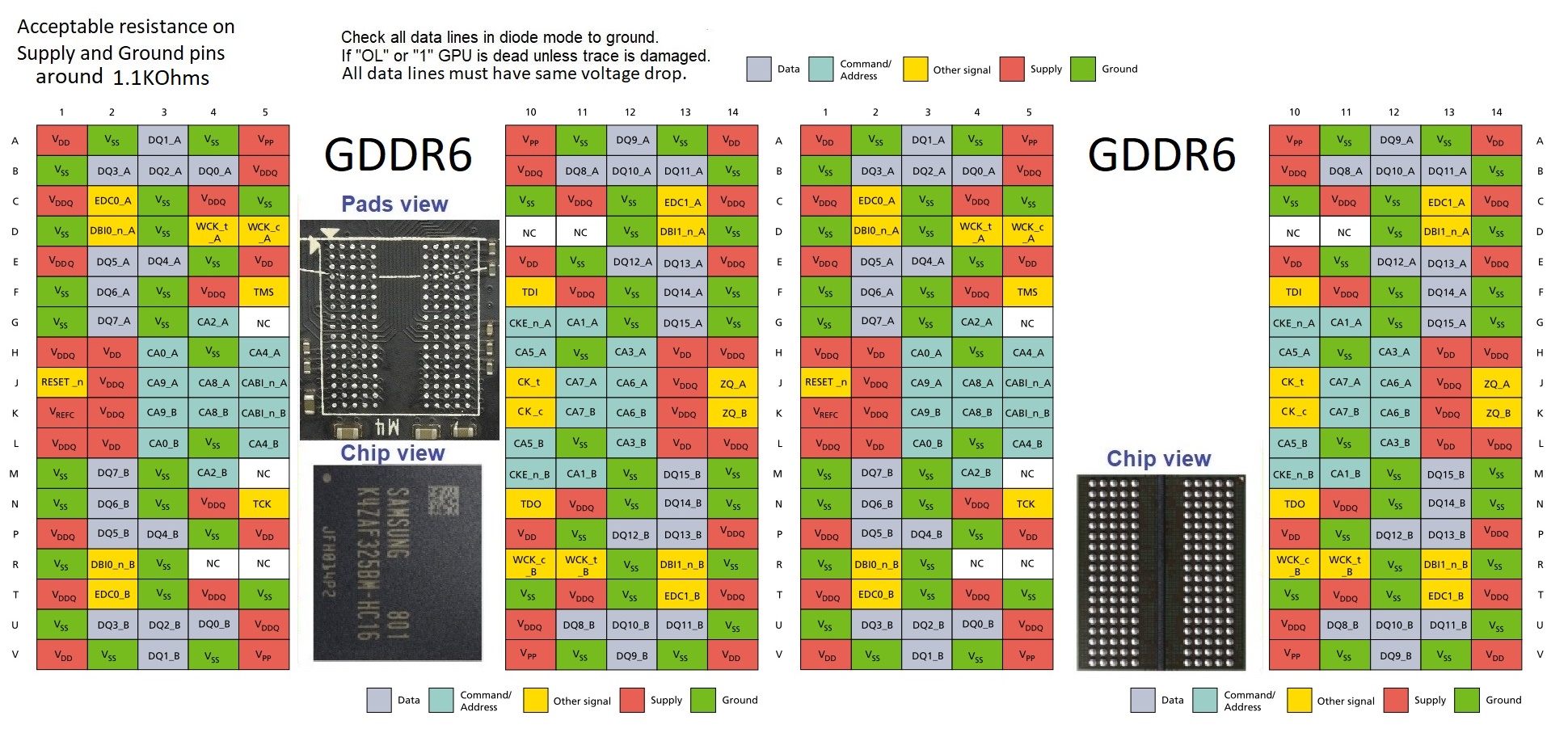

    Zotac RTX2080Ti 11g - bad memory channel, after change still the same
    i have this Zotac 2080Ti 11GB which shows completelly bad memory D0 and D1. Lines of artefacts on screen. I change IC to new, but it shows the same error. There must be something bad on that channel. i try to measure resistances and voltages, but no luck. Card have not good cooler so maybe ball under GPU
  • Prott
    • May 2022
    • 154
    • Czechia
    Re: Zotac RTX2080Ti 11g - bad memory channel, after change still the same
    Sounds like a bad memory controller in the core. Unfortunately I am afraid you will either have to scrap the card or change the core.
      what to check? i dont want to reball gpu just for fun
