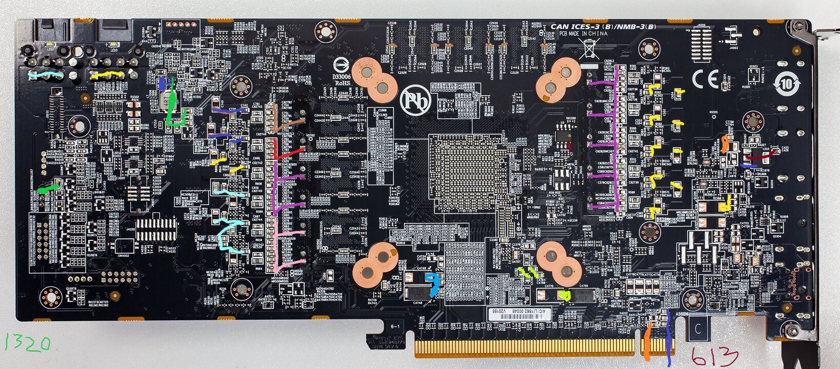

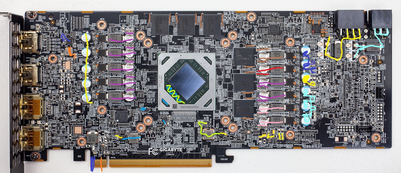

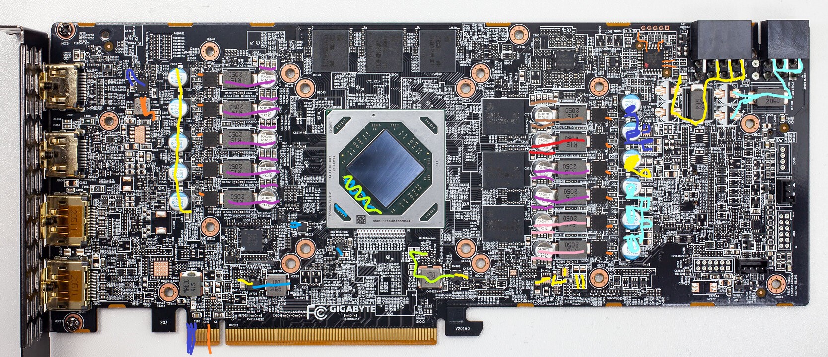

              Re: I broke my 6700xt after doing a copper shim mod

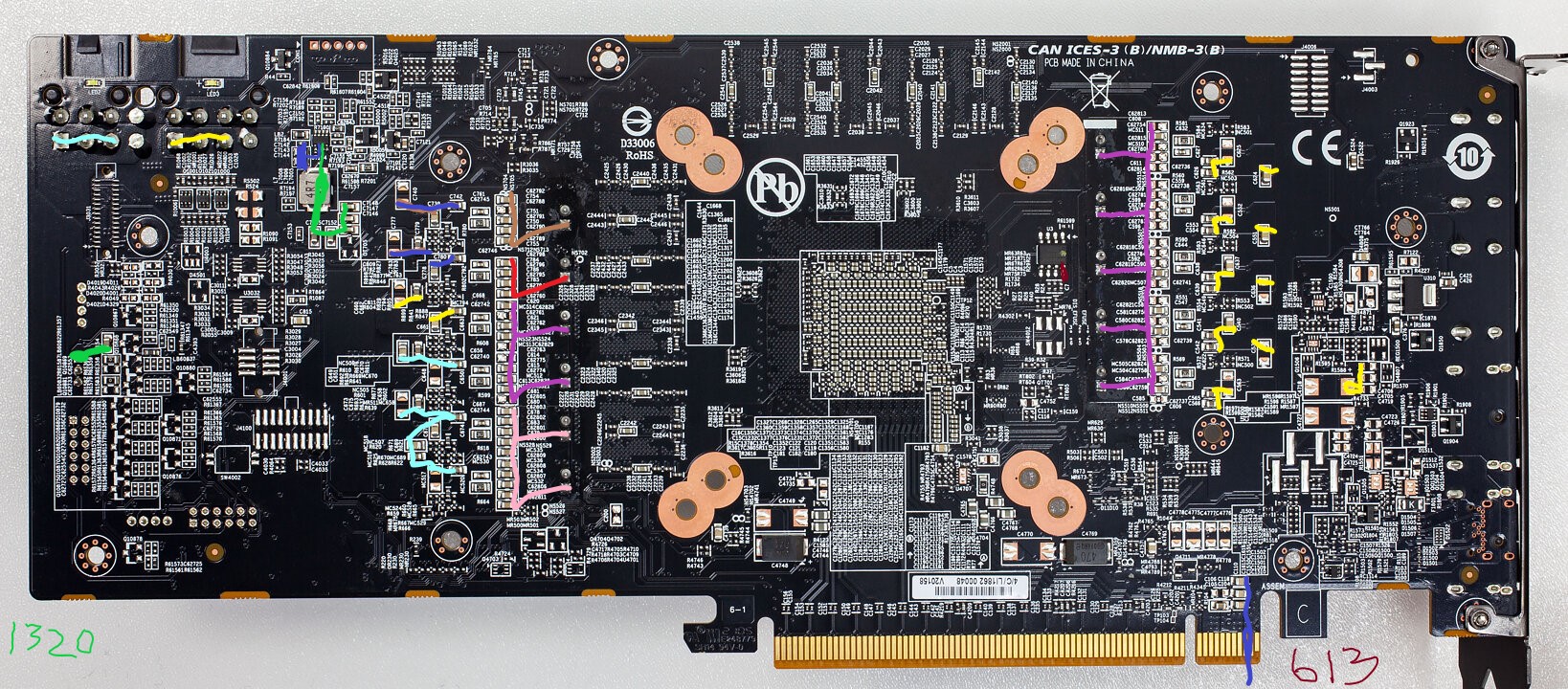

              Ok I got the bad cap off there without burning the PCB, using a cheap 858D. And that was the only short, unless the core is toast, because it sure gets hot.
              So with it connected by a 1x PCIe cable (waiting on a proper 1), and it's 12V, I get the following voltages, until a bunch cut out. And it seems all of them can be tested from the backside, so that's great for now, I have it on the cooler.
              See the pic below
              Pink=0.91V , I guess that's memory controller
              Purple=0.92 Vddcore which sounds about right for some idle state, but damn it's hot under the core
              Red=0.815V , 1 of the main phases
              Brown=1.36 Vddram
              Light blue just under PCIe=0.75V
              Neon Green under PCIe=1.81V
              Dark Red=5.04V ,3-terminal reg
              Orange by above reg=5.04V, thats Vcc for the DrMOS, but not from the reg. above
              Green near 8pin =5.06V, for the fans,etc
              12V looked ok, I forget to check mobo 3v3 in (it mainly goes to the MCU, not the DrMOS orange)
              This in a PC w/ no hardrive, and I get no video at all, and after 20-30s, the GPU turns off all voltages, except the all three 5V rails, and the 1.8V rail.
              The caps under the CPU really get hot by then, but they always did run hot, but I can't rule out something's overheating in/around the core.
              After a quick look w/ an oscilloscope, all looked fine, except I never saw any activity from the BIOS chip, not p5-6 anyways, and Vcc was there.
              I'd really like to find any overtemp sensing pins from the core, IDK if that all gets fed to the MCU. Or maybe see what current is being detected by the various DrMOS or controller's, maybe something is using way too much current.
              I'll have to start looking for power good signals, and enable lines.
              What does this sound like ?

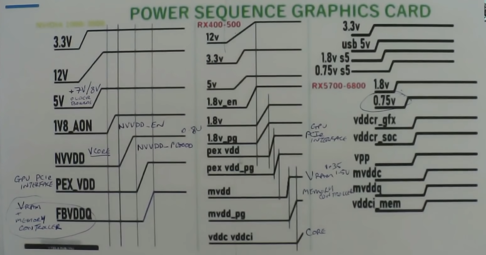

              • MasterCap
                • Jul 2022
                • 37

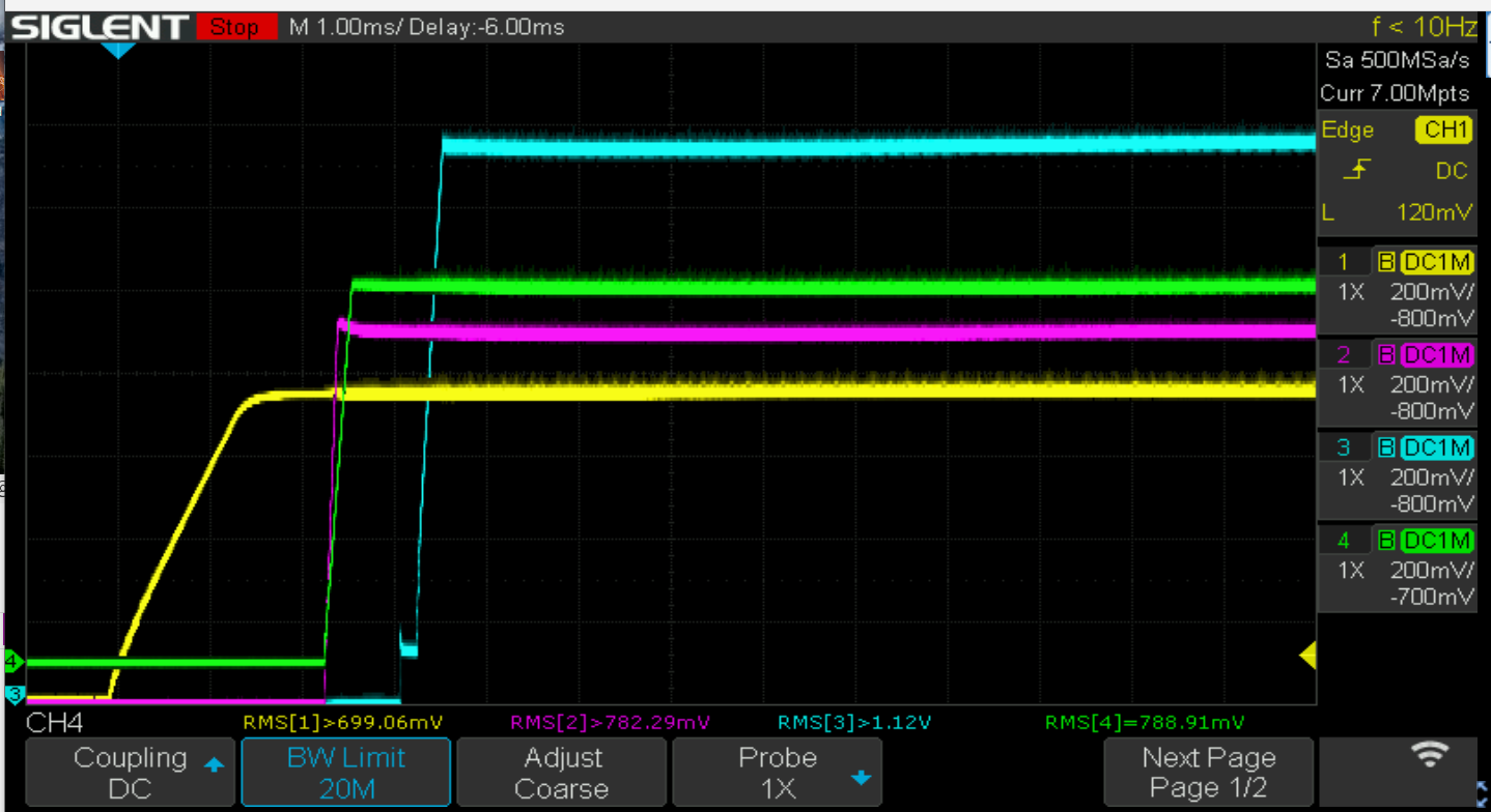

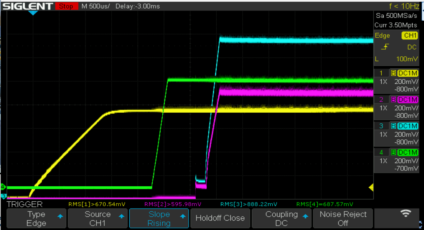

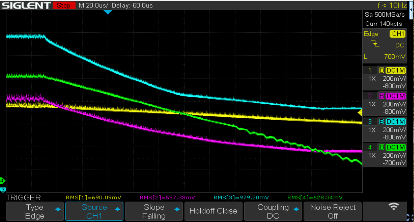

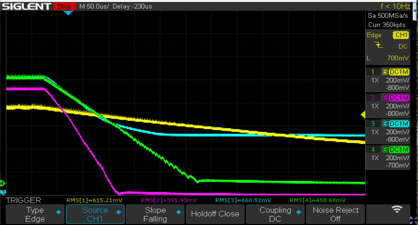

                Ok with some wires soldered on, the EEPROM is definitely being talked to, right at the beginning anyways. IDK how all that works, whether if it's the microcontroller that talks to it, or if the mobo talks to the GPU BIOS chip or only to the GPU micro-controller, etc. And there's no monitor connected ATM, IDK what exactly it talks to on the GPU.
                The back of the core is only hitting 55-60C before is shuts off, but it rises fast. But again the back often felt hot in the past, which is part of the reason I did a copper mod, and placed intel heatsinks on the backplate.
                Looking at the startup voltage timing's it basically matches the order in the video I saw on it, IDK the exact names or which is which, but they all look pretty normal to me as far as DC-DC converters go.
                And they all seem to shutdown at almost the same time, with the PCIe 0.75V being the yellow trace below, it's supposed to be the 1st to start after 1.8V, and it looks like it's the 1st to turn back off.
                on the scope
                yellow is PCIe 0.75V
                red is the main Vcore
                blue is Vram
                green is the pink phases, 0.91V probably the other core voltage
                and in the last 2 pic's red must be the the memory controller (and red on my PCB pic's)
                So time to check some stuff on the topside, but without a boardview, I will be lucky to find the logic circuits for the various enable signals.
                The game continues

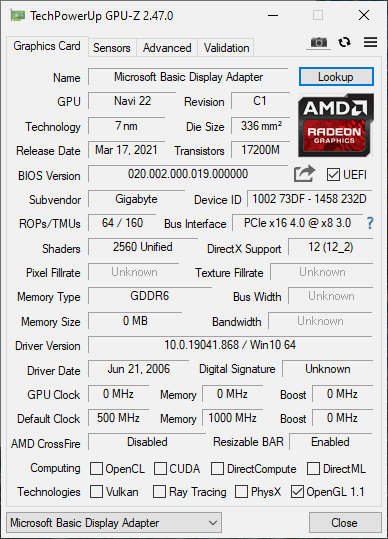

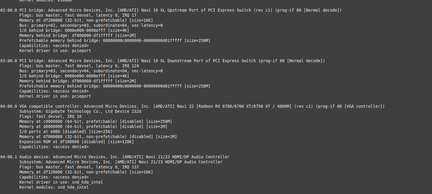

                        Here's what GPUz see's in windows, running off the iGPU tho, and some info Linux gives
                        For now I don't have solder balls, or a hotair gun I trust, or any experience with BGA soldering.
                        I'd need some practice before I'd try removing vram 1 at a time and see if that helps. I'm praying the memory controller is still alive. I'd need better gear before I'd trying re-balling the core.
                        I want to know how they check these at the factory, what I2C or JTAG tests do they run. I have no where near the programming skills for any of that tho.
                        And where do all those test points on the side of the core go ?
