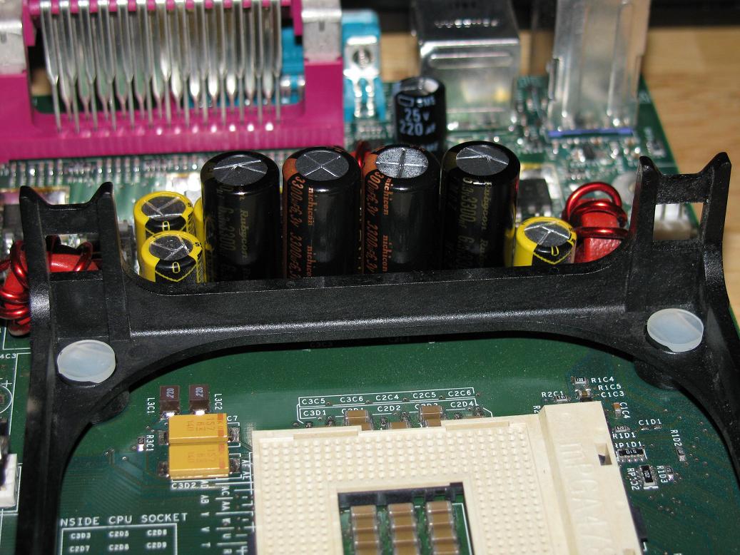

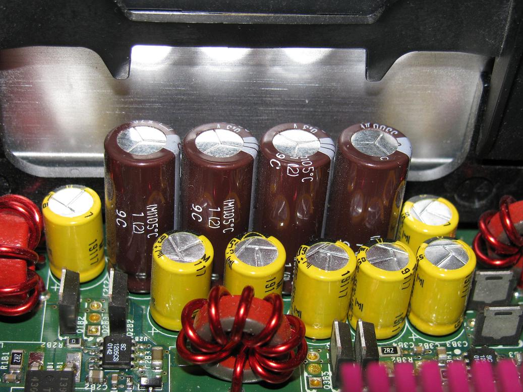

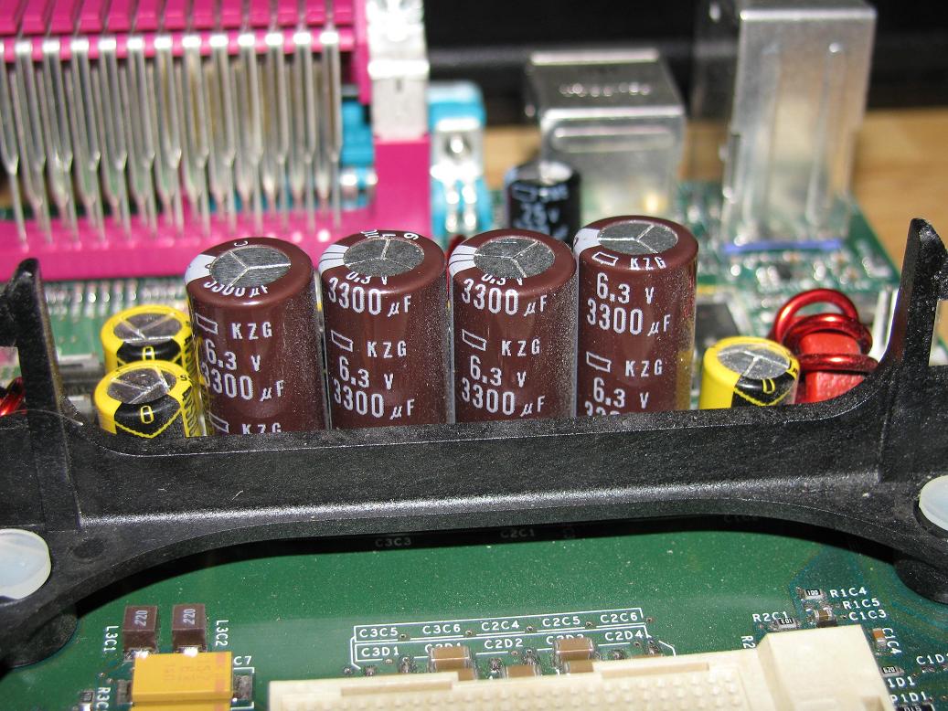

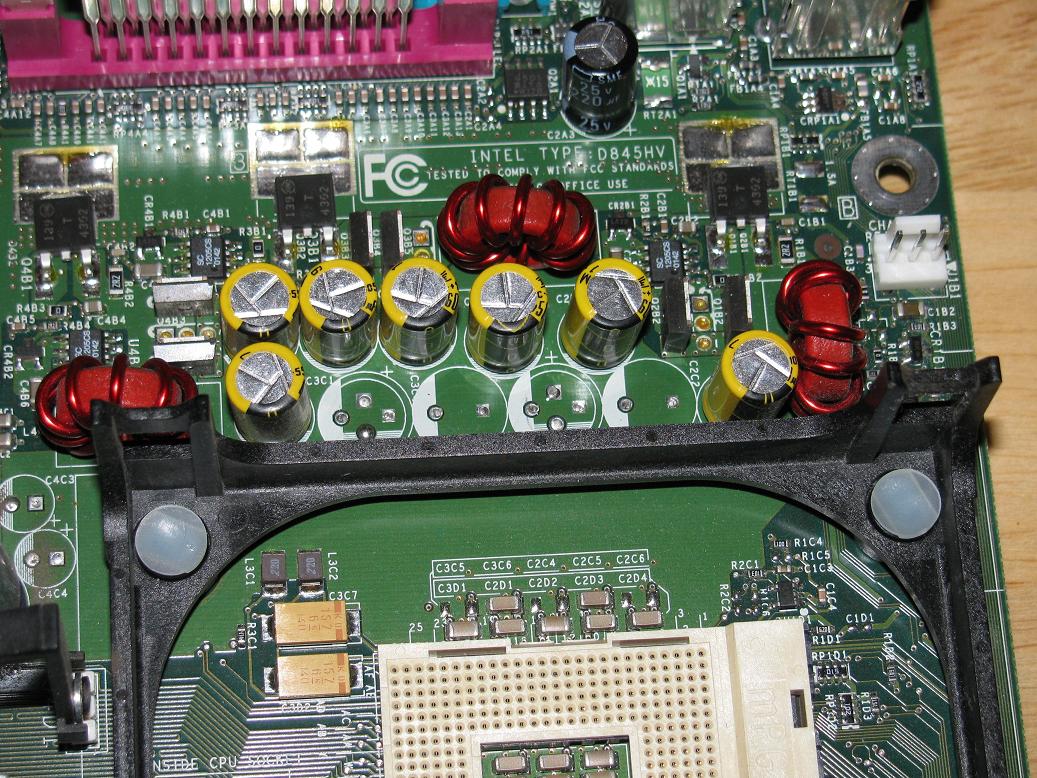

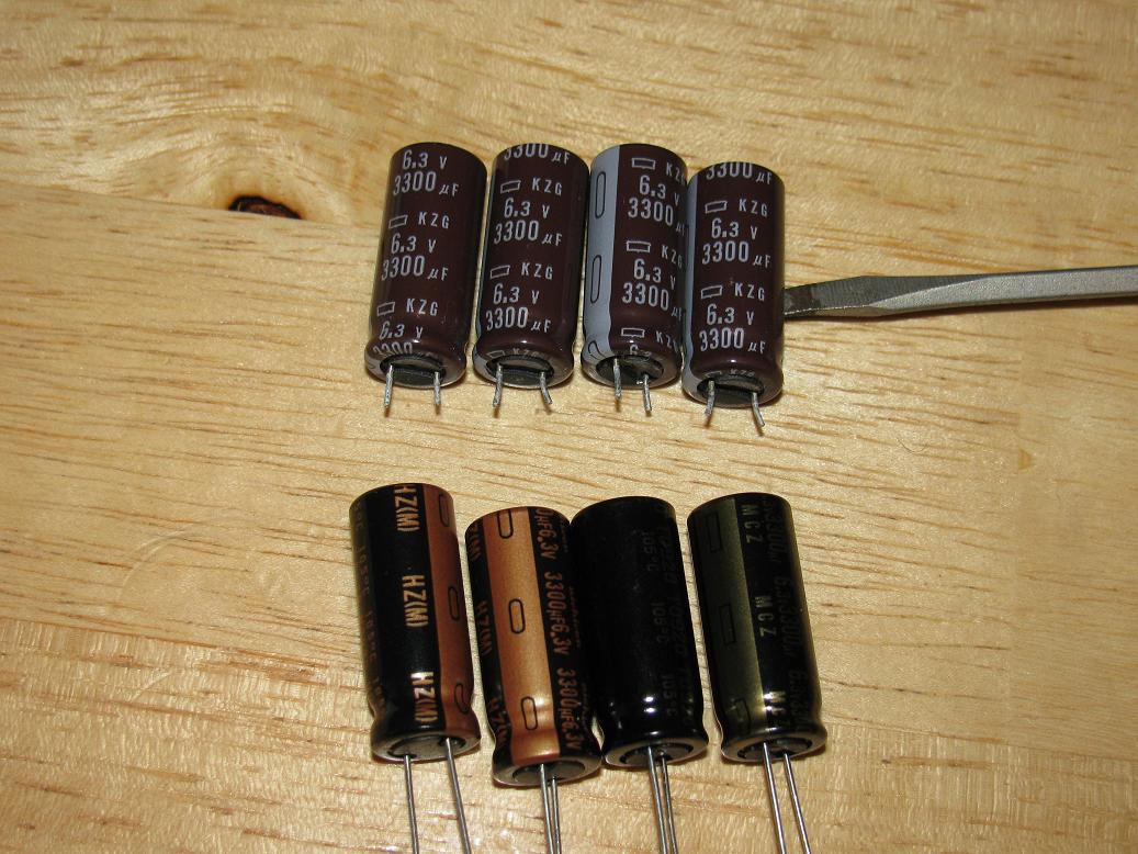

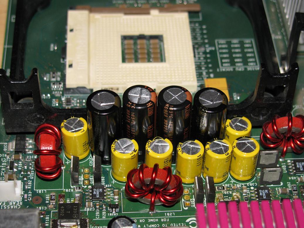

    OK I did a small scale preventative recap of one of these boards. It's the one that's in my soon-to-be-NAS computer. The CPU VRM consists of:
    4x NCC KZG 3300uF @ 6.3v and
    7x Fujitsu FPCAP 560uF @ 4v
    The CPU is a P4 Northwood 2.0GHz, and the hottest I've ever seen it (when my brother had it clogged with dust) was 40C, under full load. I know that KZG can be sensitive to heat, so even though they haven't been under too much stress, I decided to replace them anyways. They're getting to be 7ish years old, and I'm planning on having this computer last me quite a few more years, so I decided to do a recap.
    For whatever reason (me just being weird), I decided to replace the KZGs with
    2x Rubycon MCZ 3300uF @ 6.3v and
    2x Nichicon HZ 3300uF @ 6.3v
    It's been up for about an hour, seems to be running just fine
    Here's the pictures!
    The originals:
    And from the other side:
    Here's where they used to be:
    And the originals (on top), and the new ones (on bottom):
    Here's the finished product:
    And the other side:
    Hopefully it'll last for a good long time!

    just out of curiosity, why did you use 2 ruby's and 2 nichi's? Why not 4 of the same?

      Re: Intel D845HV
      I don't really know, I'm just a weirdo I suppose...
      but who here isn't?
      I had it pegged at 100% CPU all night and it's still going strong!

          You should have done 1 of each brand and retest them 12 months later with an ESR meter. :-)

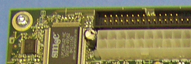

            I busted a cap on my good old 845.
            Tried to unplug the 20-pin PSU jack, but when I yanked it out I busted a cap next to it. So now I can turn on the PC just fine and it works for some 10 minutes or so, then it shuts down. Can't get it to POST for next half an hour or so, then it works fine... for another 10 minutes. Guess I'll need to fix that ASAP.
            Can't find my broken cap, must have hoovered it up.
            Please advise me what values should I look for when buying a replacement cap.
            I'm talking about this cap in the attached picture.

              22uF 25V Nichicon 85C
              I have many Intel D845WN and they all have that cap there. Obviously these boards are different than yours (they are not small factor) but I believe that they use the same capacitor in that position.

                  Those 85C caps on Intel boards [usually see Nichicon VR series] start going bad after about 5 years depending on use and case temp.
                  - - - That includes the 4&5 mm ones.
                  I've seen them [VR series] actually bloat on both skt 370 and skt 478 Intel boards.
                  - - - That includes the 4&5 mm ones too.
                  Usually they just make the board quirky/unstable or cause random BSOD or reboot without any visual indication they are bad.
                  Nichicon VZ is the natural replacement for VR.
                  [In fact I've seen examples of the same model Intel board alternately have VR or VZ from one board to the next. IOW Intel uses VR and VZ interchangeably.]
                  Now, LXZ, they are easy to get, cheap, and a lot prettier than VZ. [Just a thought..]
