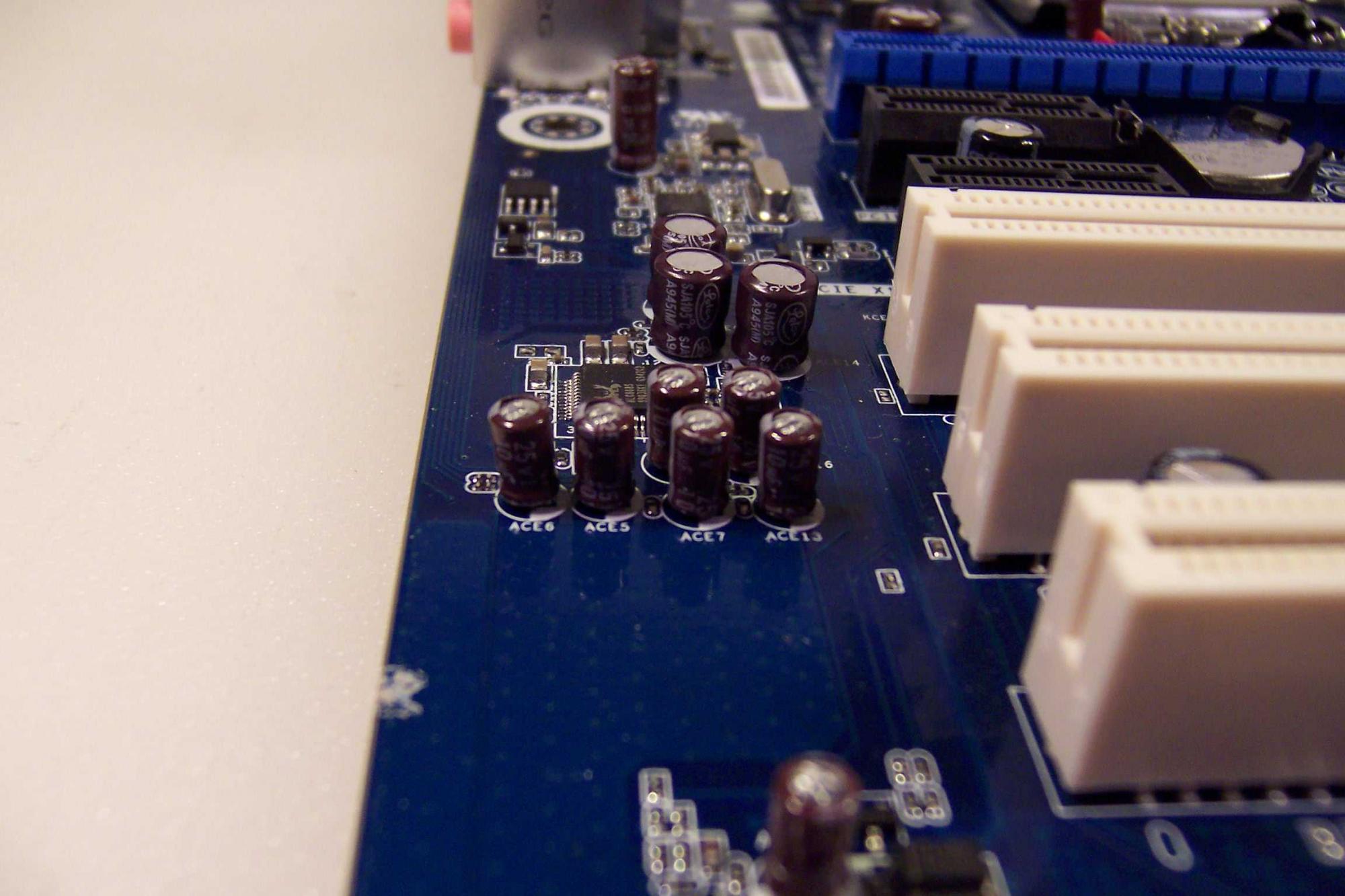

              Usually Nichicon VR. - Sometimes they were more creative.
              They've been bouncing back and forth between 85C and 105C for the small caps at least since P-III.
              You can have two otherwise identical boards but one has the 85C and the other 105C.
              Maybe they've finally figured it out but I wouldn't be surprised at all to see 85C showing up again.
              Intel has gone China on us.
              Some of their newer non-server boards are showing up with Lelon all over.
              Pic is a DH55HC board which only has a few. [H55 chipset]
              Been seeing Lelons on Intel boards from the H55 at least back to the 31 series chipsets.
              I don't mean OEM boards either. Talking retail models.
              Some boards have LOTS of them.

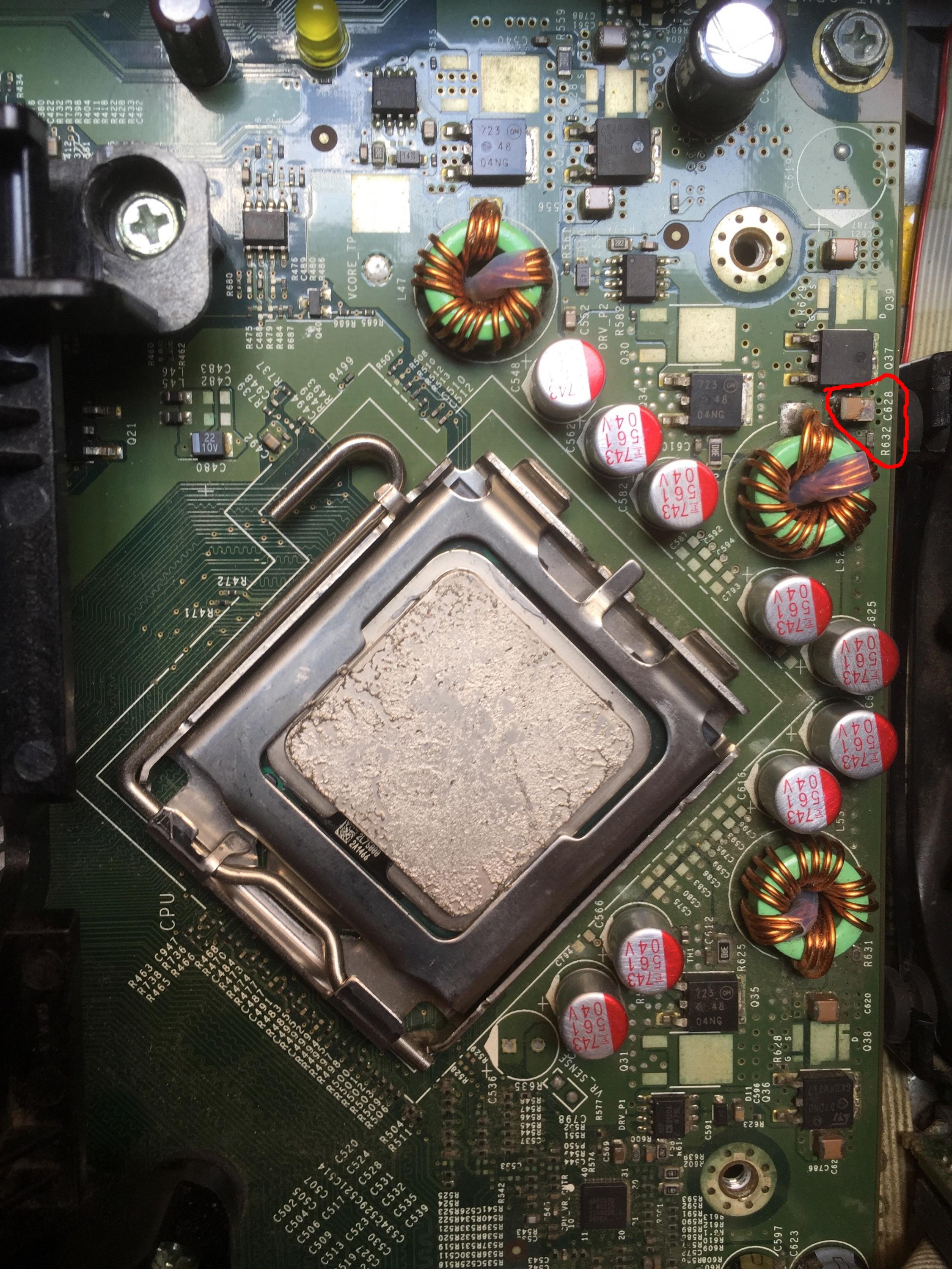

                                I have 2 Optiplex 745 that died with bad SMD cap C628 (near the CPU).
                                Can someone tell here what's the value of this cap ?
                                Il also wonder if this has something to do with the STD70N02L Power MOSFET that's just aside ...

                                  Re: Dell 745.....Here we go again!
                                  Here is a picture of one of the 2 motherboards that died (blinking orange), with C628 circled in red. The other capacitors are good.
                                  Premium supporters get full download access and other benefits.
                                  • Per Hansson
                                    • Jul 2005
                                    • 5897
                                    • Sweden
                                    #37
                                    The value will be the same for one of the on the other phases, for example Q36 at the bottom of your picture.
                                    It's possible that your board has other issues, desolder that capacitor and make sure you don't have a short at that location.
