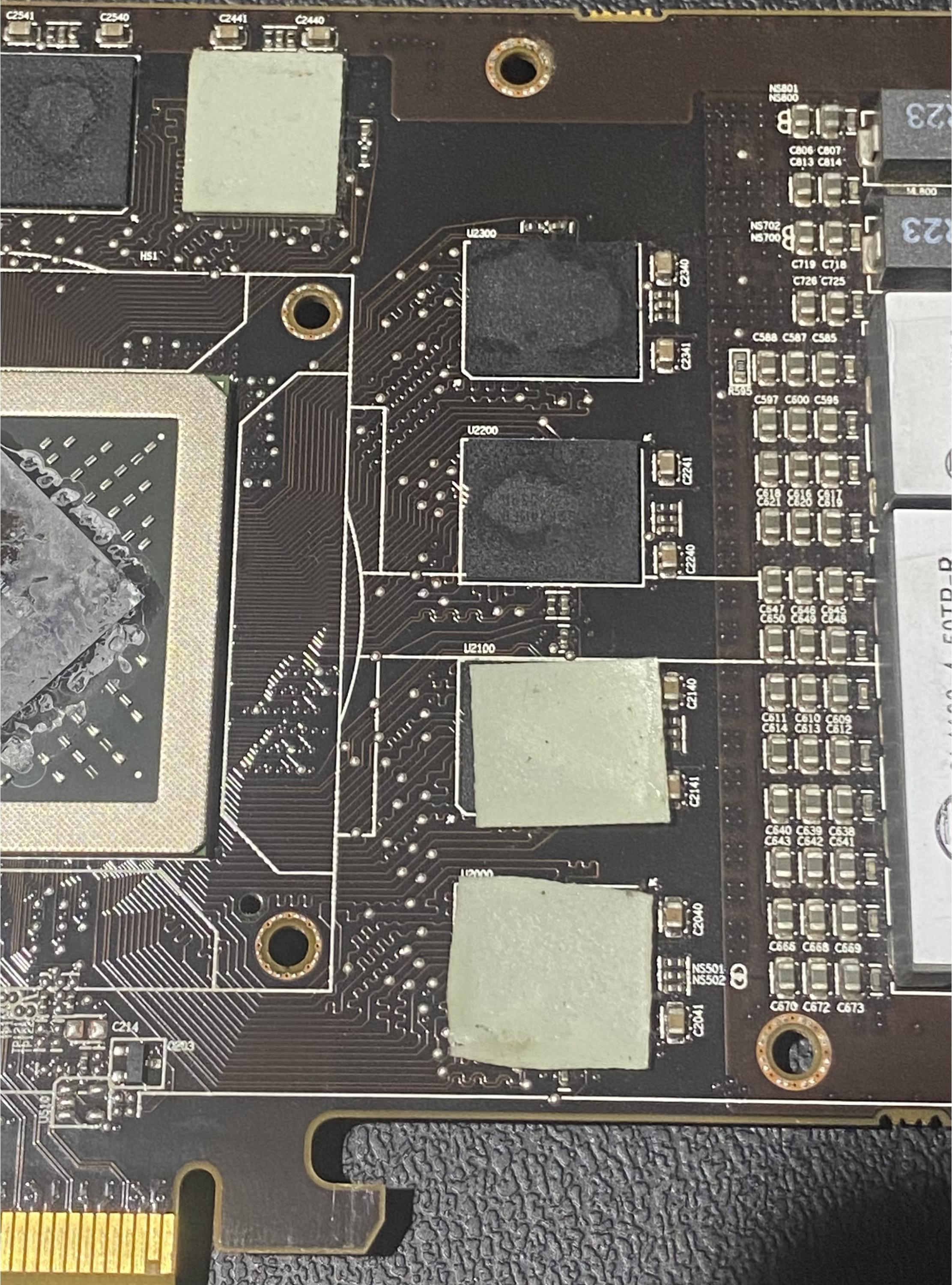

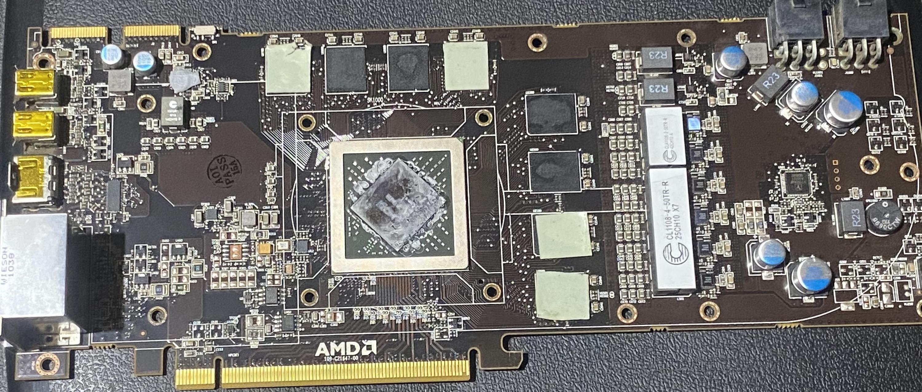

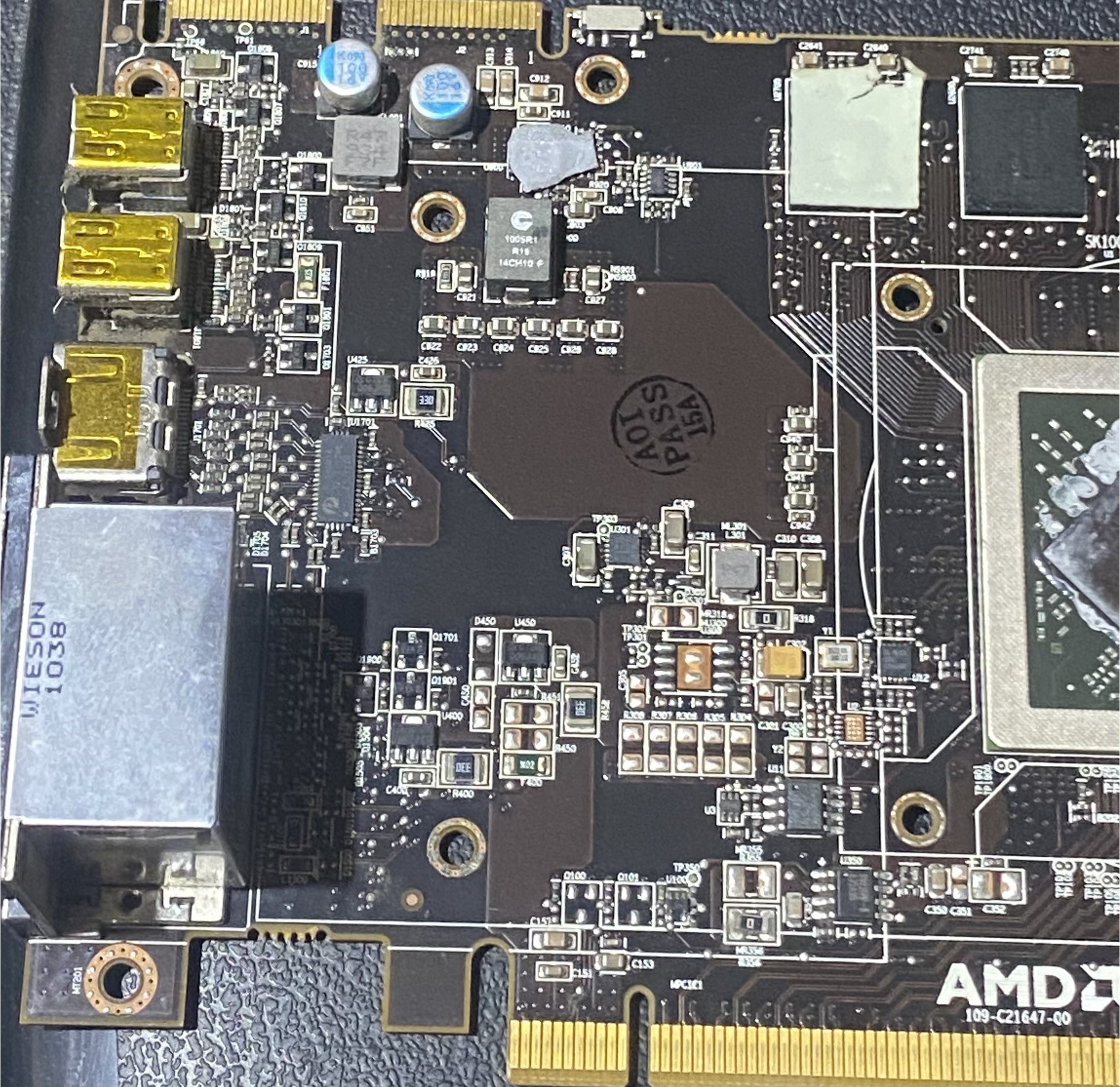

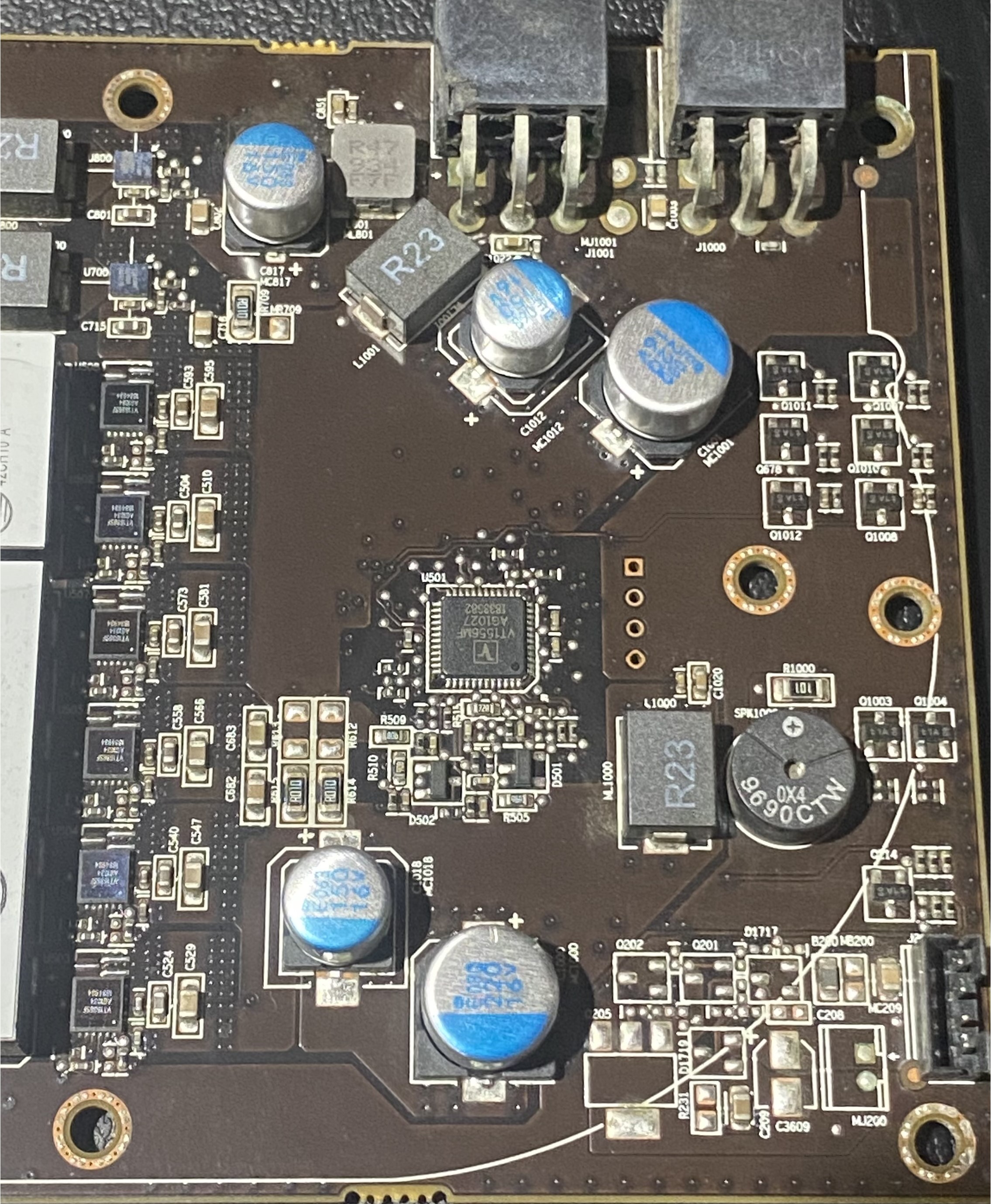

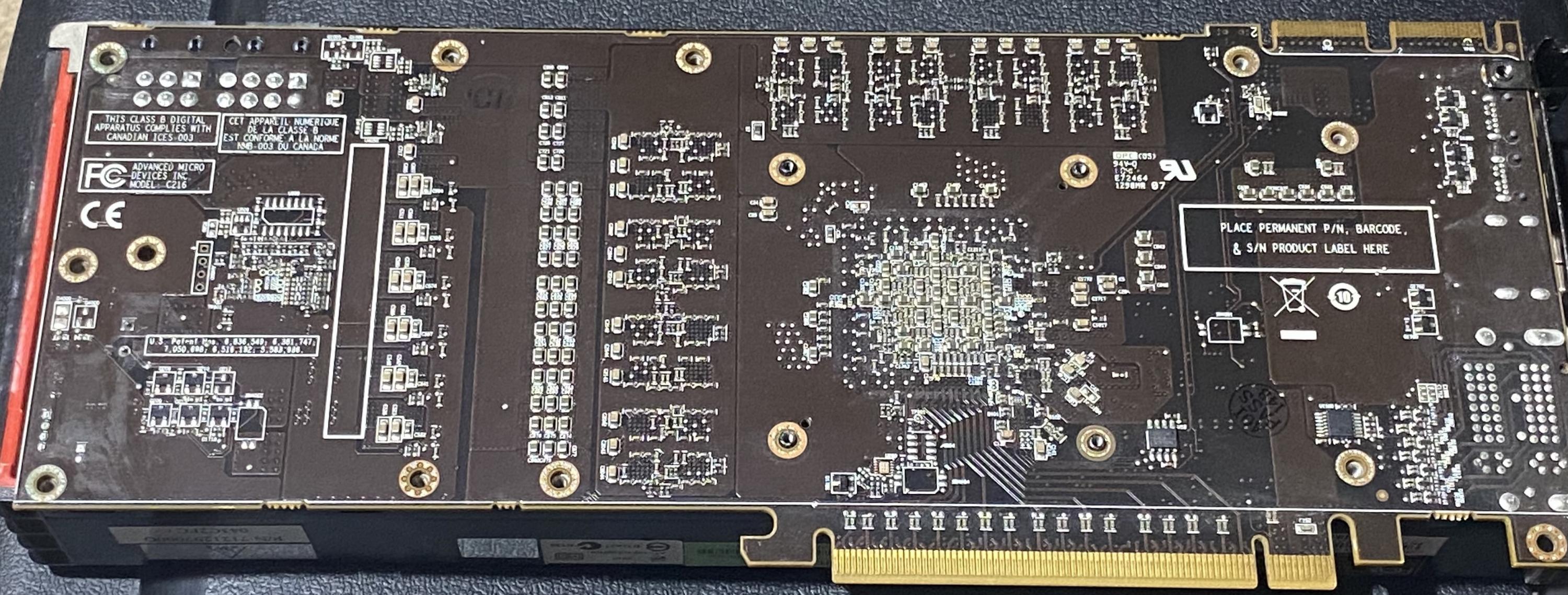

        Re: Dead HD6950 how to troubleshoot?
        Hi Rich,
        Here are some photos of the card.
        Thanks for any help
          Originally posted by piernov
          Very likely dead GPU.
          I suspect the same as well. Large die ATI/AMD GPUs are just problematic (not that nVidia ones aren't.)
          That's not to say I discourage any troubleshooting. The steps that dicky96 suggested in the video are a good start. But just keep in mind that it might be another unrepairable card... so use that to meter how much time and effort you want to put into this card.
          I'd personally chuck it for a quick reflow/re-heat and see if it comes out alive. If yes, you know the problem was GPU. If no and you didn't go over-board with the heat, then no harm to the GPU really and you can continue troubleshooting normally. I just prefer the reflow/reheat method, as it saves me time troubleshooting on these big GPUs.
