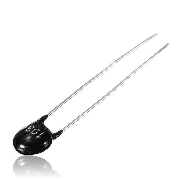

                But I'm looking at the startup section and there is something looking like a tantalum cap (but bigger?) labelled "RT" any idea what that refers to ?

                    Sensor thermistor maybe? does it look like this picture?
                    Hard to see from your photo because the lighting is inadequate.

                        A lot of oxidized solder, exposed traces etc. Make sure the traces are good. Hard to tell what that component is in the picture… I buess a thermal resistor and it has to be good, since you did get 170V into the main filter cap. Look at the components and traces between the FET and 8pin IC PWM
                                I've ohm'd out these traces and they're ok even though they look bad and are exposed.
                                I will take care of that if I repair it and decide to put it back into service.
                                And yes it looks like the picture above thanks for confirming it is working.
