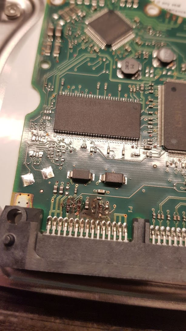

    Hello Folks.
    I did a stupid mistake and switched power Cable between two different cable select power supplys-
    when turned on the pc smoke and bad small appeard.
    when dissambled board i saw the burnt area-
    can i just shortcut those open bridges?
    is there a chance to repair... or put it into trash?
    i have no idea what part where burnt ;/
    hope someone can help me out-
    greetings

    Clean up the board and see how bad the damage is.
    You certainly need to replace some components and some trace rework might also be needed.
    If you don't have any soldering experience, an easier solution would be to just replace the PCB with a new one.

      Check for shorted diodes nearby.

        or find donor board and swap loader eproms

          I am just curios if it is possibe to repair...
          on the easiest way.. just to replace the burnt pieces
          and look what happens..
          does someone know whats these are.. ? diods ? resistors..?
          there are no values where i can look up

            This may help
            http://www.hddoracle.com/viewtopic.php?f=100&t=86
