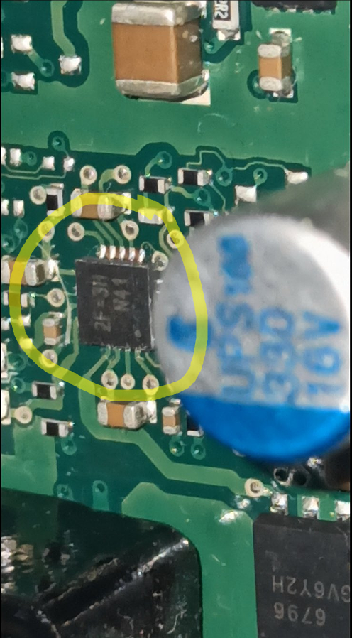

Can anyone help me identify shorted component on a 1151 motherboard?
  • LowVoltage
    • Oct 2020
    • 5
    • SRB
    I've gotten myself recently a brand PC "Fujitsu Esprimo P756/E90+", unfortunately it doesn't respond to power button at all, I'm very new to electronics, any help would be much appreciated!
    I removed motherboard from the case and plugged the psu in, with the power cable plugged in psu, I checked around the board to see if anything is getting hot and found that the component ( attached pictures of it,can't identifty it myself) gets incredibly hot to touch instantly, you can't hold your finger over it for more than a second else you'll get burned.
    I assume that replacing the shorted component would most likely fix the problem, I tried googling 2f=3h n41(if I read that correctly off the component) but no use, couldn't find anything relevant.
    (I did my best to take picture with some clarity at least, definitely need to invest in microscope or something similar)

    "2F=" → Richtek RT8230AGQW

      I've found one on Aliexpress, RT8230AGQW with label "2f=4f p2f", that one is okay replacement?

          Attached is the datasheet for this component.
          Page 2 has the details for the top side markings.
          Plenty of stock of the real part from Digikey.
          Not all suppliers on AliExpress / Alibaba / China are evil. Rather have had excellent results in component sourcing of 100% new and original parts that are not available in North America. Without their help, would have had a defunct $4k usd zeroplus logic analyzer and some expensive farm equipment from a local farm in the garbage heap. Like anything else, do your homework and raise your confidence that the supplier is for real.
          On the other side, we know for a fact that google lists a scammer from Hong Kong who claims to stock any electronic part you can dream of and at discounted prices. The company has no stock and will steal your money. Nothing will be shipped. We complained to the HK police but their position was that "but sir, you did not get scammed so no case". Search for the vendor you wish to deal with and with keyword "scam" to see if there is a history. If the vendor claims to be in business for xx years then there must be some history on the internet. If not, that is a red flag!!
          If we can help, post here and will share suppliers we have used with success.
          For the few parts like this one, stick with Digikey.
