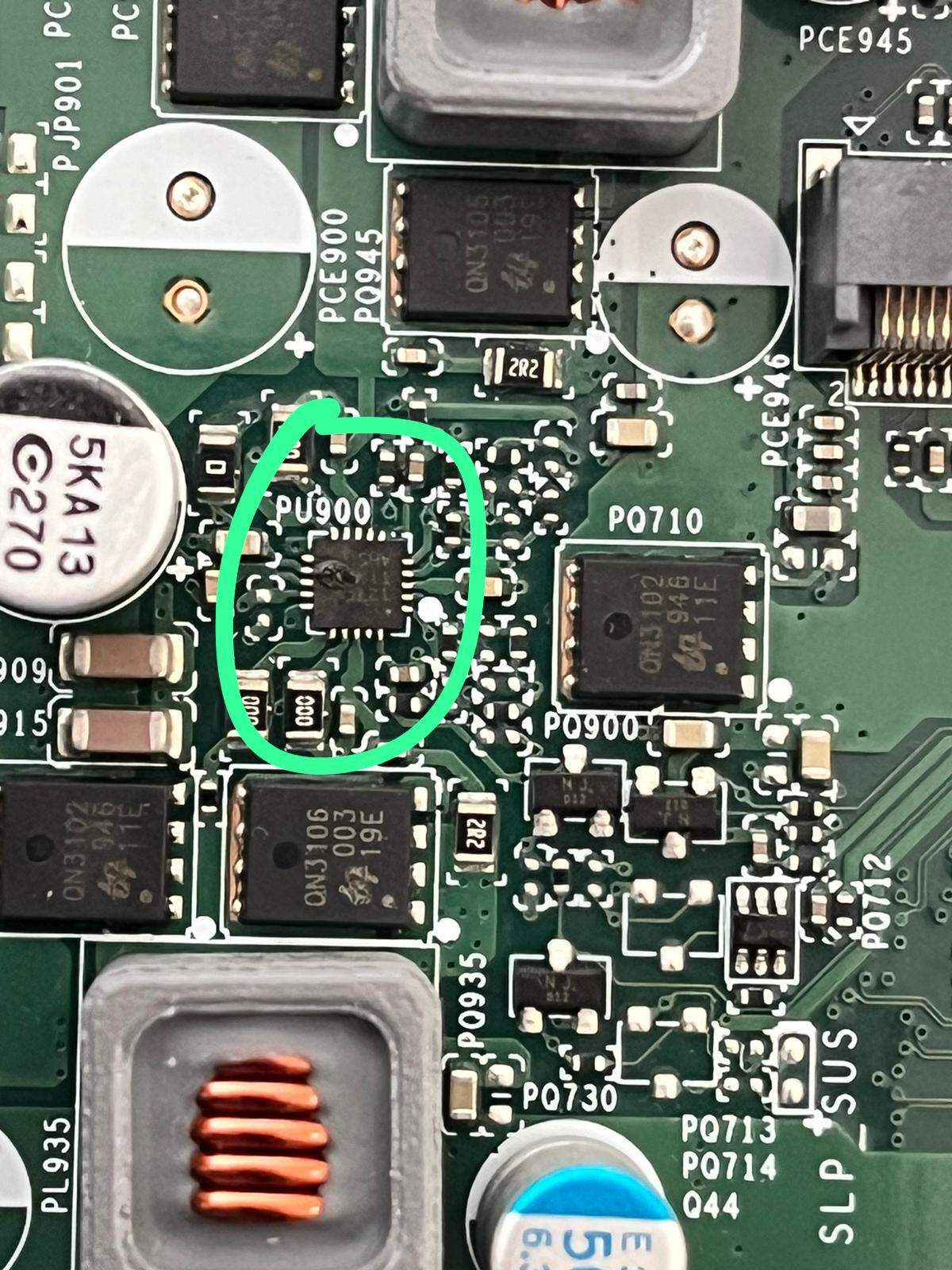

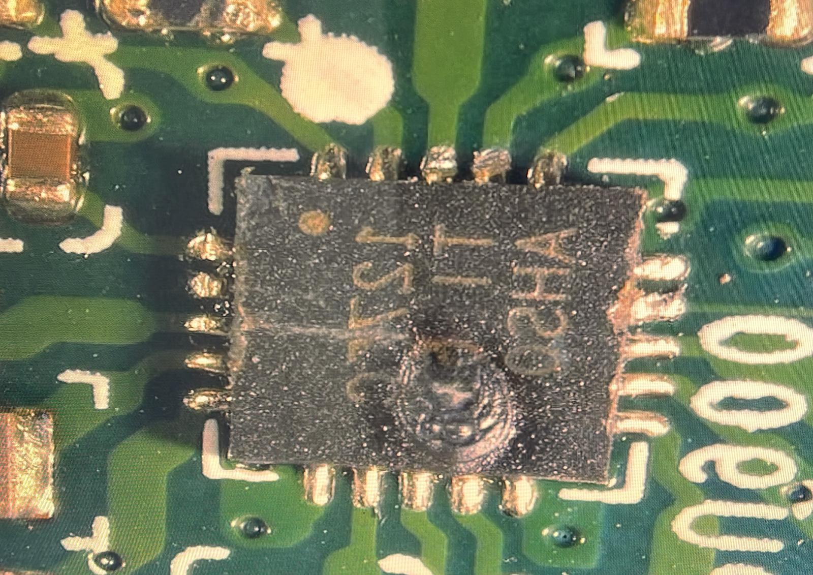

    Help to identify burnt IC on HP Motherboard L75365-001
    Hello
    I am trying to identify this burnt IC, looks like QFN20. The motherboard is starting for a second then stops. This occured after a lignthing strike in my area.

    Someone helped me on another forum
    https://www.ti.com/lit/ds/symlink/tp...dguru.com%252F

      Thanks. Was going cross eyed on the inverted and flipped close up pic of this ic. Is that a fault of the microscope software?
