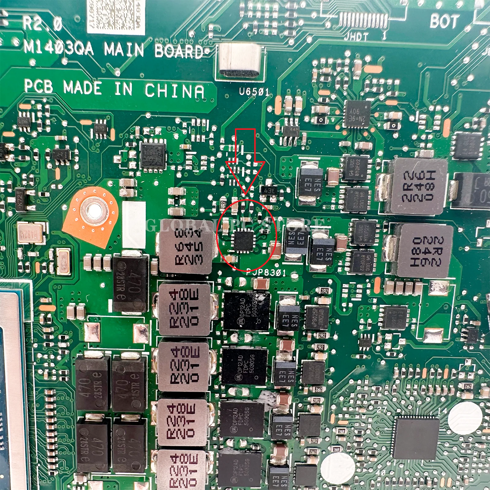

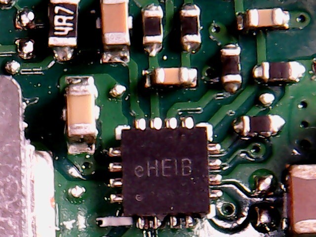

Asus M1403QA R2.0 motherboard Help required to identify HEFA ic.
  • jovani1989
    • Sep 2022
    • 21
    • Romania
    Asus M1403QA R2.0 motherboard Help required to identify HEFA ic.
    Help required to identify ic circled with red in atached, from a Asus M1403QA R2.0 motherboard. No schemathic or boardview available. Seems to be a power suply ic. Thank you!
    • 21936
    Originally posted by jovani1989
    Help required to identify ic circled with red in atached, from a Asus M1403QA R2.0 motherboard. No schemathic or boardview available. Seems to be a power suply ic. Thank you!
    eH*** SY8386RHC https://www.badcaps.net/forum/troubl...02#post1538202
    • jovani1989
      • Sep 2022
      • 21
      • Romania
      Thanks! Also ic eH*** SY8386RHC is fully compatible with rN*** SY21138ARHC. Laptop is back to life.
      • PacoGT
        • Sep 2022
        • 107
        • Guatemala
        Originally posted by jovani1989
        Help required to identify ic circled with red in atached, from a Asus M1403QA R2.0 motherboard. No schemathic or boardview available. Seems to be a power suply ic. Thank you!
        can you uploa the image i search this ic i dont wath is
Name:	image.png
Views:	178
Size:	4.20 MB
ID:	3692847
        • alexanderjara125
          • Dec 2018
          • 2
          • ecuador
          This is the reference of the ic
          Last edited by SMDFlea; 10-22-2025, 12:37 AM. Reason: English !!!
          • glovecaps
            Asus ROG Strix Scar G533qm with a G733qm Motherboard, can I modify the Bios to accept G533 Bios
            by glovecaps
            I have a Asus ROG Strix Scar 15 (G533QM) that had a dead motherboard (Graphics card dead) and after trying to fix the motherboard with no success, I bit the bullet on a sale for a new motherboard. I ordered a motherboard for the 15 inch model which is the one that I have, and when the motherboard arrived it wasn't for a little while that I saw it was from the 17 inch model.
            My question is, can I update the Bios on this G733 motherboard to a G533 Bios.
            The reason for wanting to do this is that the keyboard isn't working as it should, and I think this...
            11-25-2024, 04:23 PM
          • dhenion
            Asus VivoBook F510UA-AH51 won't run on battery after motherboard replacement
            by dhenion
            I'm working on my sister's laptop: Asus VivoBook F510UA-AH51 - The motherboard died so I replaced it.
            The original board was:
            ASUS X510UNR REV 3.0 A
            The replacement board is:
            ASUS X510UNR REV 3.0 B (identical except B vs A - I couldn't find an A board anywhere. Visually they are identical.)
            It boots right up on the replaced motherboard and everything works fine on the new motherboard - but it won't run off battery. When I disconnect the charger it immediately dies. When I plug it back in and reboot the system - it still shows the battery at...
            01-30-2024, 01:45 PM
          • rascao
            Help identify component of a asus laptop motherboard
            by rascao
            Hello i have a asus motherboard with a component sot23-6 case with markings C34JH is shorting my 3.3v line i dont have schematics or boardview and i cant find any, the motherboard is a asus x415JA r2.0, searching on Google i found a Texas Instruments LMR14203 and the pin out is at least similar because the Vin and GROUND pins are the same position but it says is a 4.5v to 45v and is on the 3.3v line so i think is not the same, any help i will appreciate...
            09-06-2023, 09:09 AM
            ASUS P5GC-MX motherboard recap
            by momaka
            Here’s another motherboard that needed a full recap: an ASUS P5GC-MX.
            This one was gifted to me some years ago by user Pentium 4, along with a few other goodies. It actually came in working order with no bulging or leaking caps. However, I noted there were United Chemicon KZG caps everywhere on the motherboard. The CPU VRM output (CPU V_core) was the only exception: it had only 2x KZG. The rest was 6x UCC TMV 4V 680 uF caps… which aren’t any good news either.
            So here is what the motherboard looked like with its original caps:
            CPU VRM area up close…...
            01-27-2021, 11:59 PM
          • MakNCheese
            ASUS Zephyrus GA401I Severe Lag, Suspect Motherboard/Power Issue - Need Help Diagnosing
            by MakNCheese
            Hi everyone,
            I'm having a serious issue with my ASUS Zephyrus GA401I (4 years old, worked perfectly until recently). The system is lagging heavily, even in the BIOS, and is charging extremely slowly (a few percent in hours), making it nearly unusable. I suspect a motherboard or power delivery issue.
            Symptoms:
            • Severe lag across the system, including BIOS navigation.
            • Slow boot times and unresponsive performance in Windows.
            • Battery charges very slowly (e.g., ~5% in 2–3 hours).
            • No error messages or BSODs, just extreme sluggishness.
            What I've Tried:
            • Replaced
            06-04-2025, 12:48 AM
