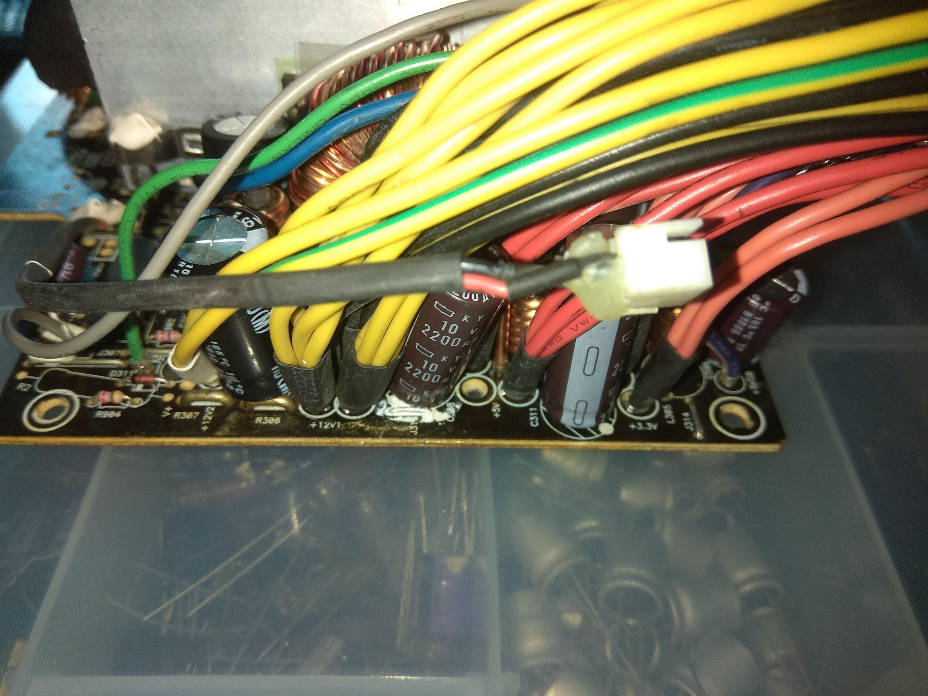

      The other two caps (5V+3.3V) show super high capacity and it seems their about to meet their doom.
      Replaced all SC caps with the following ->
      3.3V -> 2X KY 2200uf 10V (capacity downgrade from 6.3V 3300uf)
      5V -> 2X KY 2200uf 10V
      12V -> 2X Nichicon HD 2200uf 16V
      5VSB -> 2X Nichicon PW 1000uf 10V
      in any case getting 10mm diameter caps is really hard ...

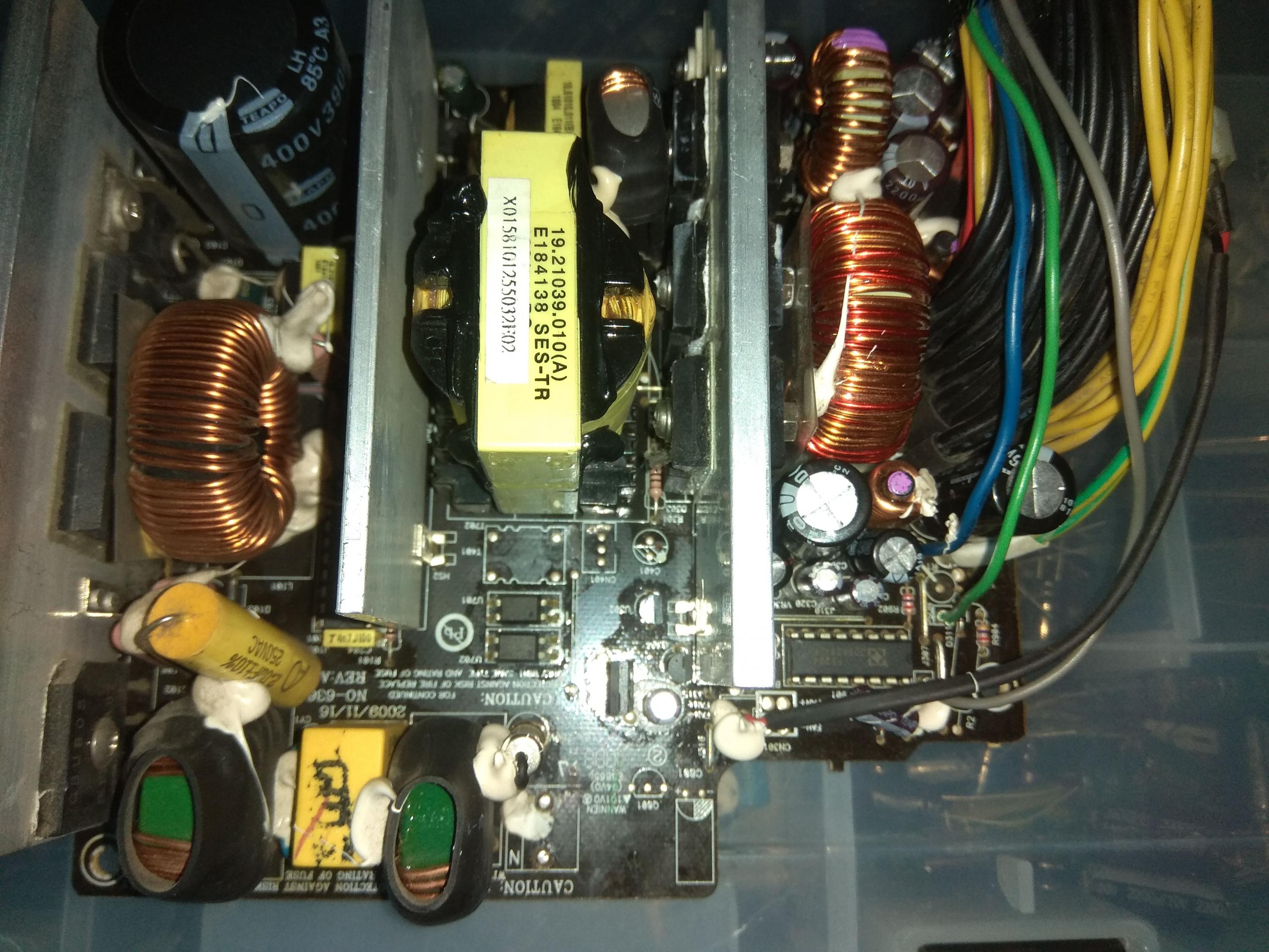

          I think 3.3V line uses MBR2045CT, hard to say for sure cause its well hidden. To improve this psu's nudity I've installed some X Y Caps. All filter caps are 1500uf LOWESR from YHC? with space for one cap for each as usual. I'll put Lelon RGA 2200/3300uf there and will let it be. The 3.3V line on DMM went up to ~3.15V on the Jetway P4 board and shows around ~3.4V on a C2Q P31 board.
          Ah, I think I know exactly what's going on now - you have one of those "super-group regulation" PSUs, like this POS Cyberlink PSU here:
          https://www.badcaps.net/forum/showthread.php?t=39222
          ^ In essence, that PSU doesn't have a mag-amp or linear regulator circuit for the 3.3V rail. Instead, it just derives the 3.3V rail from its own separate transformer tap just like the 5V and 12V rails... and so the 3.3V will vary quite wild-ly with any load. Cheap PSUs like this are some of the worst garbage you can get. I wouldn't put one of these in *ANY* PC.
          The picture of yours here confirms you have the same design in that PSU. IMO, you shouldn't waste any time on PSUs like that, unless you really have nothing else around and need to put a system together... but even then, I'd say that's a questionable endeavor. (And if you've read my posts long enough on BCN, you will find out that I am the type of person to try to reuse/rebuild just about any PSU... but some of the cheapo PSUs like this, even I don't bother with, lol. )

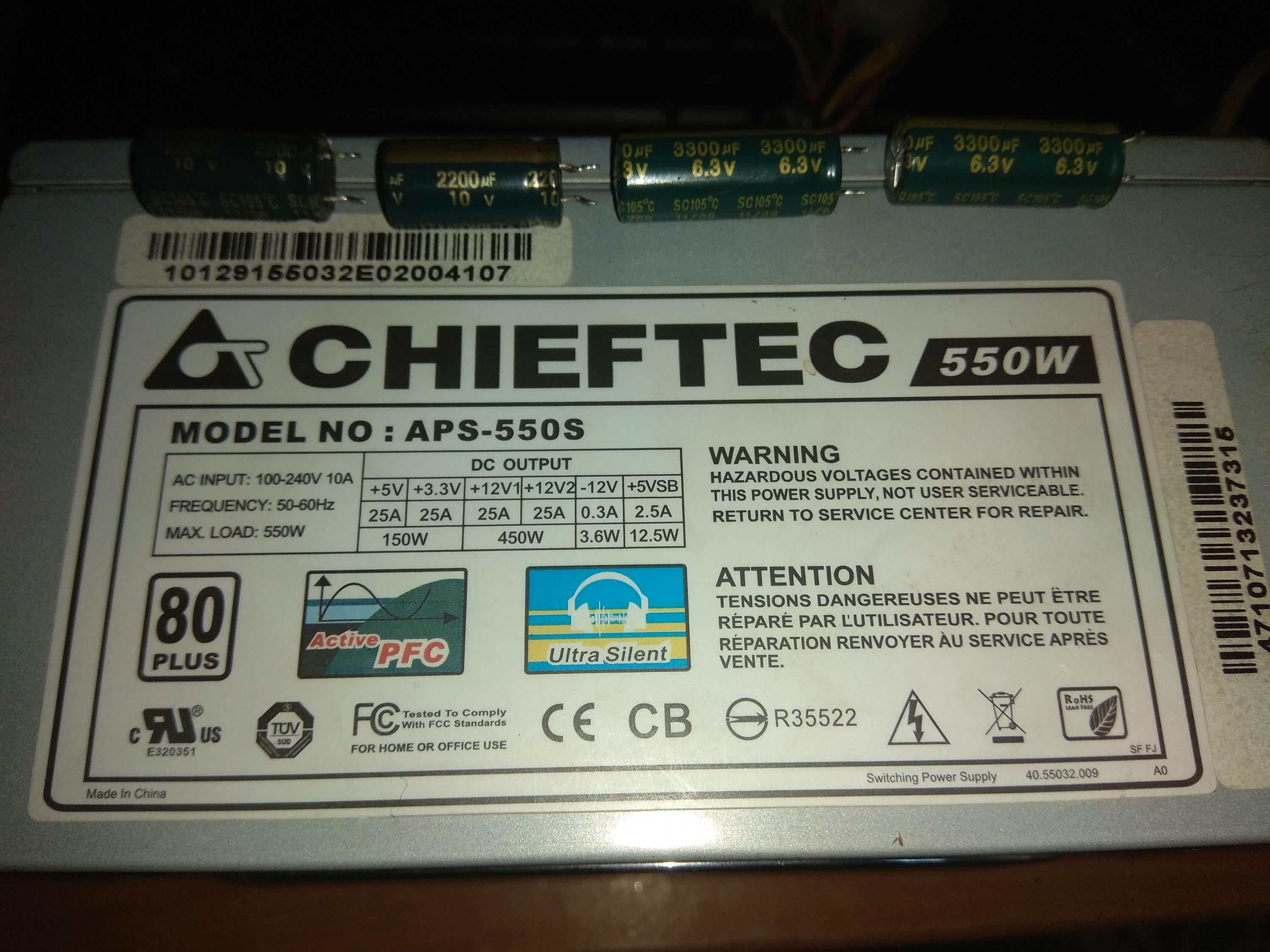

          Another nasty discovery upon cleaning a chieftec aps-500 (10y old PSU). One Teapo SC is bloated and others are starting to raise in capacity (pics bellow).
          That's a Teapo-cal failure mode for the SC series.
          10 years is about the right age too, if not a pretty good run, I must say. Would like to see Cheng/Chang/Chong/X garbage make it that long, but I'm pretty sure they won't.

          The very crammed area around 3.3V forced me to swap that cap for a 2200uf KY 10V as my other GP caps are Nichicon VZ 3300uf 6.3 and lelon GP.
          That's good anyways, since KY series tends to be a good replacement for Teapo SC. The lower capacity will just mean you won't be able to pull as much power as the label says... but that's rarely a concern if you just want a basic system build anyways.
          Originally posted by zunasthegreat
          PSU is Group Regulated with proper equipment, nothing fancy.
          Nothing fancy, sure... but at least 100000 times better than that crappy Powertech supergroup-regulated POS.
          Looks good to me.
          Wait until you run into PSU with custom-order 8 mm caps... or even 6.3 mm skinny tall caps. I haven't, but I've heard terrible stories.
          For 10 mm, and depending on what e-tailers you have/use/deliver to you, look for these"
          United Chemicon KYB series for 16V, 2200 uF in 10 mm dia.
          Rubycon ZLQ series for 6.3V, 3900 uF in 10 mm dia. (these can be used on 3.3V or 5V rails.)
          ^ At least those have been my go-to caps in 10 mm dia and higher capacity (particularly when needing to replace 3300 uF ones.) I still haven't found a good source of 3300 uF 16V caps in 10 mm. Badcaps.net used to have Samxon RS, but not sure if available anymore. I think only member behemot on this forum has some skinny custom-ordered caps that can fit newer PSUs.

            13007 transistors : Check
            One Cap per output wonder : Check
            Full nudity : Check
            1.5mm metal for heatsink : Check
            No 3.3V toroid : Check
            No PI Coils : Check
            Awe-sum quality cap only : Check
            AWG20 quality cabling : Check
            Classy Coolbox Fan : Check
            ... we have another winner
            Its the perfect psu for LoLs and having fun with bad-caps or maybe the perfect April's fool gift.
